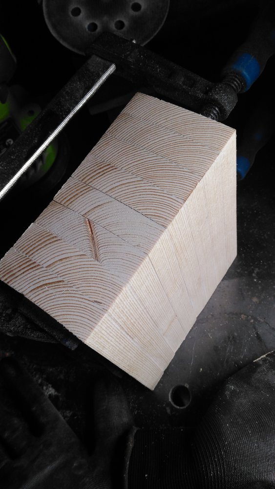

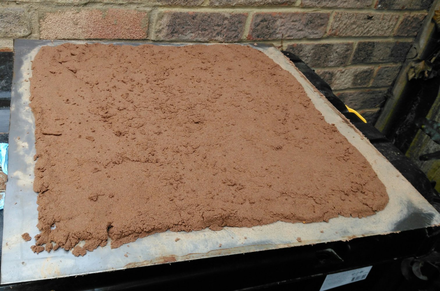

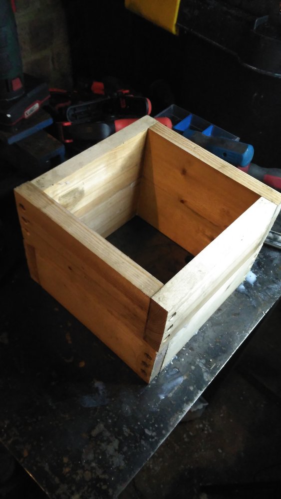

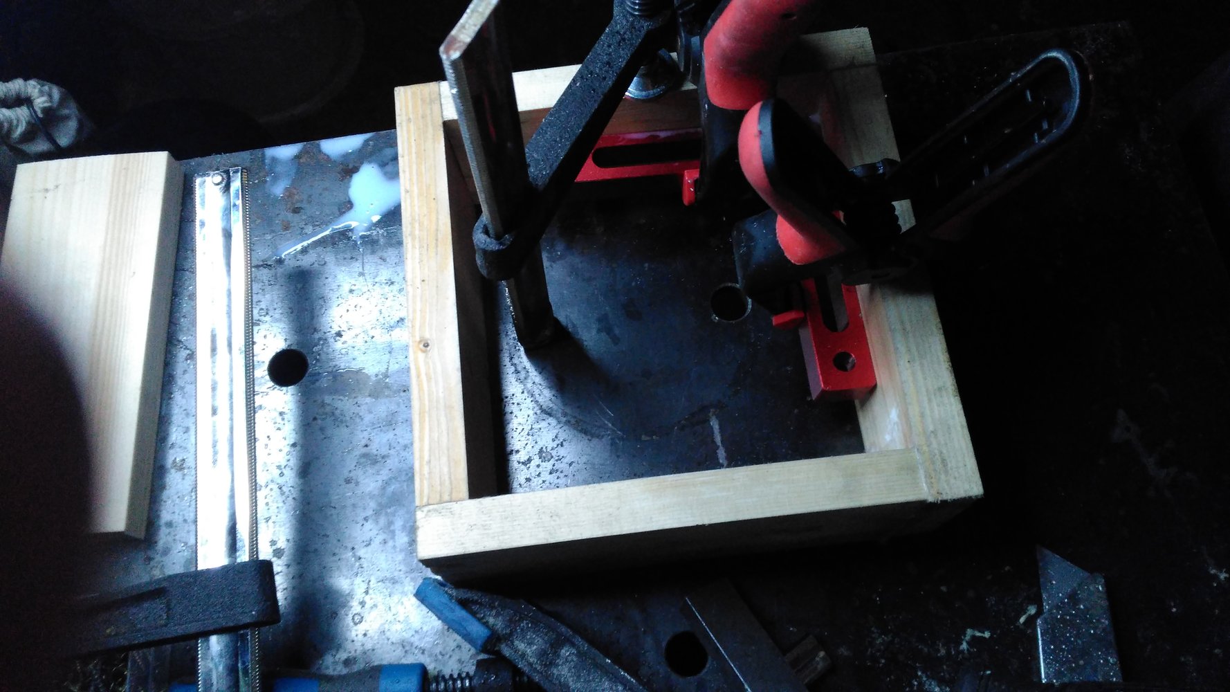

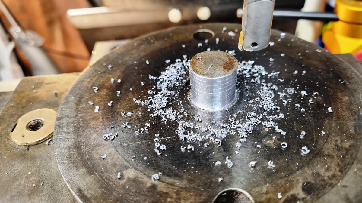

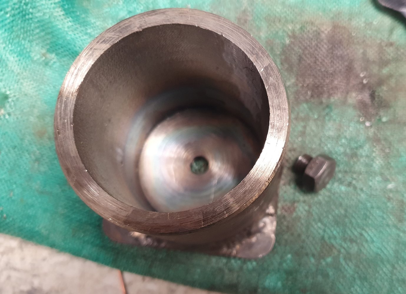

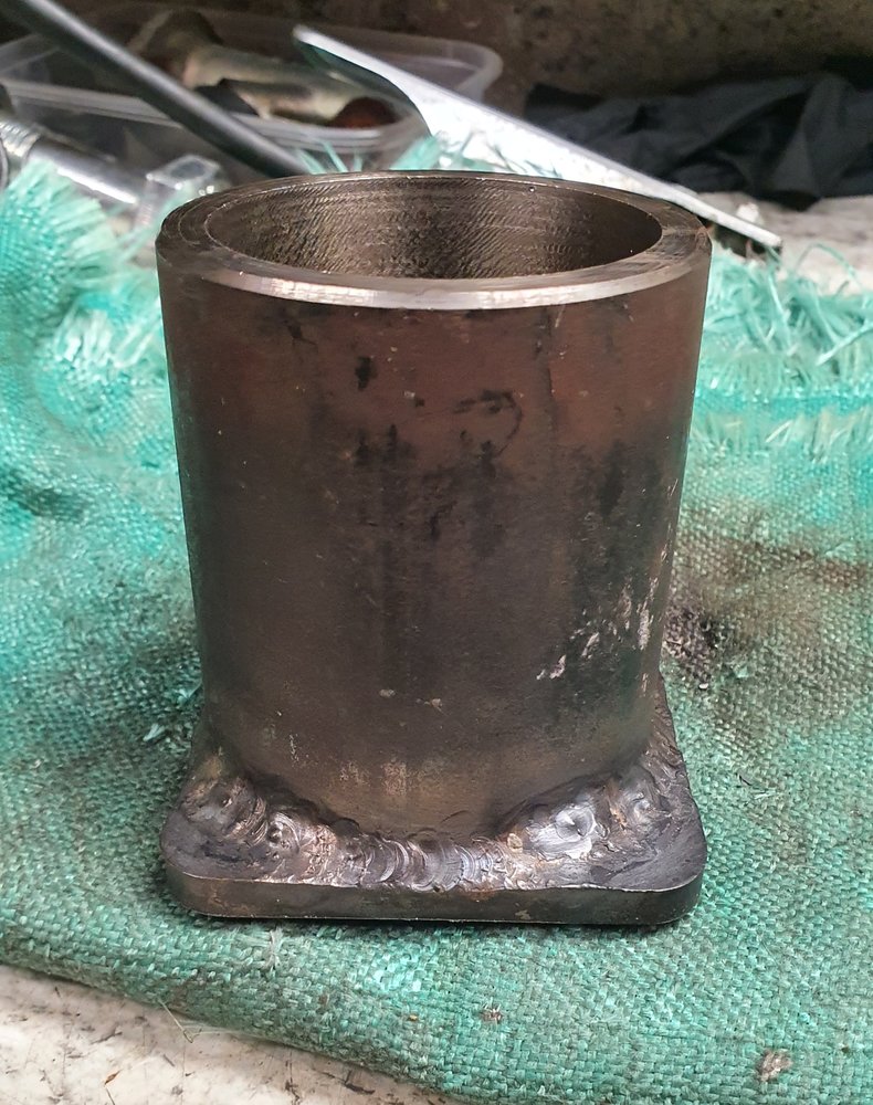

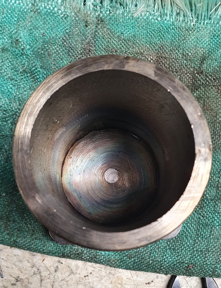

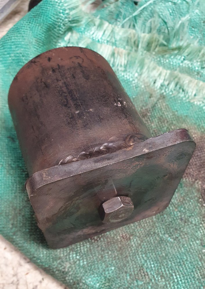

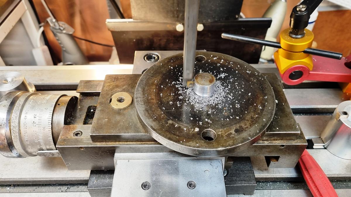

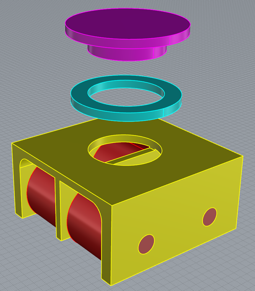

Made up a little mold for casting aluminum bar billets, internal dims are 59.8mm x 80.8mm long but final piece will be 44mm od x 35mm long so allows for shrinkage and will be used as rollers for diy machine skates from 100*50 channel.

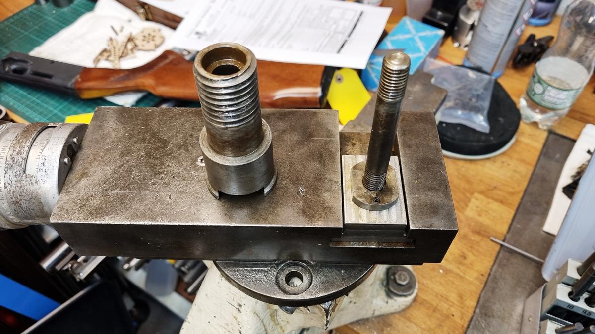

Bolt is flush with inside plate face so if the chunk of ali gets stuck I can remove the bolt then punch it out.

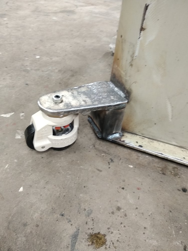

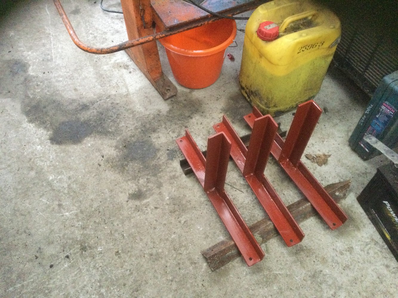

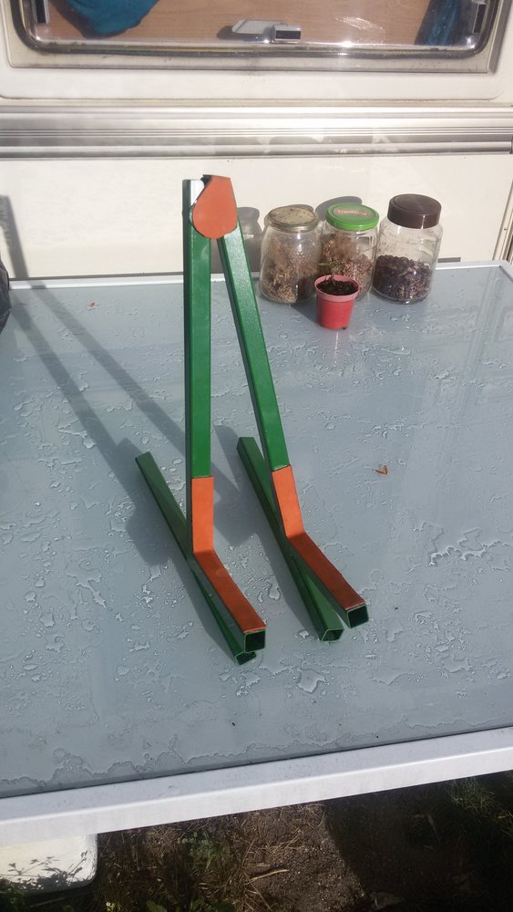

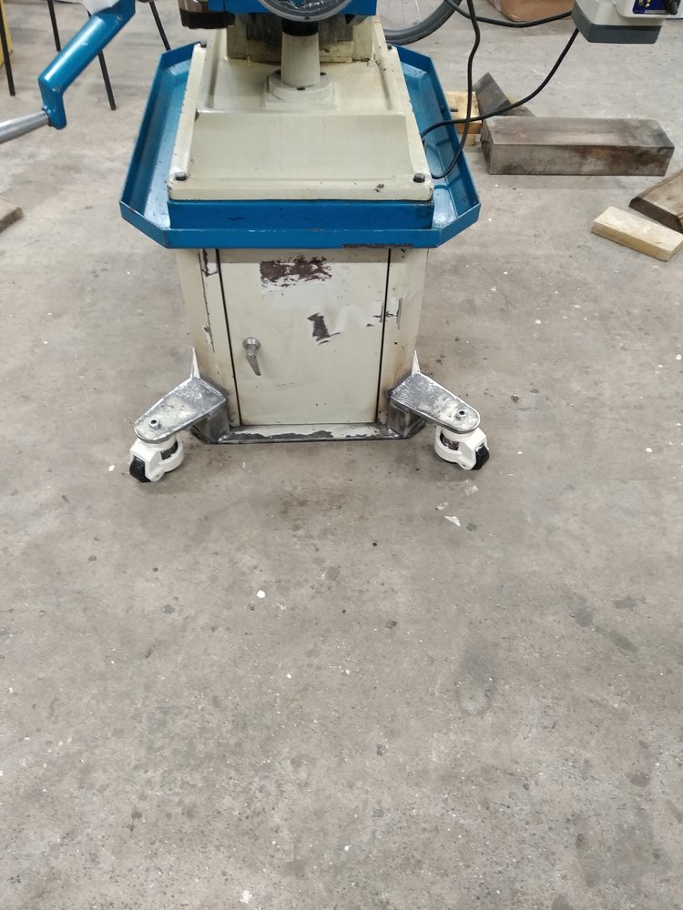

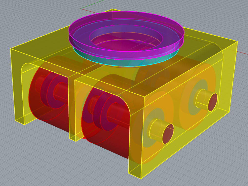

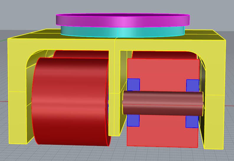

Skate model with a rotating foot on a needle roller thrust bearing version. Overall dims are roughly 100*100*65mm with a max load of 1000kg
