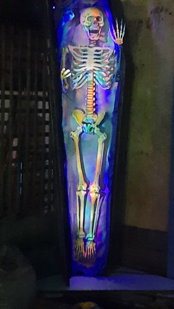

Fixed the coffin, all the UV LEDs had gone pop when the wrong voltage was used to power them

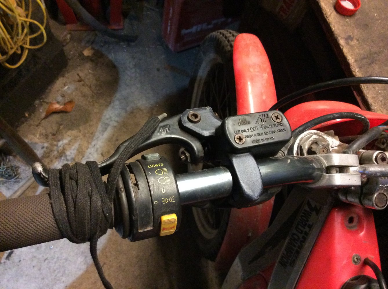

Gas gas.Is that an early Montesa / Honda?
Eat fewer beans.Gas gas.

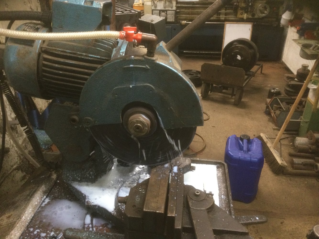

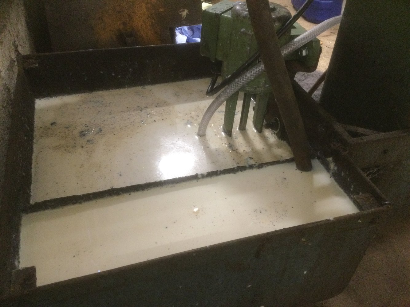

One of these bad boys is on my hit list one fine dayToday I attacked the cold saw, made a bracket and fitted the new to me suds pump, rewired, fitted a new tap and repiped it.

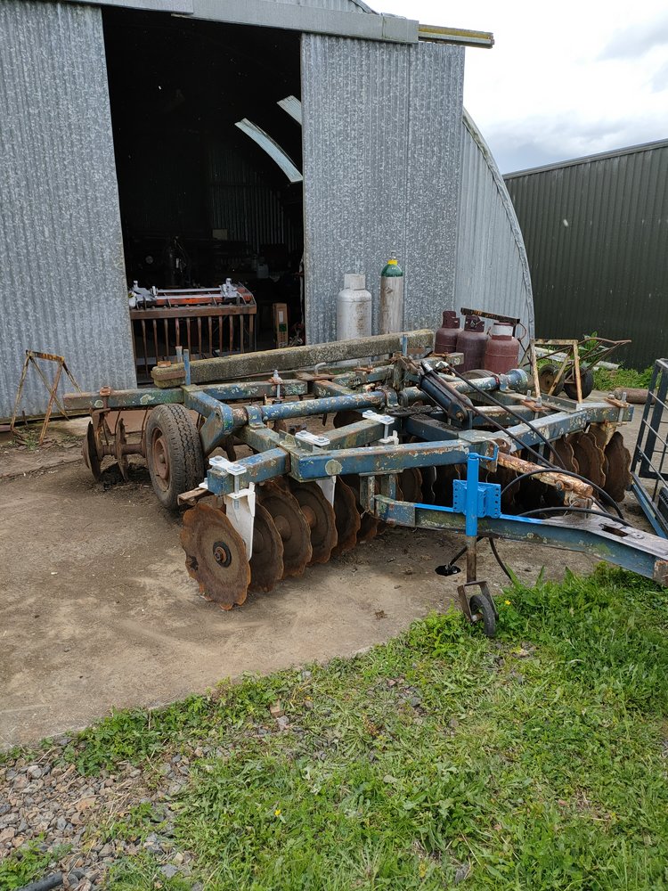

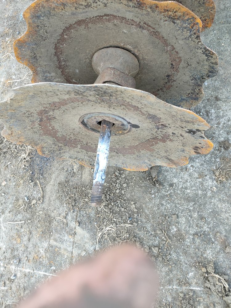

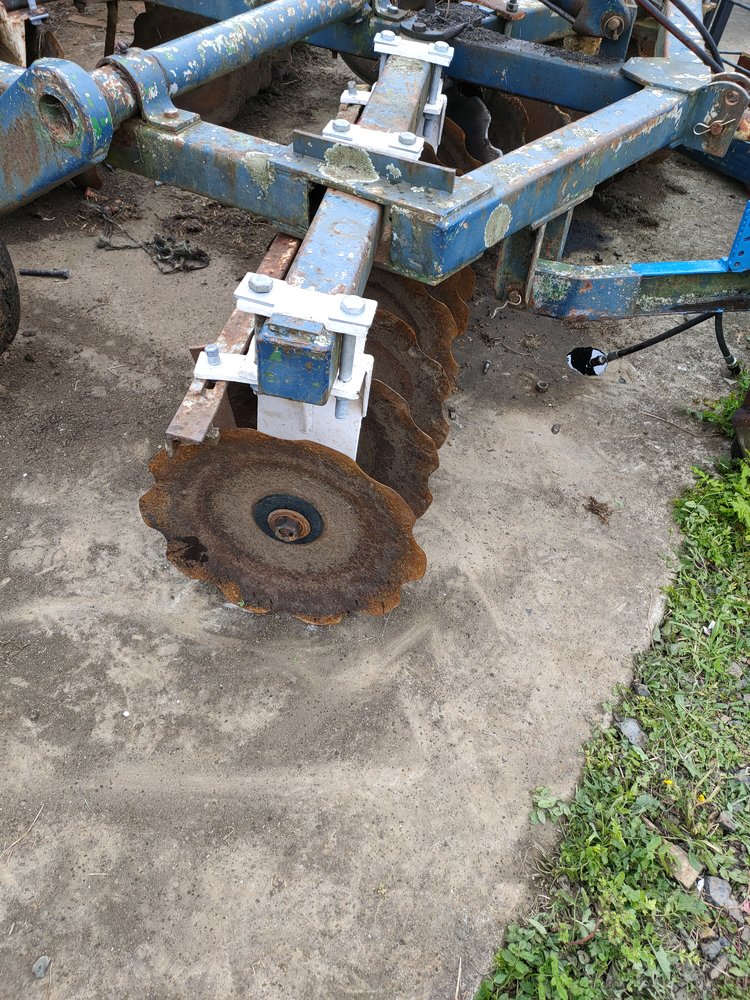

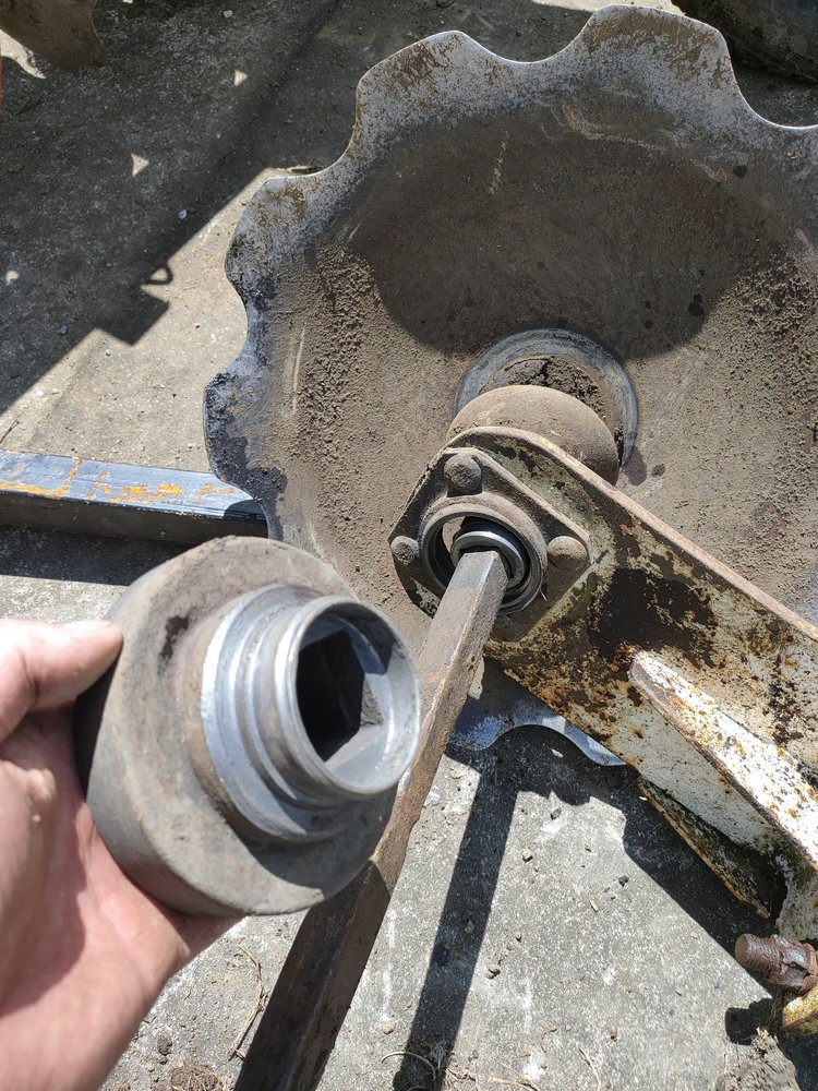

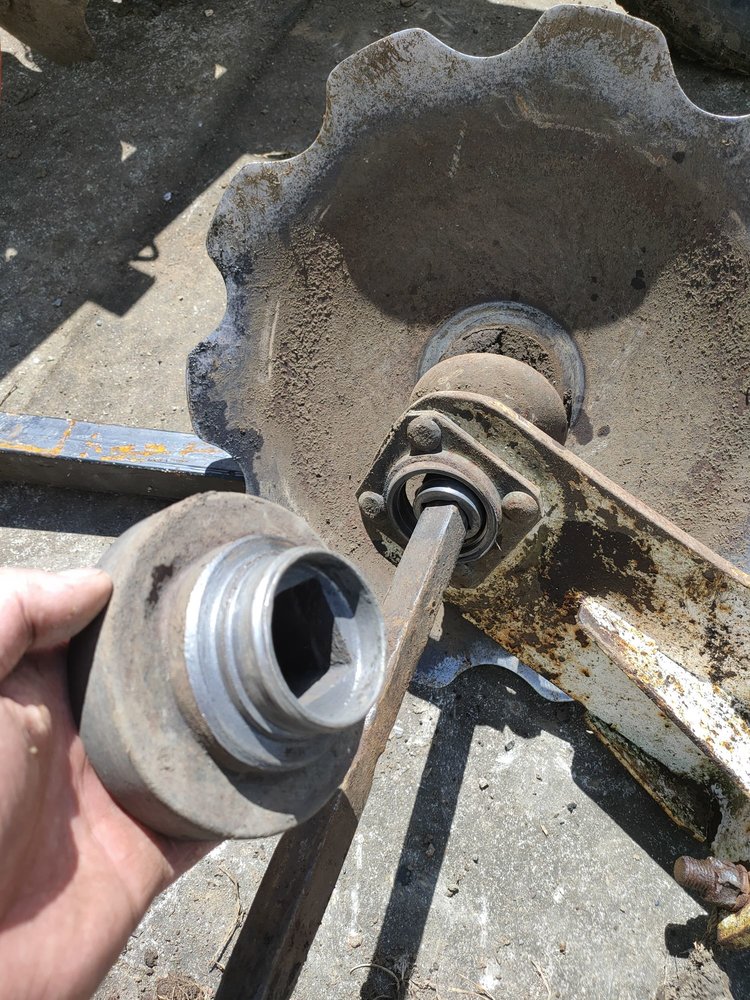

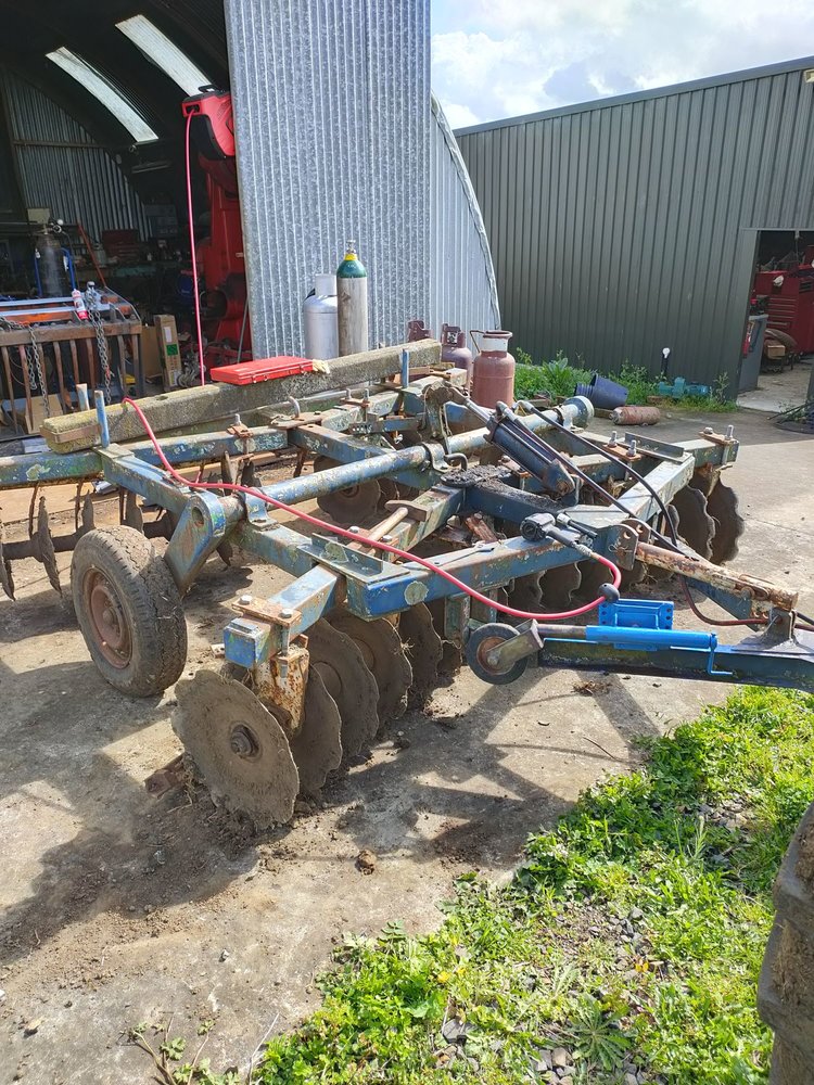

I bought a set of disc harrows last year, on the basis the price was he same as paying the contractor to do the prep work for summer feed. That plan didn't quite work - who would have thought tractor salesmen are related to car salesmen? They were supposed to be running, but having had to reseal the hydraulic cylinder and new hoses and brazing a fitting, I think they may have been economical with the truth...
I should have gone over them in winter, but anyway, finish the first paddock and a bearing collapses. The nut on the end of the shaft that holds the disks in palce came undone, the whole lot shifted sideways, ate the bearing and then started on the cast iron spacer. No bearings available easily so I have had to mail order some for this week,

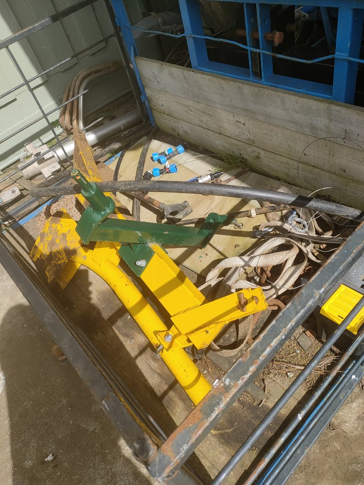

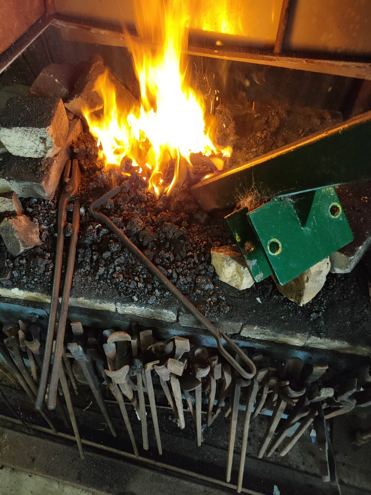

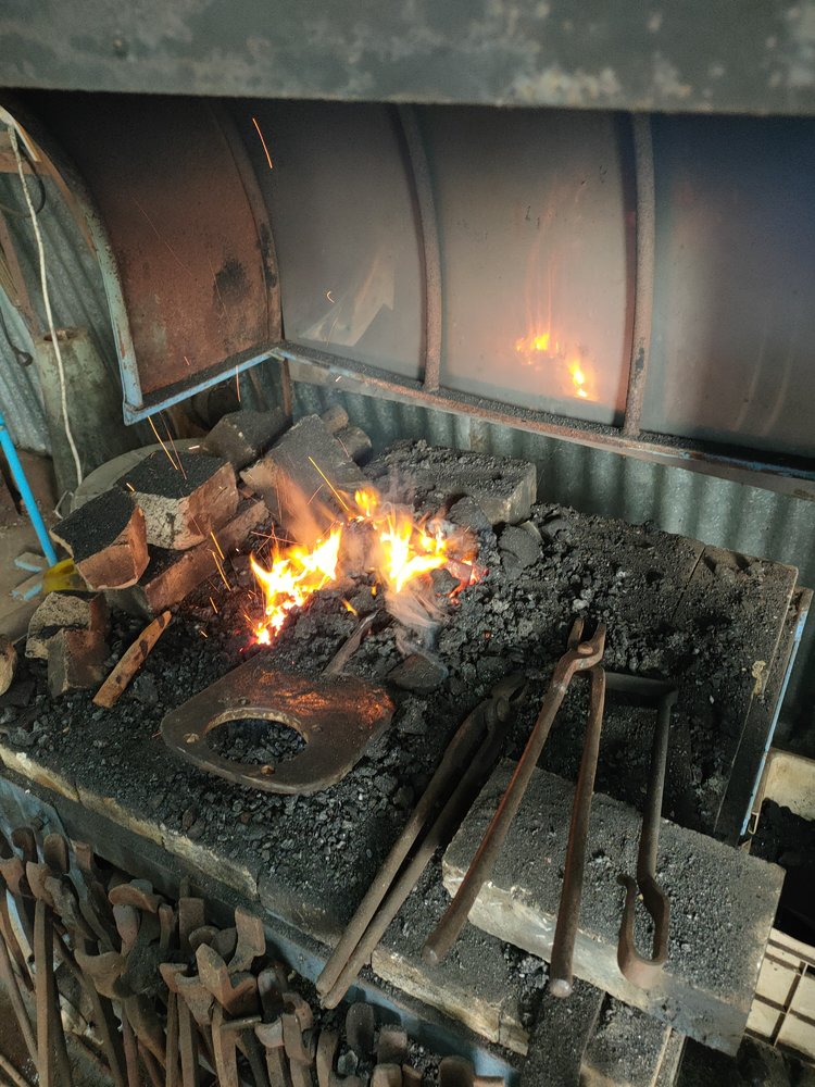

The bearing hanger had seen better days and some past abuse, being bent 40mm and ripping the welds, so while it was apart, I put them in the forge and gave it a talking to with a 4lb hammer.
It will live again, but the contractor has finished the job again this year.
