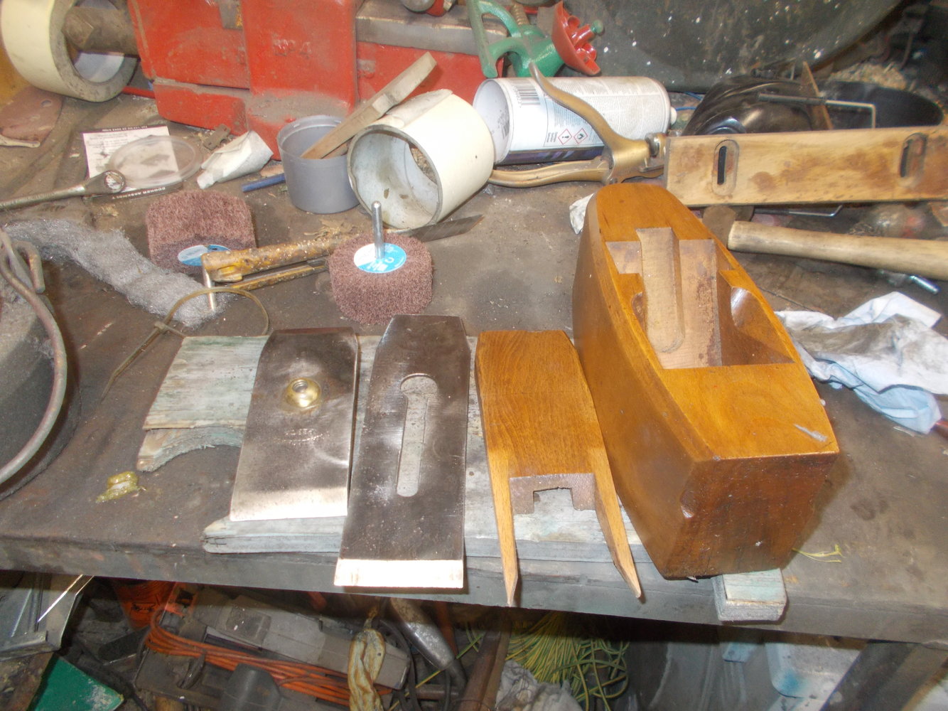

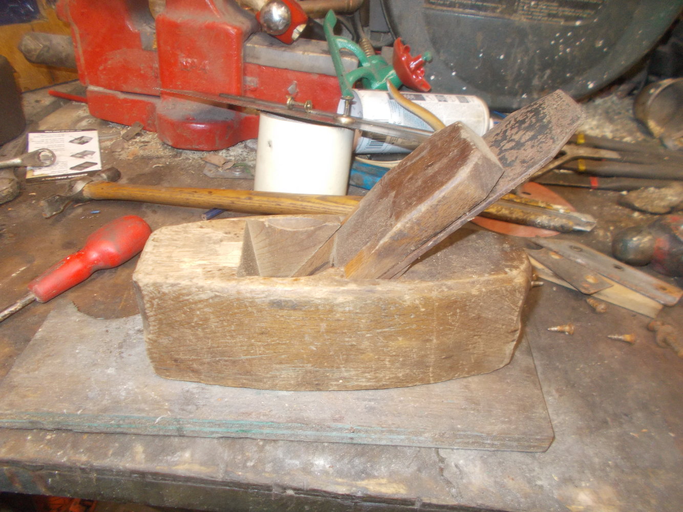

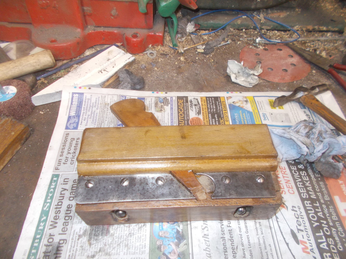

Whilst on a tour of Canada for nearly 3 months using MIL's home at Welland lock number one near Niagra falls as a base .This was a very nice restoration.
The blade and cap were jammed, but with a few taps I had them out.
The blade is bent, this was causing the jam. A few deft blows on a anvil had the bend removed.
The metal was cleaned using a scouring pad. The blade was re-ground on a wet stone, then sharpened on a oil stone.
The wood was cleaned with meths, then using a cabinet scraper cleaned up.
The finish is just bee's wax, the wood took it well and buffed up.
This old plane is a joy to use, the old steel took an edge very well.
