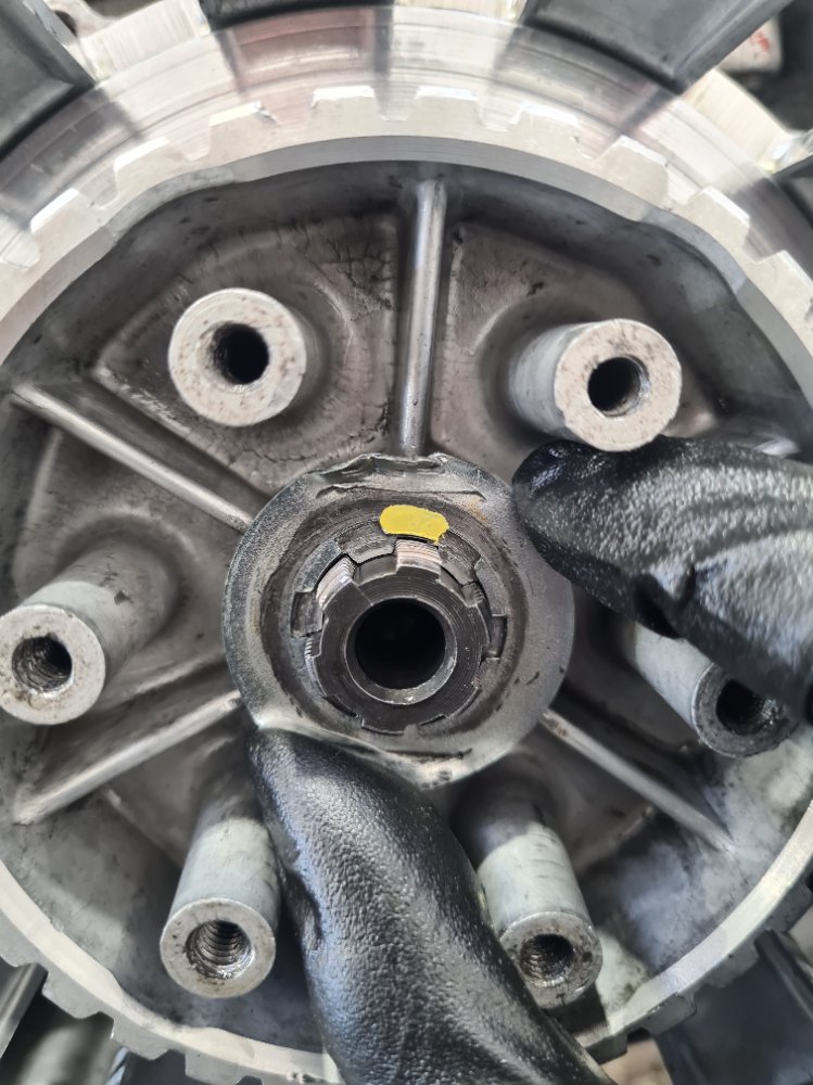

Kawasaki strimmer, very hard to pull over. The spring holding the centrifugal clutch shoes had broken, so the crank was effectively locked to the rest of the drivetrain, hence the difficulty in starting.
But… the chewed screws and stripped threads suggested someone had been in there. And the second piece of spring was missing.
Conclusion: someone had opened up the clutch, seen the fault, carefully removed the broken spring bit, and closed it all up again. Talk about sweeping dirt under the carpet, for the sake of £4 for a new spring.

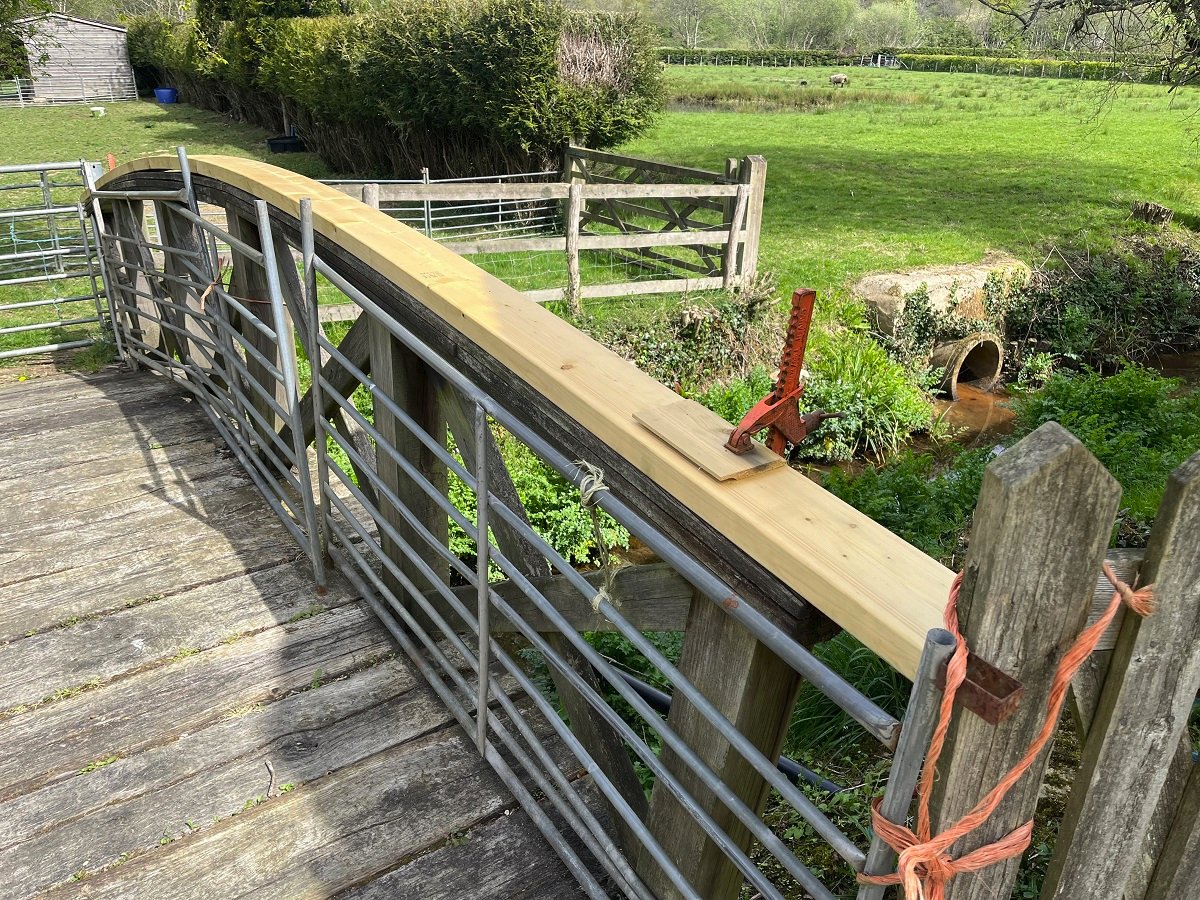

) and when built the curved handrails had to be laminated from shorter pieces as at the time I couldn't source 16 foot lengths of  6" x 2". Over the years the weather hasn't been kind to it and the rail is rotting but I have been able to source two 16 footers to replace them. Original 'curve' - more a series of straight lines wasn't ideal so this time I'm trying to get the replacement 'set' into a proper curve before removing the original (otherwise there'd be nothing to fix it to.
