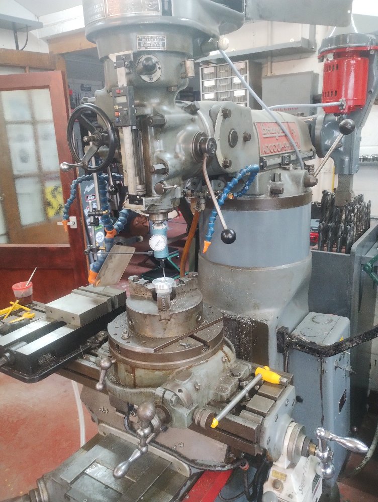

Well its only been 6 months, about time I got back to this one and try and diagnose the gutless motor that I converted from start to delta by diving into the windings. I thought I had inadvertently reversed an a1 with an a2 or similar with b or c.Started to fix the Tom Senior M1, or rather the motor and VFD. I converted the original Brooks Gryphon motor from star to delta by finding the star point and breaking it out into the individual windings. However, it was gutless. Life got in the way, and I acquired another Tom Senior, a light vertical, which meant I've only just got around to fixing it.
I suspect that I have one winding reversed, that is instead of a2 connecting to b1, and b2 to c1 and c2 to a1, one of these is reversed. I thought I would use the induced voltage method testing, using a 10v AC power supply, if its the right way around you get about 4v induced into the other winding. If all else fails I have a new motor, but that involves broaching a keyway.
I'm also replacing the VFD with a cold plate VFD, no annoying fan! I have a 40 ohm, 200 watt brake resistor on order, I'll compare before and after to see how much faster it slows down.
Pics next time, I'm in the pub!
