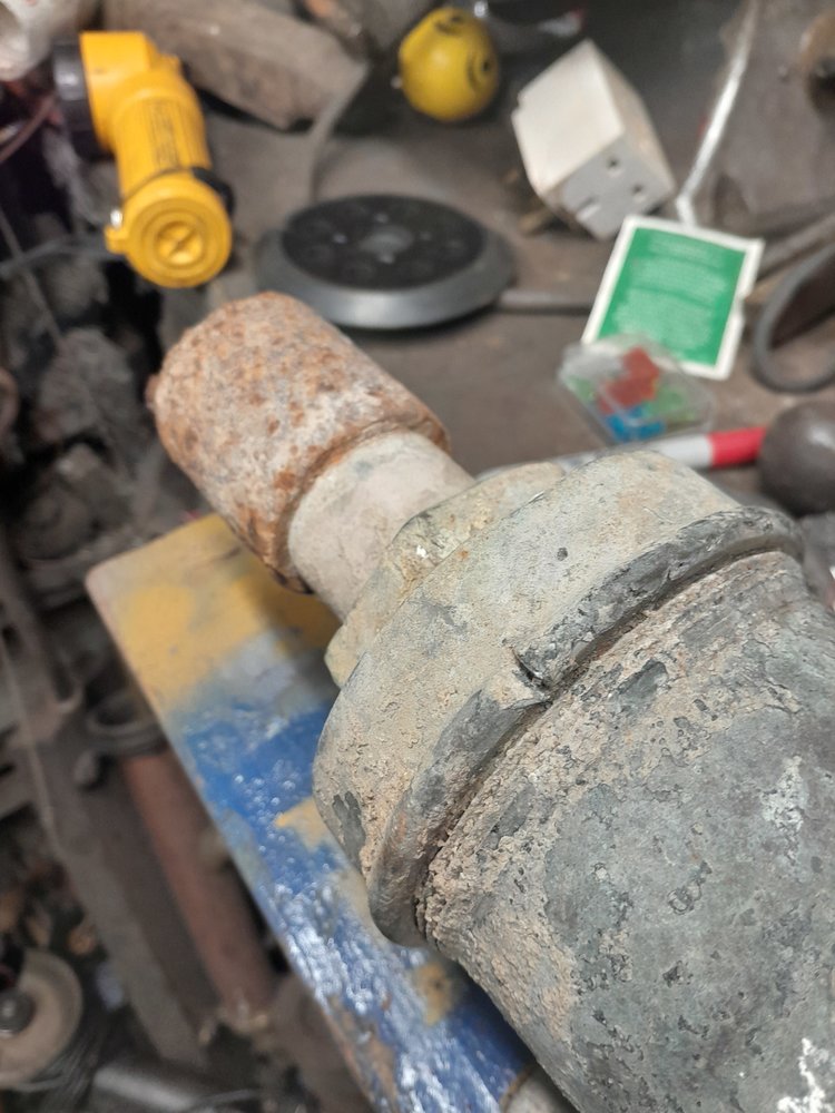

Tiny part of a huge setup, basically a routing manifold with lots of automated valves, allows product to go to and from 12 different silos to various machinery.What does it do?
