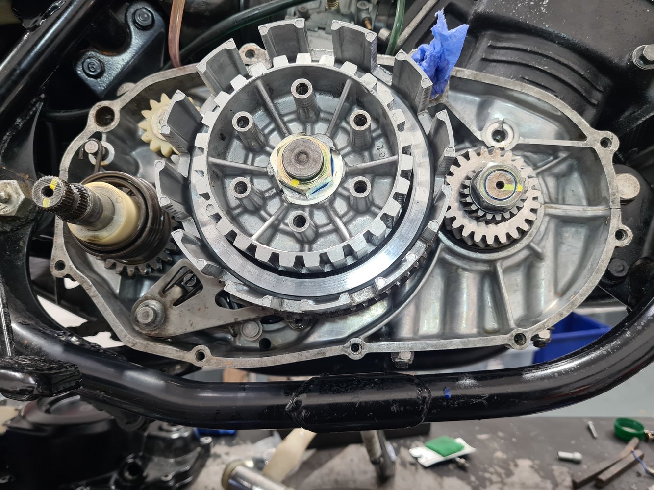

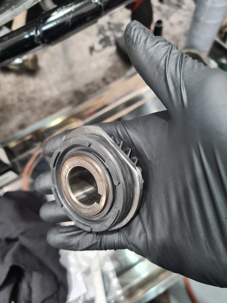

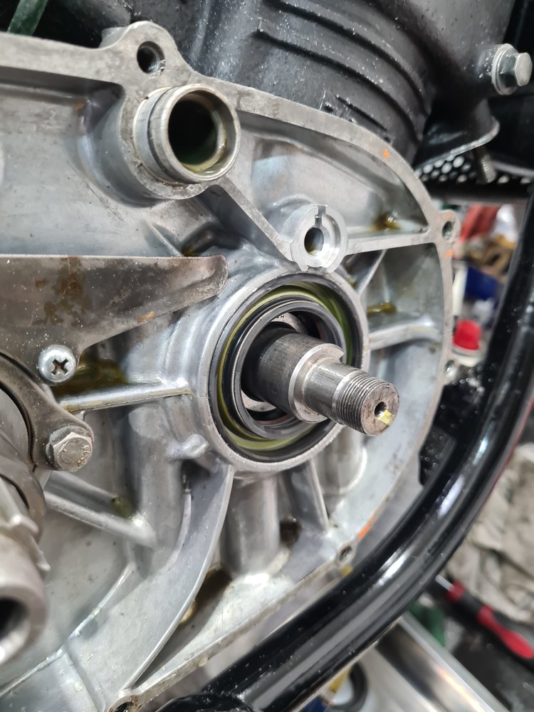

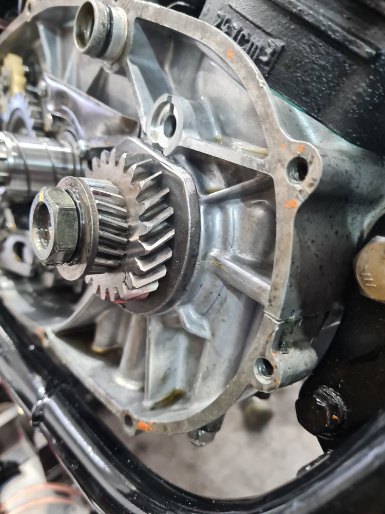

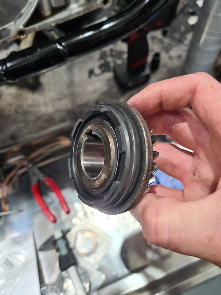

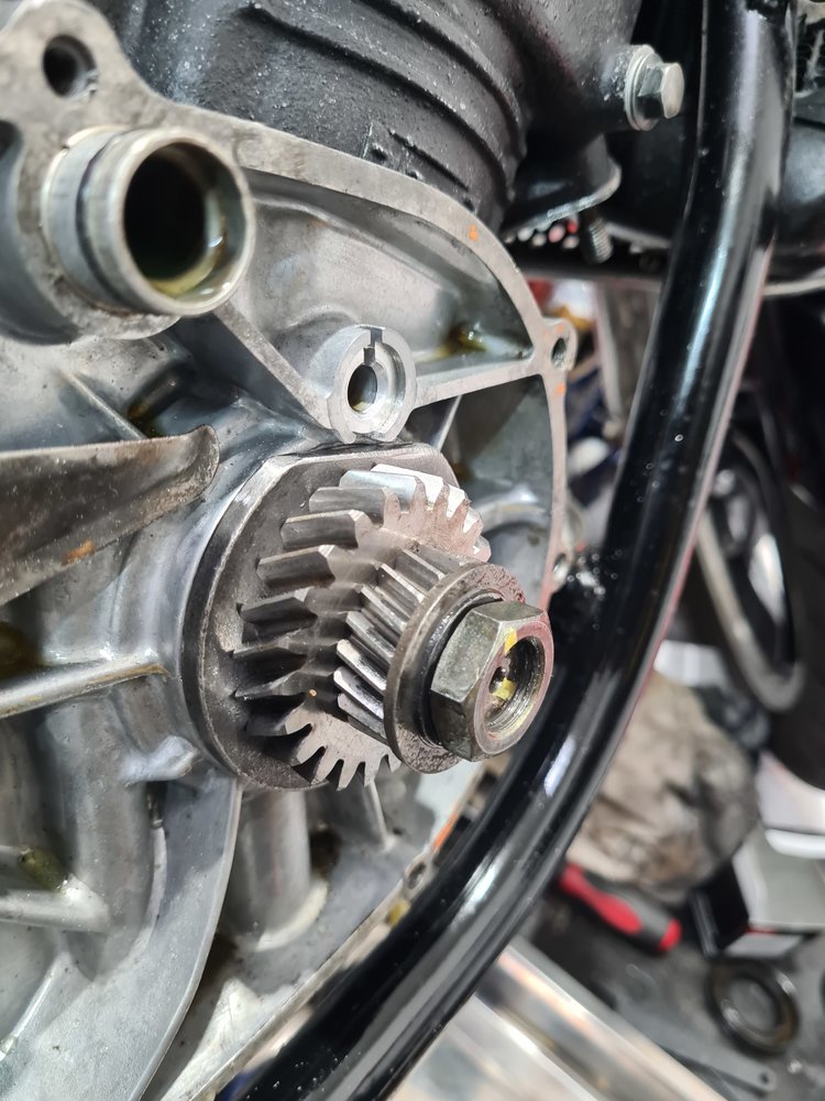

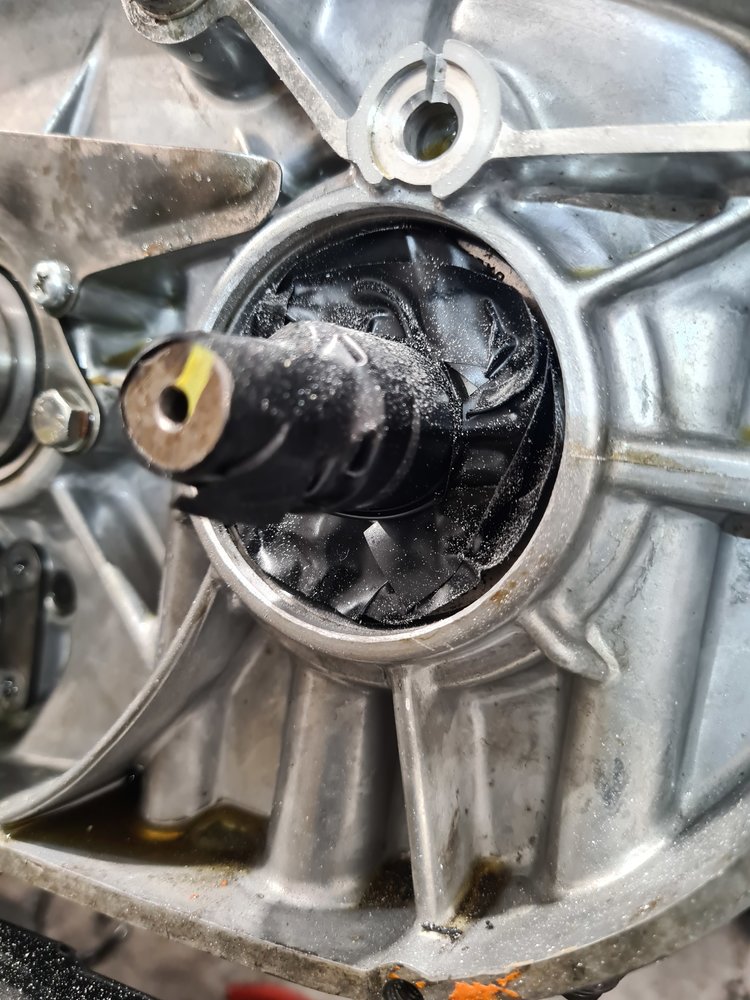

RD250 came in with excessive smoke from exhaust.
Drained oil out of geabox and took exhausts off. Ran it for 10 minutes and smoke cleared up..
Found the smoking gun but technically it is a crankcase split to fit a new seal, a lot of labour.
Said I would try and work a way out to press a modified seal in but no guarantee it will work (got 3 seals on the way).
View attachment 464398View attachment 464399View attachment 464400View attachment 464401
I thought the Rd's had a ridge on the outside diameter of the seals that prevented them being pulled out without a split???
Edit: am I thinking of the air cooled ones?
