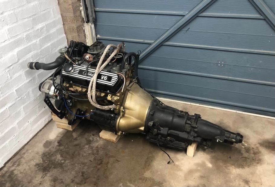

Find a nice 5/6 speed manual box (bmw rwd) and get/make an adapter up (see bmw's have there usesI‘ve looked around a year or two ago to see if anybody wanted to swap gearboxes, auto for manual, but had no luck.
‘Real men shift their own gears‘ etc etc sort of thing.![]()
)There are a few different well proven swaps around, I’ve seen them mentioned on the Scimitar web site. I’ll see how this autobox goes, but even then, I don’t see me doing a lot of miles in an open top hot rod in this country. I’ll probably sell it on when it is sorted and road legal.Find a nice 5/6 speed manual box (bmw rwd) and get/make an adapter up (see bmw's have there uses)
Mazda 6 speed boxes are cheap and adaptor to Ford engines readily available . Ford type 9 boxes for the V6 look very similar to the diesel Sierra boxes which don’t have suitable ratios , both have the longer first motion shaft and deeper bell housing than the 4 cyl versionsThere are a few different well proven swaps around, I’ve seen them mentioned on the Scimitar web site. I’ll see how this autobox goes, but even then, I don’t see me doing a lot of miles in an open top hot rod in this country. I’ll probably sell it on when it is sorted and road legal.
I just googled a bit.... and soon realised I don’t have room for three pedals in this tiny little car.Mazda 6 speed boxes are cheap and adaptor to Ford engines readily available . Ford type 9 boxes for the V6 look very similar to the diesel Sierra boxes which don’t have suitable ratios , both have the longer first motion shaft and deeper bell housing than the 4 cyl versions

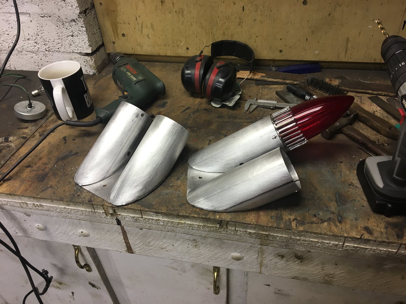

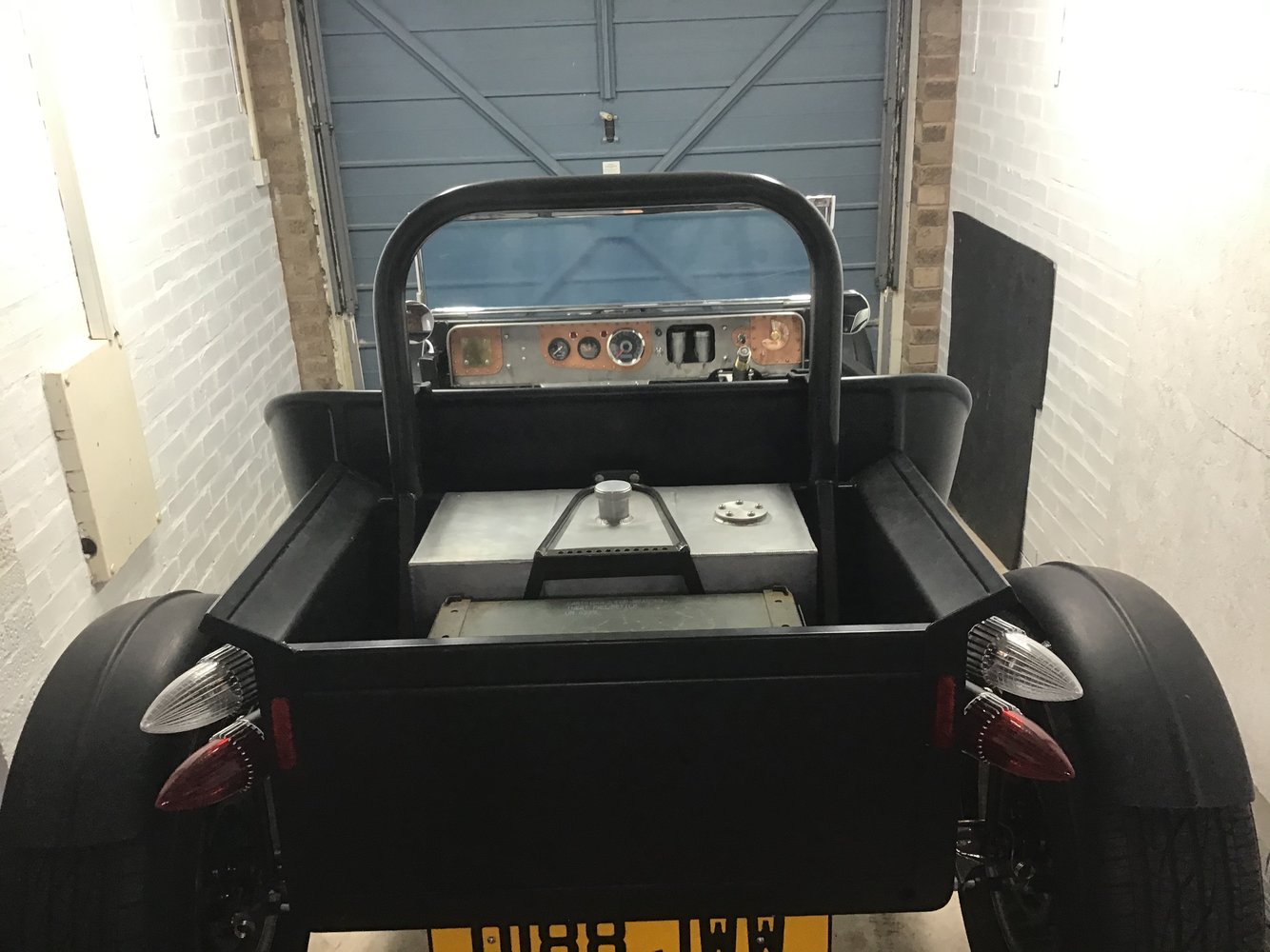

An interesting and original concept - a BMW part in a car that has working indicators!Find a nice 5/6 speed manual box (bmw rwd) and get/make an adapter up (see bmw's have there uses)
An interesting and original concept - a BMW part in a car that has working indicators!![]()
Love 'em, nice workAnd not just any old indicators... real in-yer-face Americana bling indicators.
Not sure I actually like them mounted like that, but I put so much work into making the brackets......
