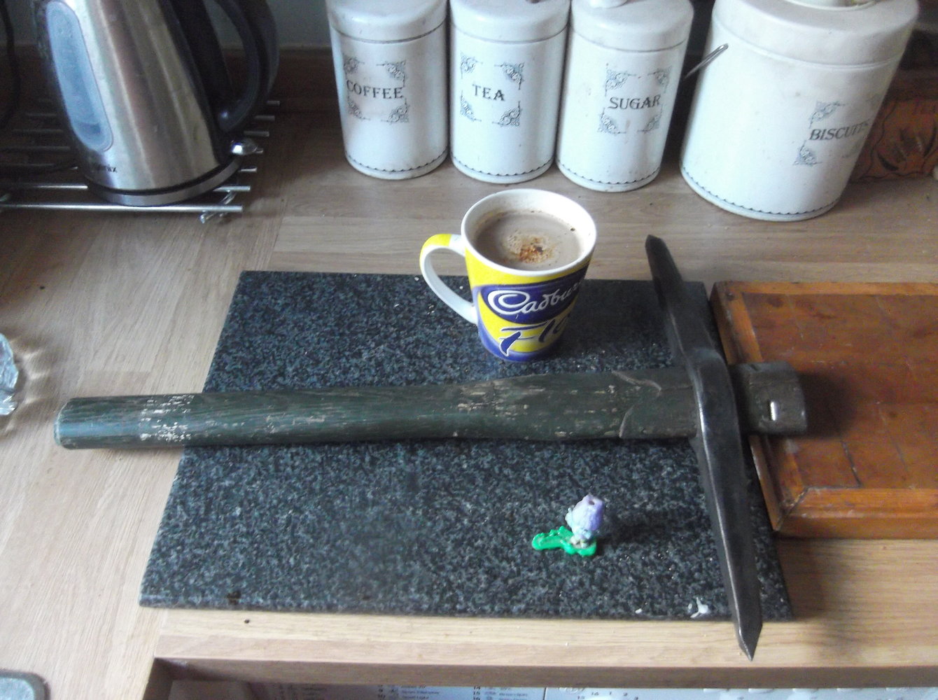

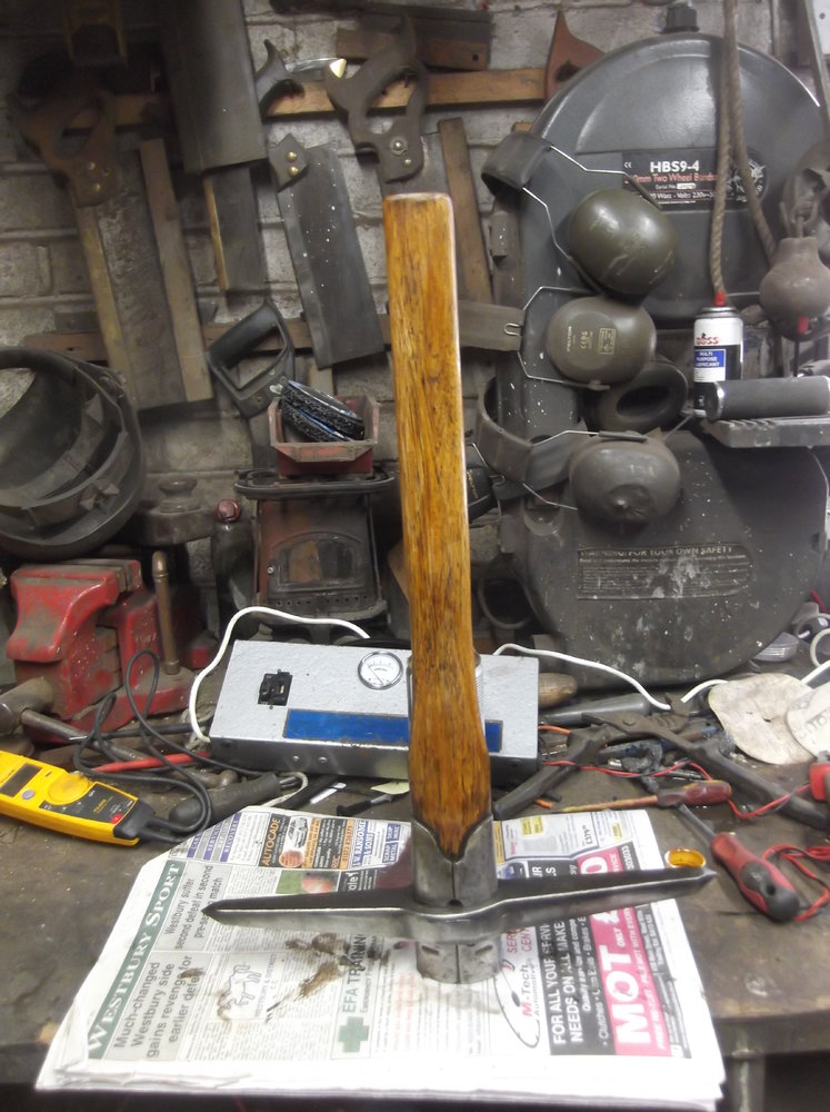

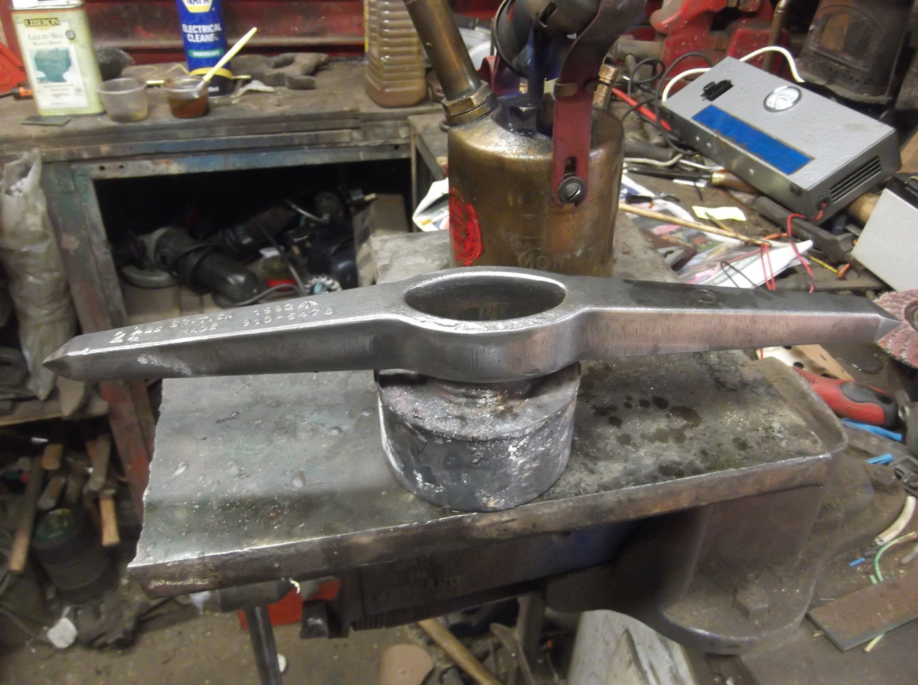

This British Army WW2 Pick Axe came my way.
The issues are:
Jammed head.
Deformed points.
Rough finish and splinters on the handle.
Plus it was not WW2.
The trader has refunded me 50% of what I paid for it.

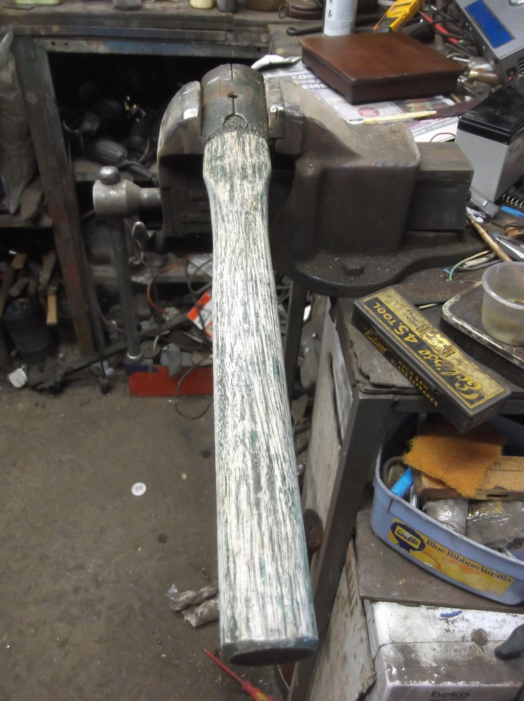

It took some head beating to shift the head. There was a serries of burrs in the hole.

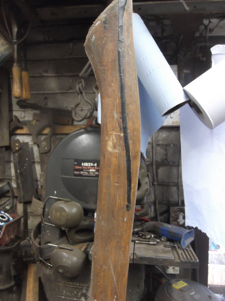

Here the handle has been worked over with a cabinet scraper.

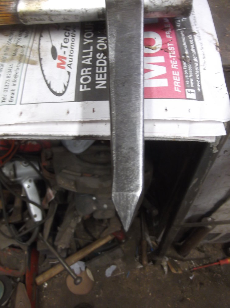

The head was cleaned up, the burrs removed.
The tips were dressed to a point, the heated to cherry red. Diped into cold salted water to harden them.
Then tempered to a blue finish.
When it was still hot a wax/oil mix was applied.
Handle was finished with a glass scraper, then french polish applied. No sanding sealer, as you want a textured finish for grip.
The fit is now correct.
Finished.

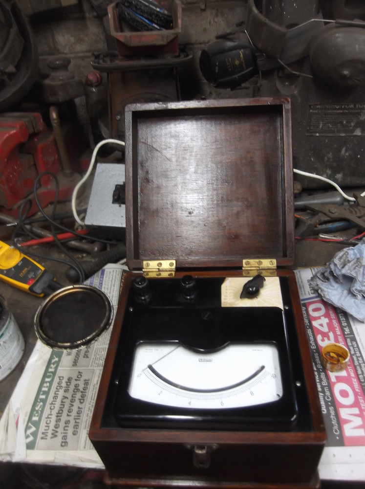

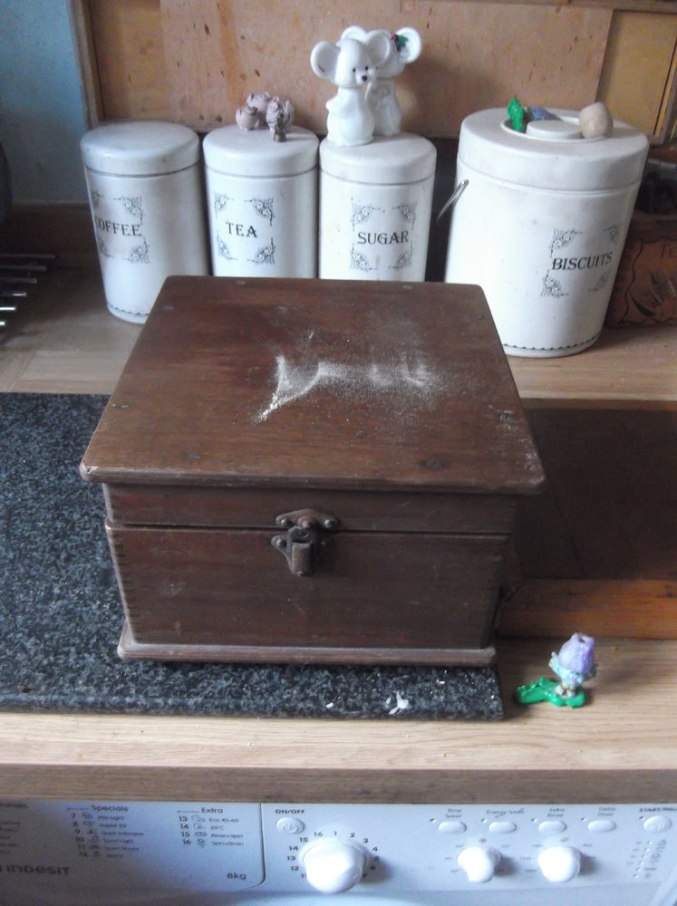

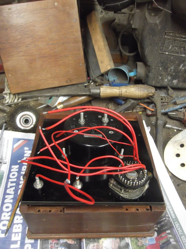

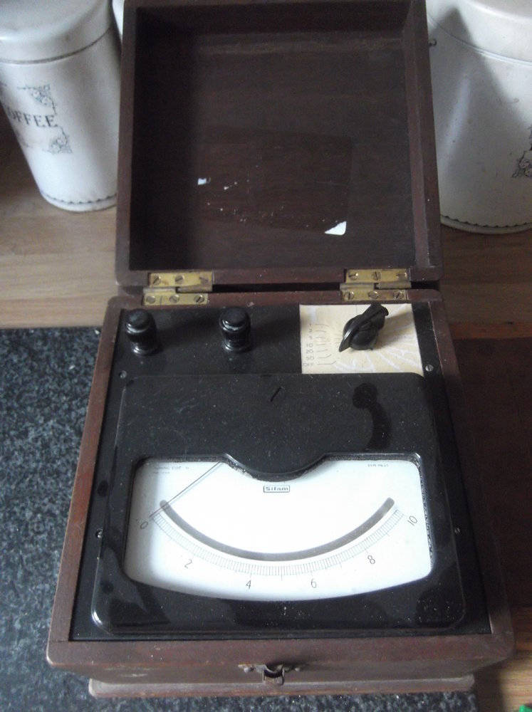

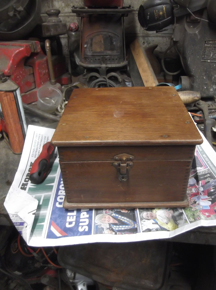

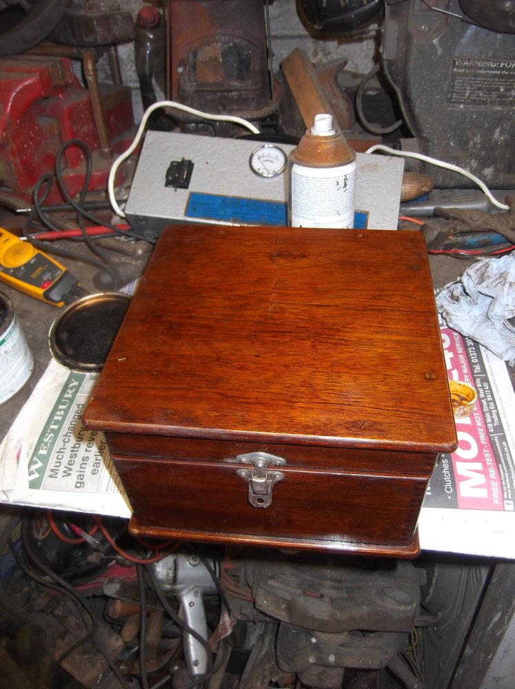

Another Meter in a box.
.View attachment 402238
Sifam Moving Coil meter.
I was told it was not working.
I can't work out why.
I am seaking a drwaing to re wire it.
Untill then.

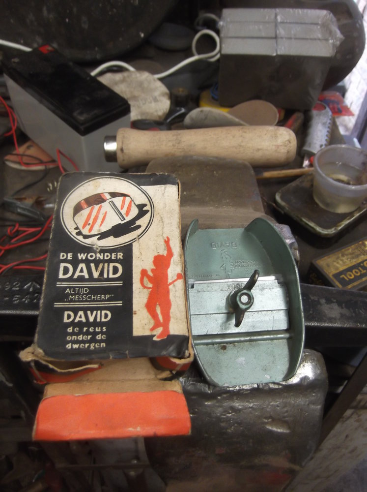

This handy tool is fantastic for getting into the edges to cut back the tired polish. A cabinet scraper does the rest.
The lower parts can be seen on the lid, gentle working will have it level.

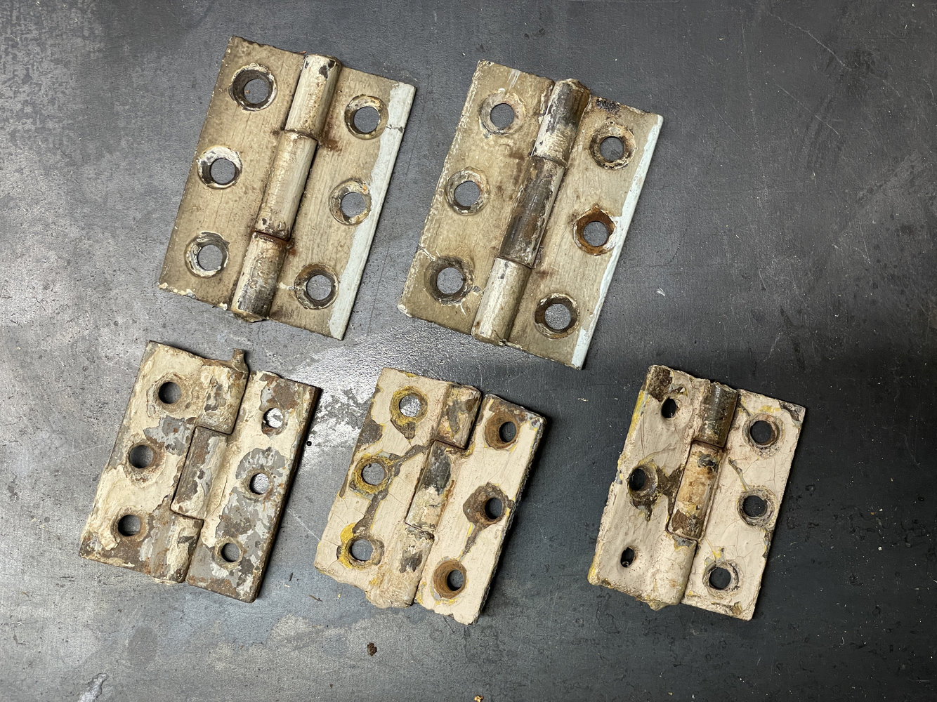

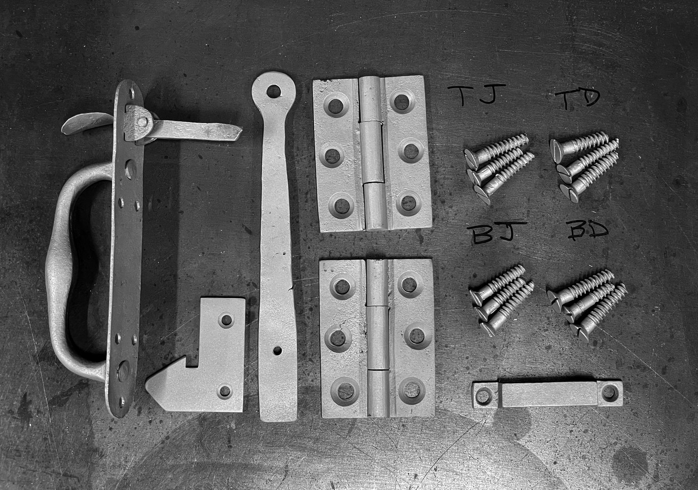

Cleaning some of the fixings.

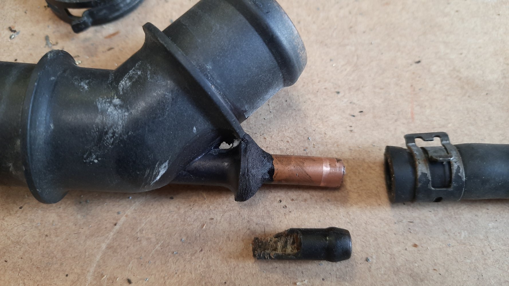

We did the bottom seal on the VW LT35 the small pipe on the plastic housing broke off so i drilled a hole in what was left then used super glue to fix in a bit of 8mm copper pipe and added some baking soda and glue as a shoulder to help it. View attachment 402385View attachment 402386
I would have done but i could not find an olive, i have also used a yorkshire coupler if itas a bad fitHello, I've done similar repairs on my DS, I always solder an olive near the end of the copper pipe to stop the hose popping off.

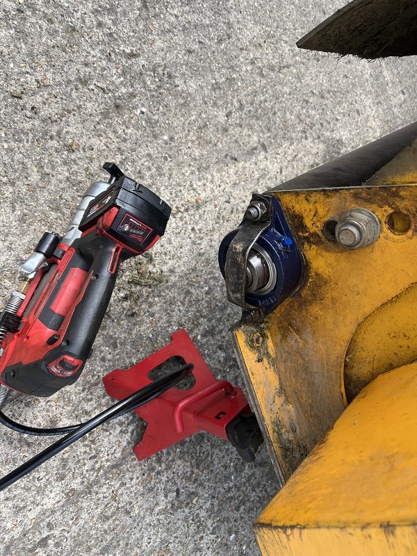

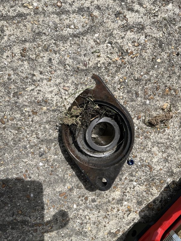

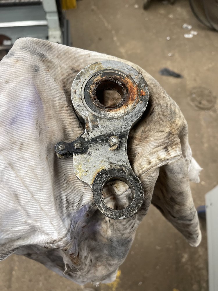

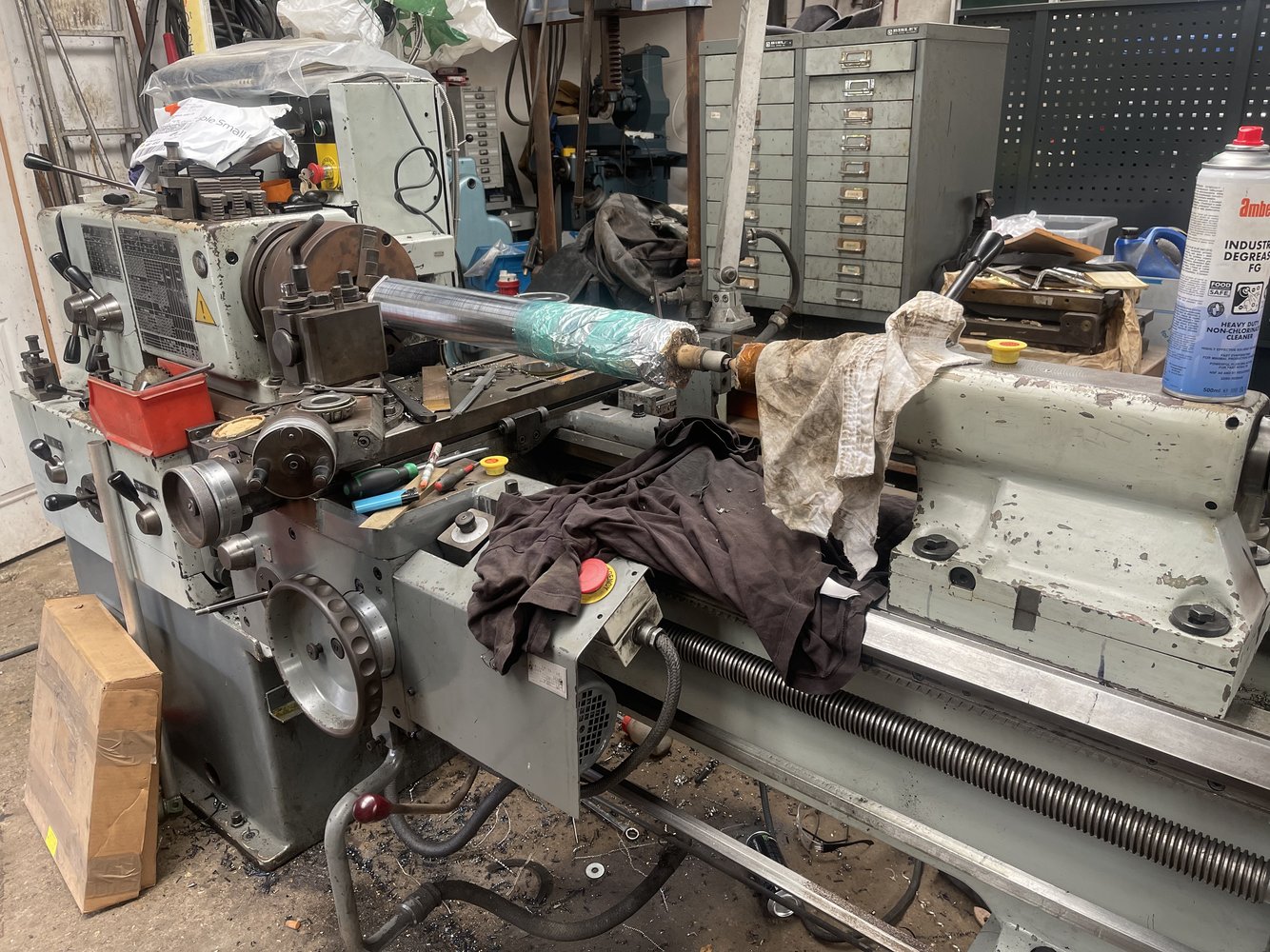

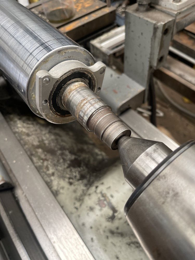

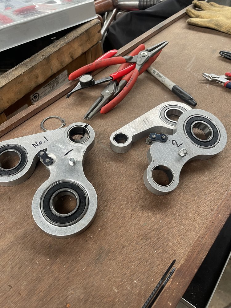

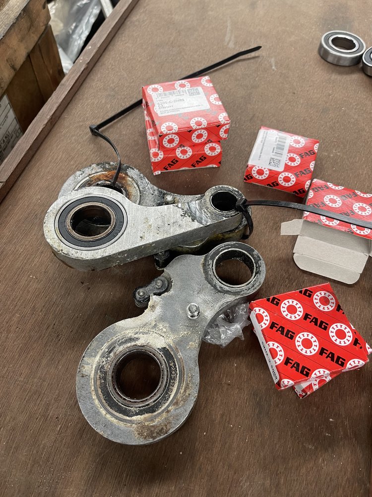

Looks as new again, nice.A long day! Bearing replacement and shaft repair on a piece of bakery equipment
View attachment 402528 View attachment 402529 View attachment 402530 View attachment 402531 View attachment 402532 View attachment 402533

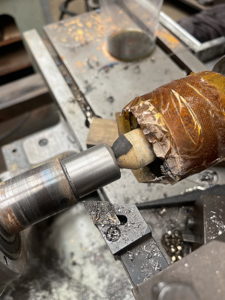

Kapton tape on the live centre to stop powder sticking.Looks as new again, nice.
What's with the tape on the center? And inside the centerhole is black tape?
