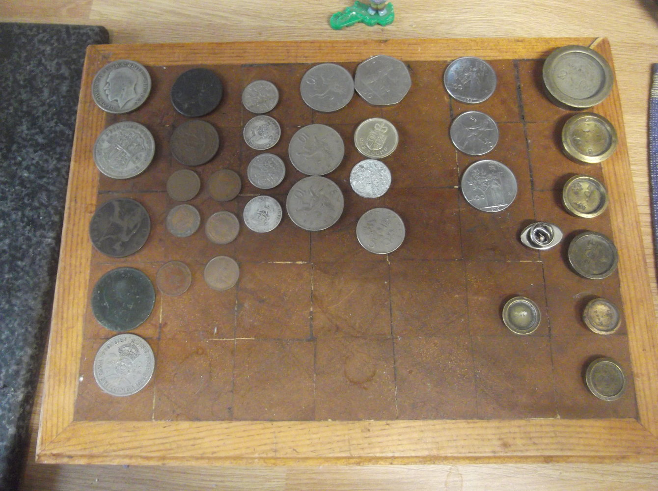

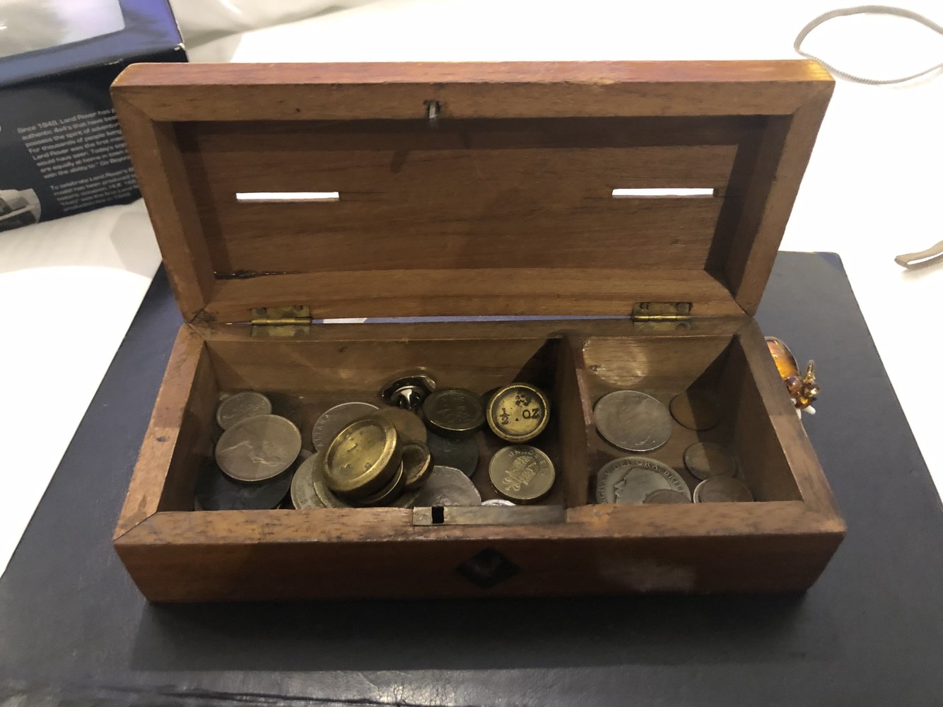

Yes.That 1/2oz weight is missing from a set my wife uses with our Avery scales.

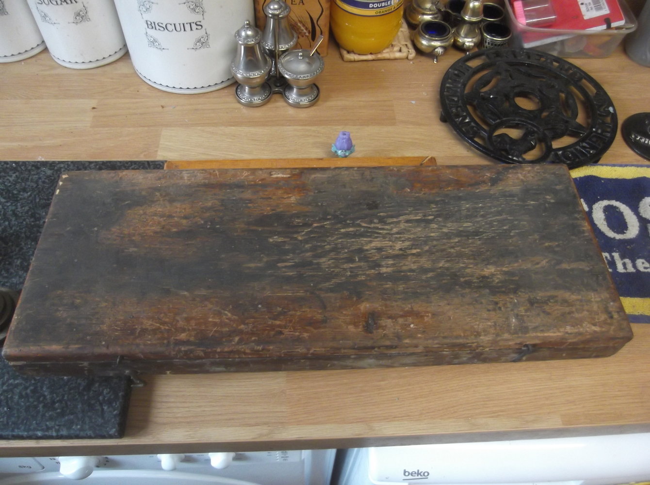

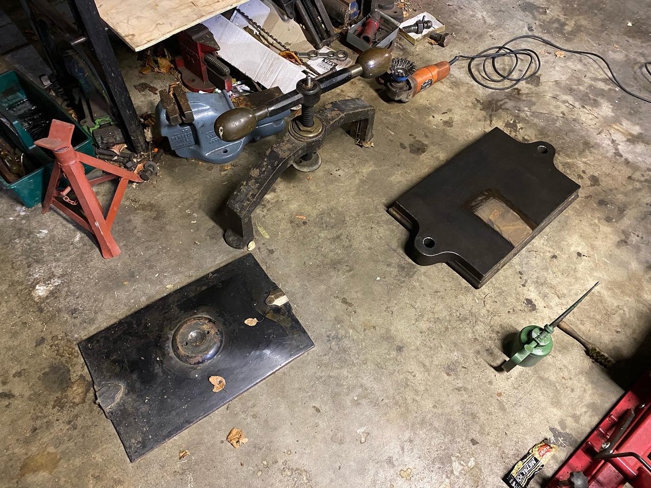

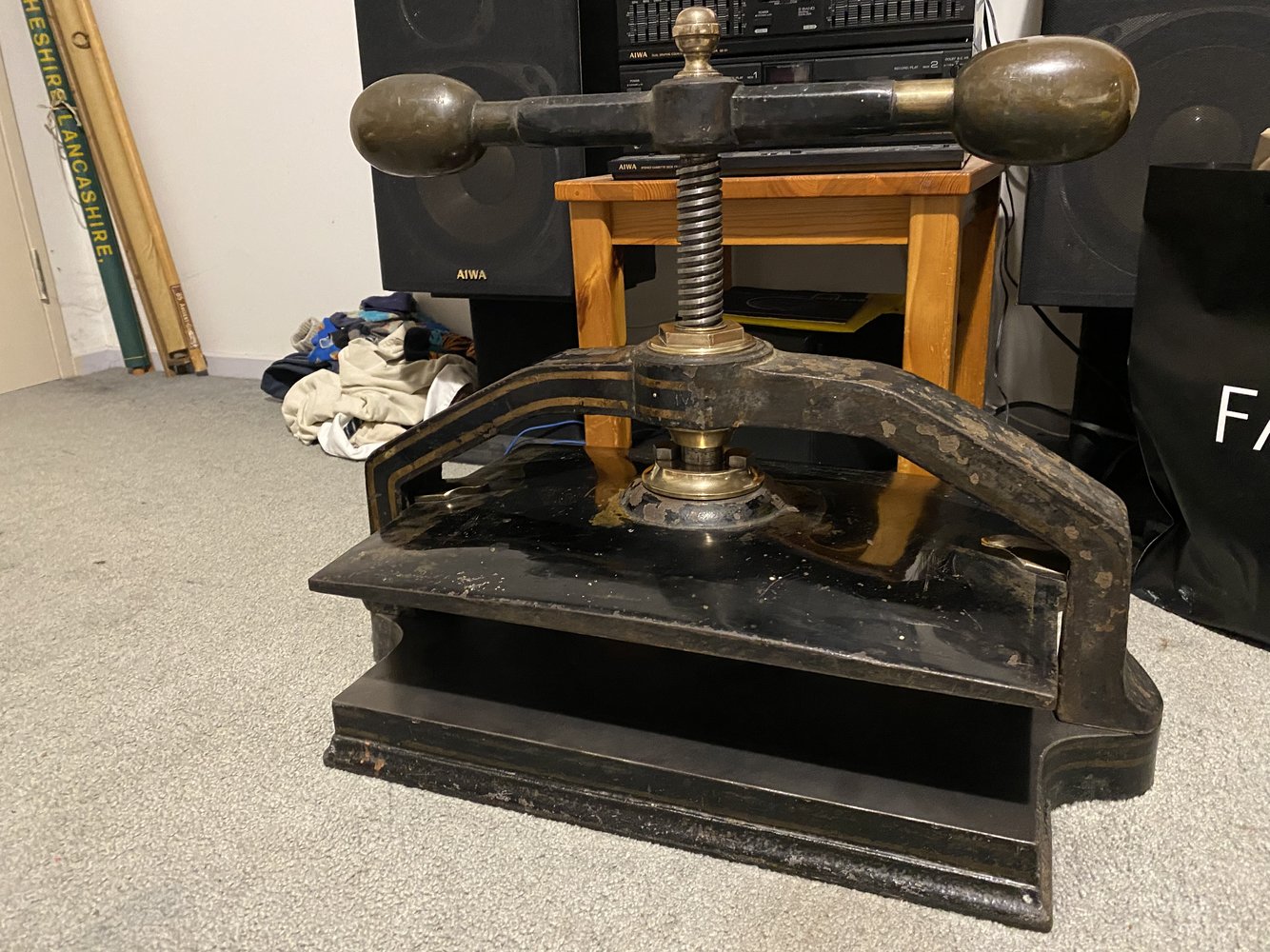

This old book press.....
I wonder if it might be an old letter press from the days pre carbon paper, often found in legal or bank offices.
I know the feeling. Whenever I finish something all I need to do is look down and find something else to do - projects awaiting their turn everywhere! It’s bloody heavy I tell youI have one that's identical. It's actually a copy press for low volume printing. Mine was thrown out by Grayson Perry and is now languishing in the garden, in bits, until I get a Tuit
