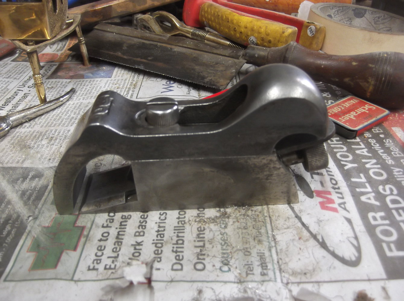

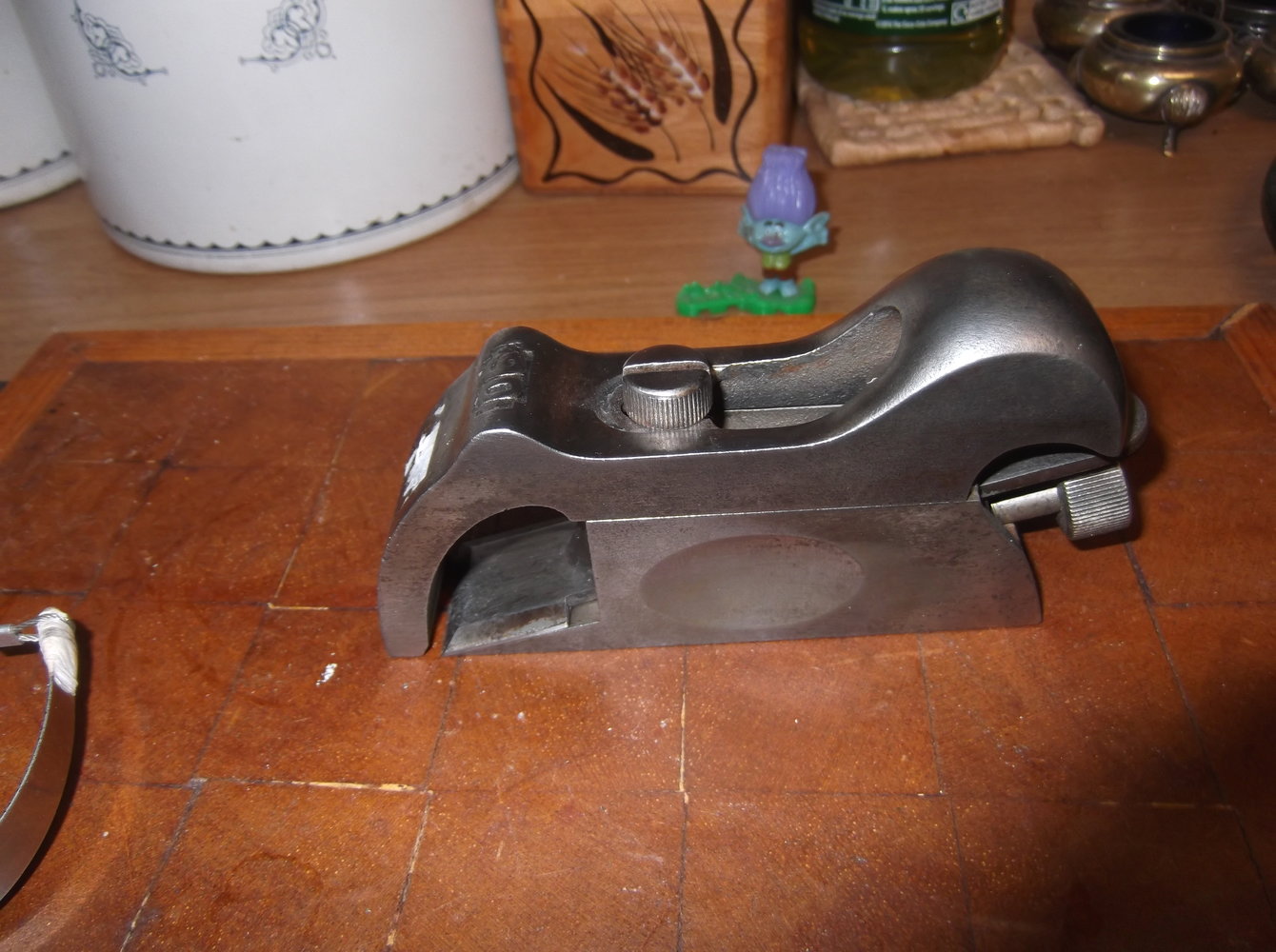

This plane was brought for a friend.
Little did I know, when I handed over the cash it was hidding an issue or 2.
The mouth adjusting screw thread was all bit striped out and the blade was bent.
I struck lucky. A local collage teacher said he would have a go a repairing the thread. It was mounted in a Mill and machined up a size. He then a inserted and it was chilled and the body warmed. It was pressed into place, the tapped to the correct size.
The blade was heated to cherry red, then pressed flat. I then tempered it and polished it up.

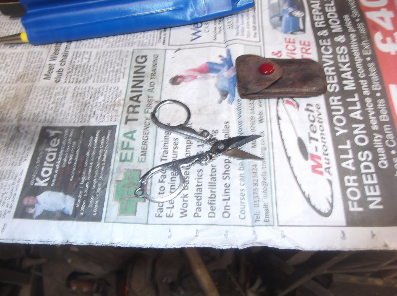

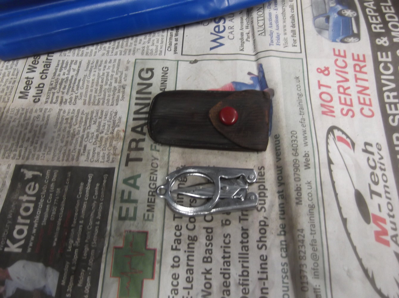

This pair of scissores were bent, that made them very hard to open.
Drilling out the rivets and bending the frames true.
New rivets were made from nails and cold riveted. The case was treated with leather cream.

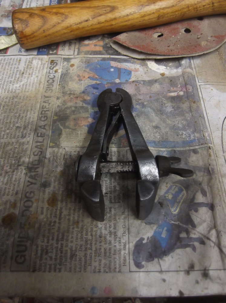

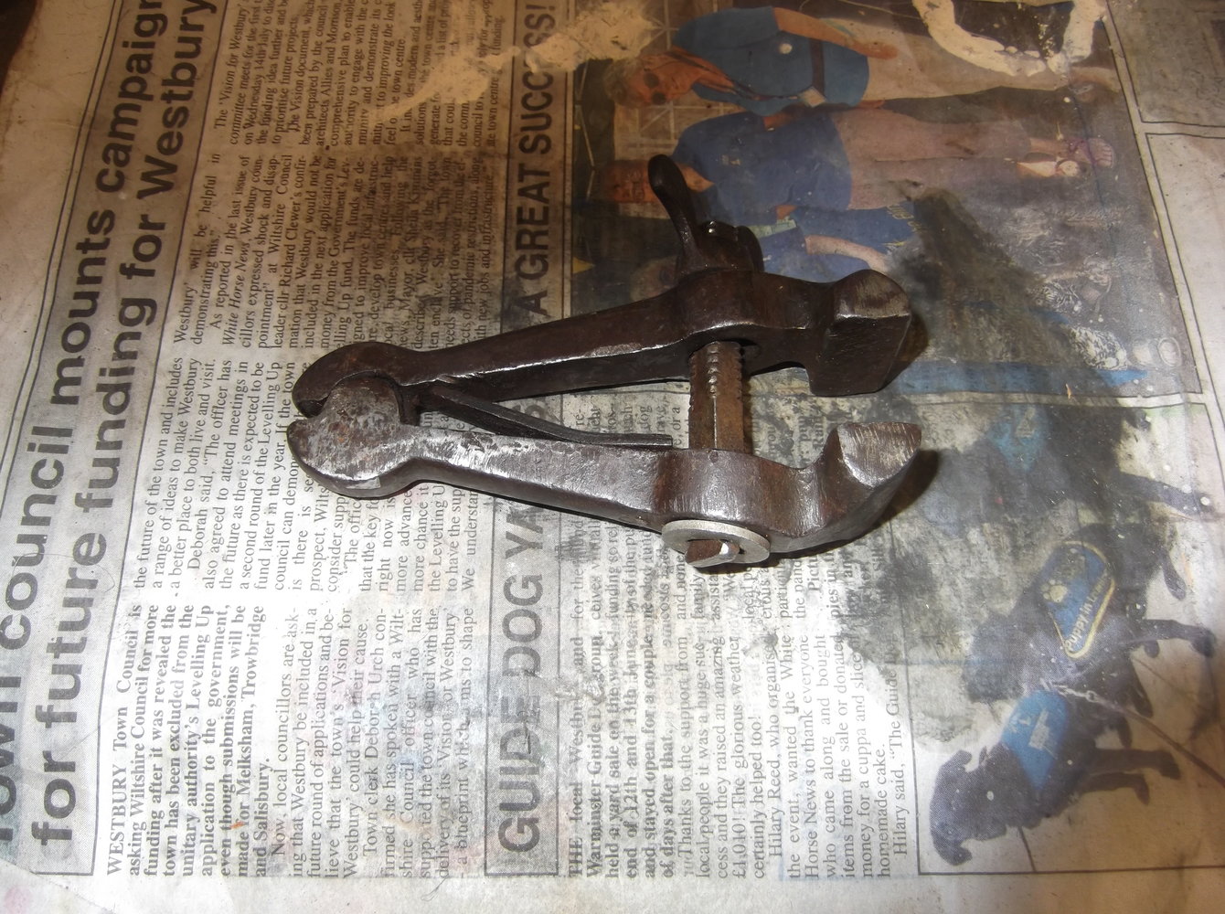

This hand vice was just in need of a clean up.
Hot citric acid, then a good dry on a hot pate.
Then a wax/oil mix.

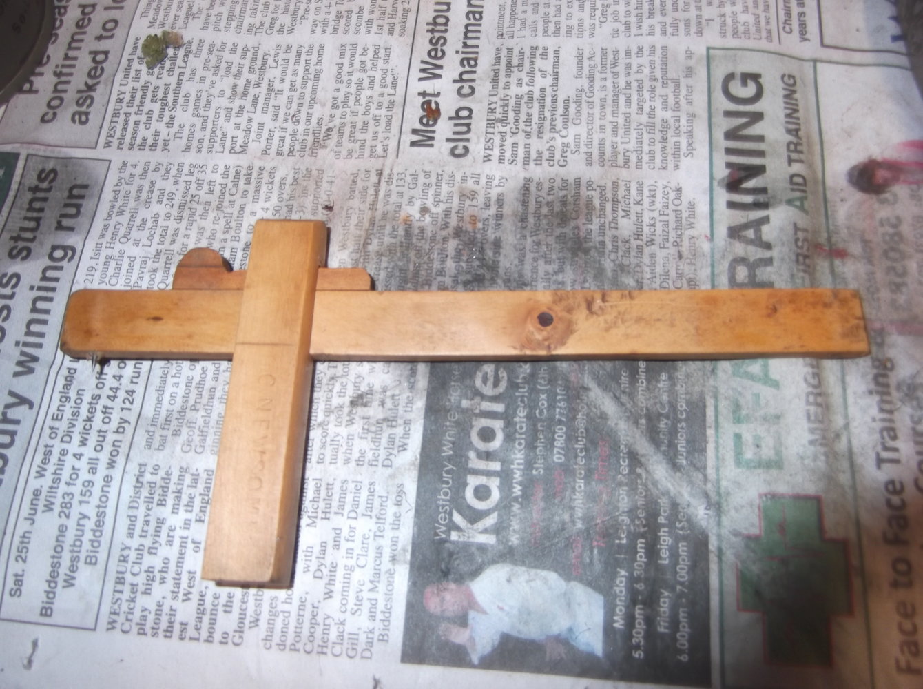

The same oil/wax mix was used on this marking guage. It has showed the Box wood grain a treat.
