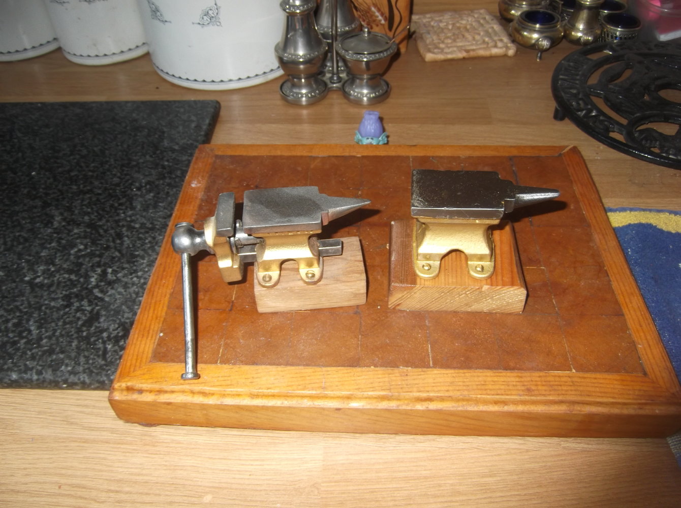

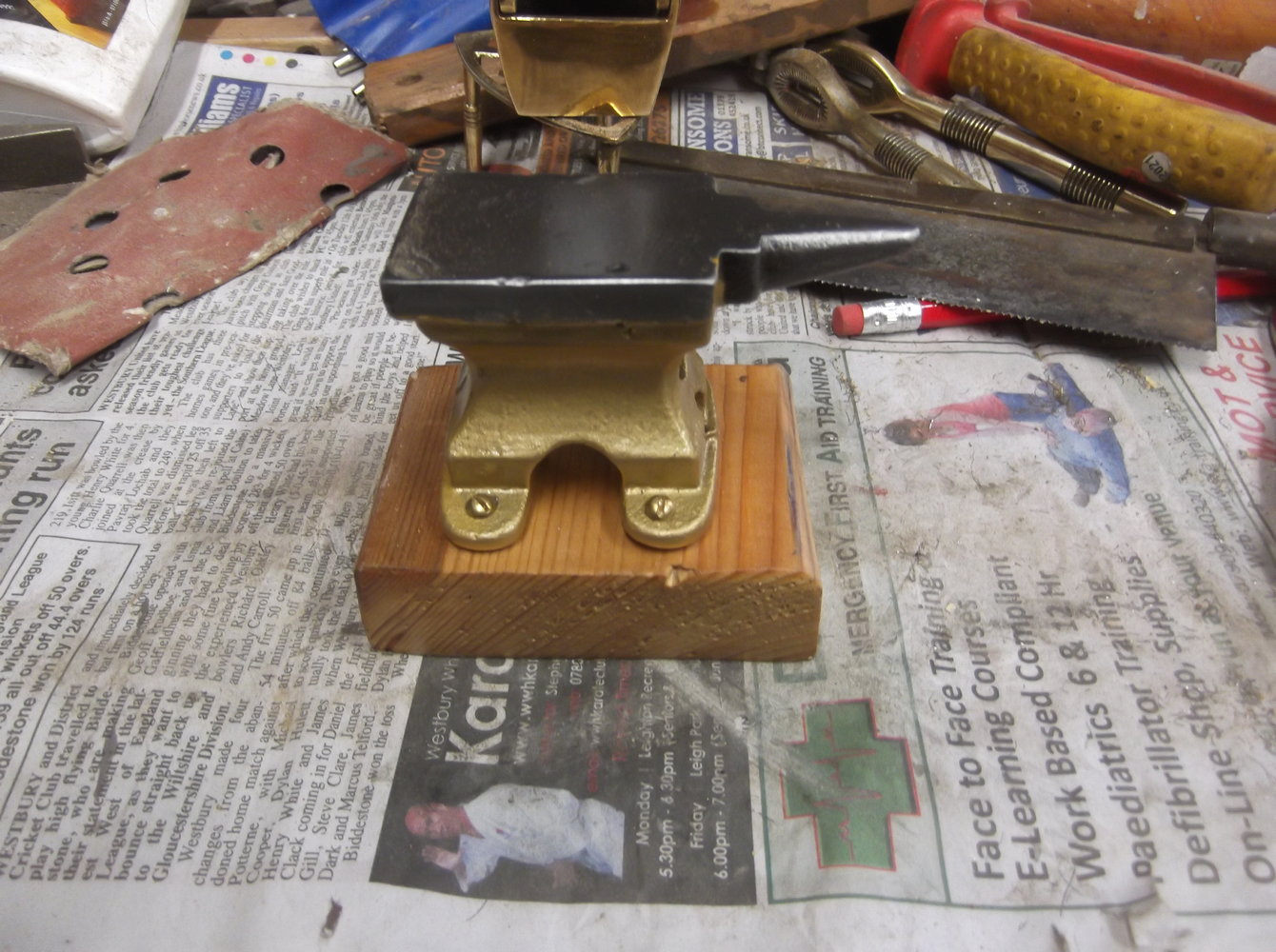

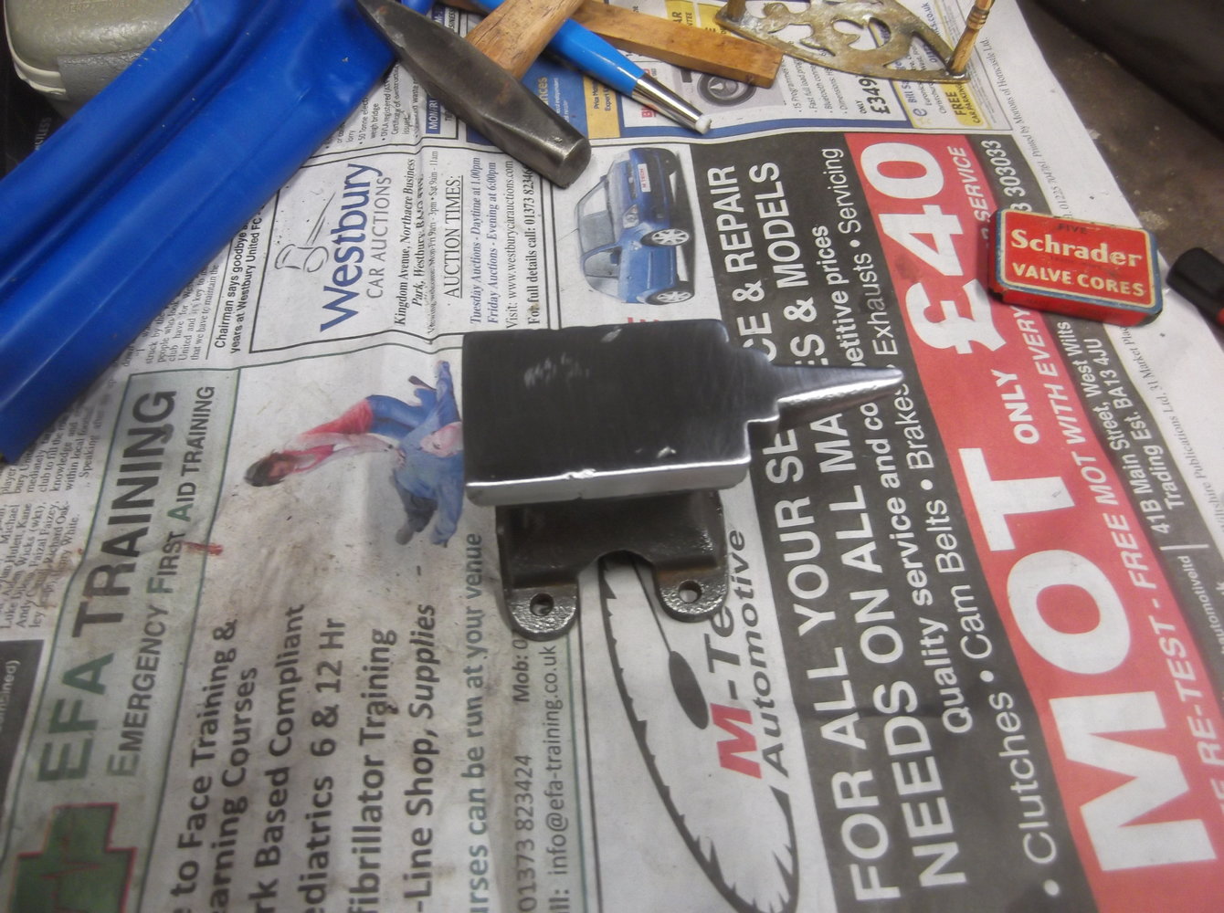

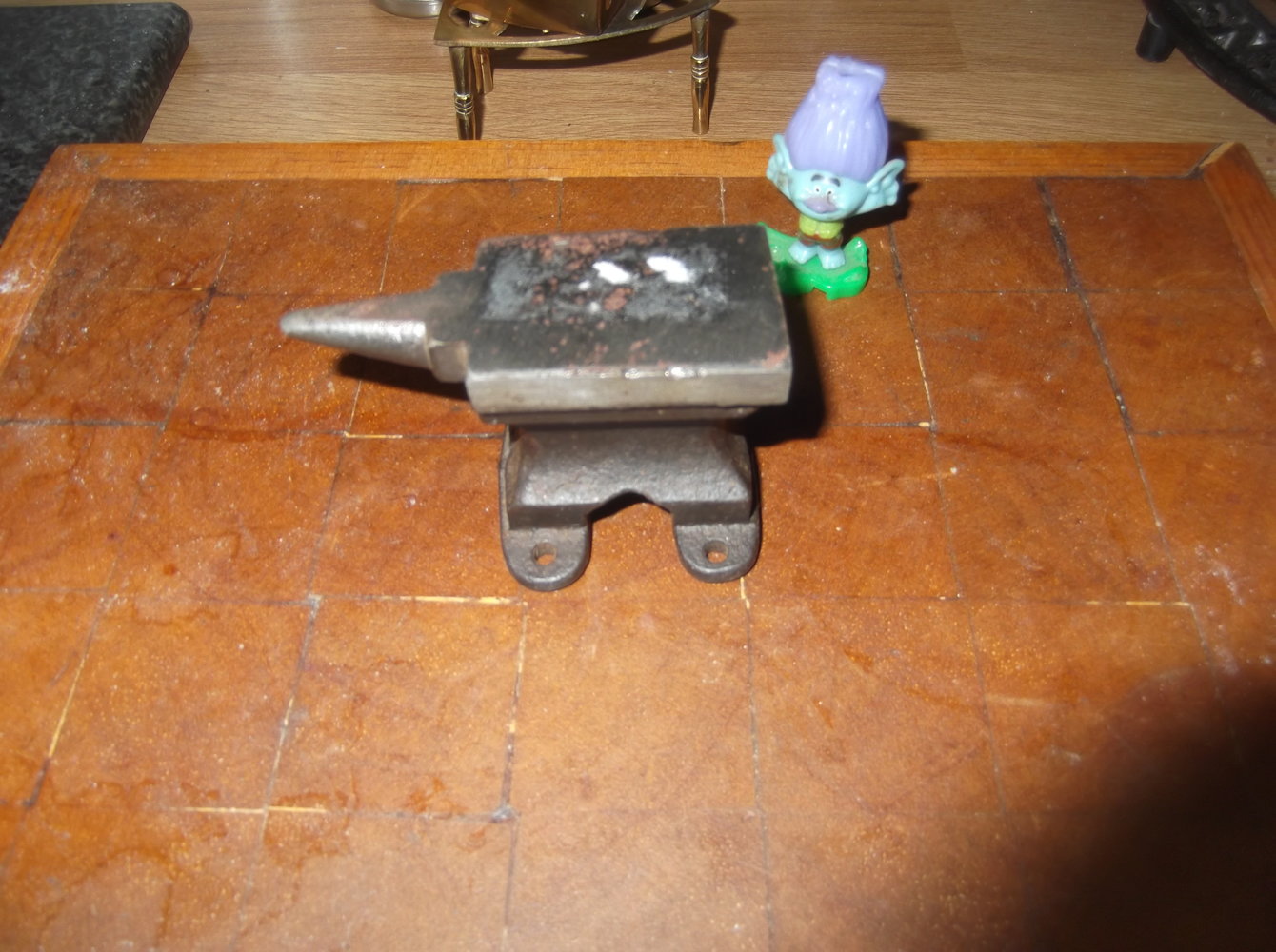

This smal anvil.
Into this, a bit of a clean.
Bit of gole leaf.
Bit of wood.
As well.
But not a pair.

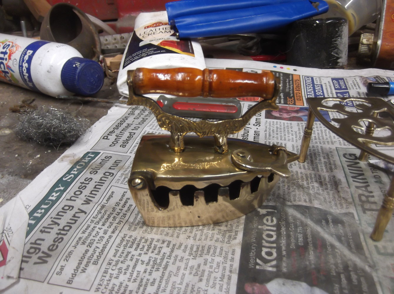

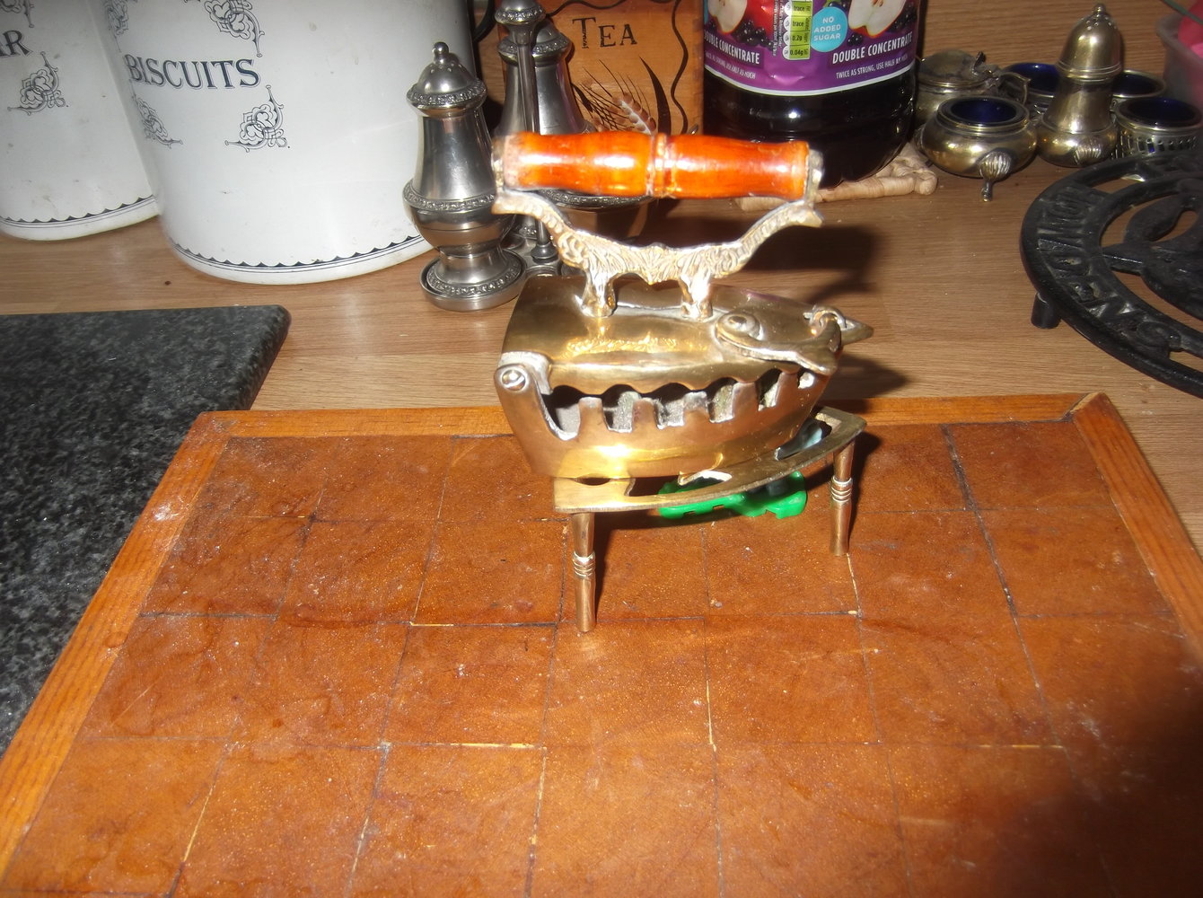

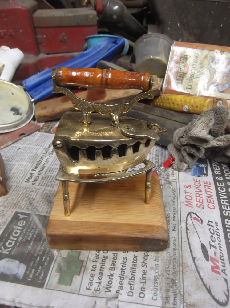

Tidy Tie iron. But I knew it needed some TLC.

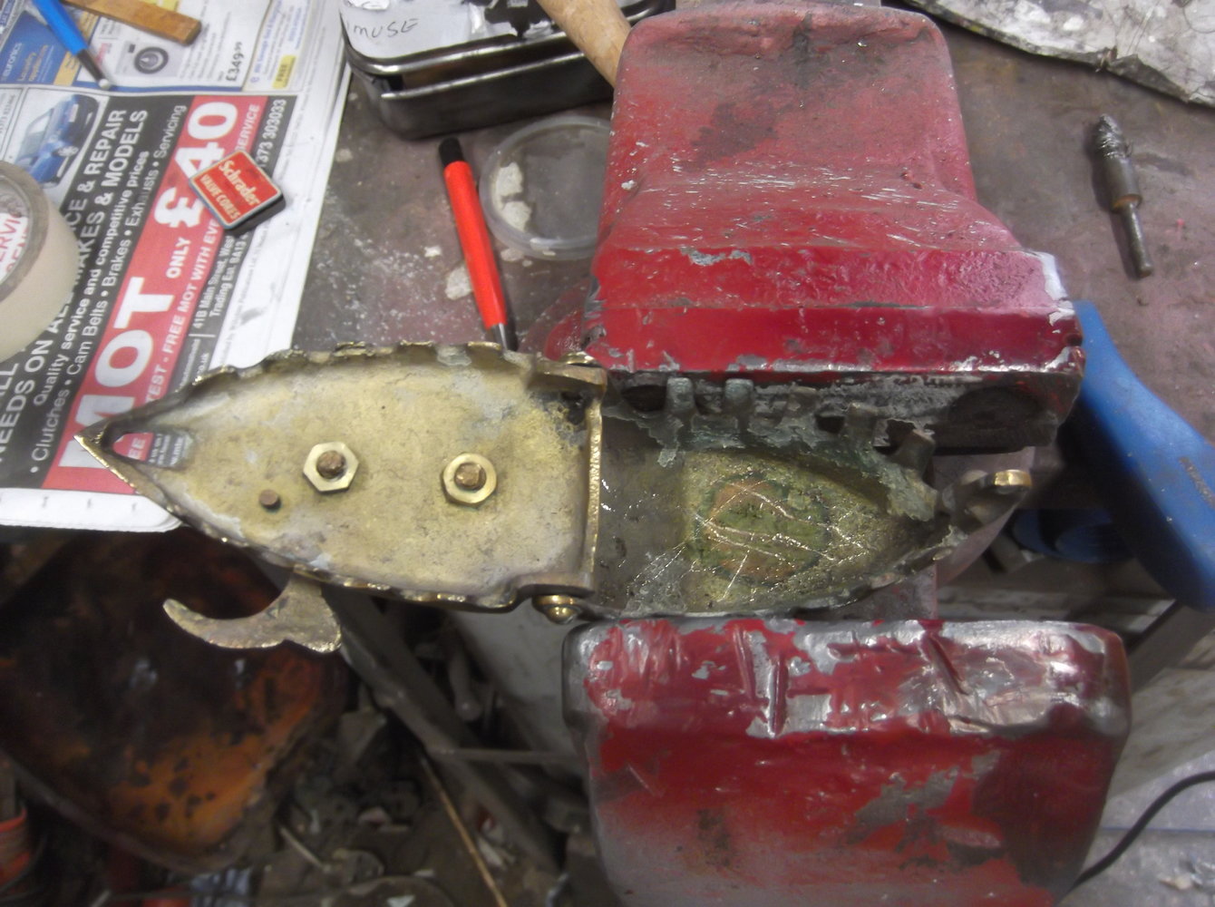

Job 1.
Fixing the handle correctly. Not with some glue.
Made up some pins from some brass bolts. Silver soldered into place. Open the holes up and fitted the handle frame with nuts.
Job 2.
Remove, clean and fix the handle. I saved the saw dust. Mixed it with quick 2 pack glue. Filled the splits. Sanded and polished with light brown (tea) french polish.
Then make a bit of wood look good to show it of on.

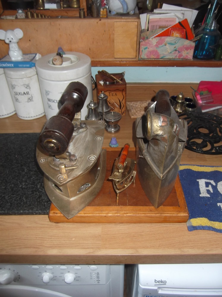

Playing with the big boys.

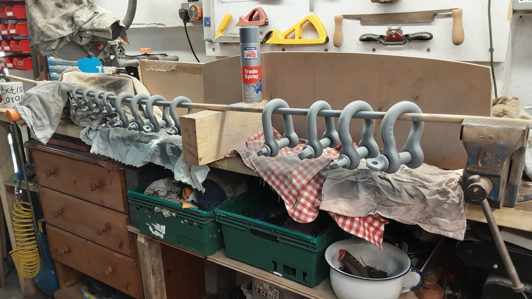

Next task is to give them a top coat of something hideously lairy such as girlie pink that will ensure the magpies leave them well alone.
I suspect it's all down to how they feel they want to identify at the time of stealing them .Don't go with pink. Seems to attract them to being borrowed. I tried that once, thinking no bloke, (bar me), would be seen dead with owt pink.![]()

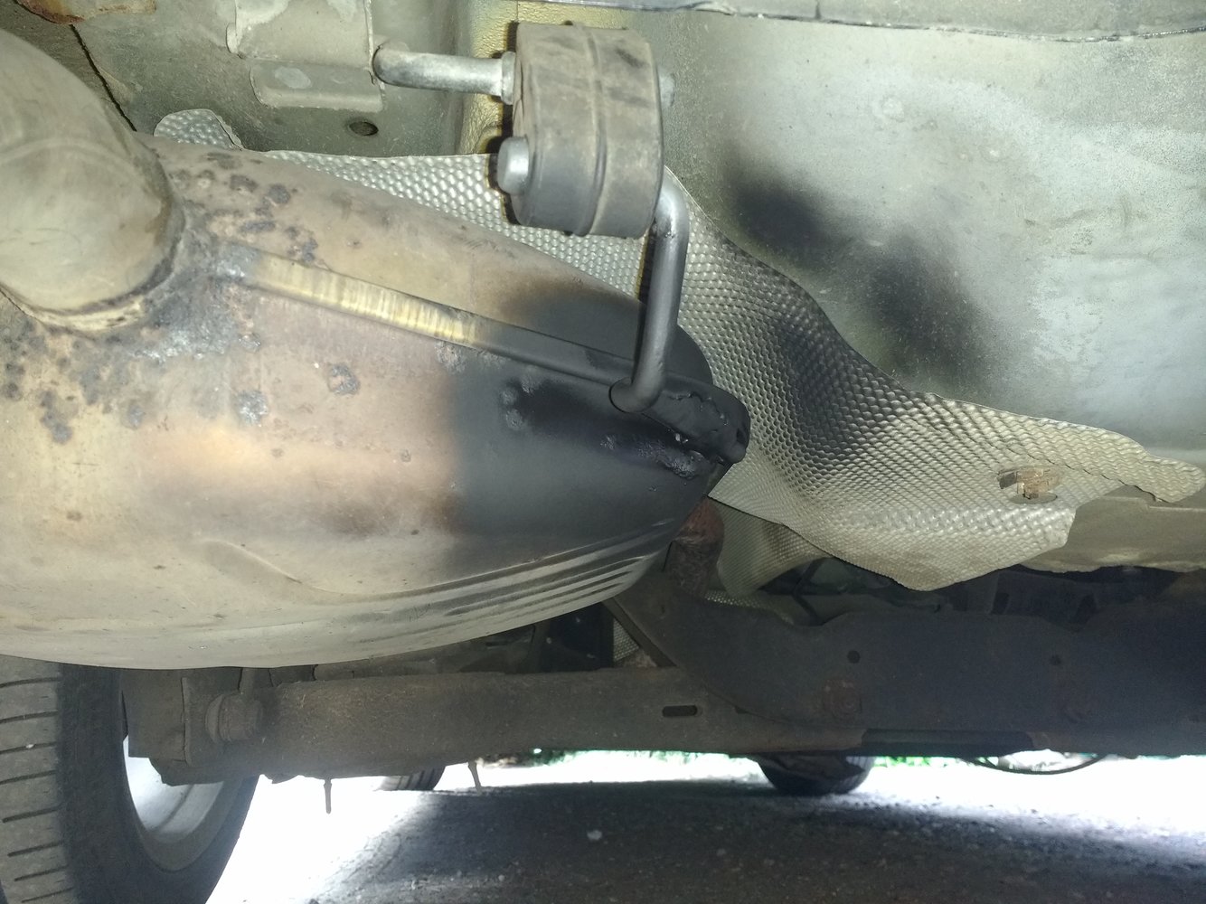

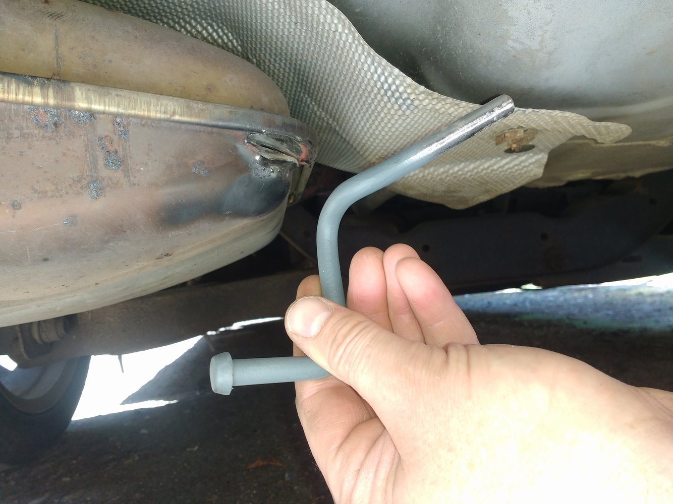

The Mondeo developed a clunk. I thought suspension but no it was the exhaust hanger bracket broke off the back box!

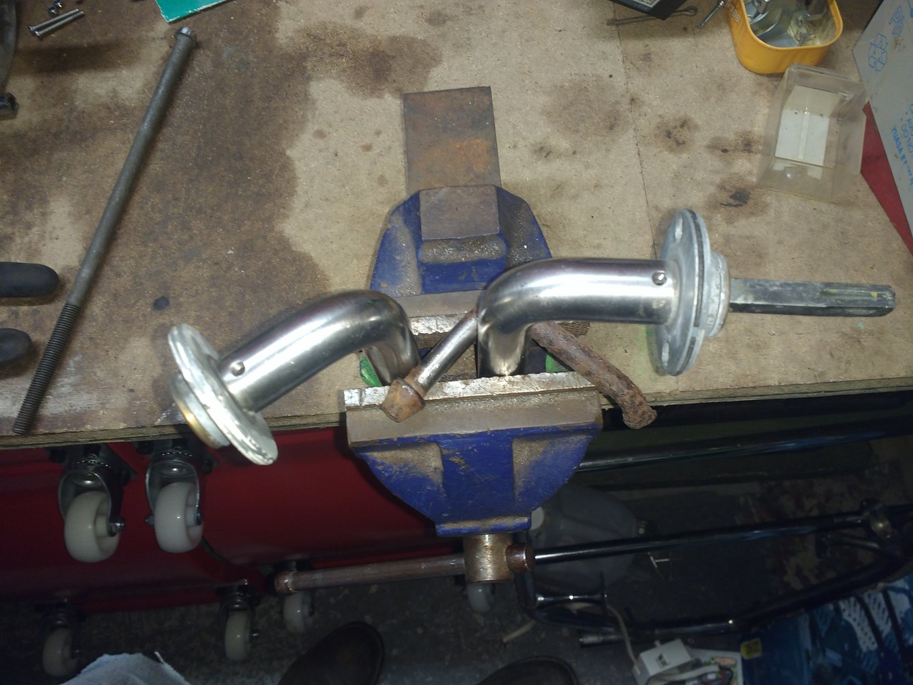

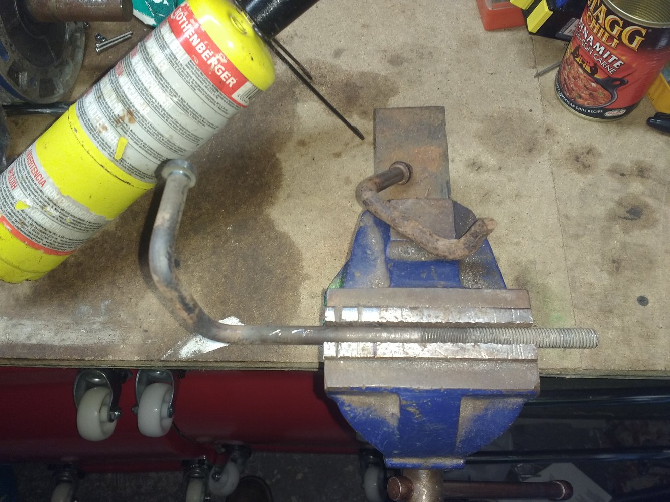

Got a stack of these M10 black bolts so I ground the head conical, something akin to the original hanger:
Some MAPP gas and a couple of solid door handles for a former:

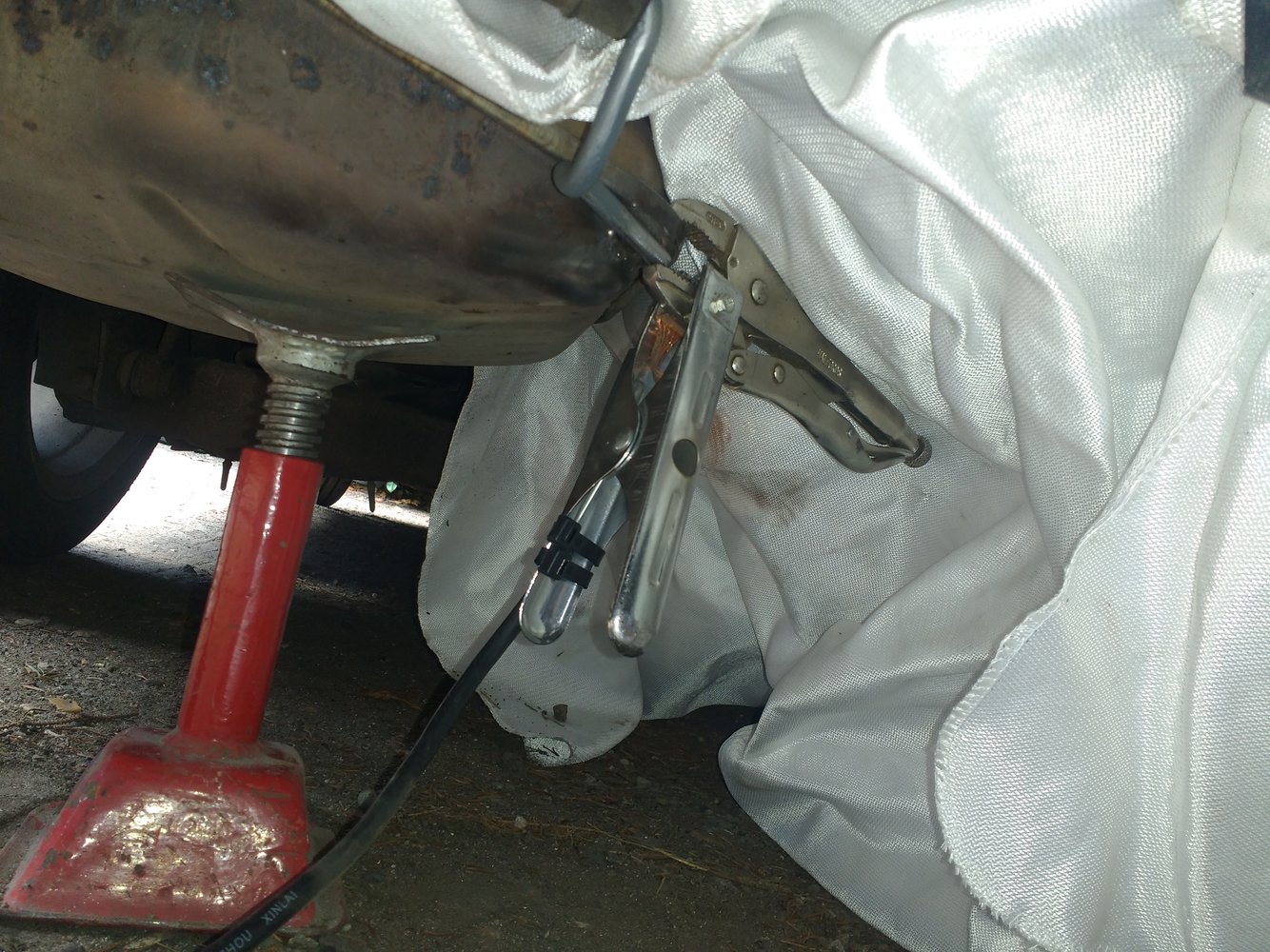

New hanger formed and painted, old weld ground out. Nearly ready to weld:
That ingenuity

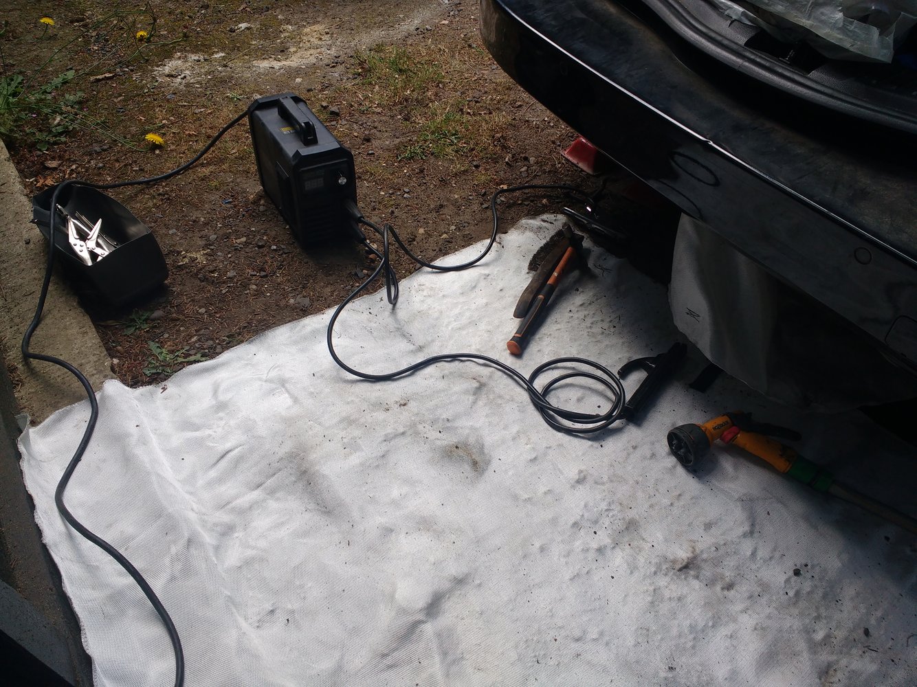

They’re stillage feet. I may steal that idea.Welds ground down and sprayed VHT black to hide the embarrassment. (I wonder if you can get grey VHT?) She ain't pretty but she'll hold Captain! I didn't jack the car up, just sort of wedged me and the Parkside diddy 140A inverter under there and did it from the side/below. Ginour helmet.
Incidentally, the red axle stands were given to me. Made by an old chap, ex tank regiment and an incredible engineer. I think these were pallet feet or something from the Bedford plant in Luton, going way back.
Fire blankets, overalls too in this weather!
11/10 for the exhaust! I’d have just put a jubilee clip or a steel Ty rap in it![]()

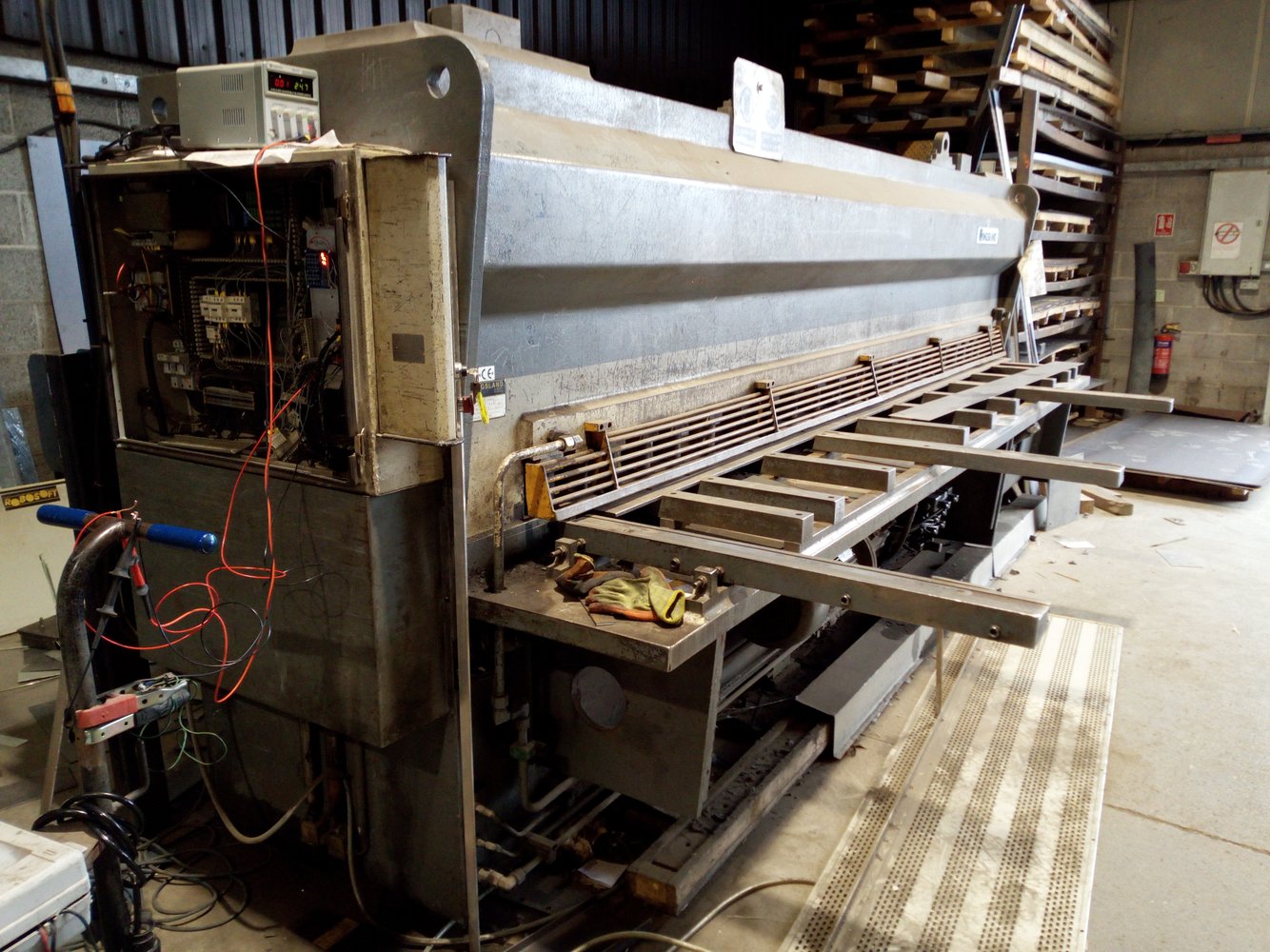

Fixed it again on Friday. One of the contactors (original install) failed which took out a track on my lash up board (2h from starting the design on the computer to fully etched and populated board).This monster
4m cut @6mm
CNC Controller died on it last week so I ripped out the old one and a lash up has been made using some development boards I had lying around and a custom PCB to get them back up and running. Bought myself some time to design and build a proper controller.
Lashed together is the right word because the power supplies I had to hand were not powerful enough so was testing using two old car batteries to flick solenoids and contractors. New DIN rail PSUs should be arriving with me today.
Then to sort out the back gauge.
Doesn't matter, it'll all have burned off by the end of the week if it's anything like any of the VHT stuff I've used in the past.(I wonder if you can get grey VHT?)
