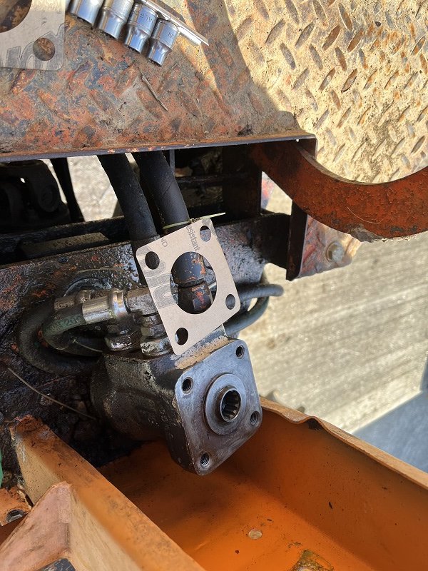

When I worked for Eaton, we made steering valves for thwaites dumpers, on ours the front seal end was removable via a snap ring making a seal change an easy 3 minute job.My Thwaites 2 ton dumper has been leaking for a long time from the 'steering valve'. It's not the original valve but one I rescued from a 'Bank Mower' that I scrapped. Same fittings and mountings but the swept volume doesn't match the steering ram resulting in MANY turns from lock to lock - but heck it works. The leak is from the upper central shaft seal and i annoying rather than debilitating. Slowly but surerly oil leaks into the steering column itself and back out as the column isn't sealed to it's mounting flange.
The proper solution is to strip the unit and replace the seal but life is too short and I'm still hoping to find a proper ex Thwaites dumper steering valve!
So today stripped out the unit from it's mountings, made a few measurements, I fired up autocad, draw up a flange gasket, ported the DXF to my laser cutter, cut a gasket, dragged out an old tube of Blue Hylomar and stuck it all back together.
Early days but so far no leak - I'll wait for the oil to come out of the top of the steering column but I don't think the leak is on the pressure side so it should only fill up to the level in the hydraulic reservoir !

Looks like a Danfoss, the other main manufacturers were Ognibene and Rexroth, who bought out out Hydraulik Nord after the wall came down.Not sure what make this one is - I'll see if I can read it's plate with a mirror but location isn't ideal for this !
Be very nice if the seal CAN be easily changed.
