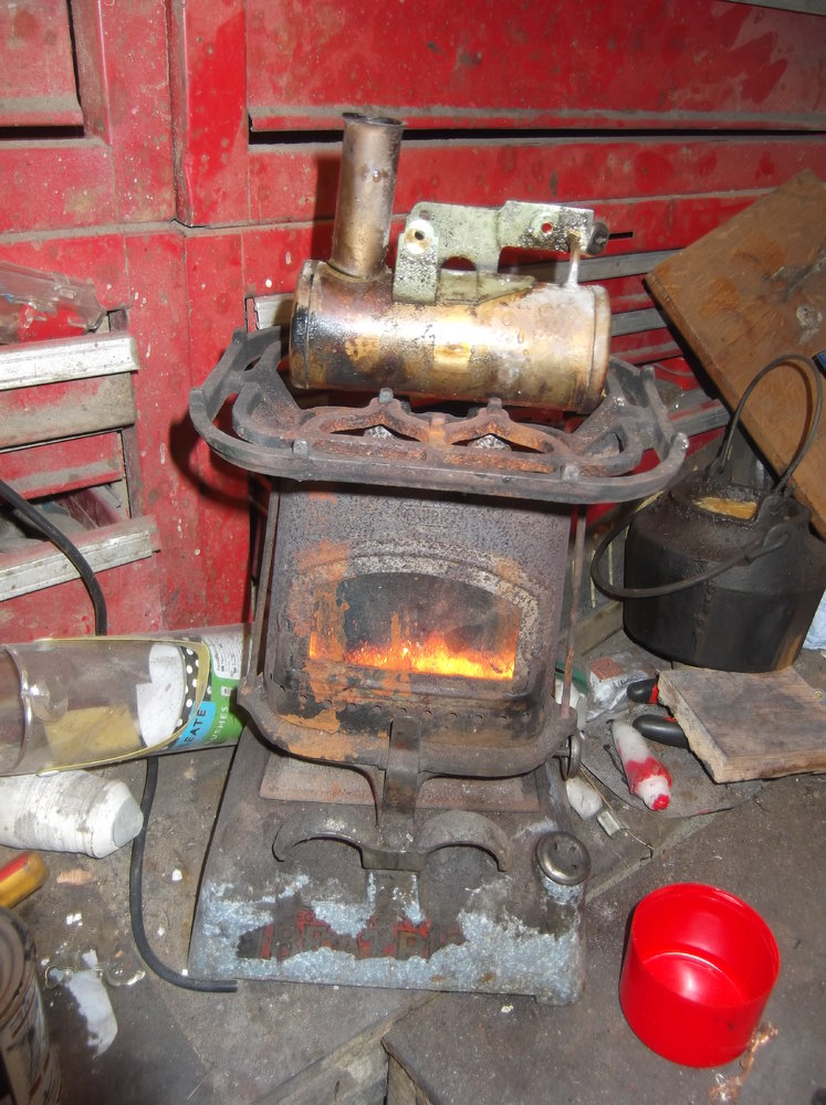

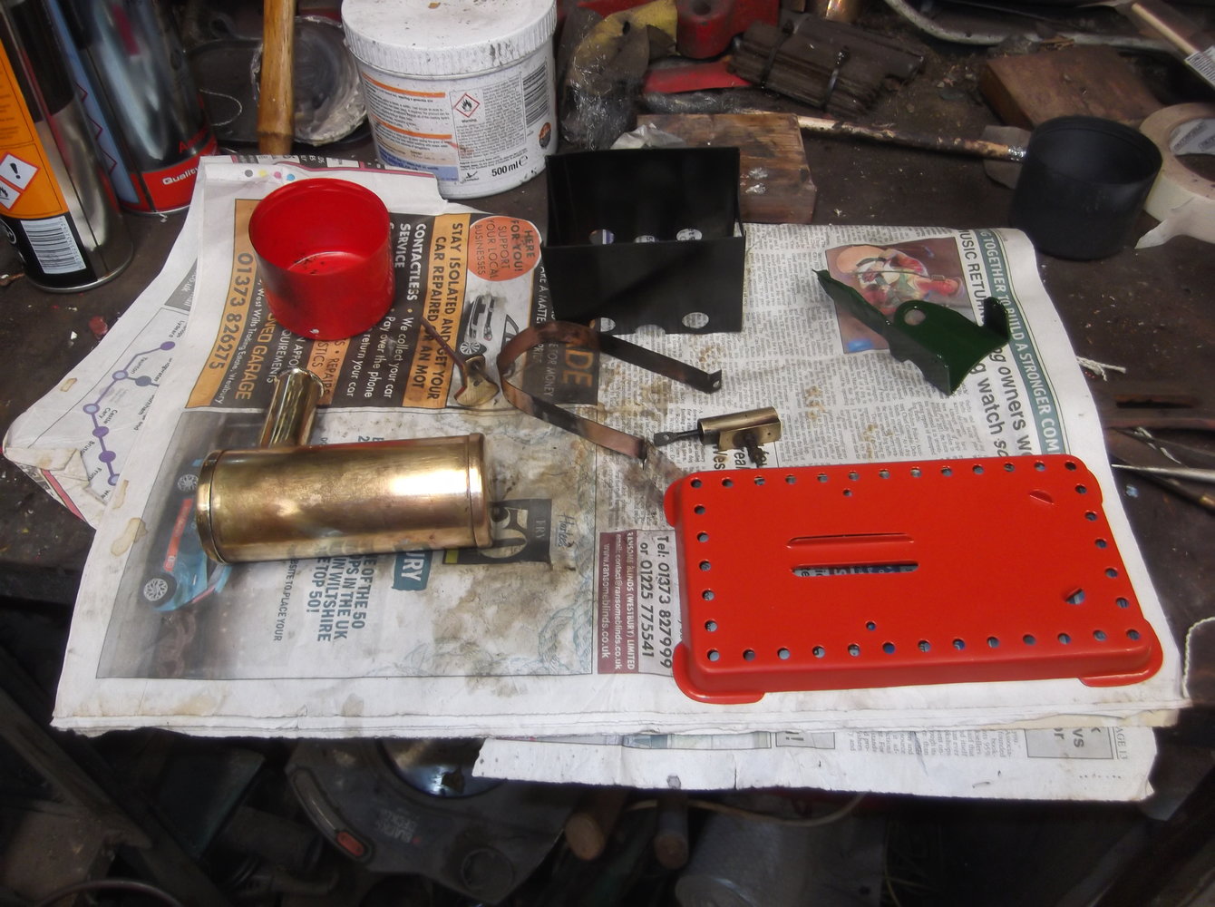

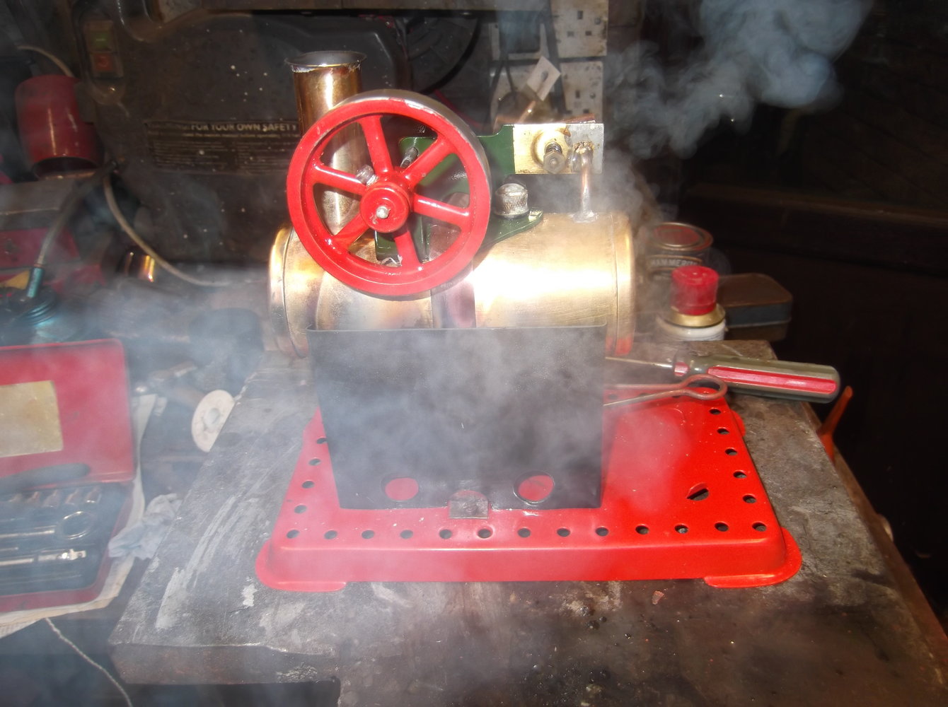

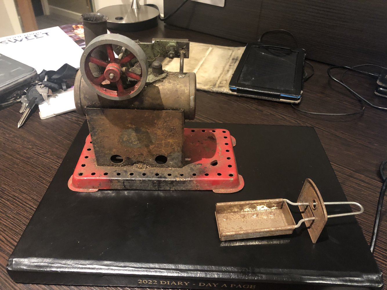

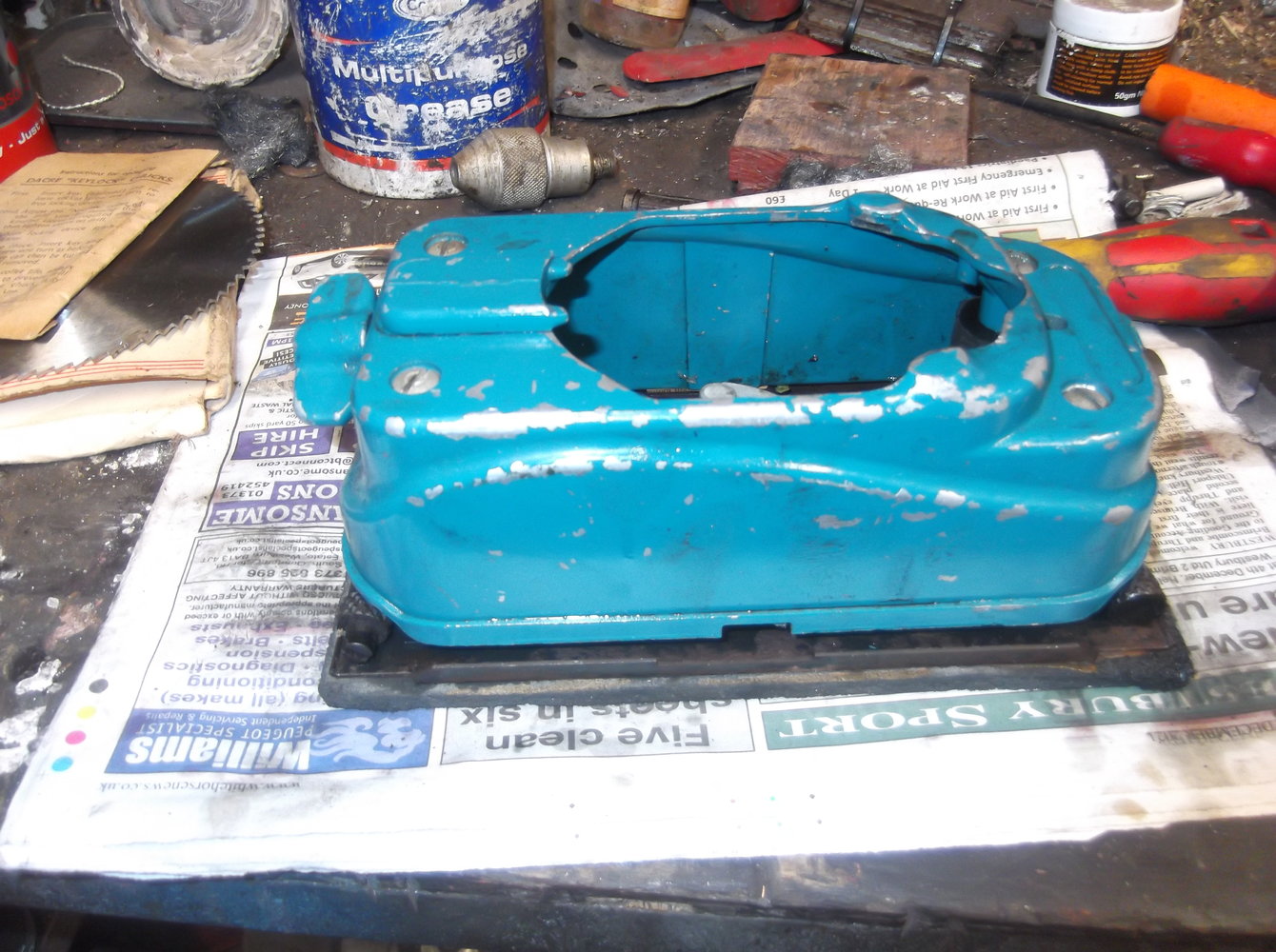

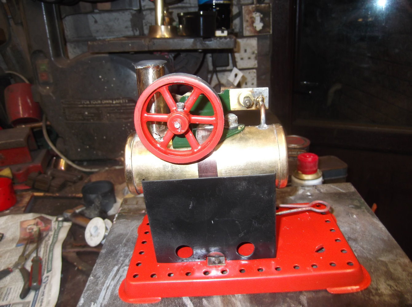

This tired Mamod cam my way the other day.
It needed a lot off attention. Not from abuse. But from a lot of use and the passage of time.

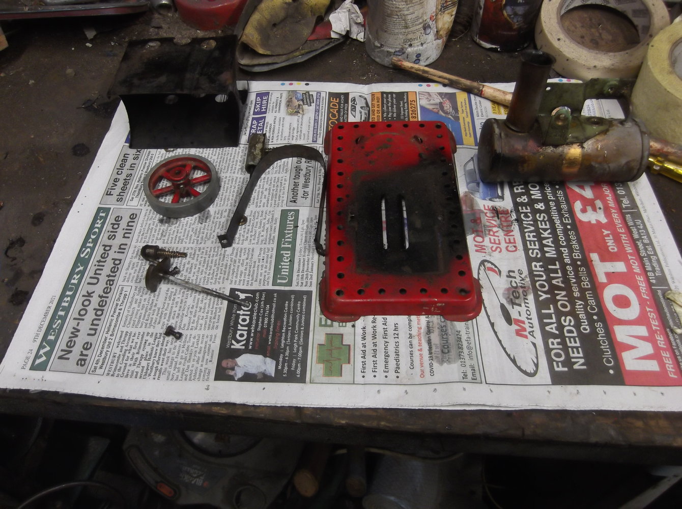

In bits, more issues have come to light.

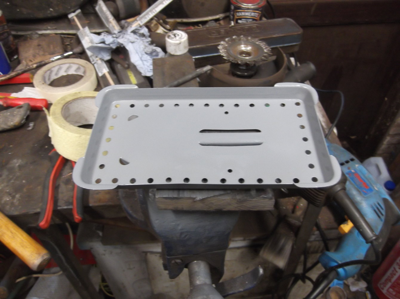

The base was split. Gas brazzing just distorted the frame. So I bribed a friend with Hob Nobs and he tig brazzed it together, dressed the dings and dents out and left it in grey primmer.
De-scalling the boiler.
All ready to rebuild.
The piston and cylinder is badly worn. But replacements of the old style are hard to find. The modern ones just don't fit.

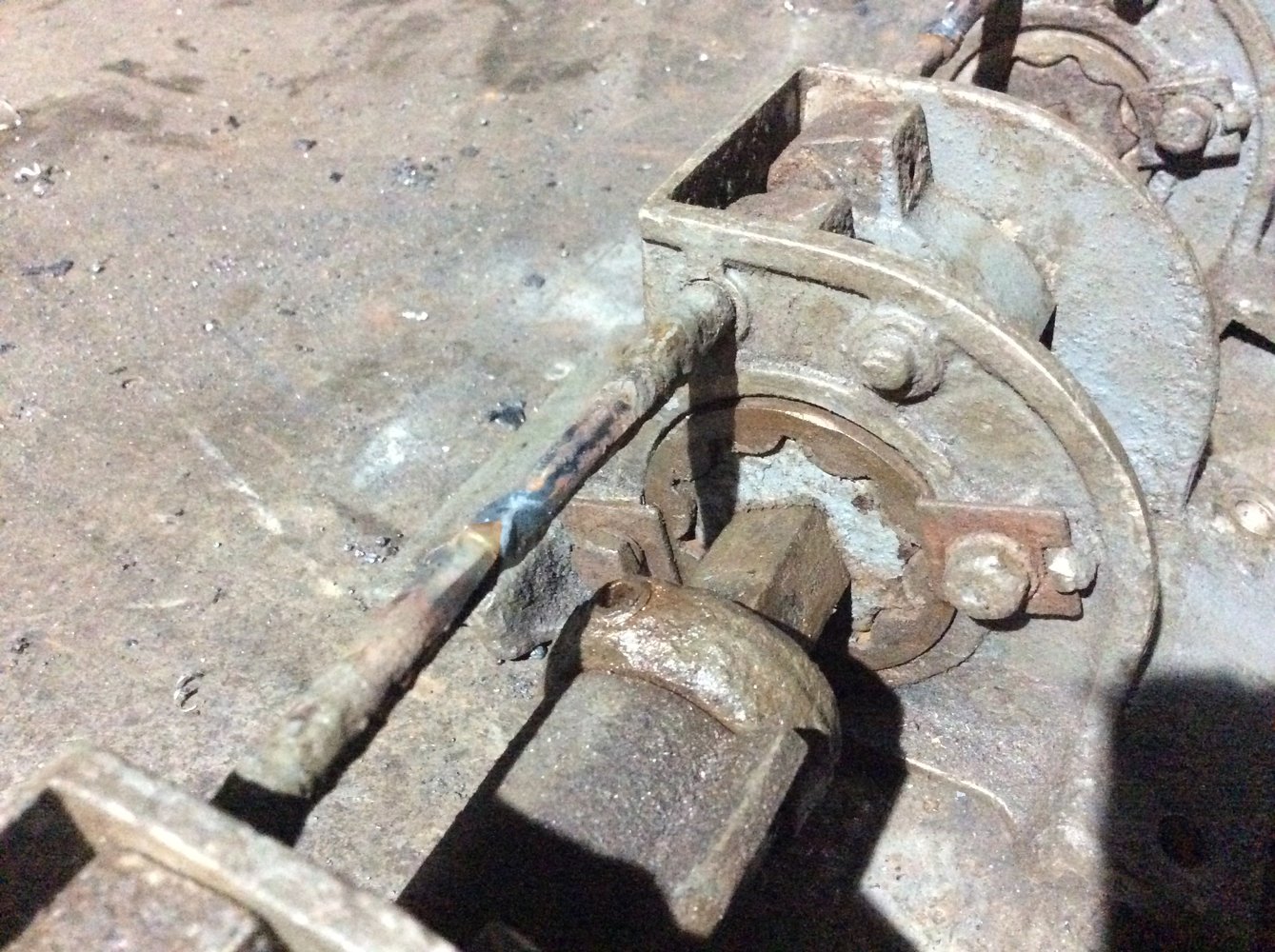

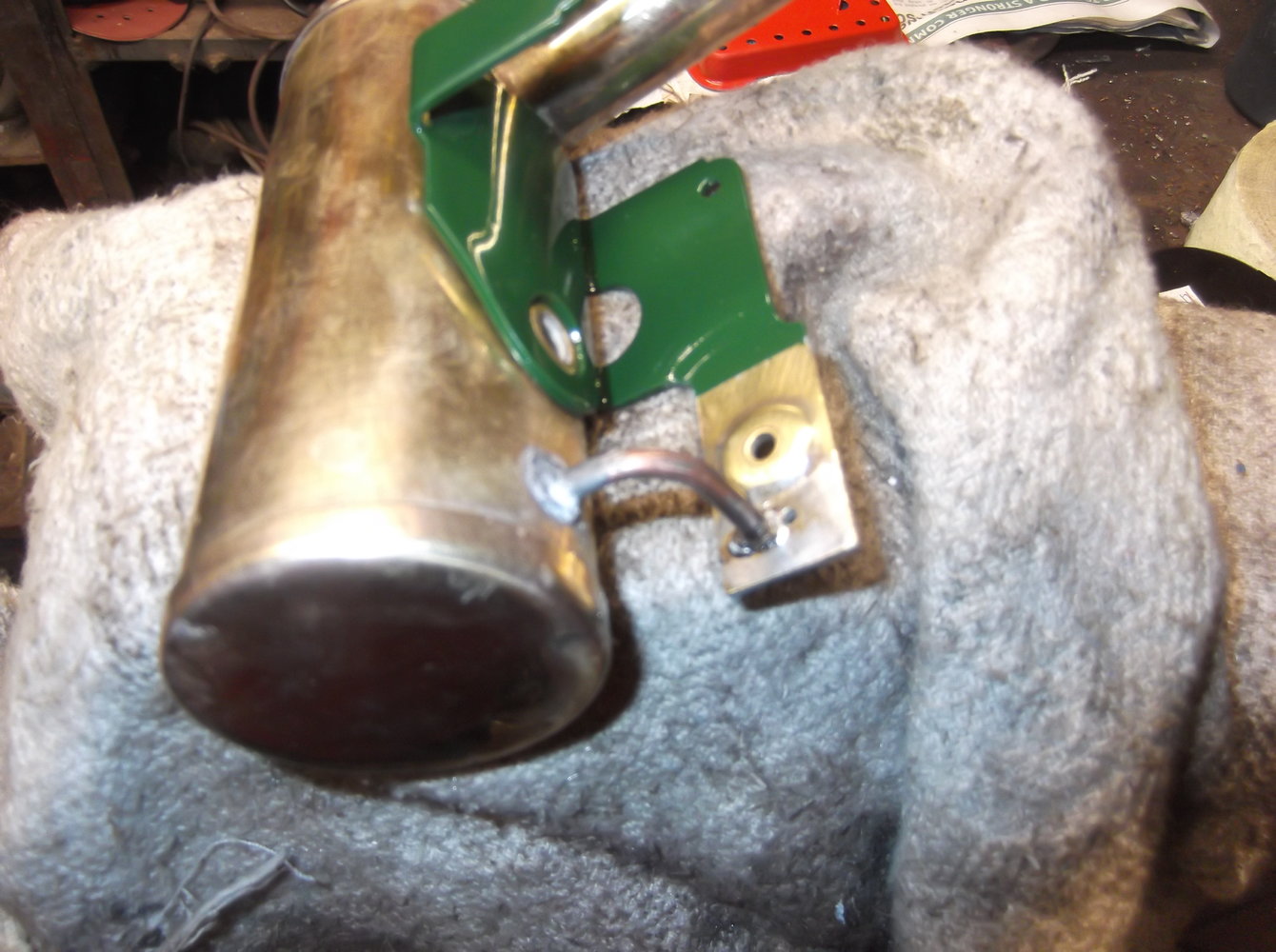

Get the steam pipe repair wrong and it is a pain to rectify.
Get the holes in line. Pin with a small drill to keep them in line. You want the pipe applying a small amout of pressure to the flame. Heat the frame and apply solder to the pipe.
No.
2 tries and I got it right.

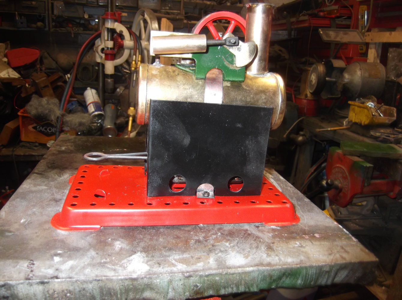

Rebuilt and warming through.
Bum.
A distortion. The whittness mark is not good.

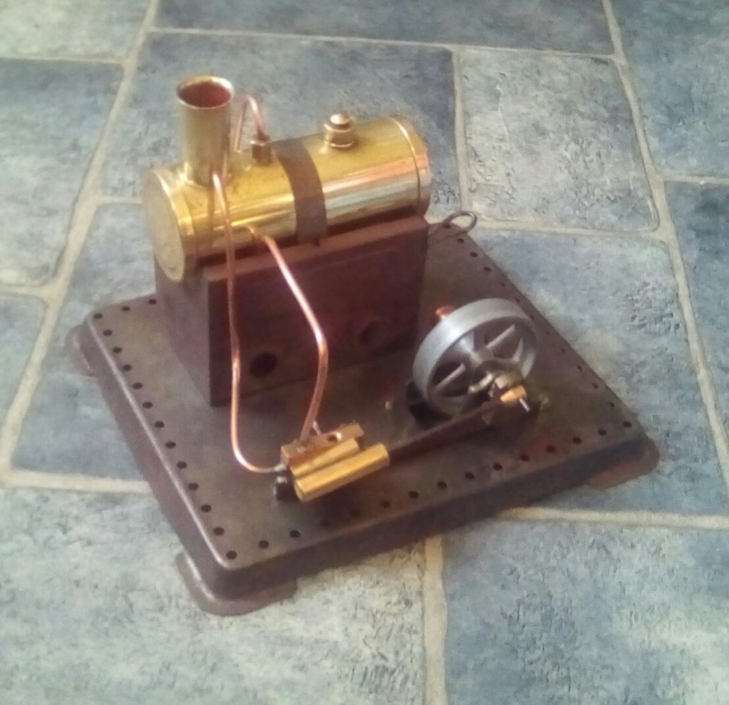

In steam and running.
I tried spraying the base of mine, and like most of my painting attempts, it was disastrous, so I took it off and just "blacked" the base, the firebox and the cylinder/flywheel mount bracket, on the gas stove.. It gives a sort of "olde iron" industrial look to it perhaps
. Still it's an improvement on the wrecked state it was in previously
