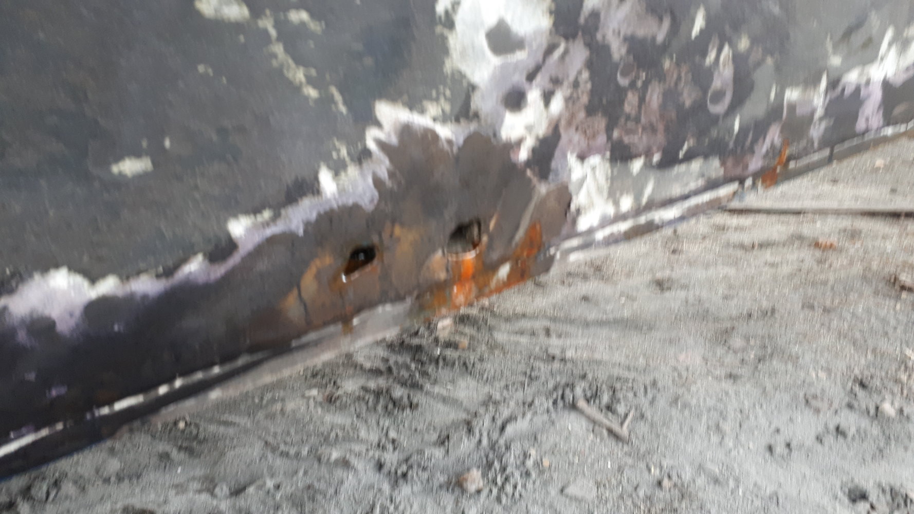

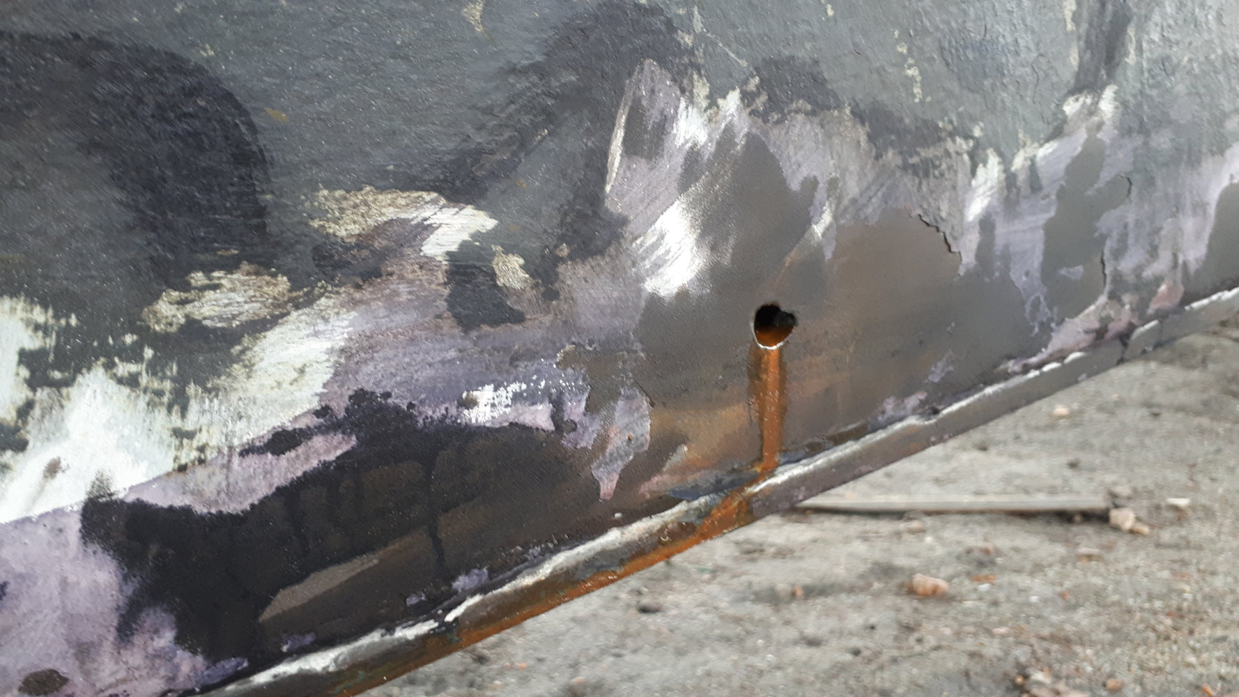

Yes there are holes in the keels now after wire wheeling nut the deck was the main culprit and that's now welded up.No chance the hull's pinholed?![]()
Fill it with water afterwards, and see if any leaks out........No expert, but if you cannot gain accesss to the rear of any weld areas how do you propose to make sure all the welds done from one side only are perfect?
Now thats a man with ferrous spheres ,,,, even I wouldnt try that and Im game for most things , I can certainly see the theory but Id like to see the pictures just the same.The hull needs drying out thoroughly, and the old paint will need to be stripped off anyway, come what may.

No chance of sand blasting it?I think I'll stick to grinders and dehumidifiers for now![]()

I know the joy of what pien ball hammer hitting the side of a 120+ year old hull sounds like!!If you can make a dent with a ball pein hammer lightly held, but swung at arm's length, it is a cause for concern because that's the kind of impact which can often be suffered by hitting floating tree-trunks and so on.
Only just seen this and read the post. You mentioned your ultrasound is working intermittently. That could well be down to internal corrosion affecting the readings. Regarding repair, definitely cut the affected area out and weld in new steel. Overplating although very common in boats is not a good thing. It causes more issues than it cures.I recall that @spaffmonkey welds up steel boats for a living.
