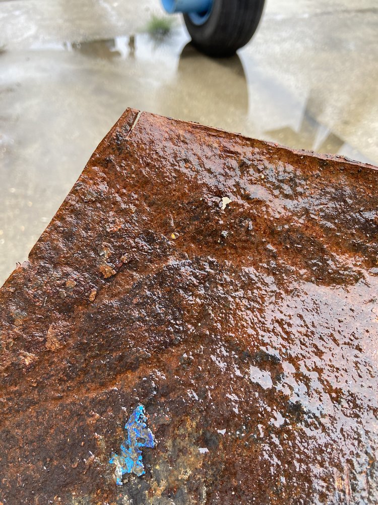

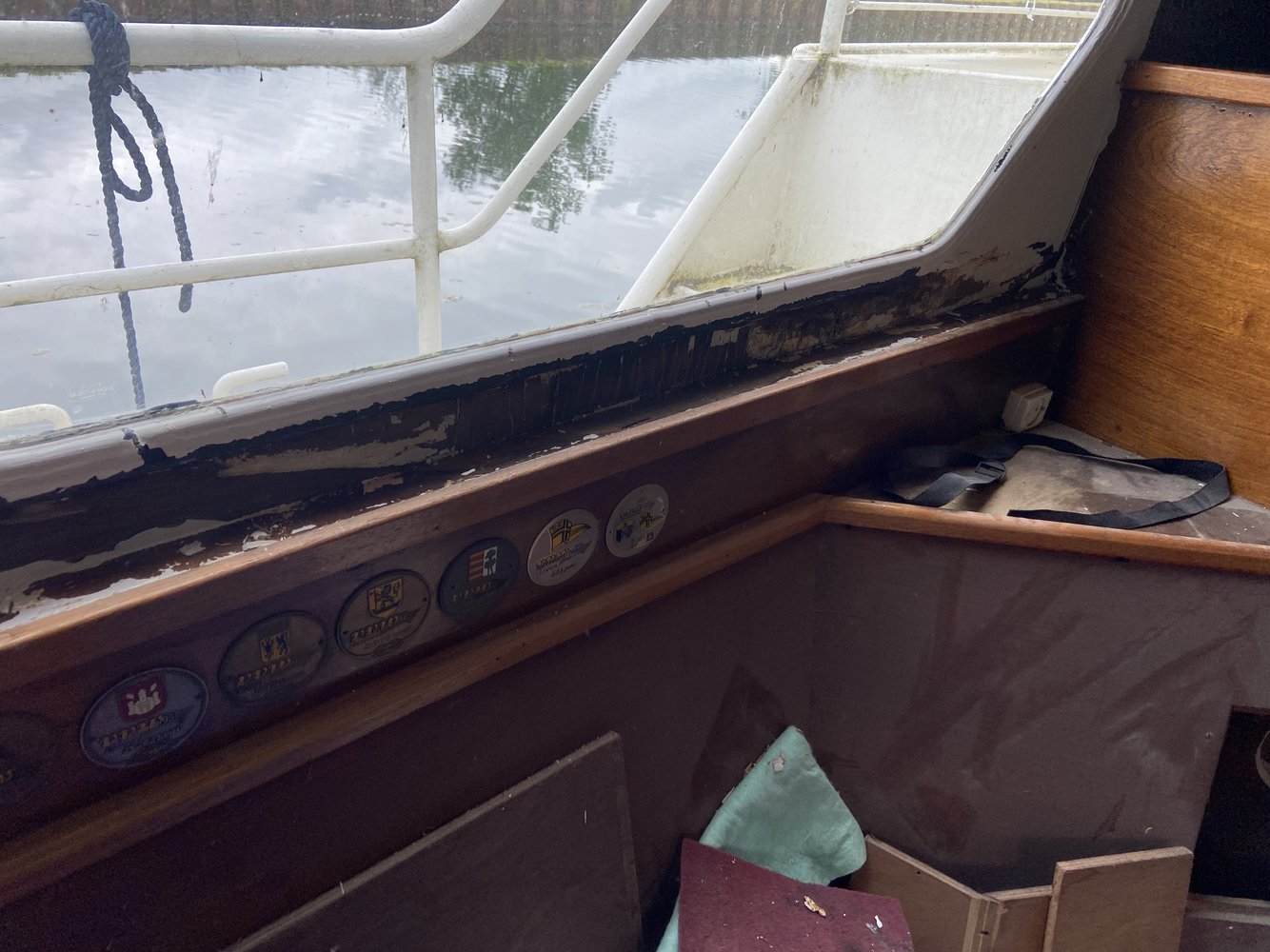

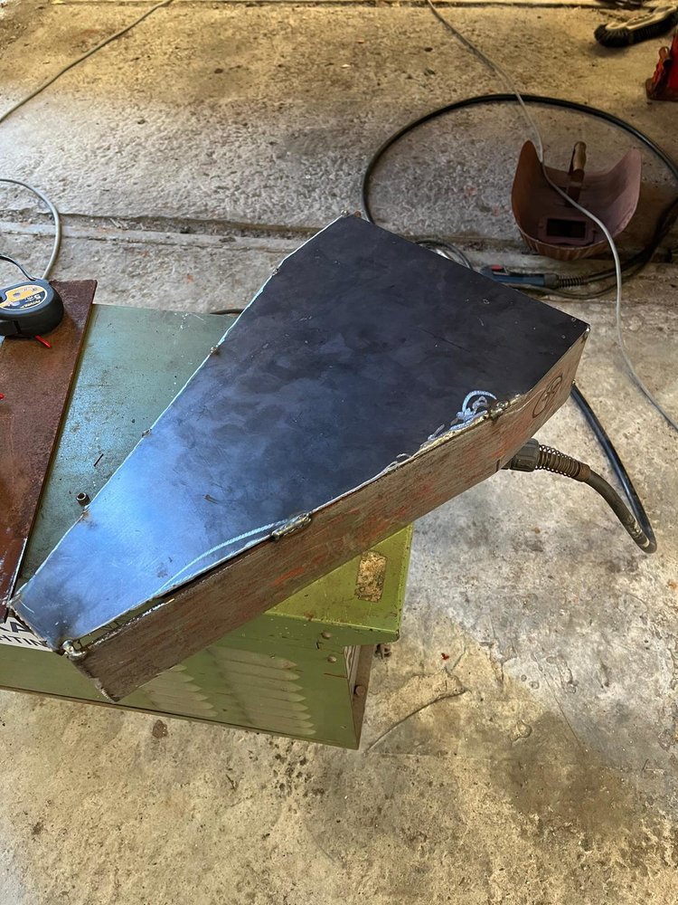

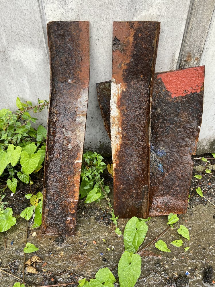

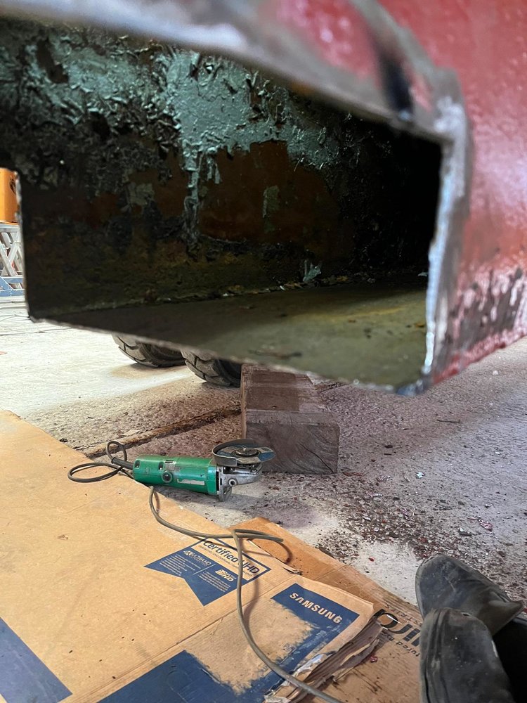

We have a Jacobo 12 m 1978 also had to have some of the keel cut out and replaced. Have you had much interest in her? Do you have any pics of the wood that you replaced finished?
View attachment 449165 View attachment 449166 View attachment 449168 View attachment 449169 View attachment 449170 View attachment 449171

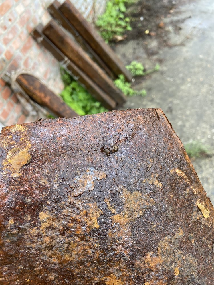

Yes noticed how thick your keel was in the photos, ours are only 5-6 mm thick hence the corrosion and a large bent in the front of the keel from a rock. Yours looks like a very well built boat by the look of it. Fairly common for the teak deck to go if left in the weather unfortunately.Is that the bottom of the keel as it looks quite thin. Mine are 20mm thick along the bottom of the keels.
Everything else is 5mm thick.

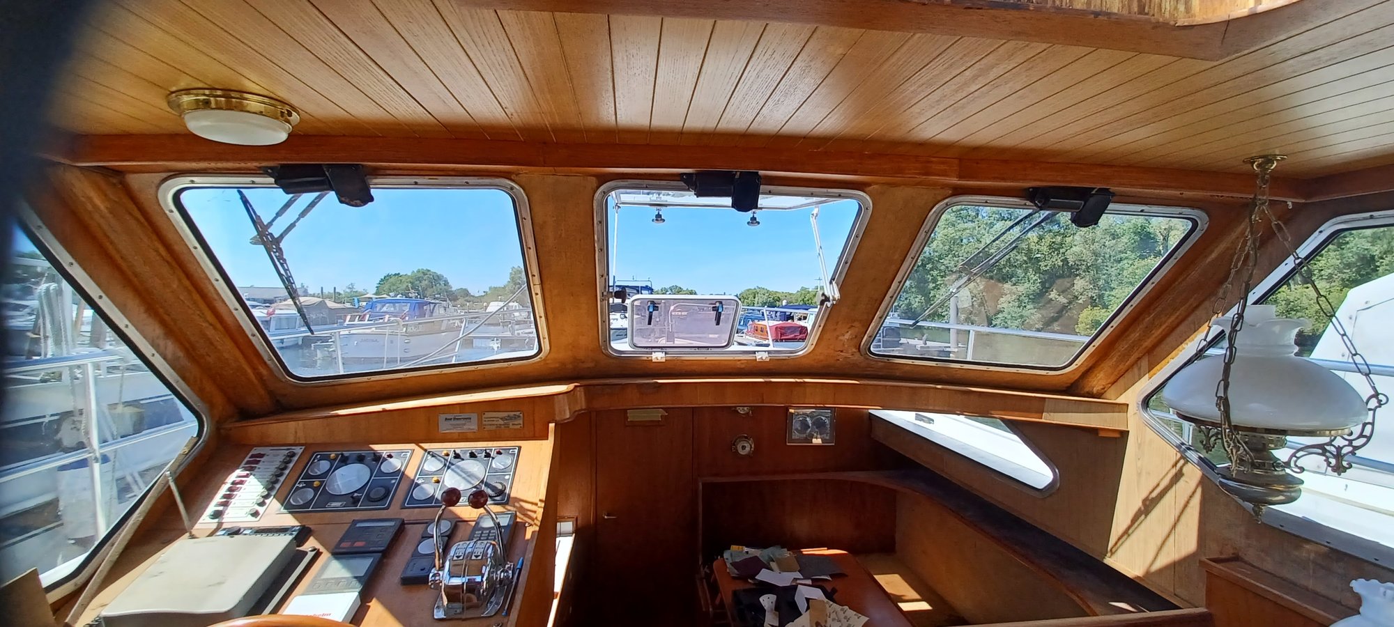

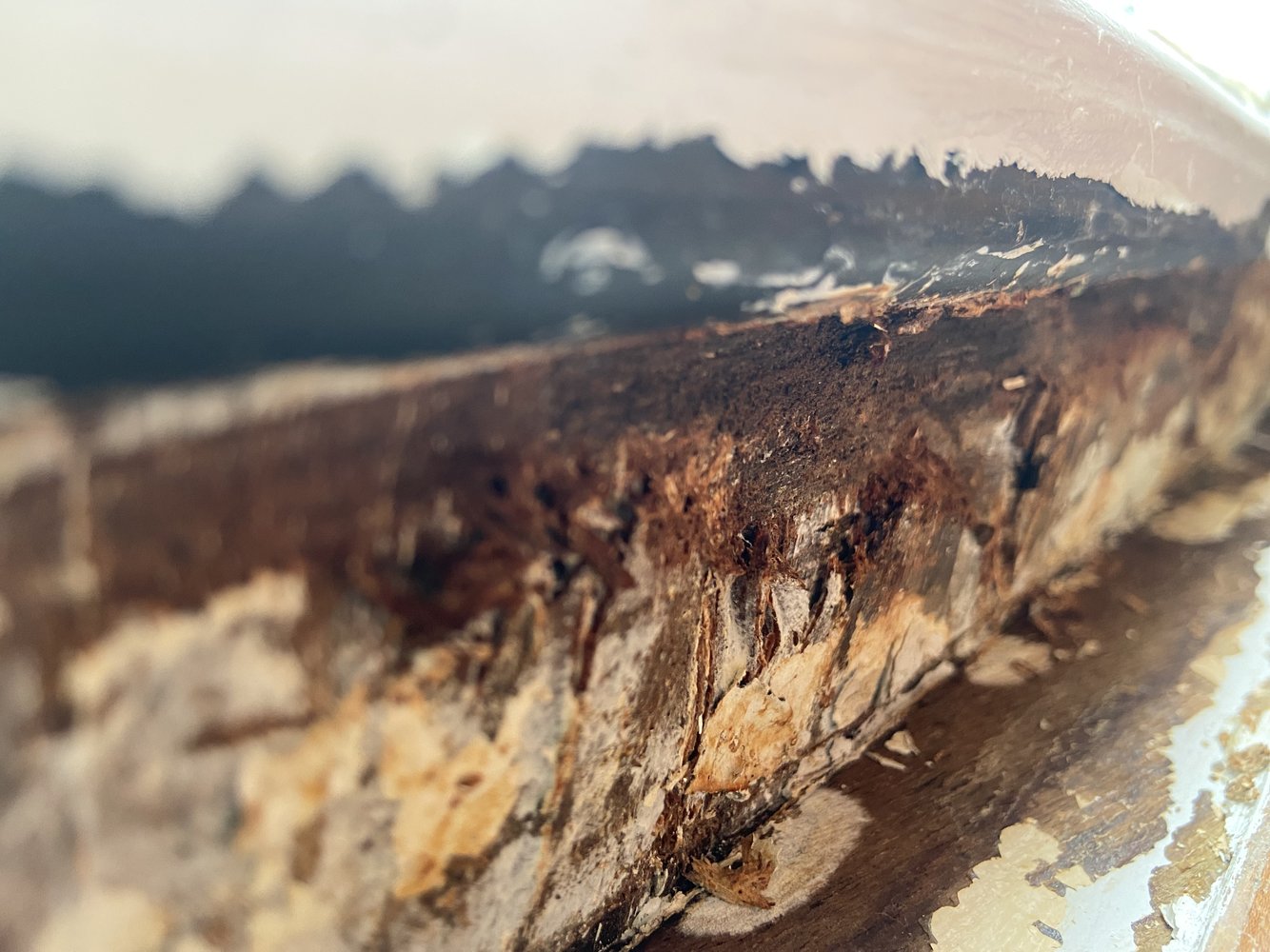

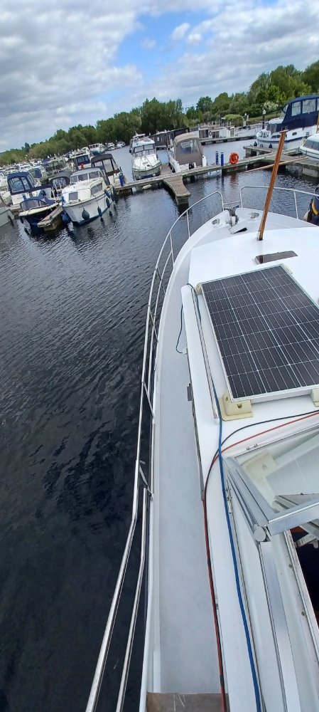

I'd replaced about 1/3rd of the aft cabin ceiling but the bit I replaced in the saloon you can just see on the right of this pic. This was before it got stained and varnished.

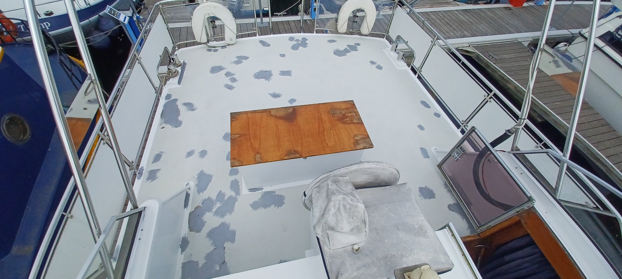

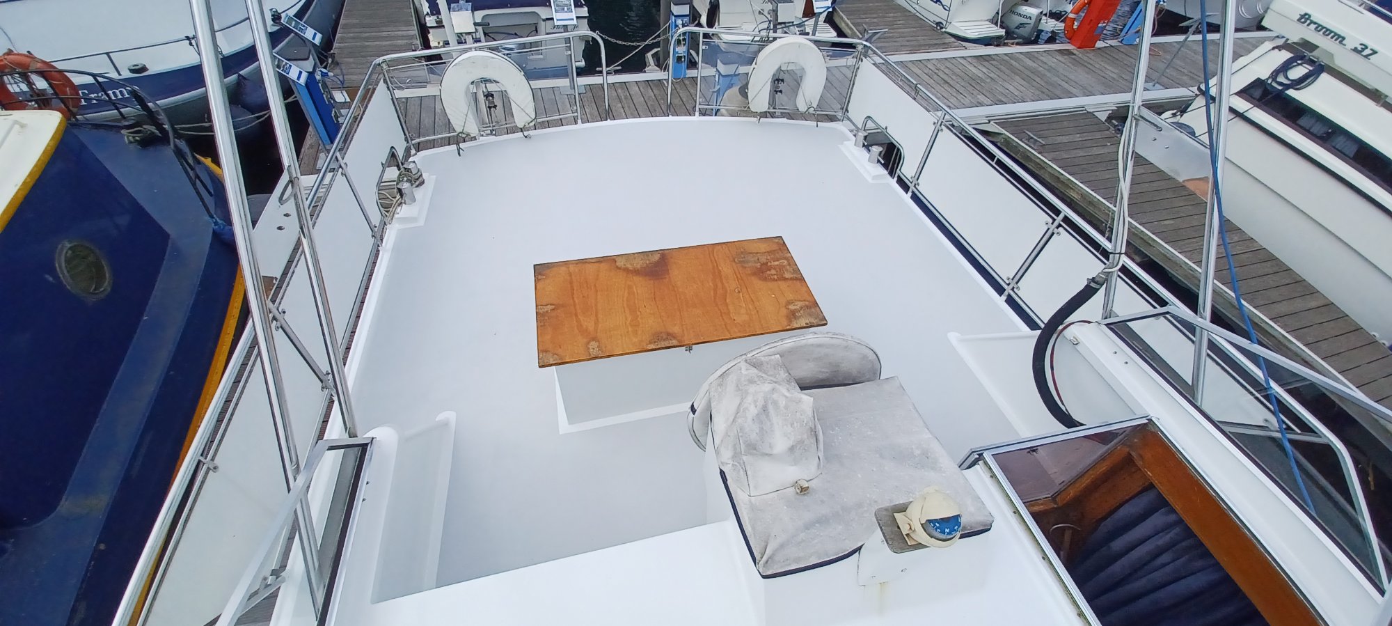

I made my own. I used fine aquarium gravel. Sprinkled it onto wet paint. When dry coated over the top. Really nice and grippy.SML Lustre Marine Deck Paint | Single Pack | SML Paints
Durable deck paint designed for marine environments, offering an attractive finish.www.smlpaints.co.uk
So I'm thinking of using this with the non slip beads added.
Anyone think the jotun is a better option?
