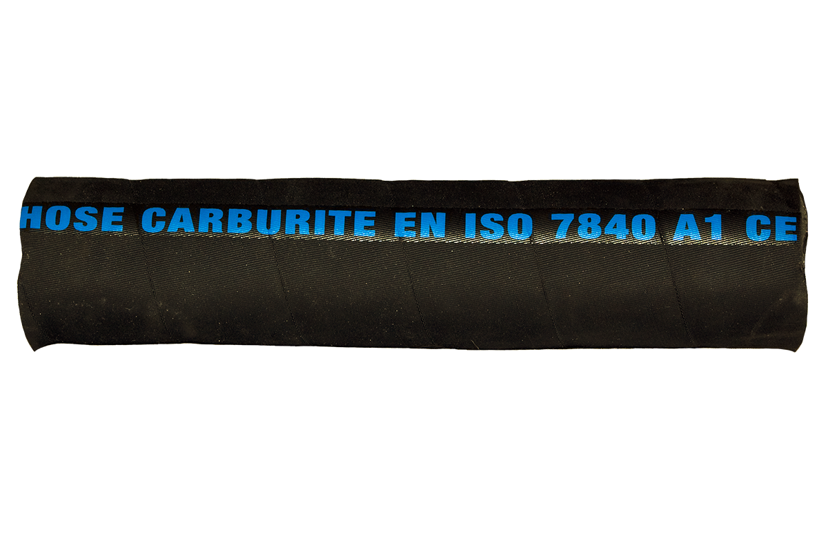

I've spent the weekend working through the list of jobs I need to do. I've come across an issue with needing 45mm fuel pipe for the filler bit it's not available is iso7840 hose. It's 38 or 51mm only so neither of those are any good.

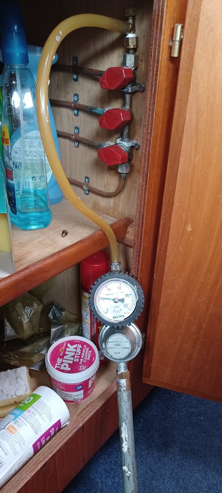

I'm still fitting a new reg and pigtail but it's good to know none of the appliances are leaking and the system is OK.
Grandmother/eggs alert..New olives are much safer than PTFE. Or annealed old ones even..my LPG surveyor would give birth if he saw that!Yes I think it is ptfe
Sorry missed that.Mat, do you have to deal with the BSS?
Do you know of and iso7840 hose with a 45mm ID?
He found the fridge didn't have the correct fitting on the gas pipe. The tube was pushed onto a flared copper pipe the clipped in place.Looks great.
has the BSS person found additional faults ?

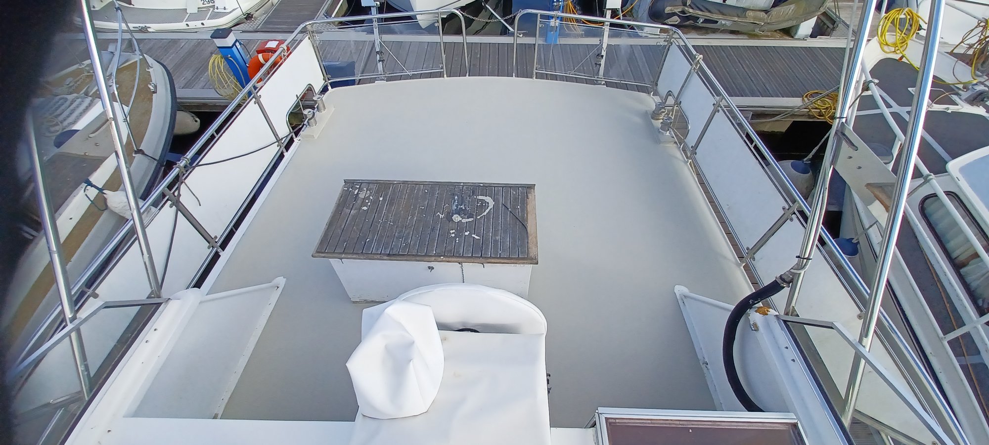

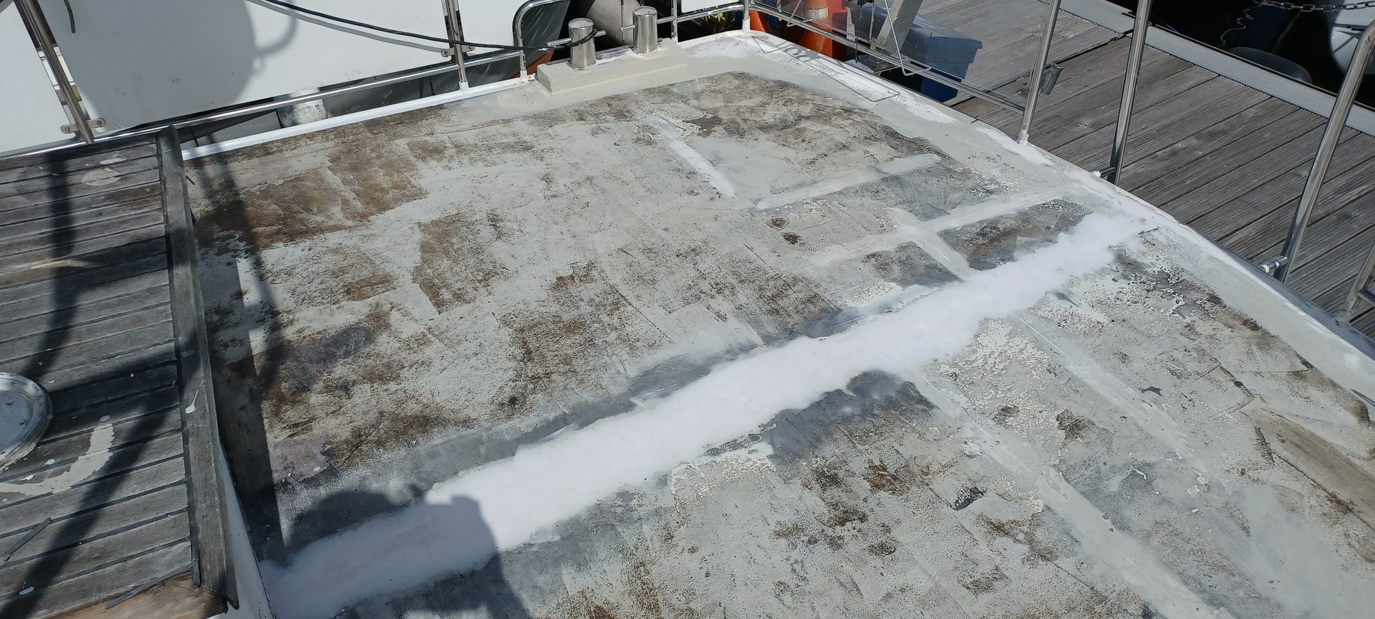

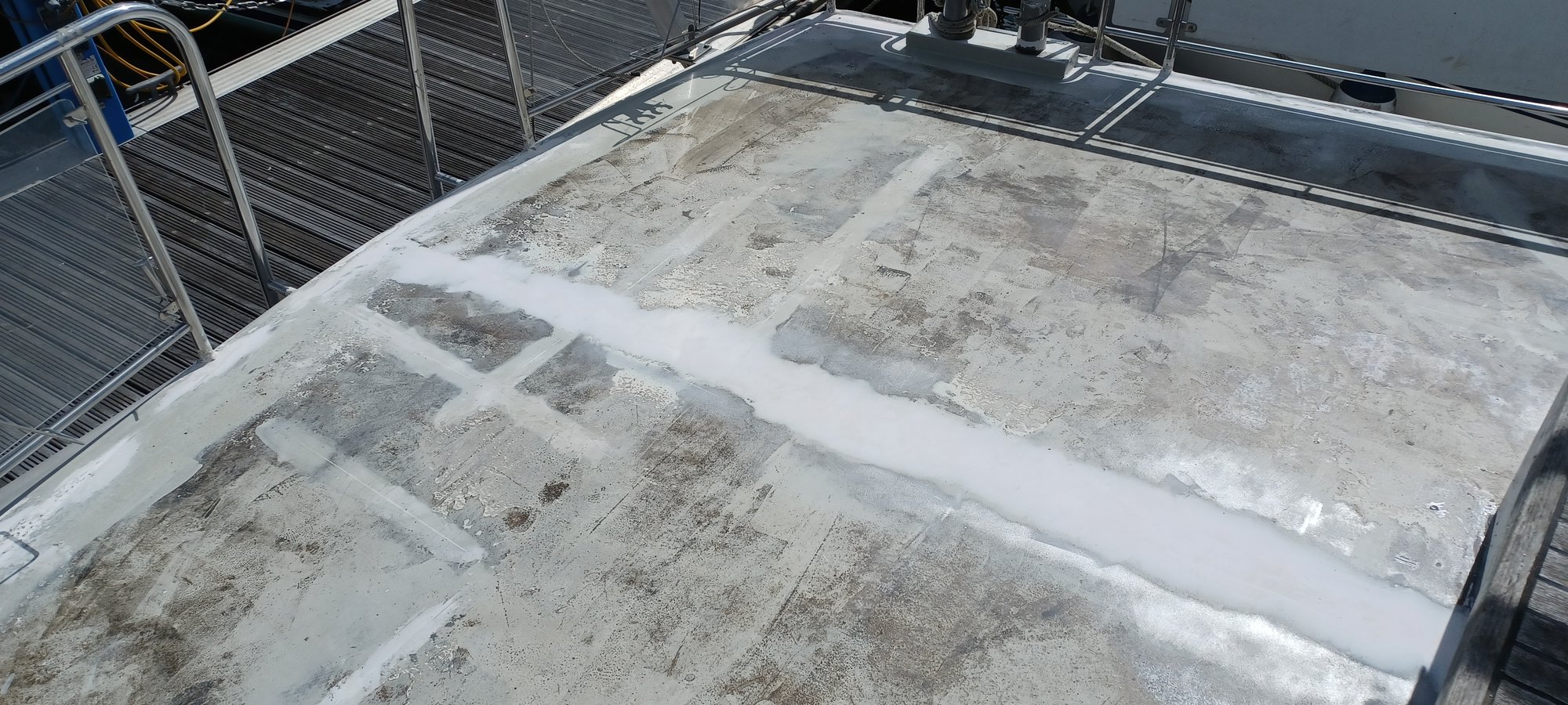

Still needs some more work before it can get painted as I missed a few bits that need fillingFairplay, that rear deck looks super tidy !
measure twice cut onceSo still not through the BSS but it should do when he comes out next.
Last weekend I did a lot of filler work on the back deck and got it in epoxy primer.View attachment 351724View attachment 351725View attachment 351726

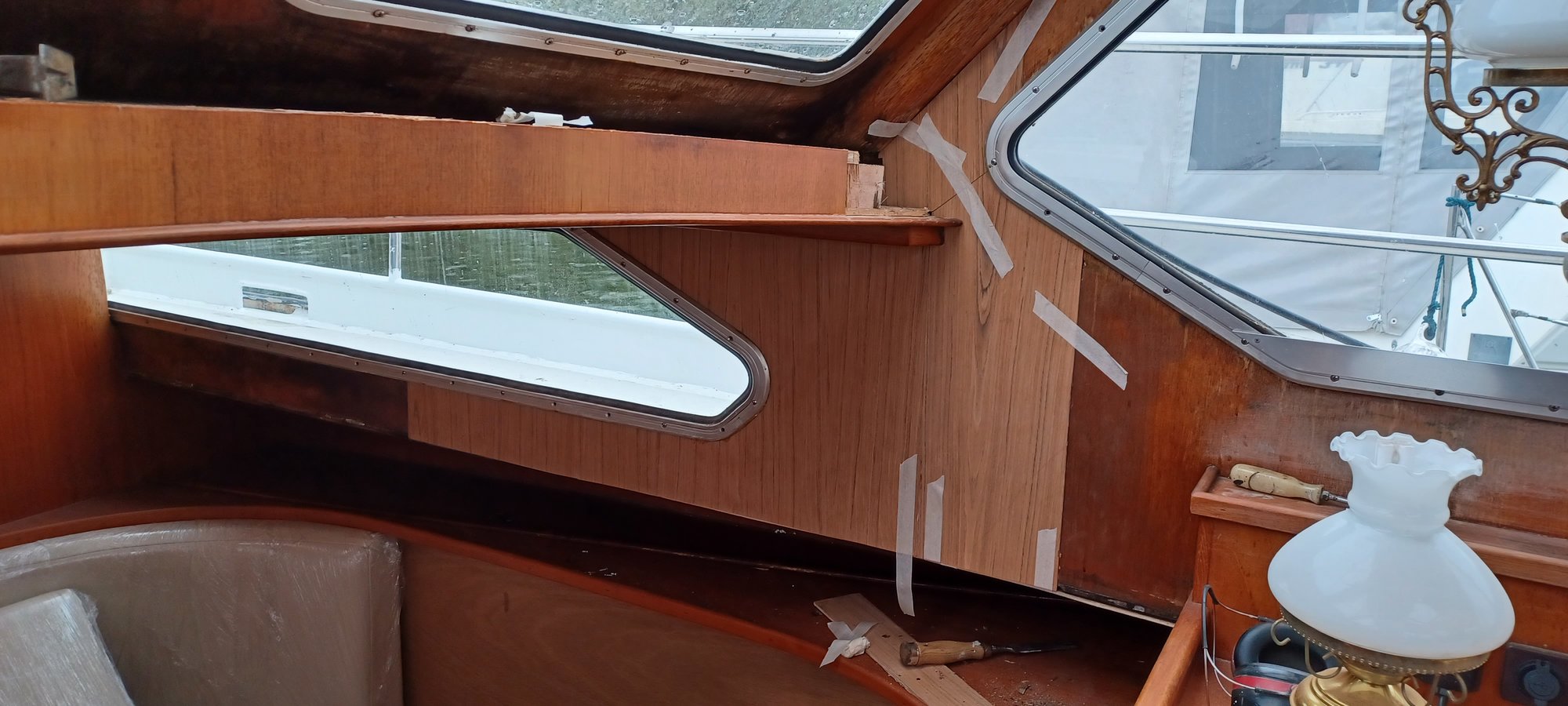

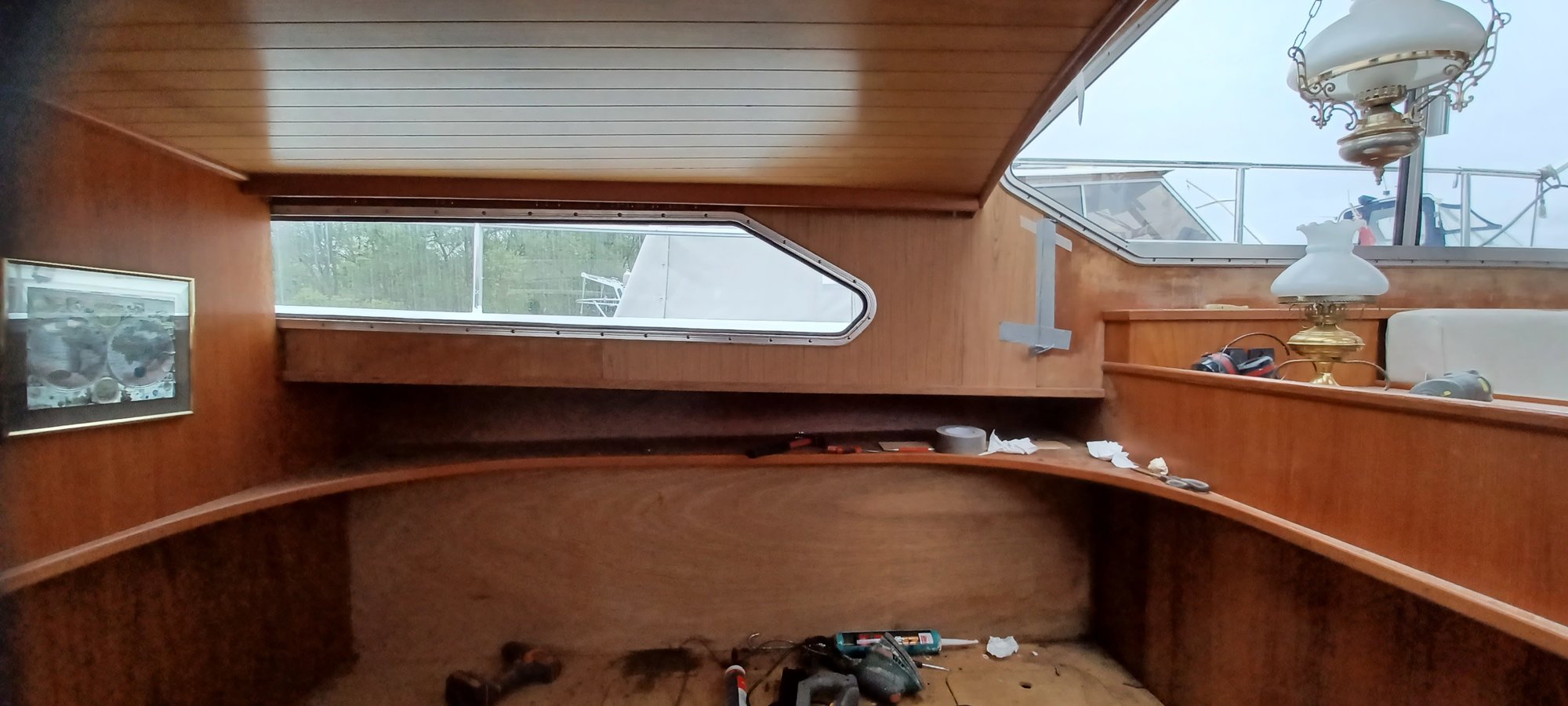

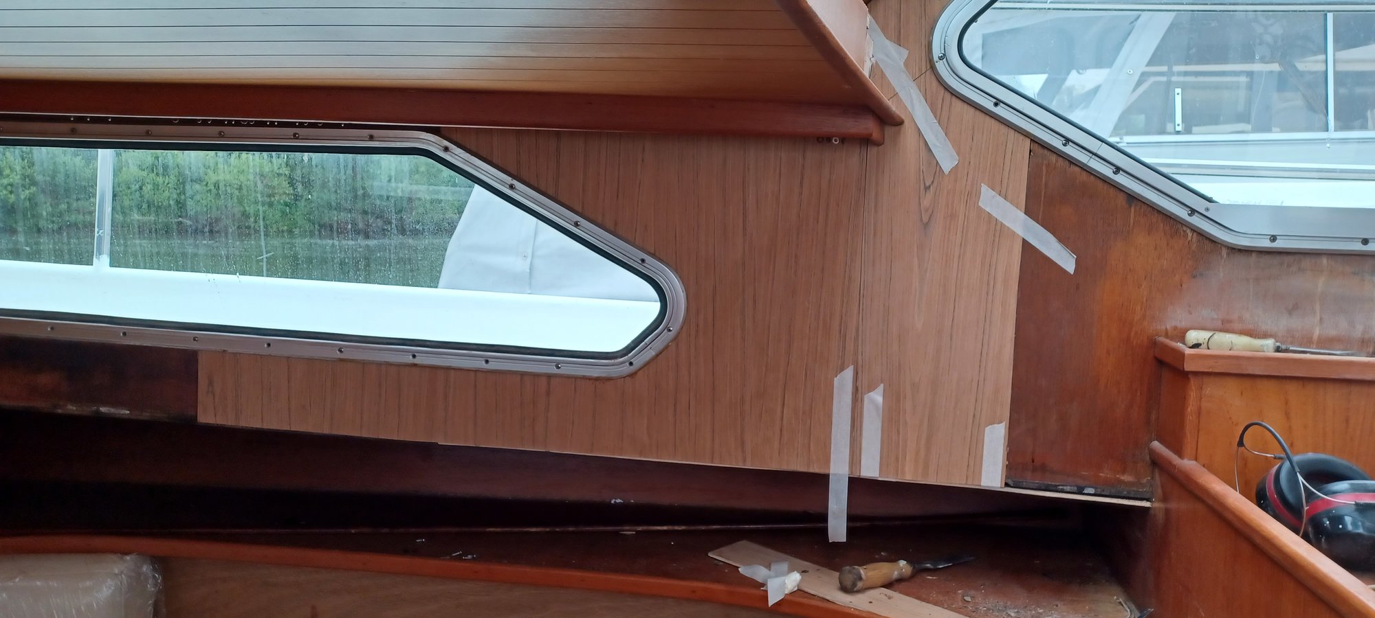

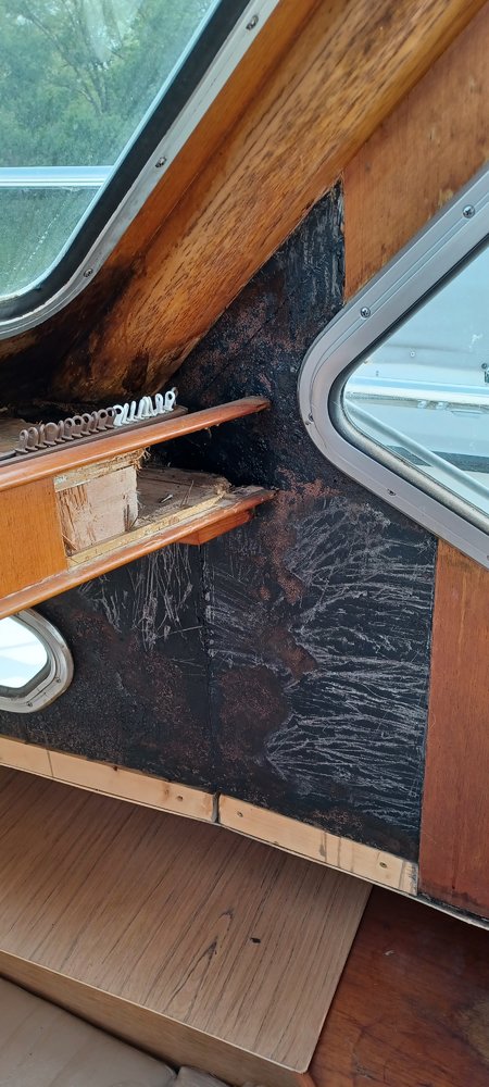

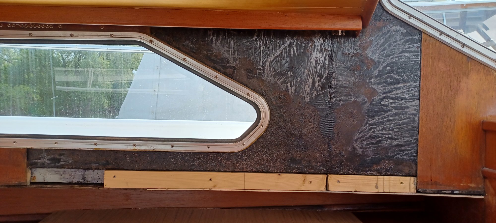

This weekend with the weather being pants I'm inside and doing some woodwork. This area was damaged due to a window leak so the wood was rotten. View attachment 351727View attachment 351728View attachment 351729View attachment 351730View attachment 351731
Not as much fun as metalwork as you can't weld bits on if you cut it wrong.
Bit more sanding to do before the stain can go on.
and a bit of patience
