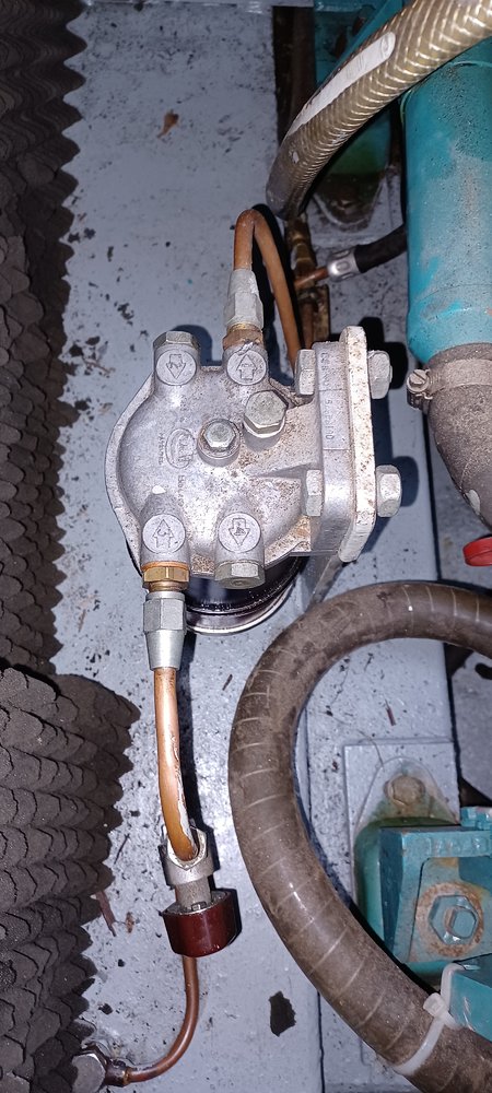

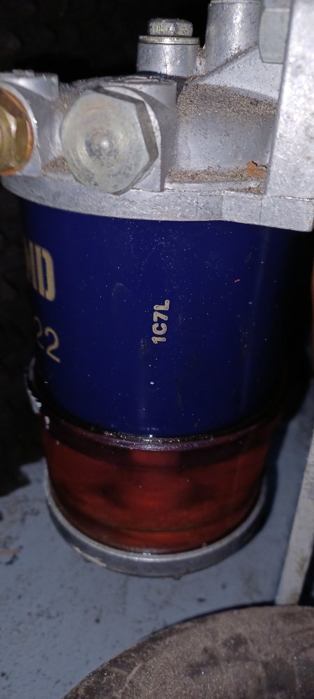

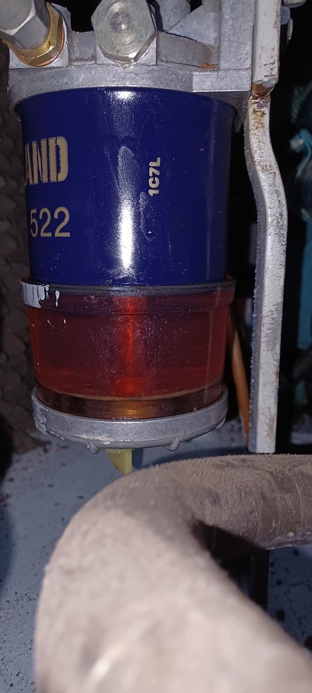

Glass are allowed !This is one of the filters I need to replace the bowl on. Anyone know if the bowls are available on their own or if I will need a whole new housingView attachment 343138View attachment 343139View attachment 343140
Yes, see post #268. The examiners don't always know their own rules!Glass are allowed !

Don't see fire being the problem with glass, if it gets that hot your boat would be toast anyway. Isn't it to do with damage from being knocked? So a mesh around it would be sufficient?Wrong hoses is spot on, it's got exhaust hose for the fuel filler so that needs changing.
I'll fit the proper metal parts on the filters if I can find some. Pretty annoyed with that as I prefer the glass as it makes diagnosing issues much easier.
I'll ask him about the fire resistant glass and see what he says
