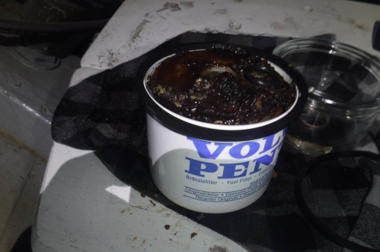

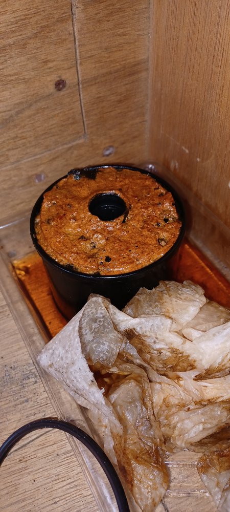

Really wants the tank out and treating if it’s got diesel bug. I’d be sourcing a temp tank to get you where you need to goJust a main tank, lost the starboard engine again and the port one only just got us moored up. Can't be arsed with it now. Called the breakdown people again so they can come out again tomorrow. We are just 3 hours from where we need to get to as well.
Should have had biocide in before itwas laid up. The sulphate reducing bacteria grow in the bottom of the tank inthe water, that drops out from condensation as the atmospheric temperature changes. Blocks filters real quick.Really wants the tank out and treating if it’s got diesel bug. I’d be sourcing a temp tank to get you where you need to go
What did you do to fix it?
Flush tank out as well as possible, blow through fuel lines, new fuel and filters, diesel bug treatment stuff.What did you do to fix it?
