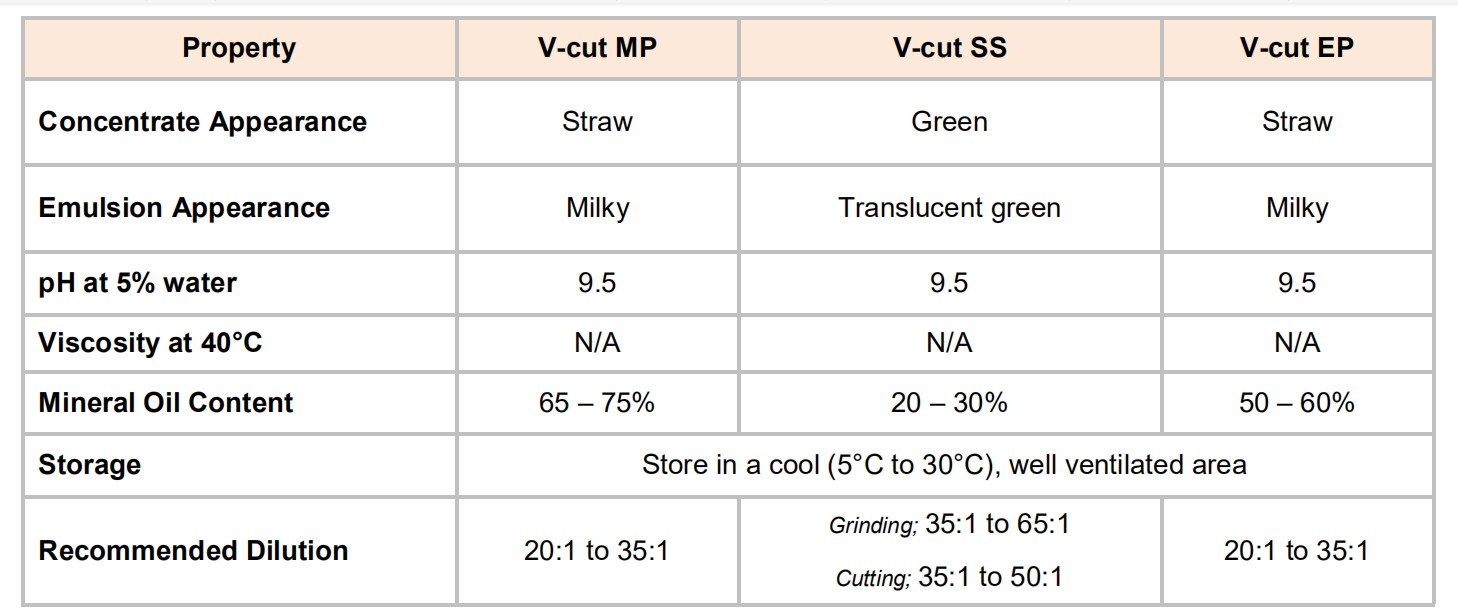

They always do. Give mine stir before use.Yea, I'd be worried about overdoing the bleach. Dunno though, nothing seems to suggest bacterial growth is my problem to me - just appears to separate!
