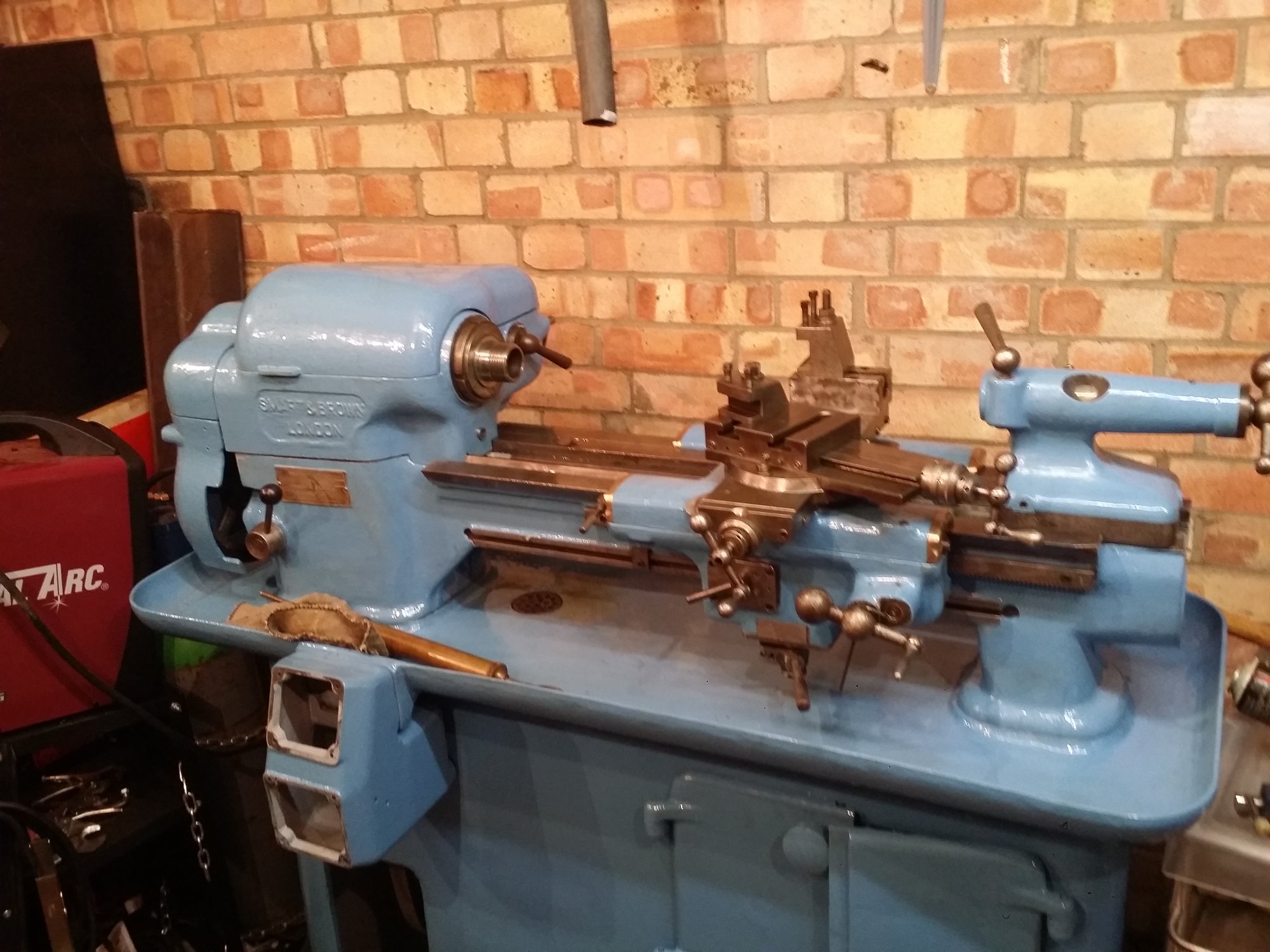

Don't suppose you've a fixed/traveling steady laying around.
.[/QUOTE
I don't have any steadies but I think the price may be exorbitant if you can find one. I may have a 4 jaw that's fits the backplate but I haven't had time to look.

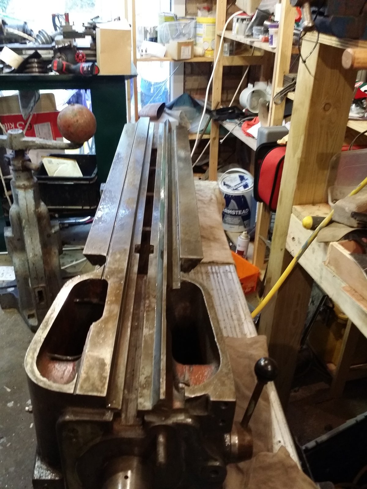

Aye. Last job is the change wheel storage and shelf as the motor only fits through that hole. I'll probably repurpose the Louvre doors lurking in the shed.Are you going to do anything about the missing louvered grill on the stand?
No worries. Planning to make one anyhow. Be nice if I could find an image of an original but none I've seen have one either.

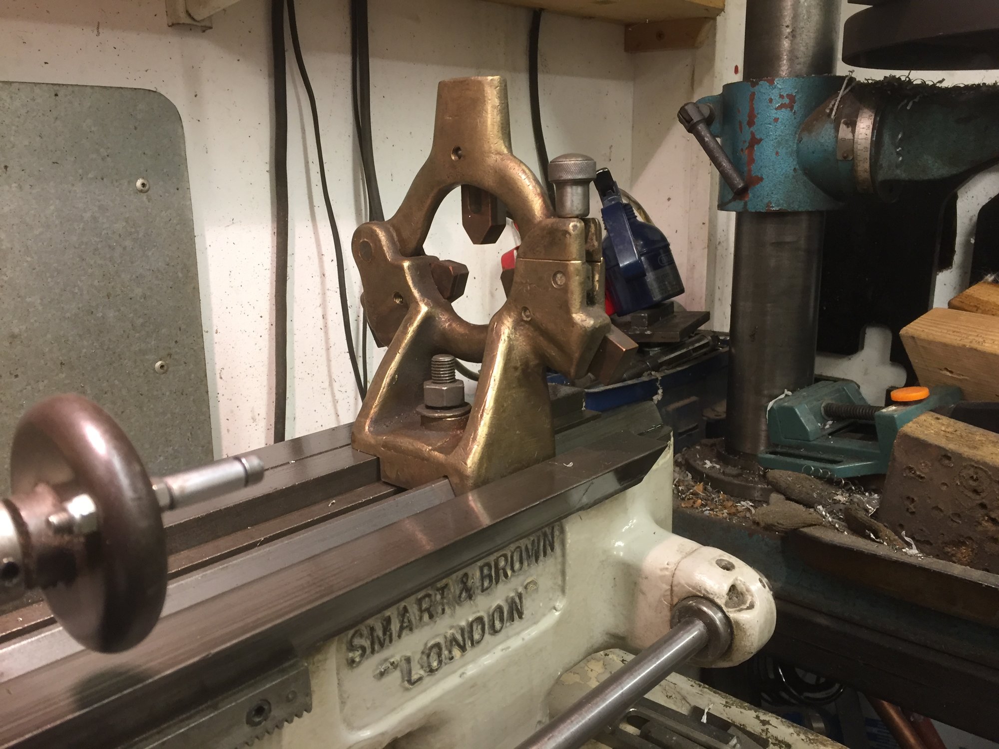

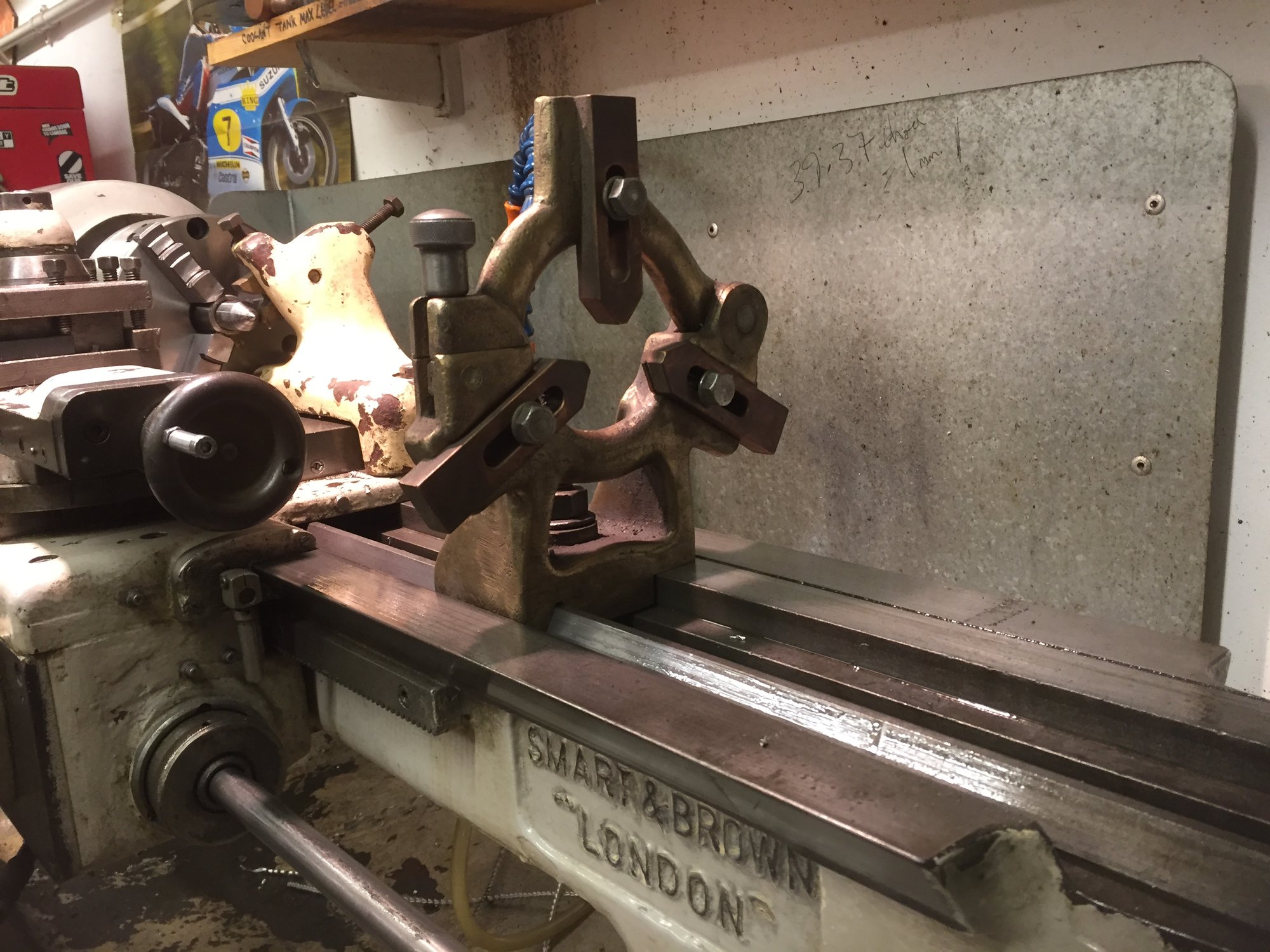

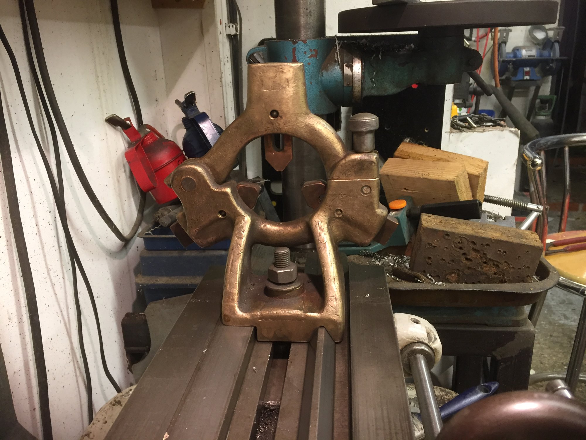

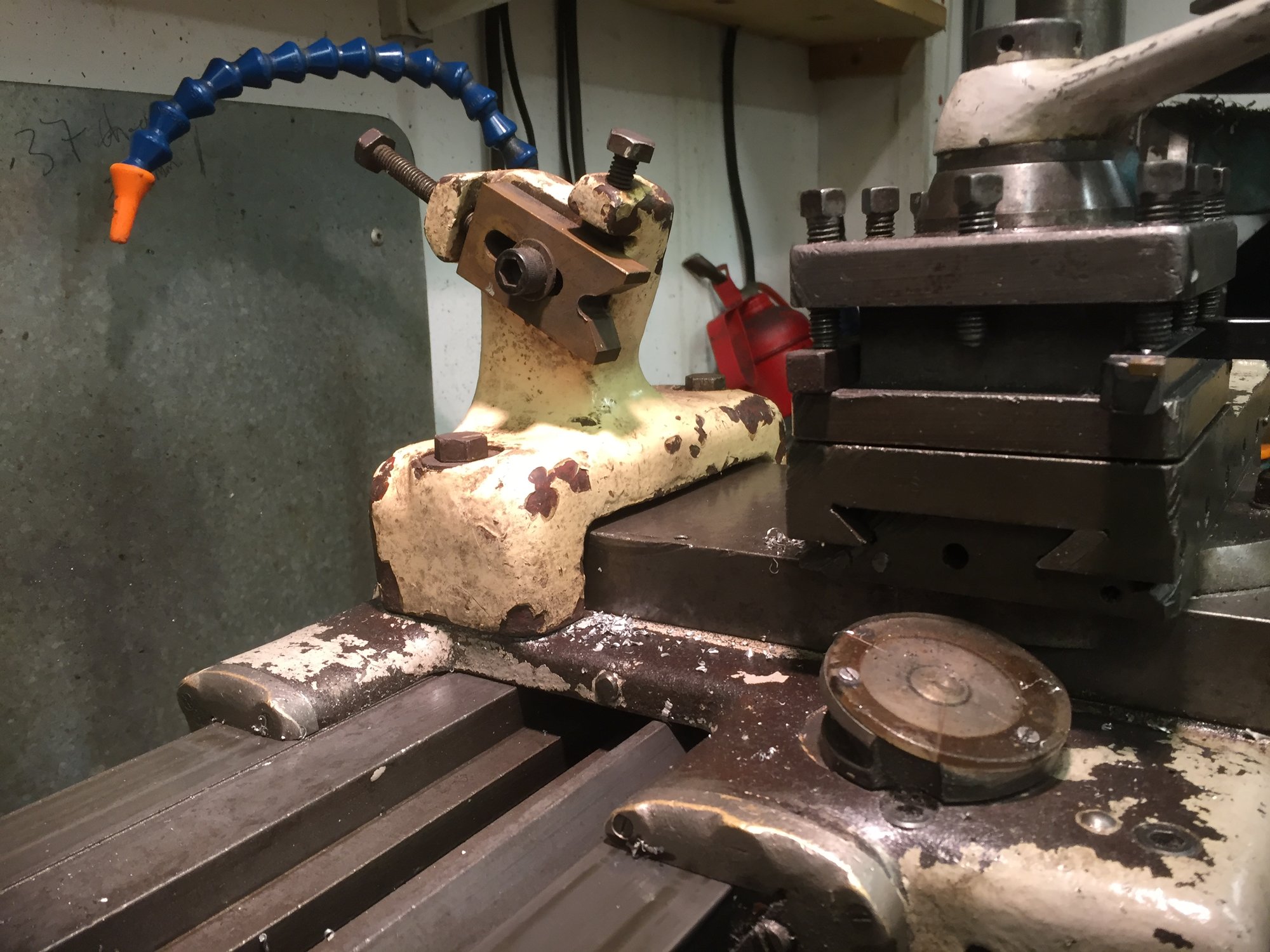

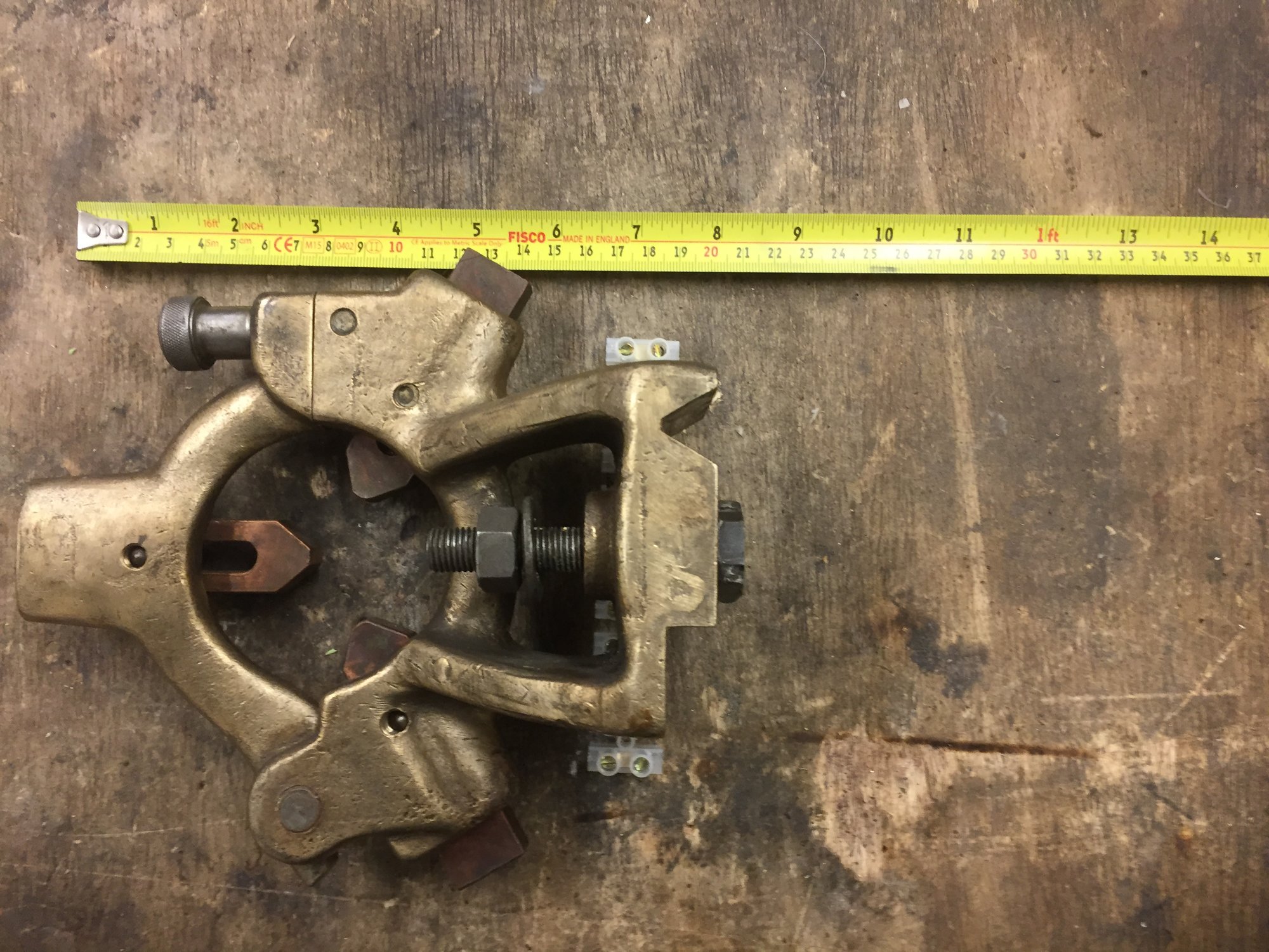

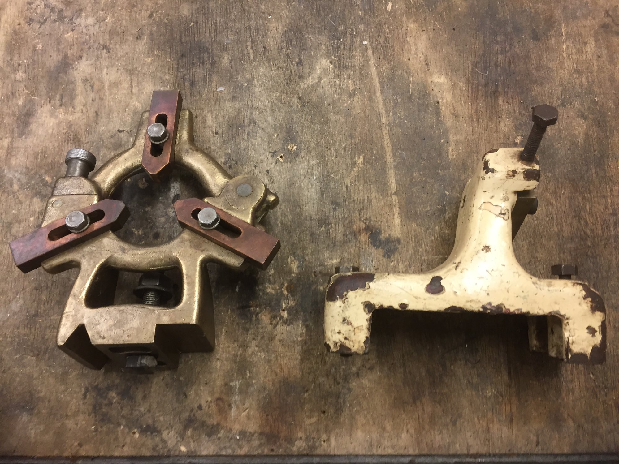

Top man. Sure I'll be asking for dimensions at some point maybe next year when I have time lol.I have travelling and fixed steadies for my Model M mk2. I'll take a few pics this evening and post them on here tomorrow.

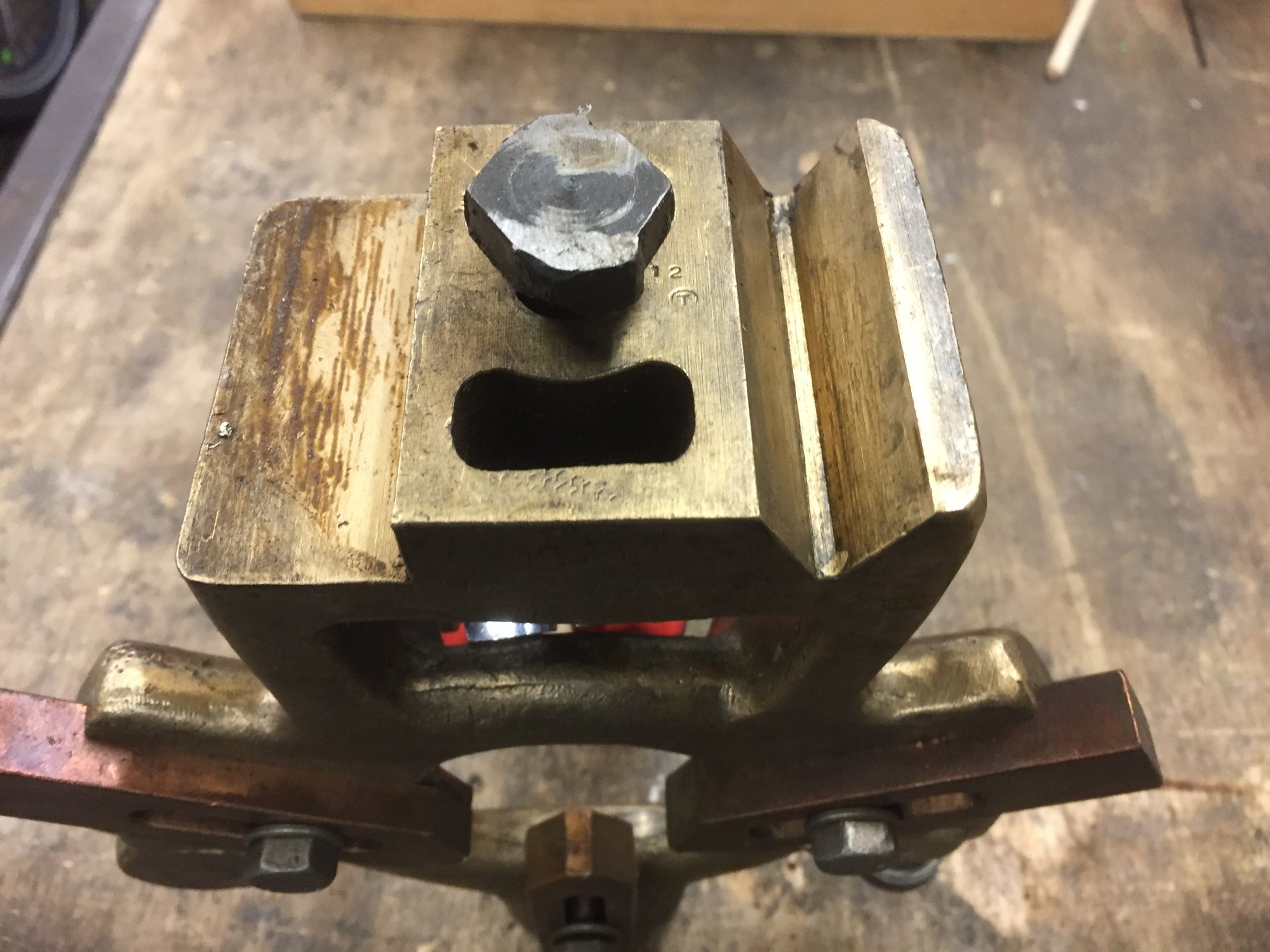

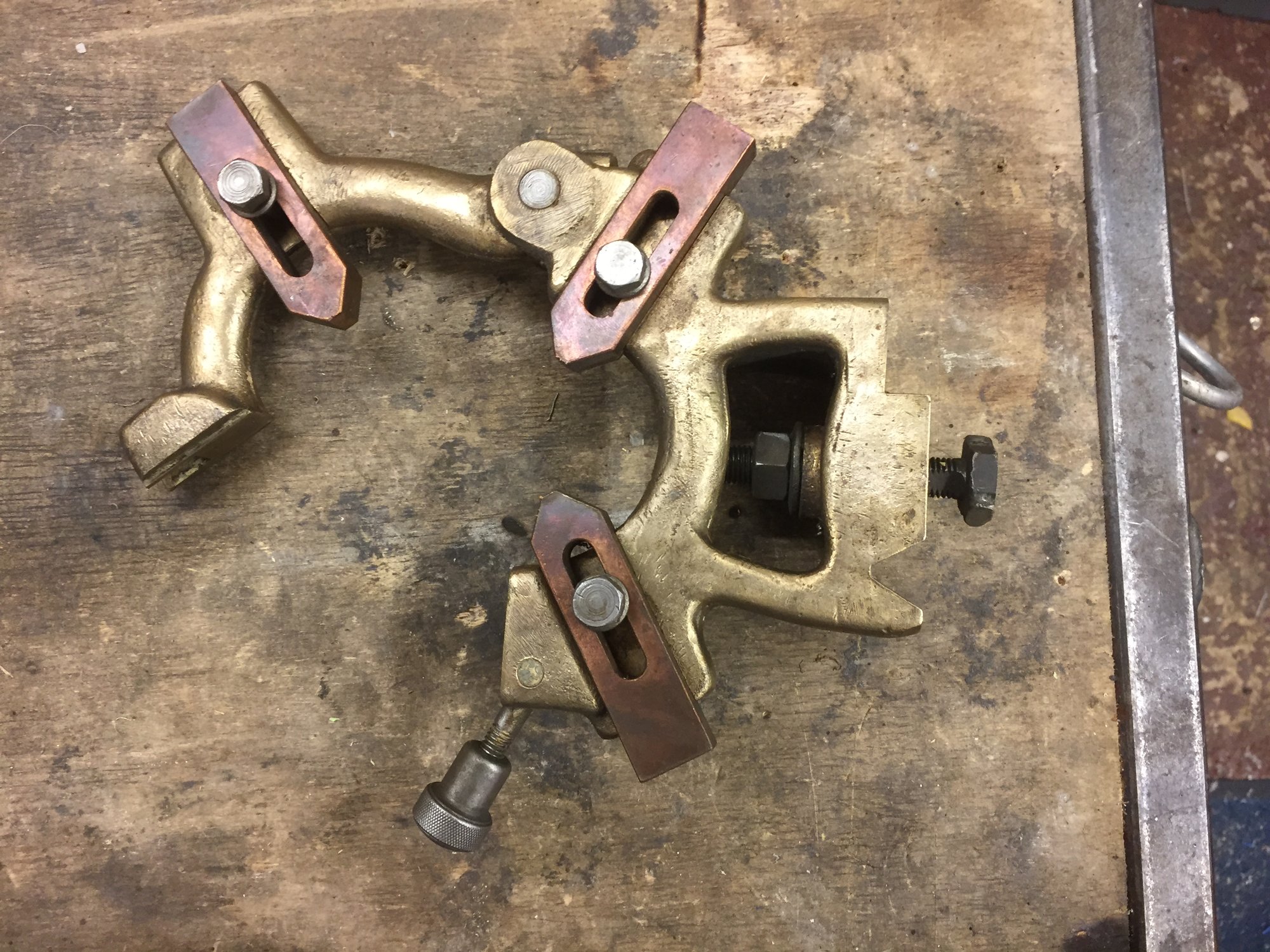

Top man. Much appreciated. Beds look identical too. Believe I can convert mine to a mk 2 if I found the needed bits. There add on parts so will be a few differences. I'll use my tailstock as a gauge when I come to make them. Would be nice if I could keep them close to original.@eLuSiVeMiTe Pics of S&M steadies as promised. The travelling steady is cast iron and the fixed is solid brass. I don't know if the ways are the same on the mk1 & mk2, but if you were to make them yourself you could make them to fit. Hope this helps.View attachment 121807 View attachment 121808 View attachment 121809 View attachment 121810 View attachment 121811 View attachment 121812 View attachment 121813 View attachment 121814
There doesn't seem to be any fine adjustment on the fingers of the fixed steady.
That's the travelling steady...

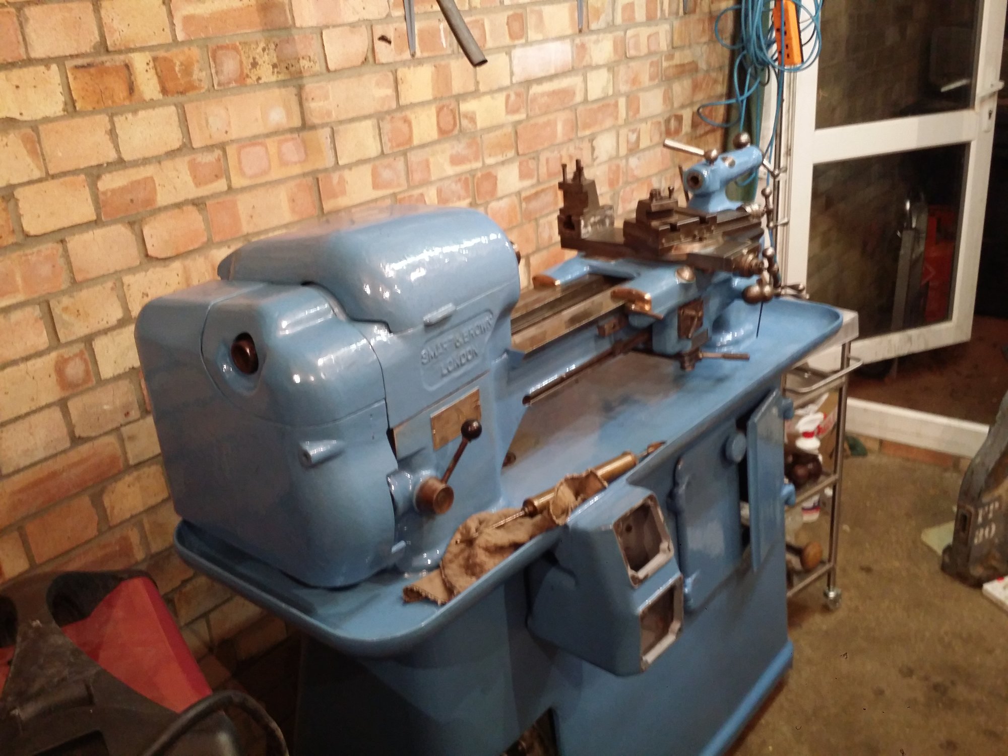

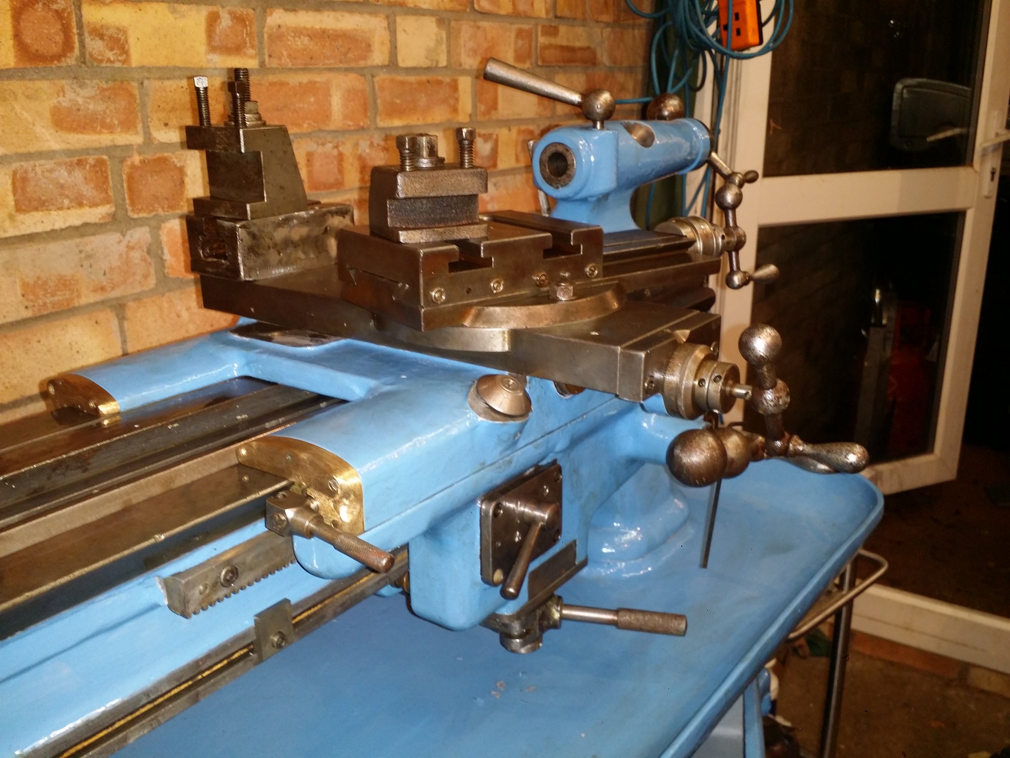

Machine looking hansom mate.Key had been sheared New one appears to be holding.

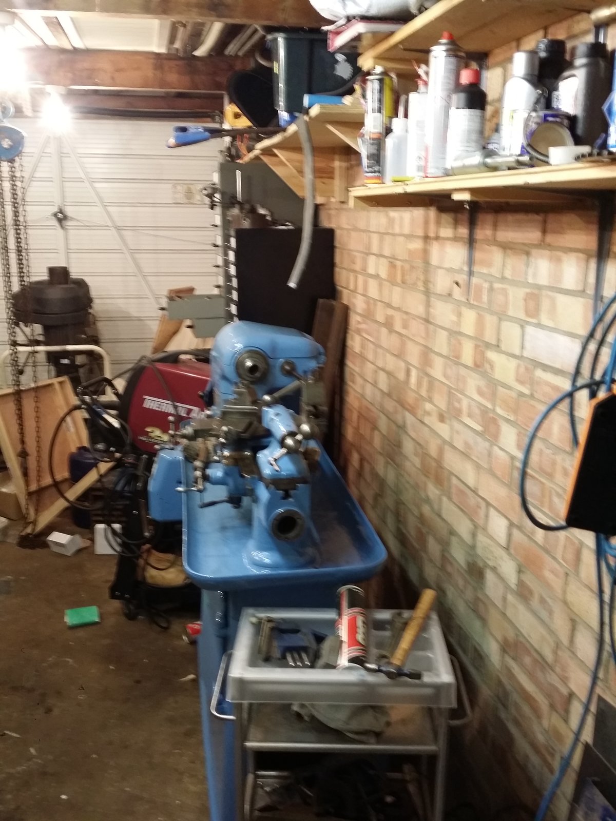

Still got handles to polish and pin. Leadscrew to refit. Tumblers to clean and fit and the bed to bolt down. And tighten the gibs
Now there's defiantly an end in sight. View attachment 122092 View attachment 122093 View attachment 122094 View attachment 122095
