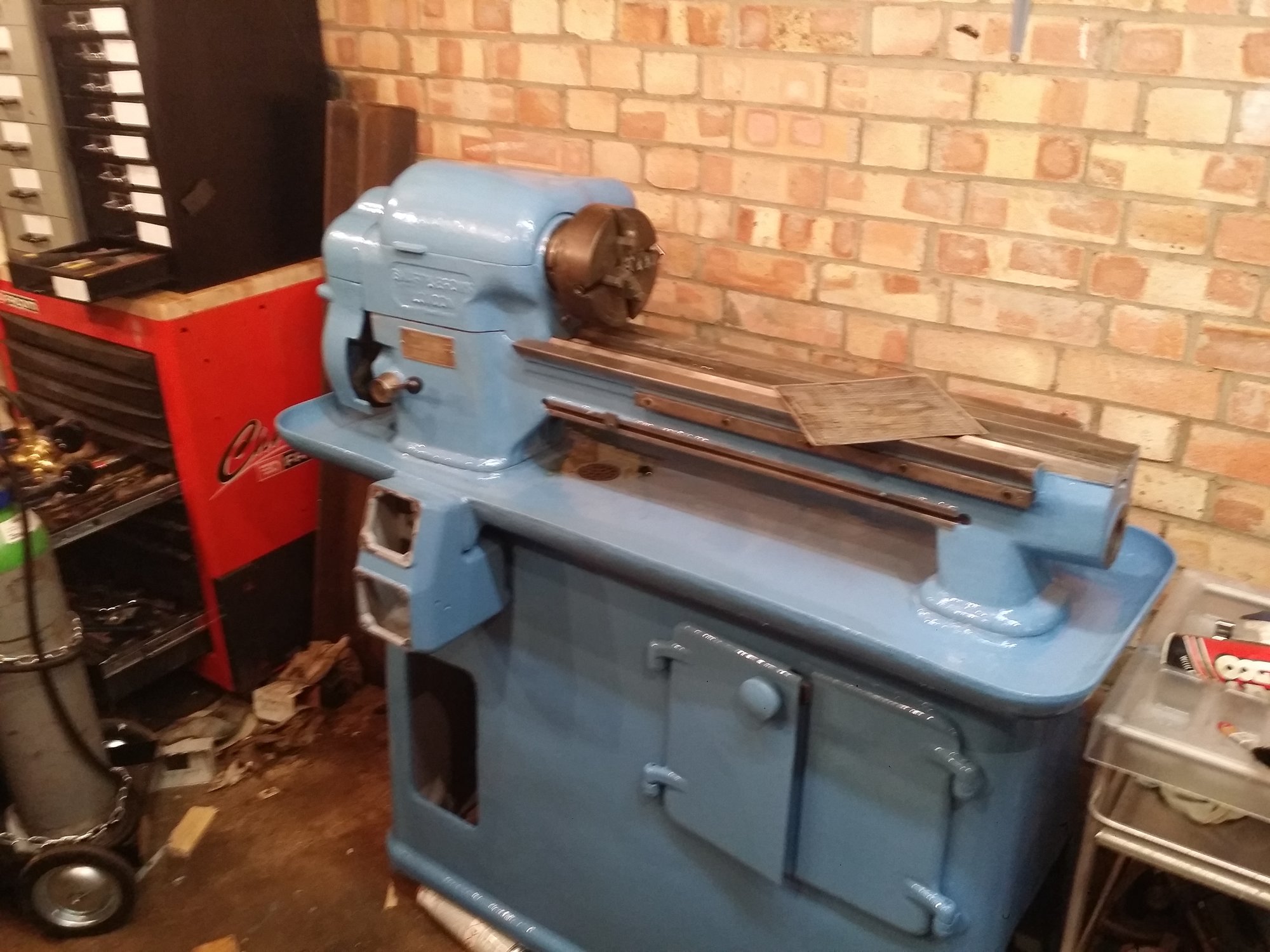

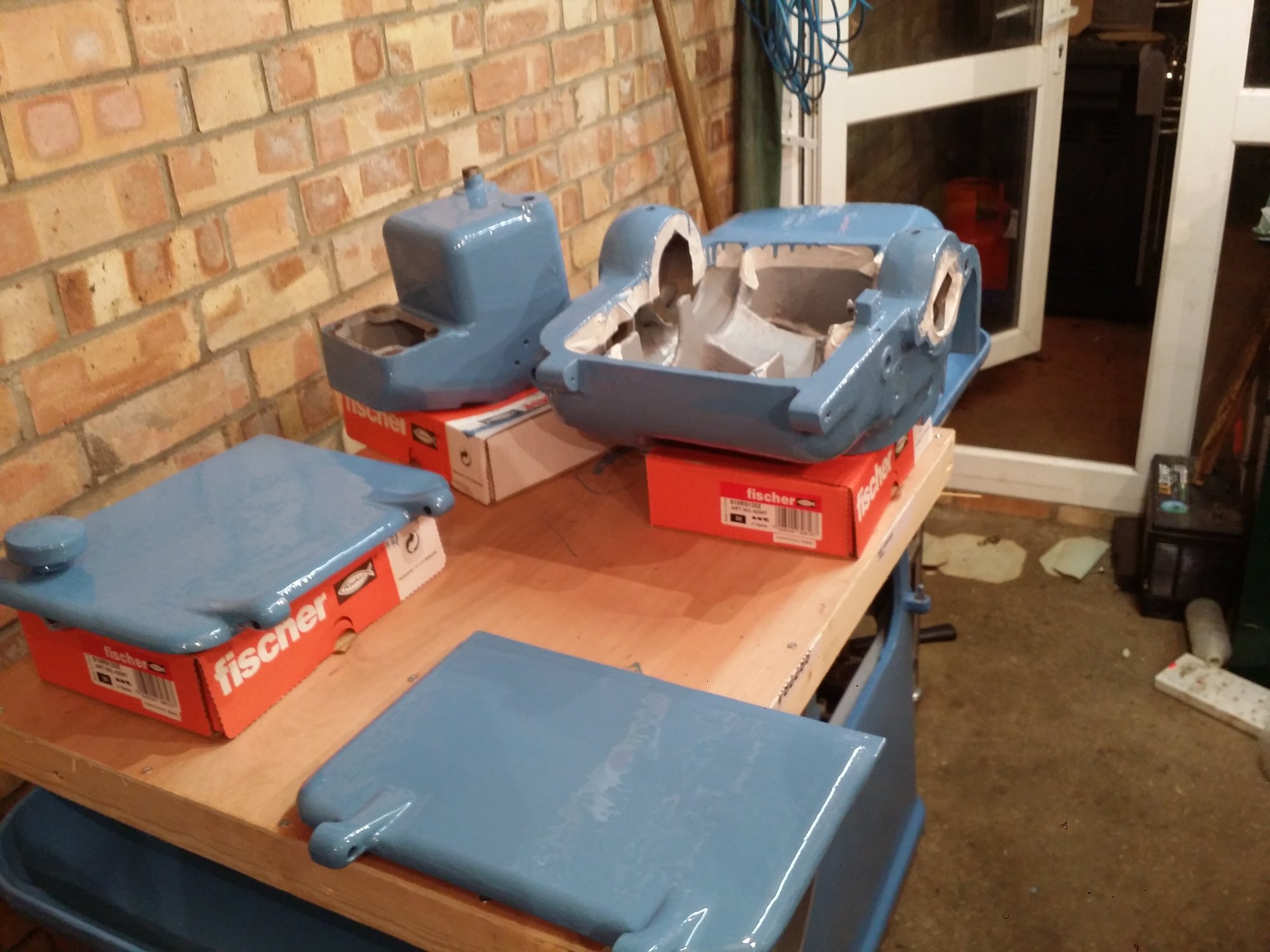

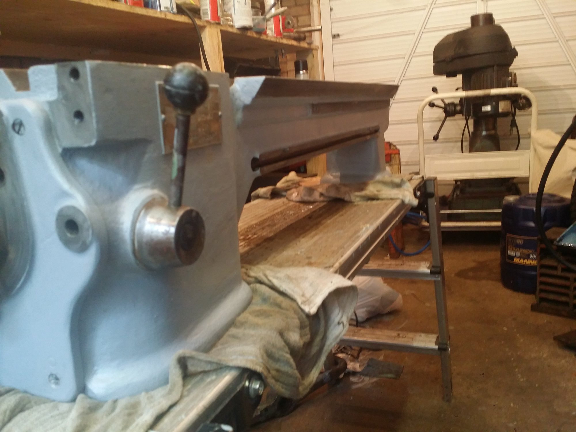

Na. Probably stay as they are. Was just red oxide last time round. Easy to see anything foreign in there. Same for the cabinet insides. Were all red. Now staying grey.

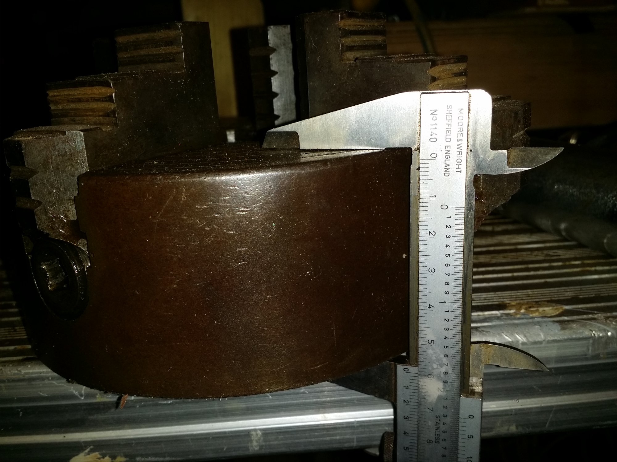

One day, I'll find a 4 jaw too![]()

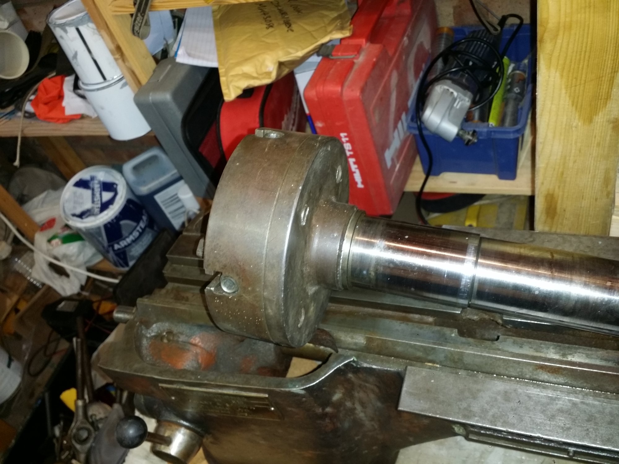

Model L?I think so - I mean it's definitely threaded but whether it's the same or not...
Yes, it's an L.

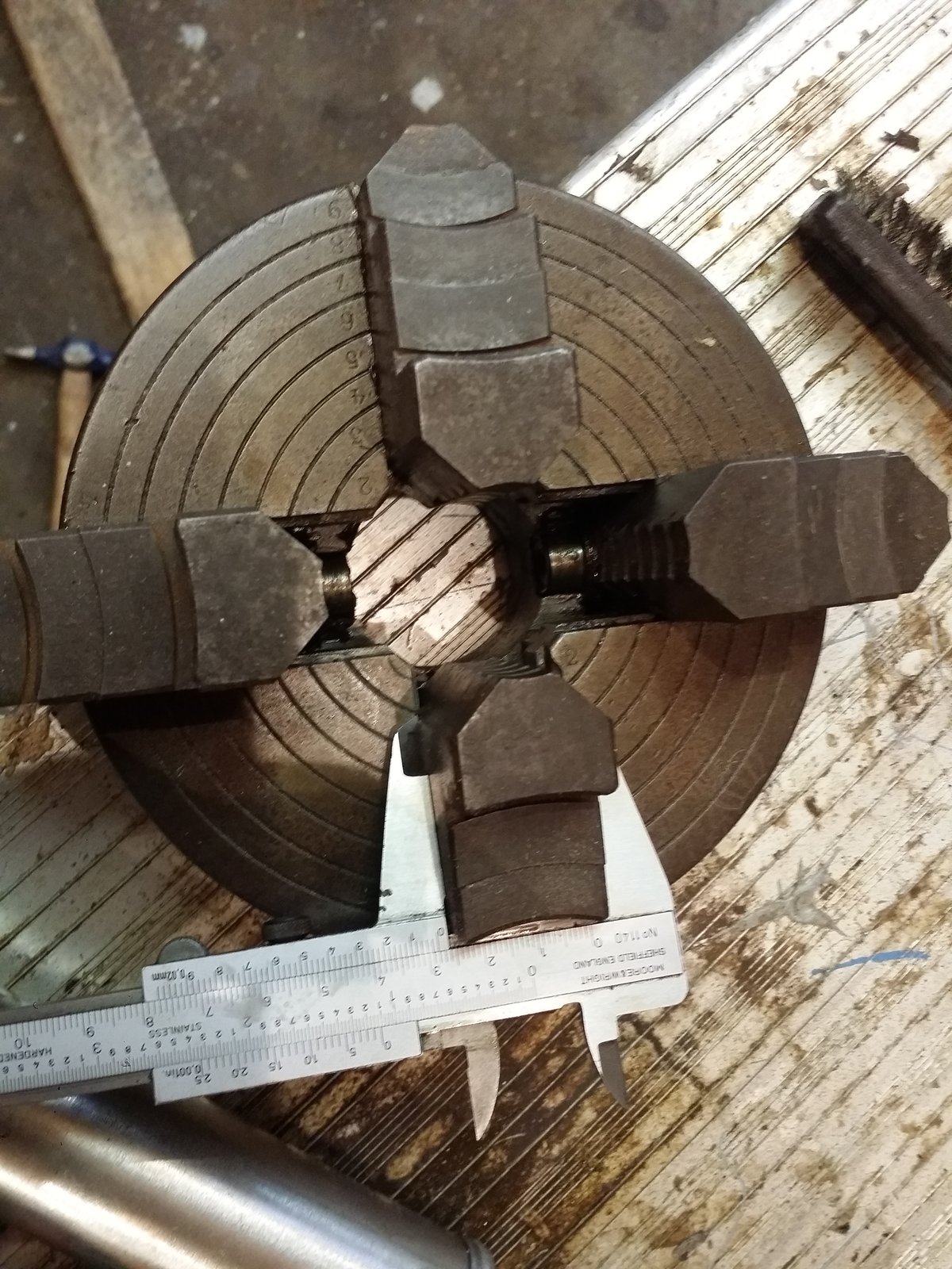

I've got the backplate for the 3 jaw, but I'd happily forego the 3 and just use a 4 (and collets) instead.

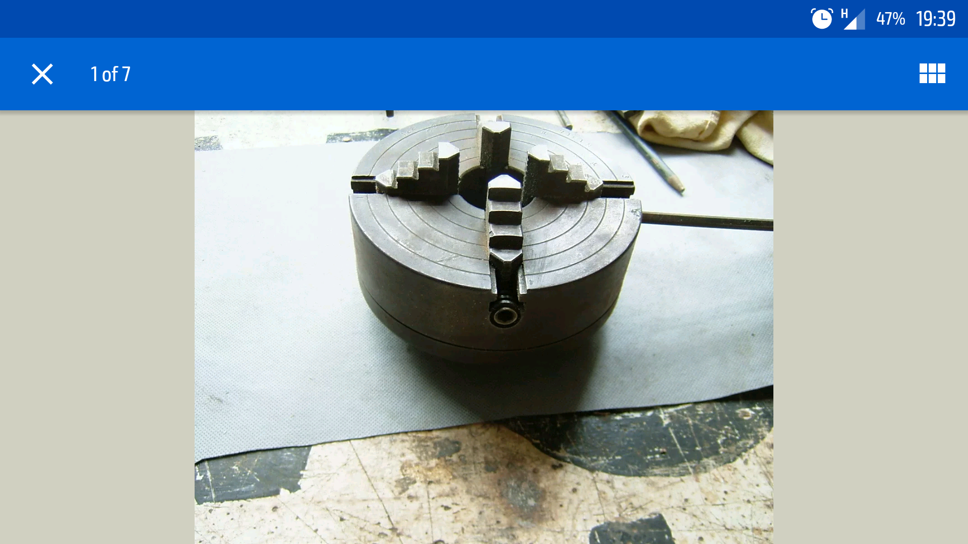

What I'd like to do is find a 5-6" 4 jaw (or even a 4" if it really came to it), mount it on the S&B backplate and make a threaded adaptor bush so I could screw it onto my RandA too.
Maybe I'd have more luck finding one if I looked more often than once every 8 months or so![]()
I'll scroll back through fleabay and see what it set me back tomorrow and drop you a msg.I think that'd just about work - it'd be tight, but just...

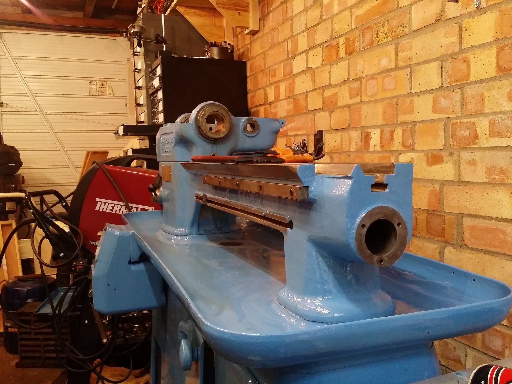

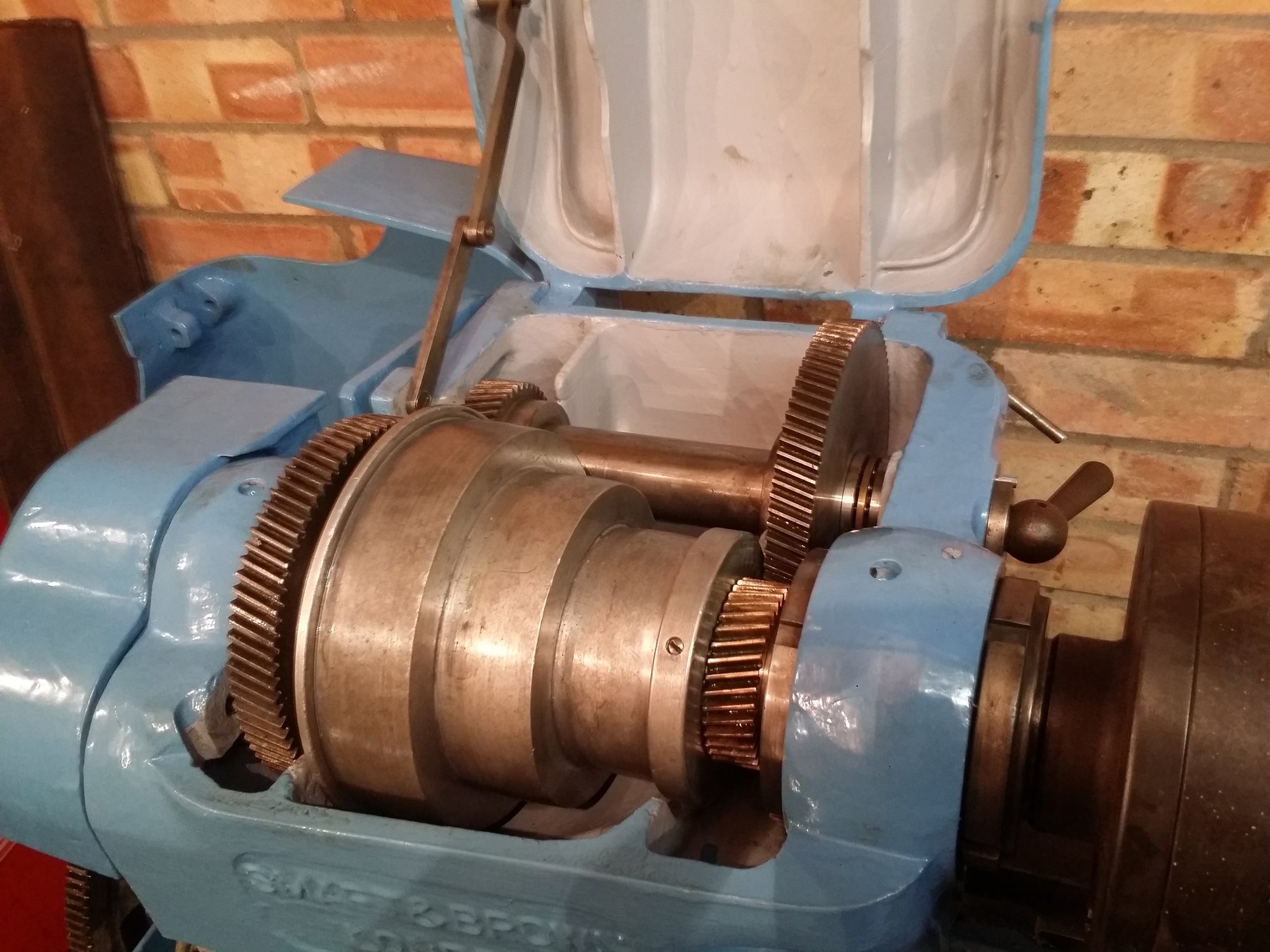

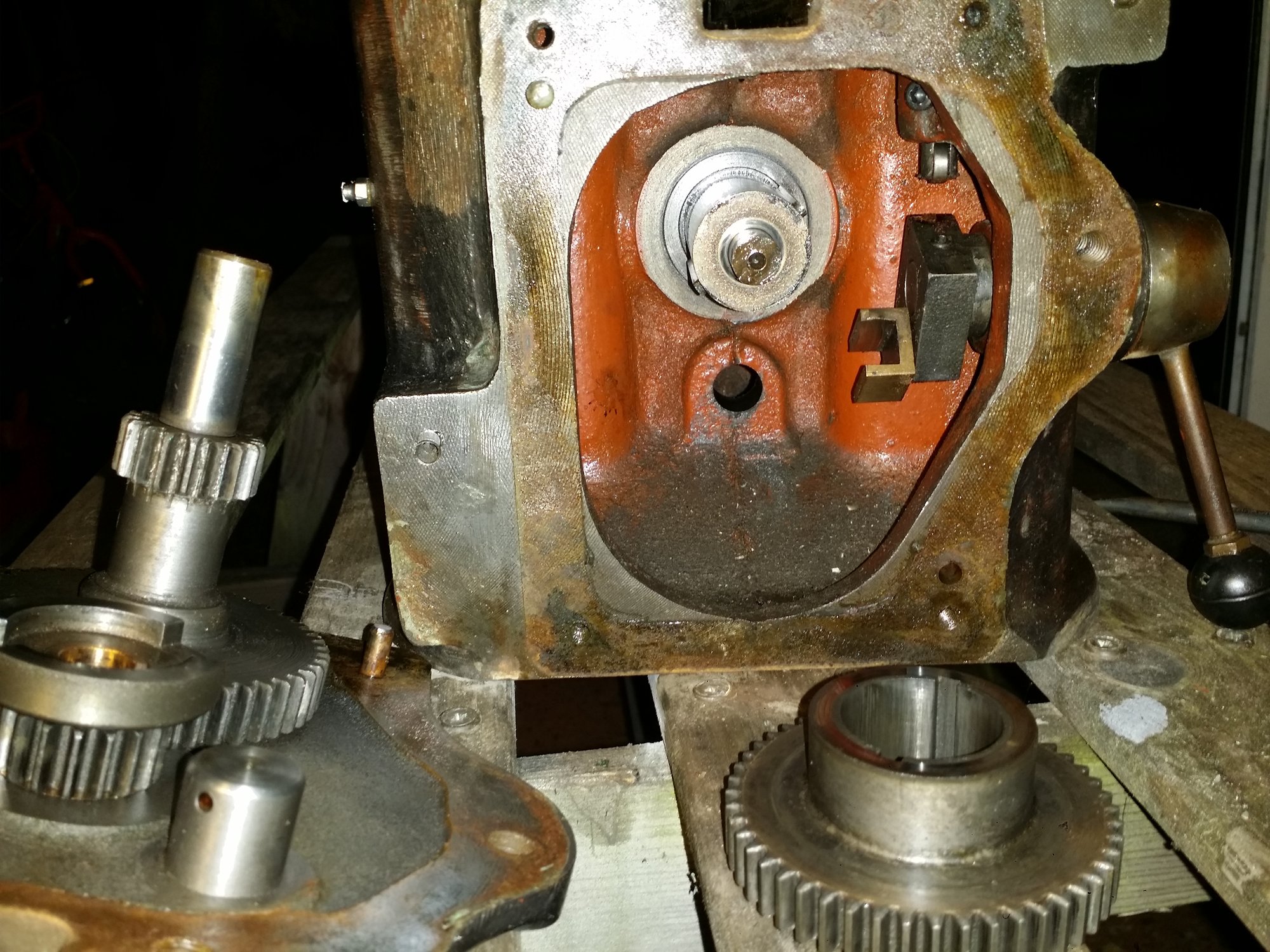

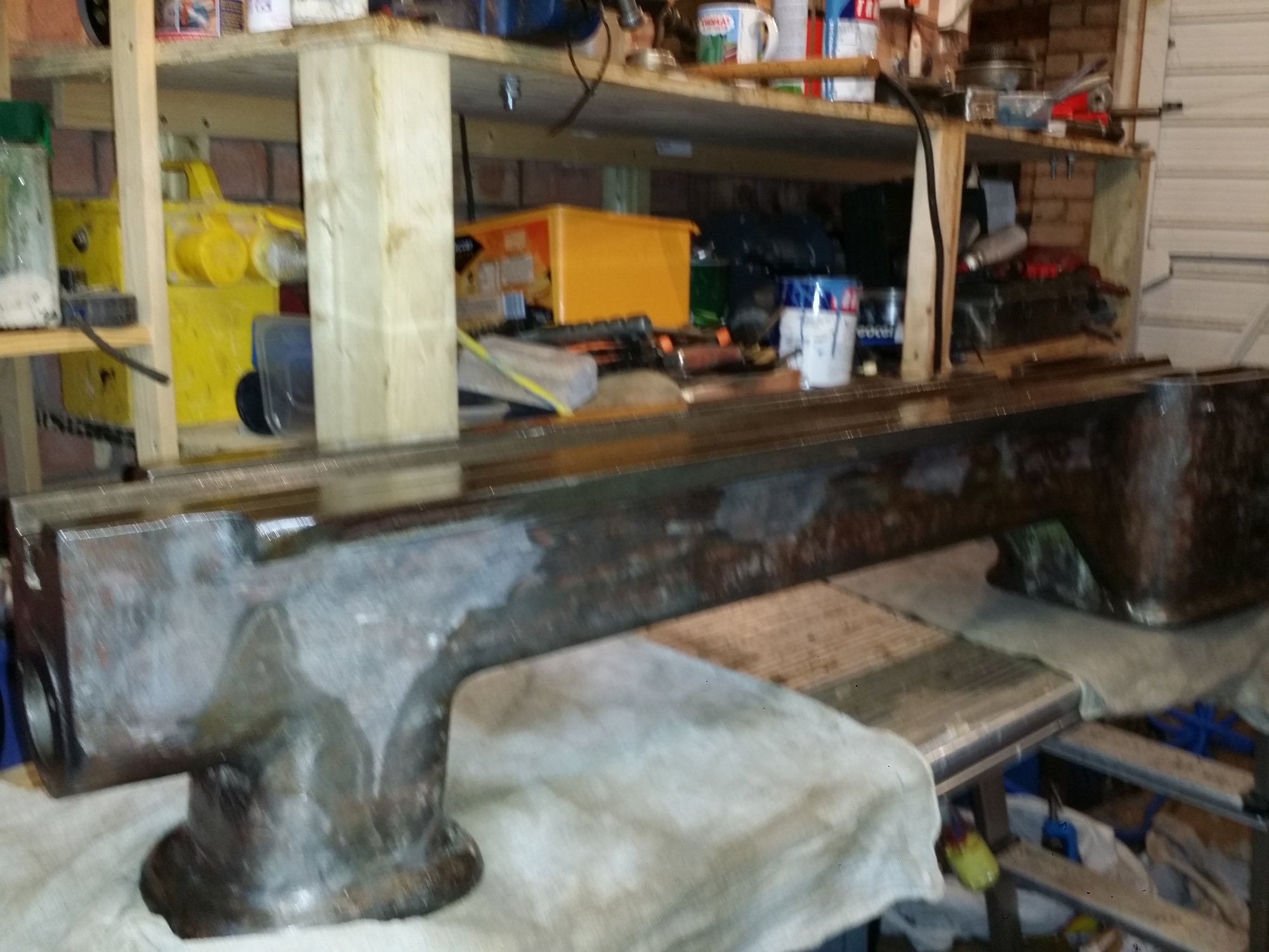

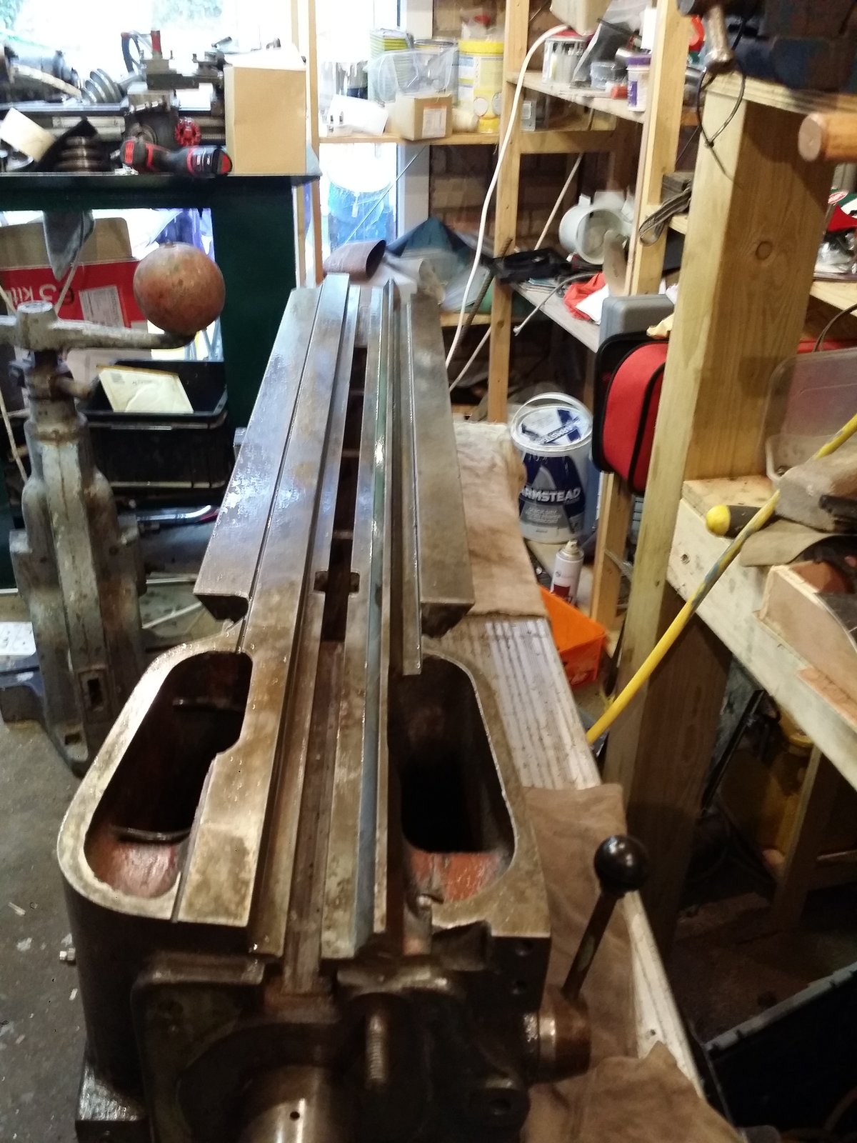

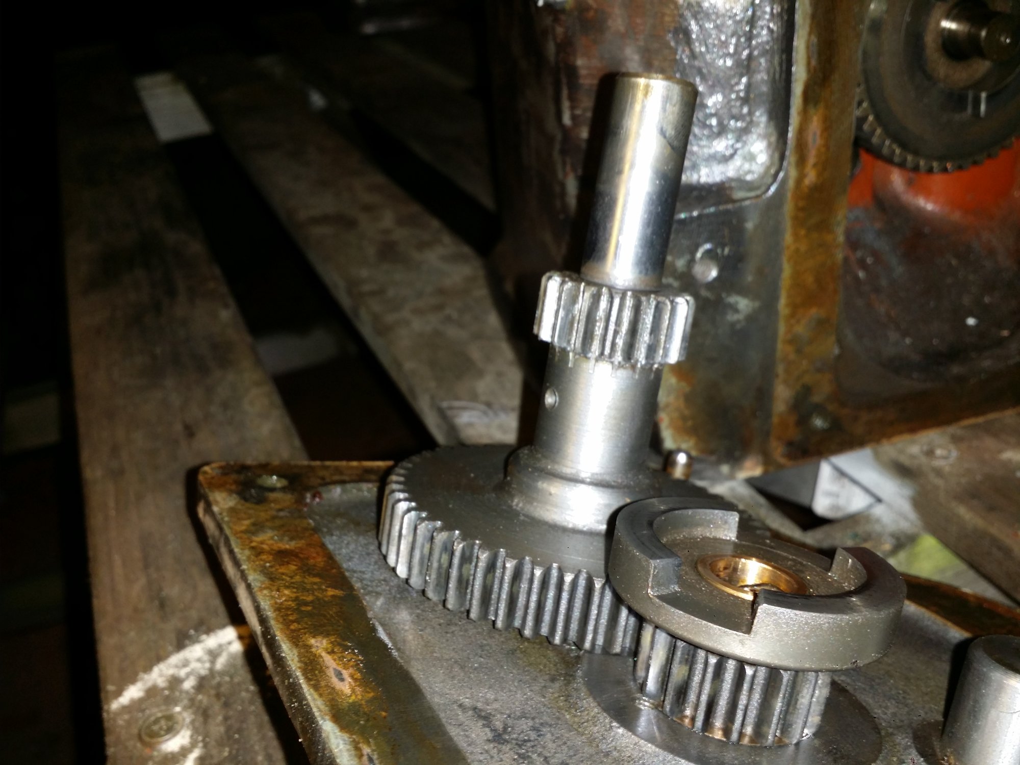

Bed isn't bolted down yet. Will need to jack it up to get the apron under. Spindle went back together perfectly a teeny bit tight but there cold. Will pay attention when running.
View attachment 121500 View attachment 121501 View attachment 121502 View attachment 121503
Chucks and collets in for the pics. Now removed.

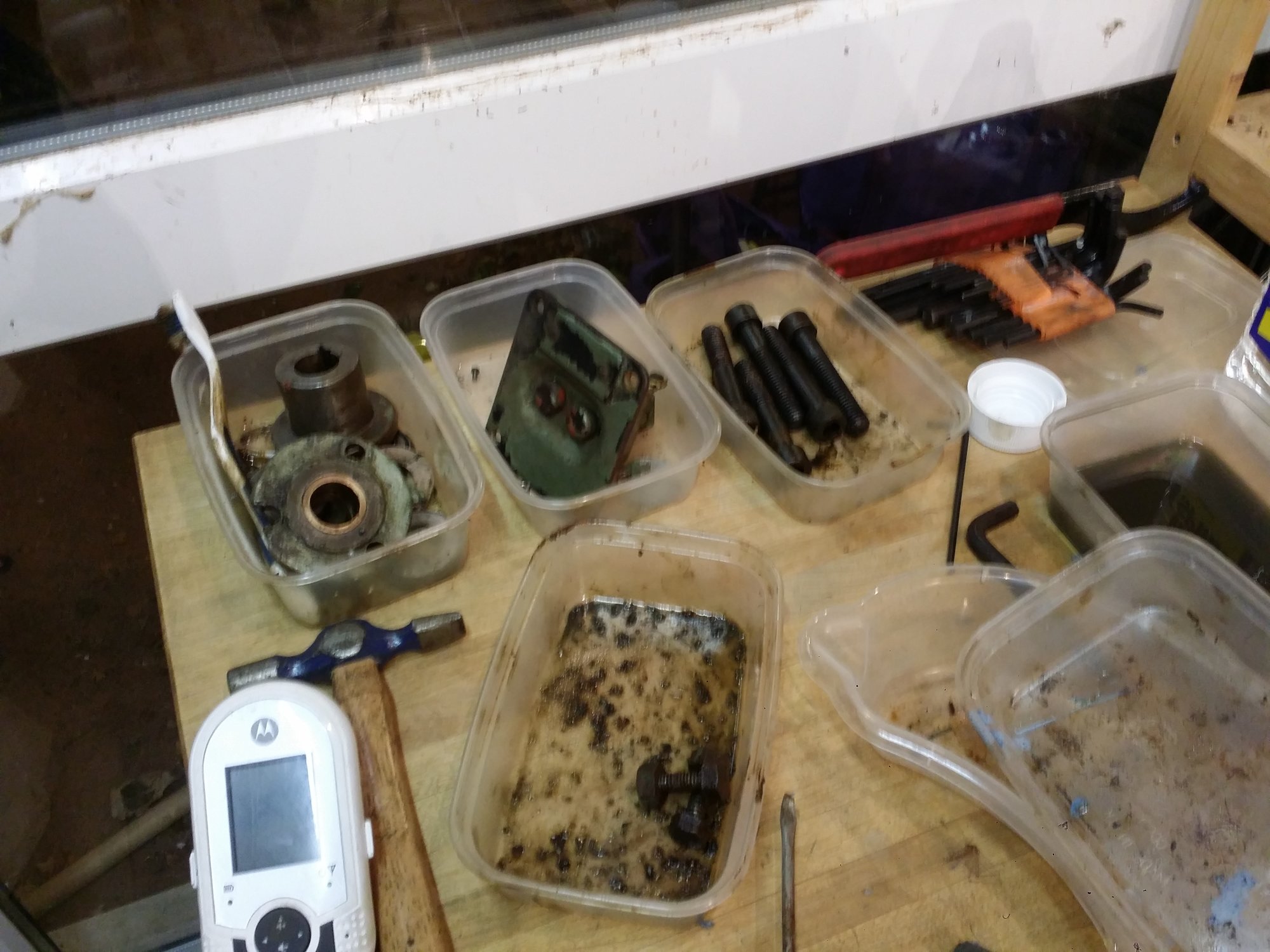

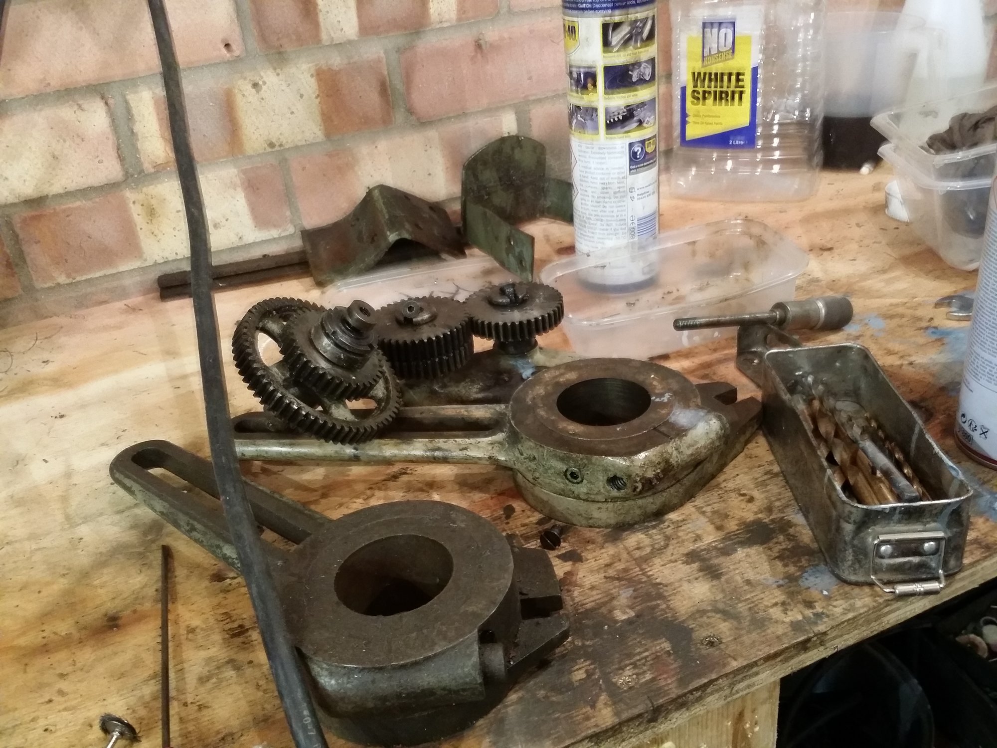

And excluding the already built apron and slides and leadscrew this is all that's left to be cleaned and fitted.
View attachment 121504 View attachment 121505
Still need to look at the motor and pulley.

same as the A then,Don't know about the MK1 but the M MK2 is 1 3/4" x 8TPI
