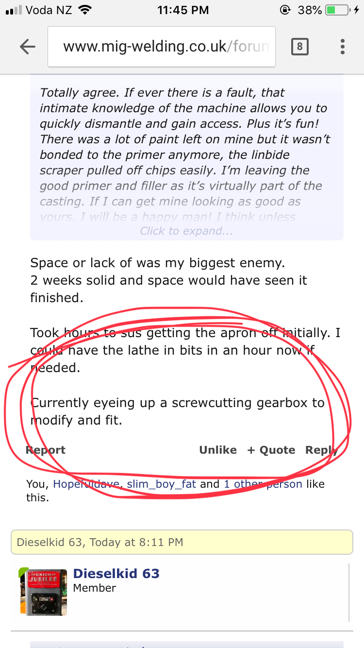

Took hours to sus getting the apron off initially. I could have the lathe in bits in an hour now if needed.
Currently eyeing up a screwcutting gearbox to modify and fit.
If you've read the thread then you'll know that he was not talking about a thread cutting geabox as you claimed. You're wrong but won't admit it.
If he wants to use the lathe as it is I have absolutely no problem with that at all. Where did I say that I did ? I made a suggestion. Am I to be taken to task for that? Did I ever say anything critical? The only person that's being critical is you.
Im quite happy to stand corrected if incorrect.You say the model m doesn't have a gearbox but on 27 th sept you said you opened the gearbox and got a surprise. It does indeed have a gearbox although the ratio is fixed.
It is this box that should be oil filled.
If you look at the black model m mk2 on the lathes.co.uk site you'll see what a difference properly cleaning the unpainted areas makes. A lot easier to do than all the work involved in repainting.
But if one takes the trouble to do a full repaint which is after all to make it look pretty why not finish the job and clean off the fine surface rust?

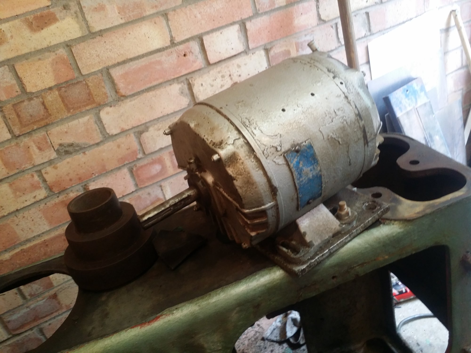

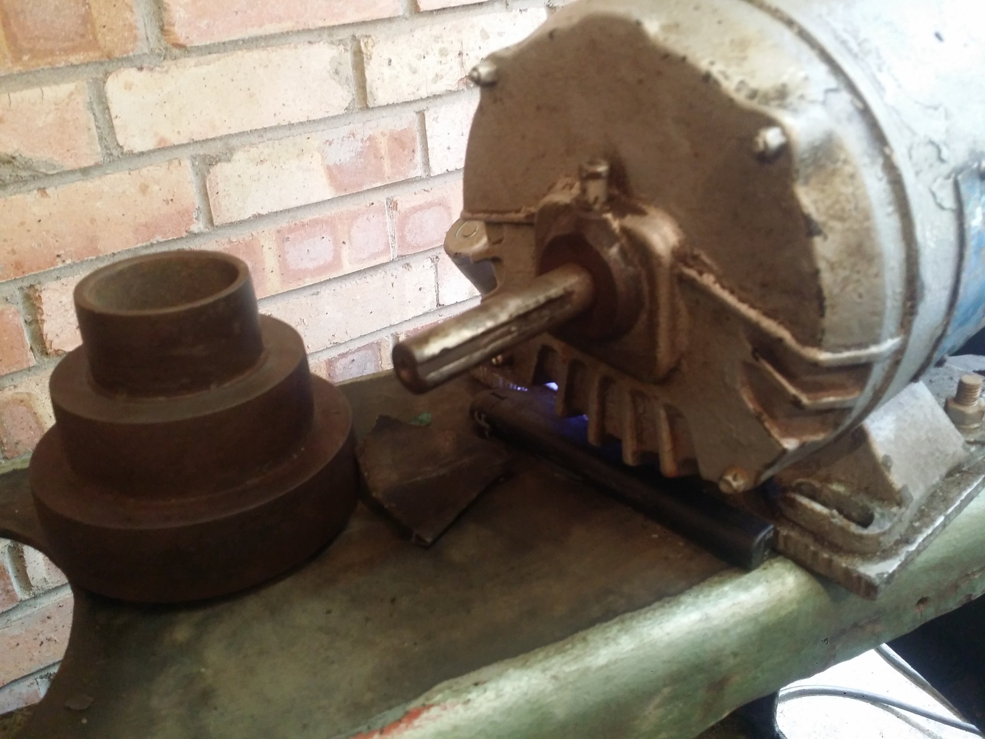

@spencer. Images above.Well the motor bearings seem fine. Not opened it up yet.
3/4hp 1440rpm I believe. Plates a bit battered.
The original pulley has had a brass bushing machined to reduce to the newer spindle. Newer spindle looks to have had a hard life. At first it almost looked as if somebody had welded a shaft extension on. Can't machine a new bushing. No lathe. Can't reface the shaft. No lathe.
Spin the motor up and file it more uniform? Then Shim the original pulley to a snug fit. Its the source of my knock. Can hear it spun by hand and its magnified when tensioned on the lathe. Slid a new pulley on with a good fit. No knock.
They didn't put a new keyway in the bushing either. Just relied on a bolt into the shaft keyway to hold it on.
Erring towards bodge as above and purchase 3/phase vfd setup for it down the line.
