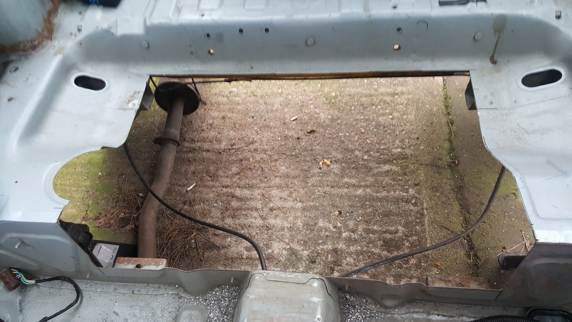

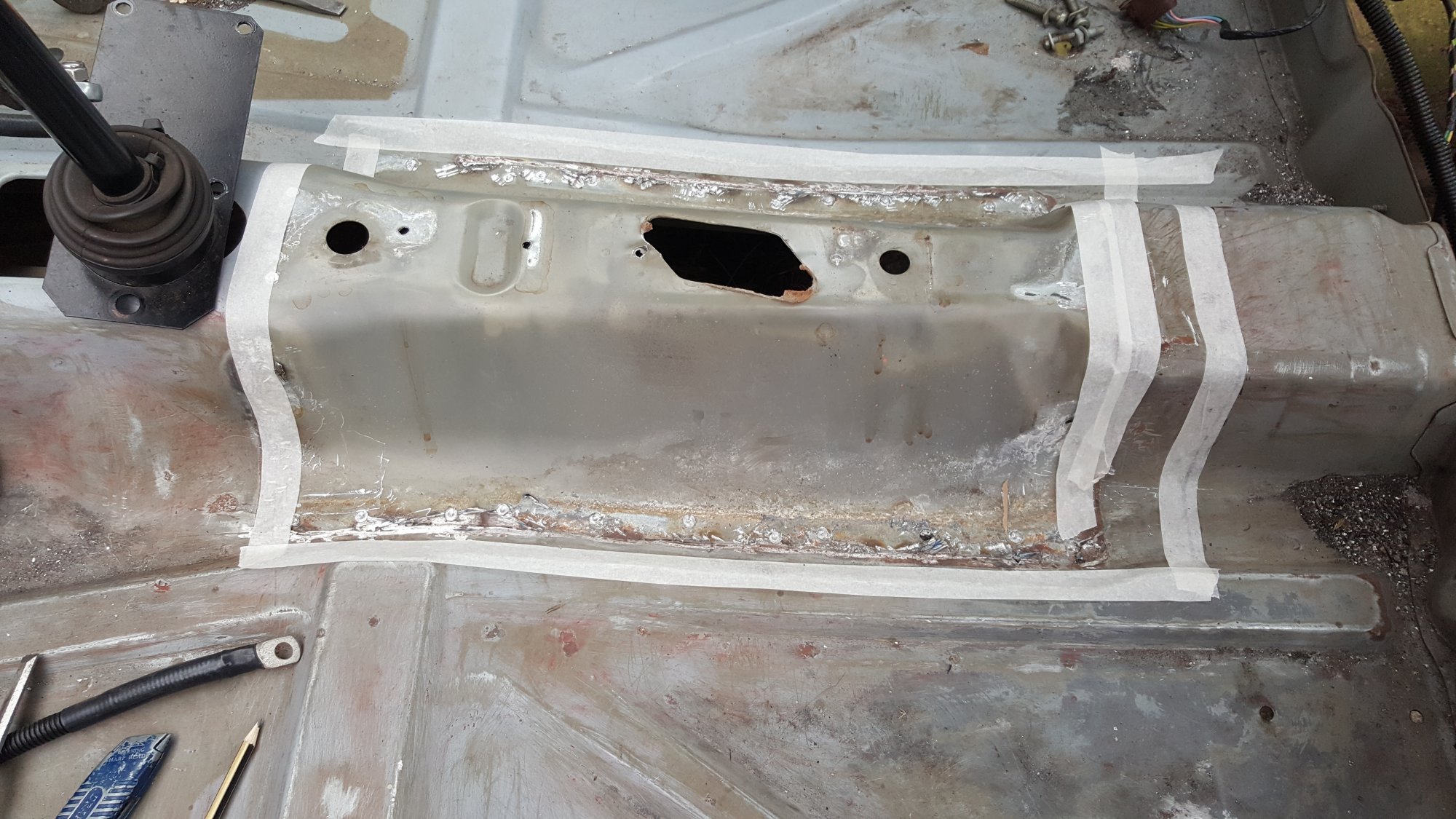

No not yet. But I will start one at some point. Had it two year. Finally got round to it. Just removed the panel that goes over the top of the exhaust tunnel that holds the seatsame in. What a fk that was to get off. Heaps of spot welds everywhere. Might just cut it out and replace with a new as damaged the tunnel getting it off. Cut the rear floor for fuel cell. My cell is a fair size as had it new for another project. Rear beam cross member was rotten so will fab a new member and install the fuel cell box with it.Is there a build diary anywhere??
Lots of curves and awkward angles to form
I thought the same thing ten minutes ago when I was sitting in the back looking at the heap of work ahead.Just change your name to Flintstone and you're sorted.![]()
