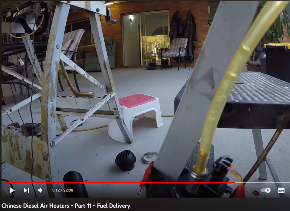

The air isn't an issue, unless the pump is drawing in that much air, the air is making it to the heater.I just ran my heaters again. Looks like having the pumps hidden in a box above the heaters isn't working. The pumps draw air out of the diesel due to the strong action of the piston inside of the metering pump. This air builds up and probably causes inconsistent fuel feed. No biggie, I'll move the pumps so each one is right under its heater.
I bled the hoses but saw that there was still a stream of bubbles coming out of the pump even though the hose into the pump was completely bled. I recently watched John's famous diesel heater videos on YouTube and he said that the air is being extracted from the diesel by the action of the piston. It's too much air... moving the pumps is no big deal and i get something more reliable.The air isn't an issue, unless the pump is drawing in that much air, the air is making it to the heater.

I've just finished moving the pumps. I put spring clips on each hose, so they're as air and fluid tight as can be. The spring clips create an even clamp force around the hose, whereas some hose clips pinch the hose and I don't trust those. There is still a steady stream of bubbles being released into the fuel but the air now goes straight up the hose to the heater without building up, so the heater is getting consistent fuel. I did notice that when the pumps were above the heaters, the metering pump frequency would change every so often as though the system was trying to adjust for the inconsistent fuel it was getting due to the air pockets.There will be a leak somewhere, it's just not always practical to cure the leak.
The type of pipe/hose used and the hose clips often don't create a perfect seal. The nipple connections into the pumps are another source, and I'm pretty sure the internals of the pump probably are not the best designed or sealed. They'll be sealed enough to not visibly leak, but the shocking likely allows them to move and let air in.

Classic youtuber who doesn't understand why something is happening.The pumps generate bubbles, see attached pic, or this video:
(the video starts at the bit showing the bubbles).
The whole video is largely about air issues.
