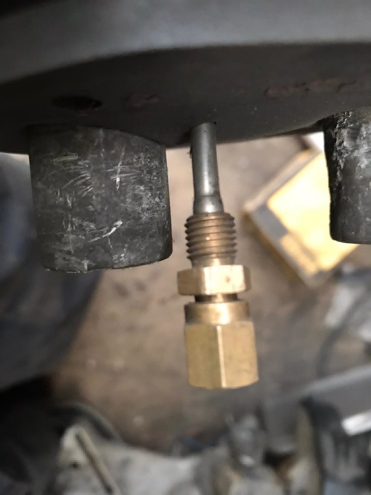

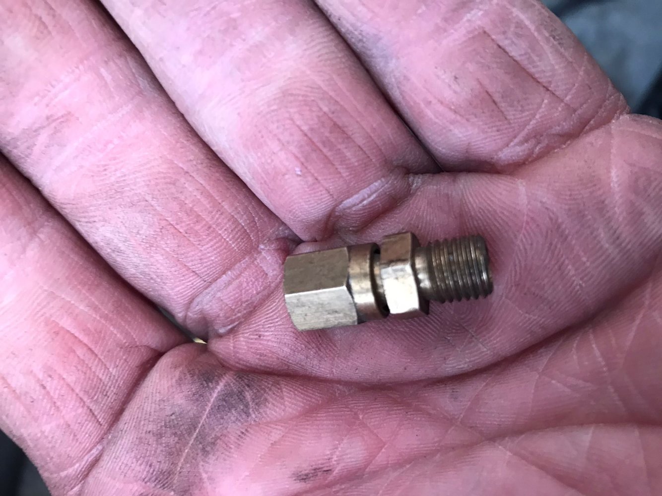

I thought about copper, but I couldn't figure out how I'll attach the copper to the heater fuel input as it has a barb/bulge, or even if I could, whether that's a good idea considering the heater may move or vibrate a bit relative to the wall mounted copper line.I tend to use the hard cunifer style pipe if it’s needed. You can get compression fittings etc to suit.

2 ways. Either use a rubber hose joiner like you would with the plastic pipe, or use a compression fitting.I thought about copper, but I couldn't figure out how I'll attach the copper to the heater fuel input as it has a barb/bulge, or even if I could, whether that's a good idea considering the heater may move or vibrate a bit relative to the wall mounted copper line.

You may need to cut the ‘bellend’ off the input. Use a “bite olive”, normally used for gas.
I’ve done that many times and not had a leak. The vibrations between the two is negligible if it’s installed well.
Mount the pipe on p clips to insulate it further from movement.
Haven’t cut that input but just to show you it goes straight on.

Make or get someone to turn up a compression adaptor & soft copper olives & cut off the bulbous bulgeI thought about copper, but I couldn't figure out how I'll attach the copper to the heater fuel input as it has a barb/bulge, or even if I could, whether that's a good idea considering the heater may move or vibrate a bit relative to the wall mounted copper line.

i just used copper/kuniper brake line, and put a slight flare on the ends with a brake flaring tool, then just used rubber fuel hose and decent hose clamps to secure it allI thought about copper, but I couldn't figure out how I'll attach the copper to the heater fuel input as it has a barb/bulge, or even if I could, whether that's a good idea considering the heater may move or vibrate a bit relative to the wall mounted copper line.
