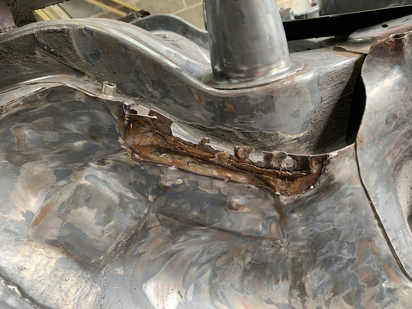

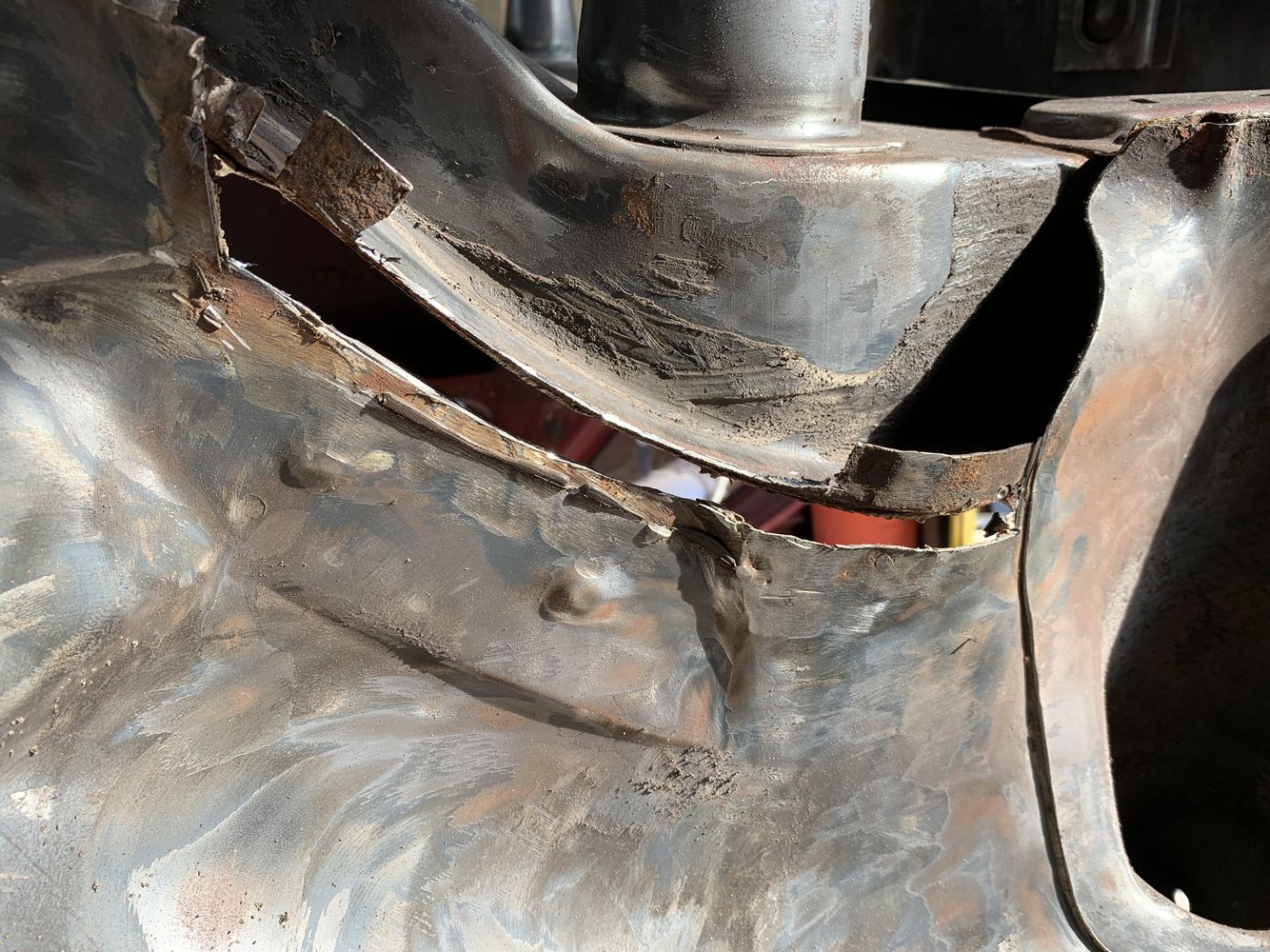

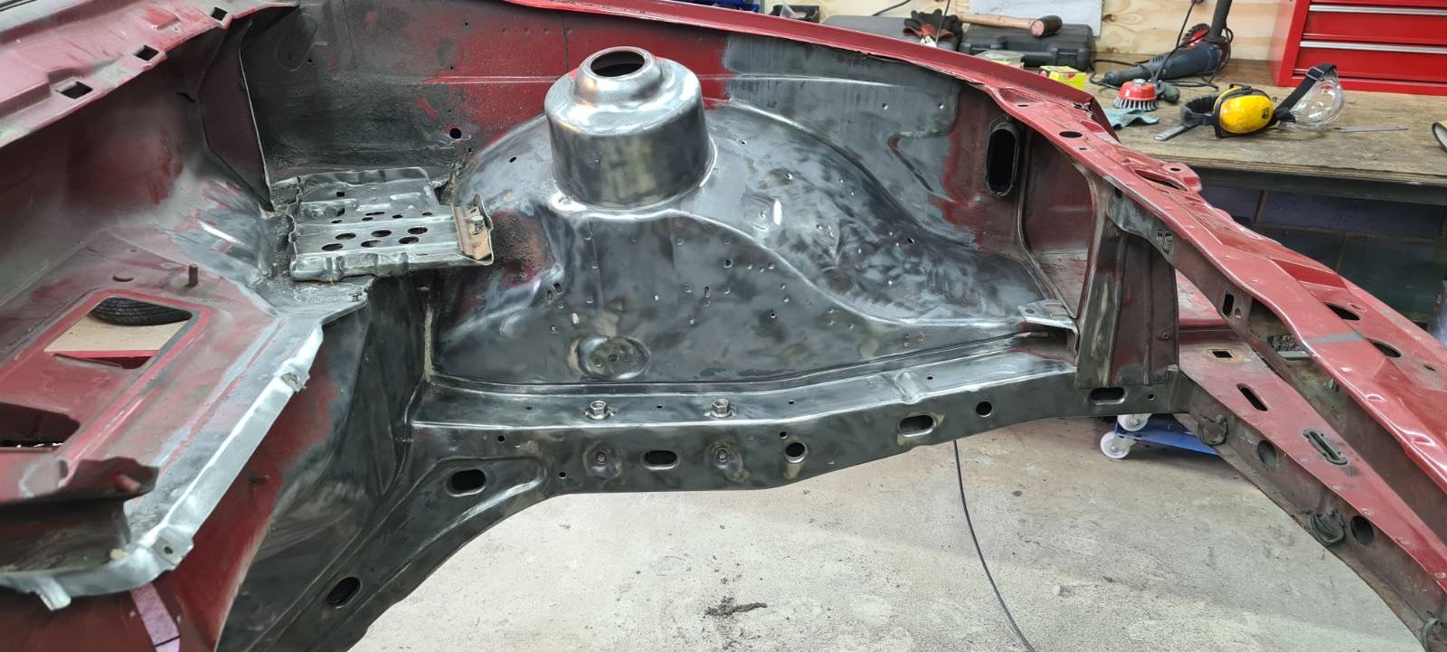

A standard hammer will get you there ,, no need to make things tricky , I use a snap on dead blow hammer for this sort of work , with a re profiled round end and it works grand .Great idea!! And some fine work on that Alfa.
yes, I could make a former either out of hardwood or steel like DCAL did and then form into it.

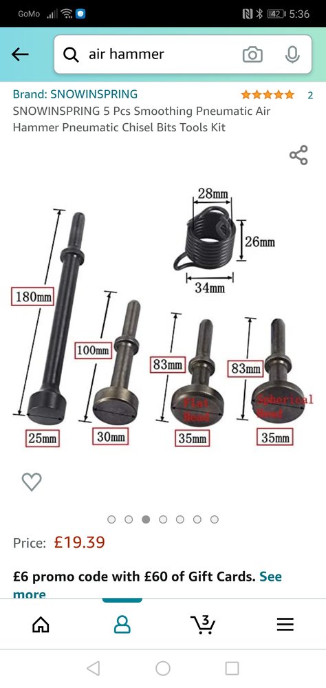

Can you get something like a ball pein end for an air hammer?
.. .. especially at this price
