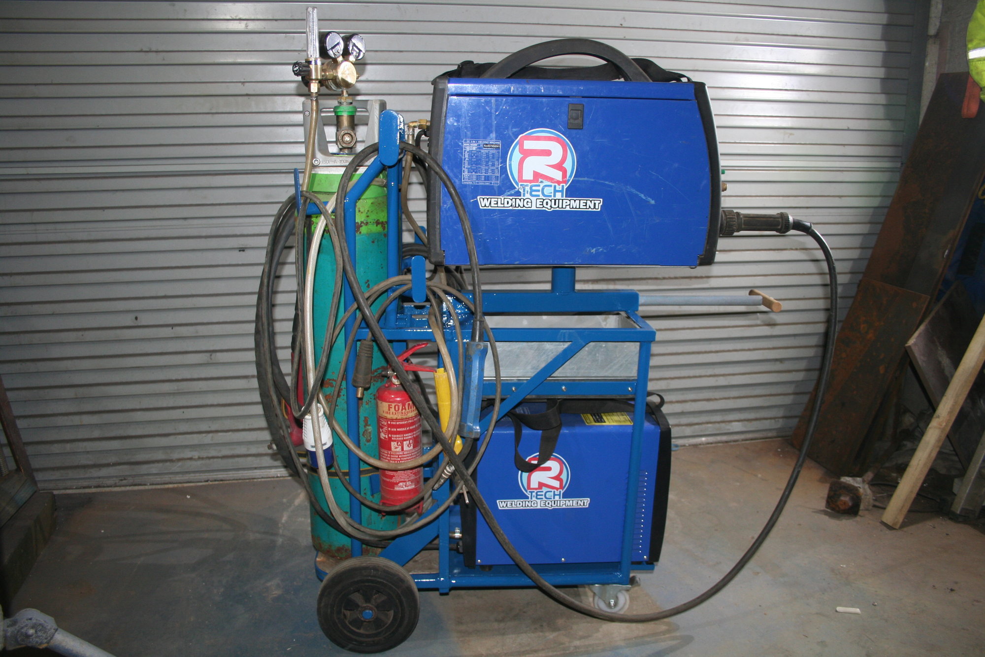

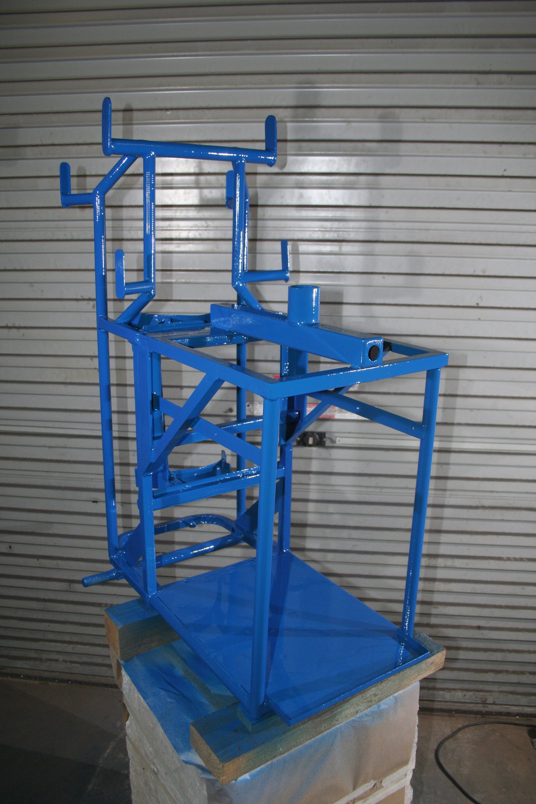

A couple of coats of Ford Tractor Blue certainly helps the look of it.
I wasn't trying to match the Rtech colours, I just got into the habit of painting most of my tools Ford Tractor Blue when I had some left over.
Let it dry overnight and then started assembly.

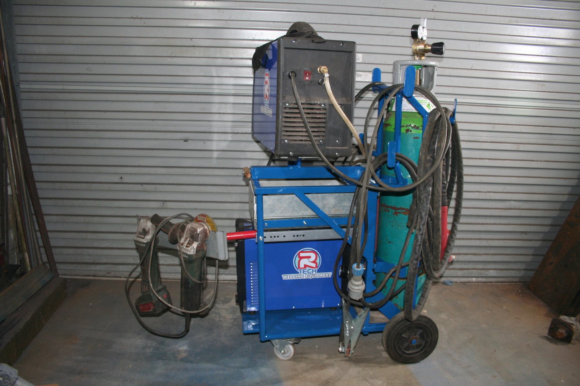

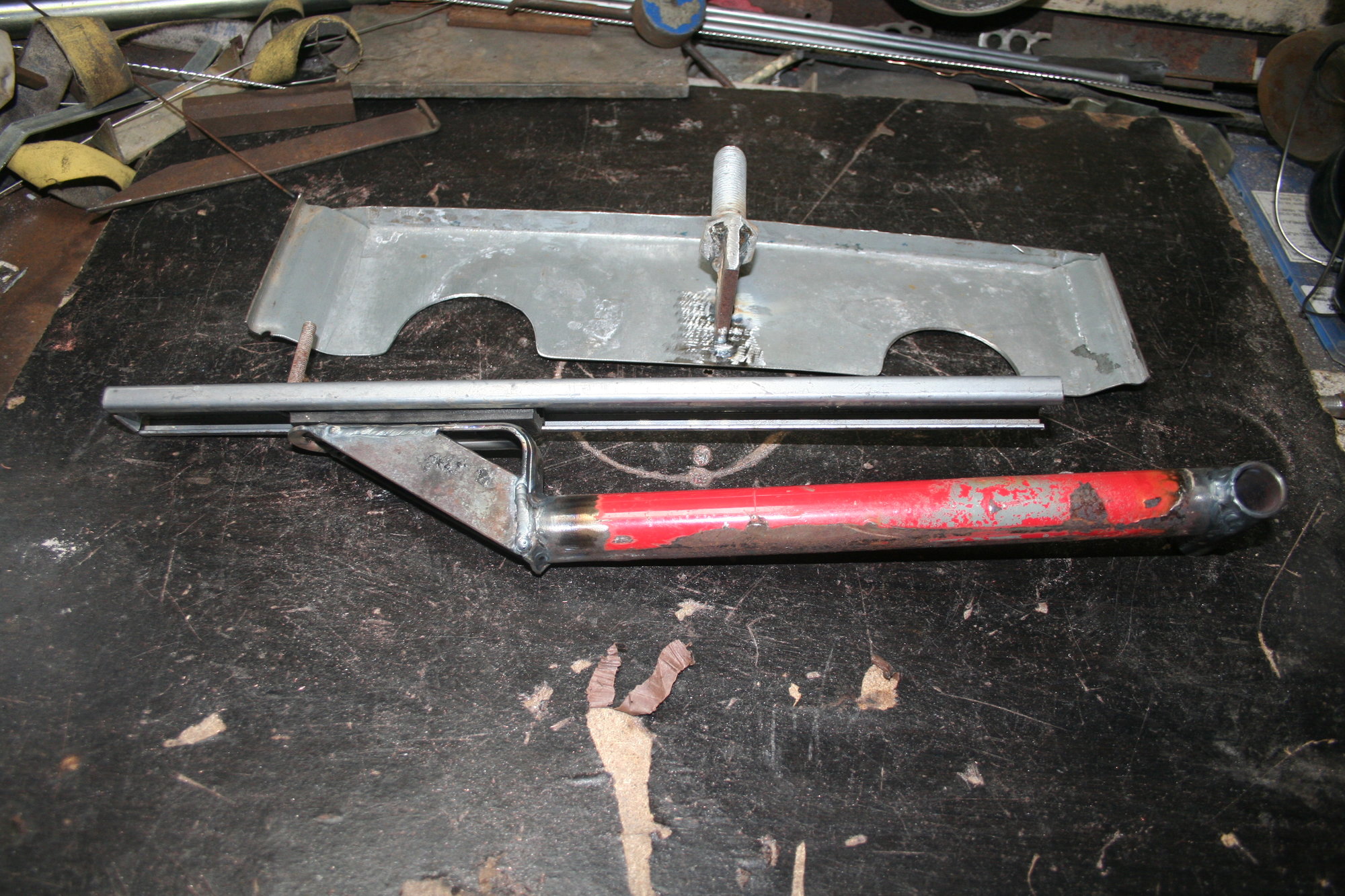

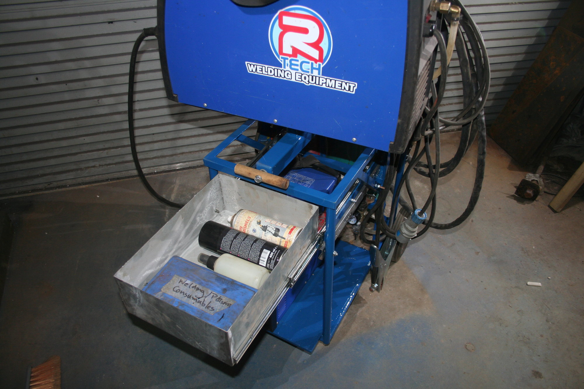

In the gap to the right of the plasma I made a pull out grinder stand from a tie rack I found laying about.
It's probably too light weight but I'll see if it lasts or gets used before beefing it up any more.
The grinder stand works quite well and it might help keep the leads tidy.
I will soon see if it's an ornament or a useful addition.
Also found a bit of spare space for a small fire extinguisher to live.
I think I'll change the extinguisher to a CO2 one.
Remaining things to do are, fit a lid to the top of the drawer to stop it filling up with grinding dust, make a cover for the plasma for when it's no being used and make proper handles but all in all it works well.

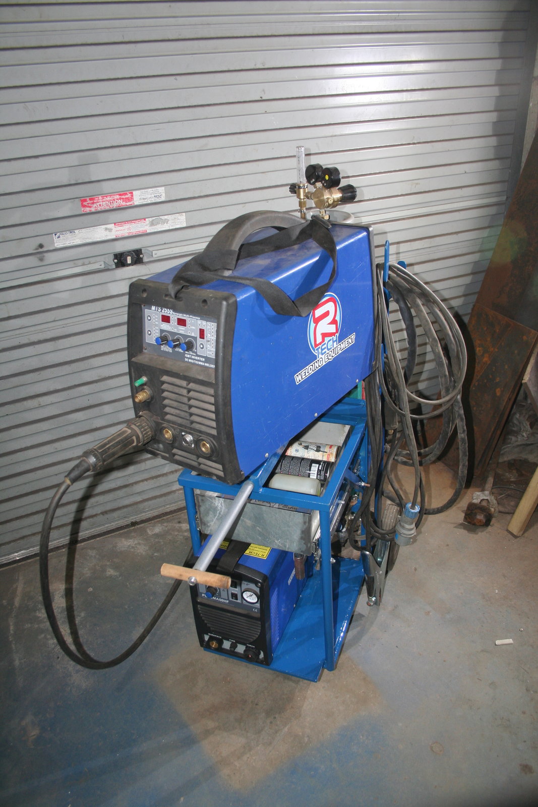

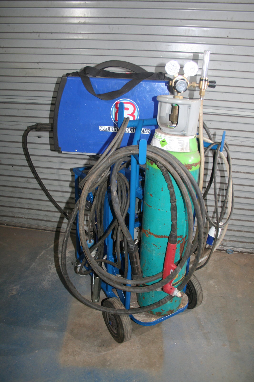

If I was making it again I would make the frame longer as the lower shelf is really too short for the plasma (I had to relocate the air regulator) and the on / off switch is hard to get to on the plasma (the on /off switches on both of the Rteck kit are on the back which I think is a major design flaw.)
What I wanted, was a compact cart that was only as tall as it needed to be and I think it ticks those boxes.
It's no top heavy and moves about nicely.
It was made specifically to the dimensions of my EWM Phoenix 355 with separate wire feed unit so unlikely many would want one.
