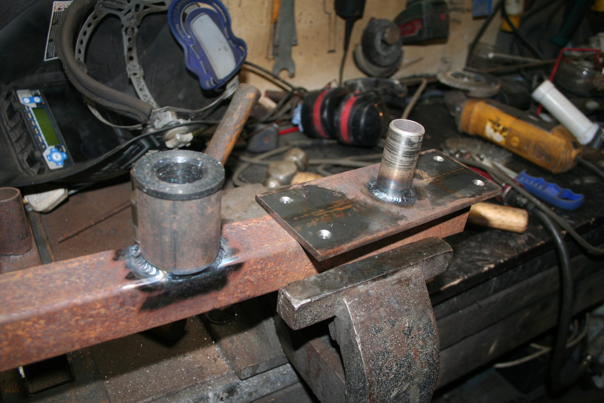

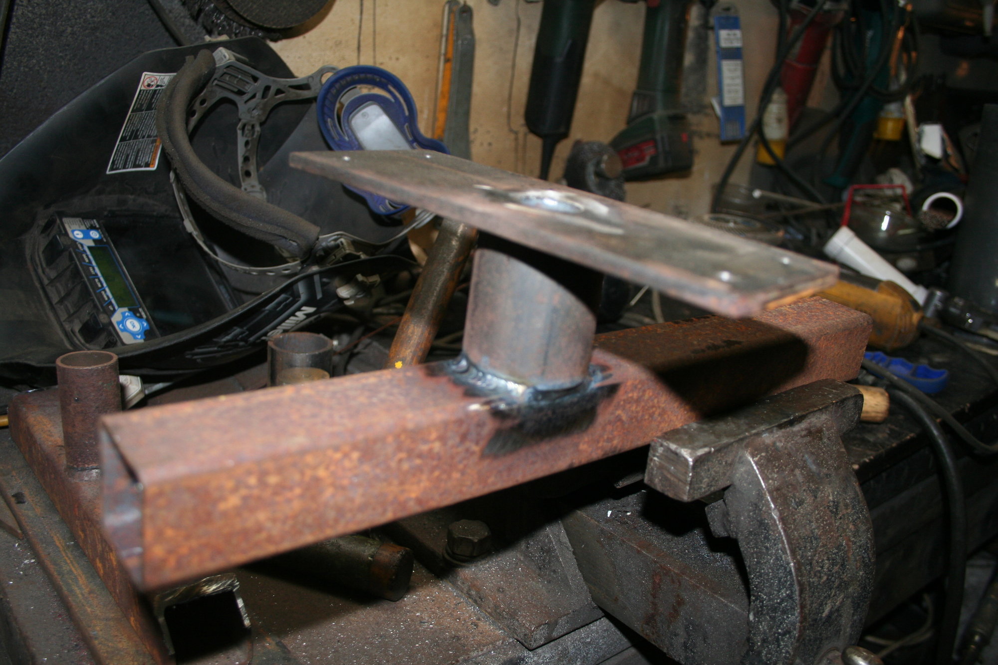

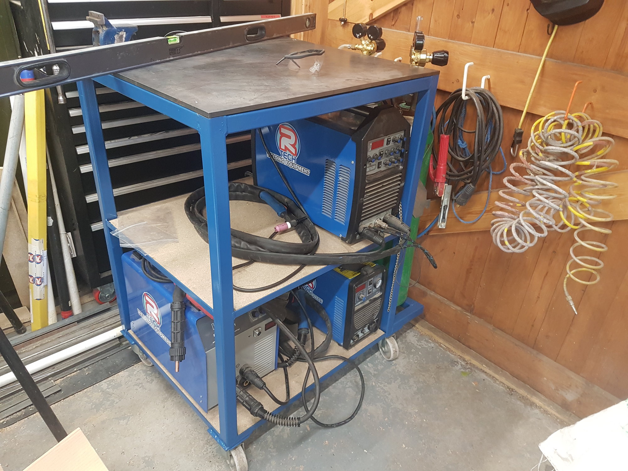

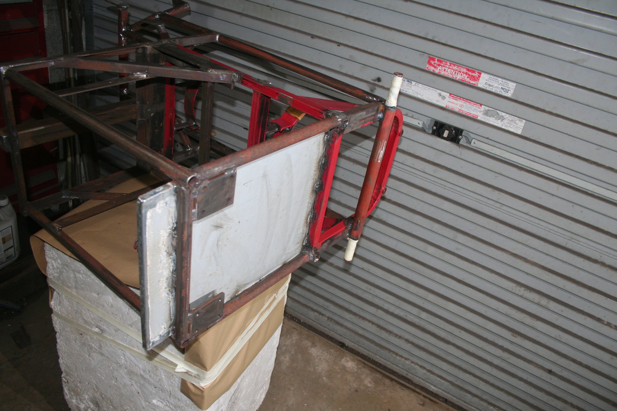

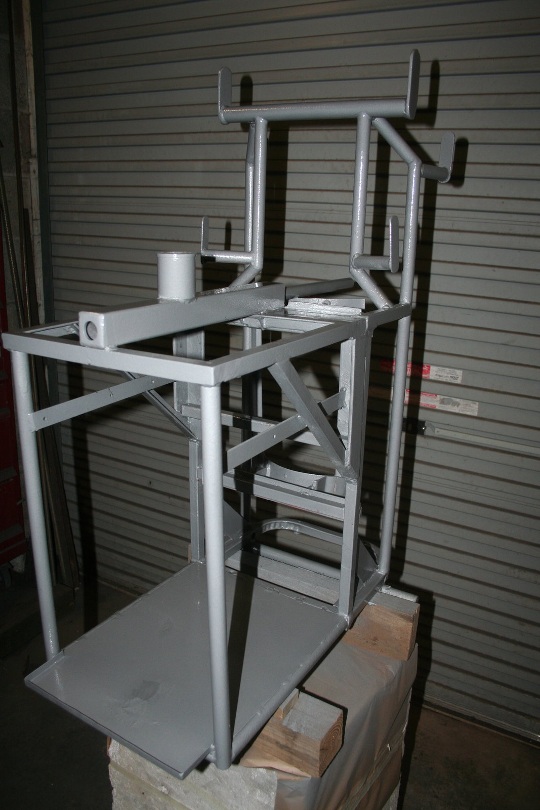

If anybody is interested how its laid out, a closer look.
The welder pivots out on a double layer shelf unit, with the foot pedal under the inverter, the earth and tig torch hang on the side, the whole unit just lifts of the pivot pin post.
Stored in the box is an electrode stinger and a 17 gas cooled tig torch for max ampage tig.
More pics please. That is the smartest and best laid out site box I've ever seen - I love the pull-out swivel base for the welder!The box has now been updated, with a para weld water cooler and a 25ft water cooled 20 tig torch.

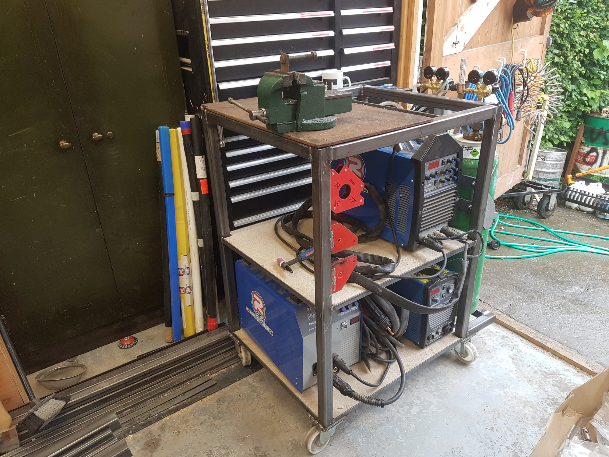

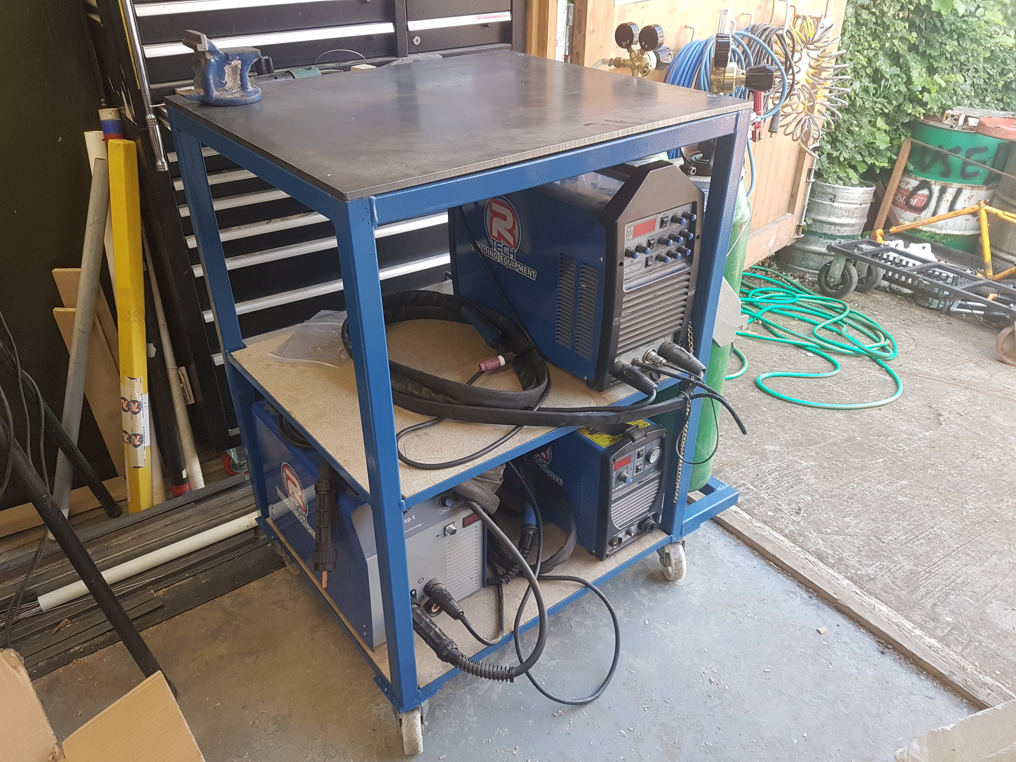

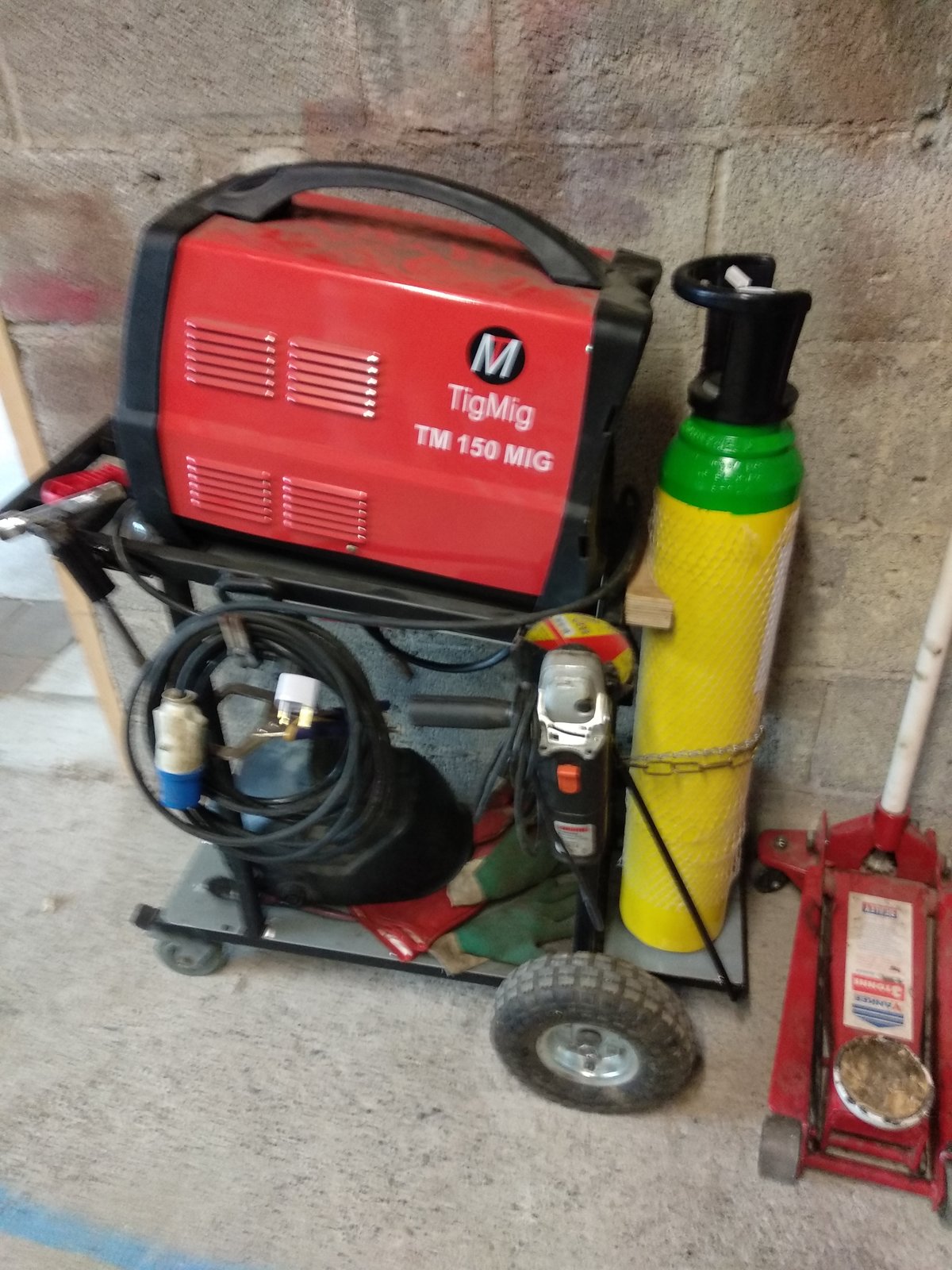

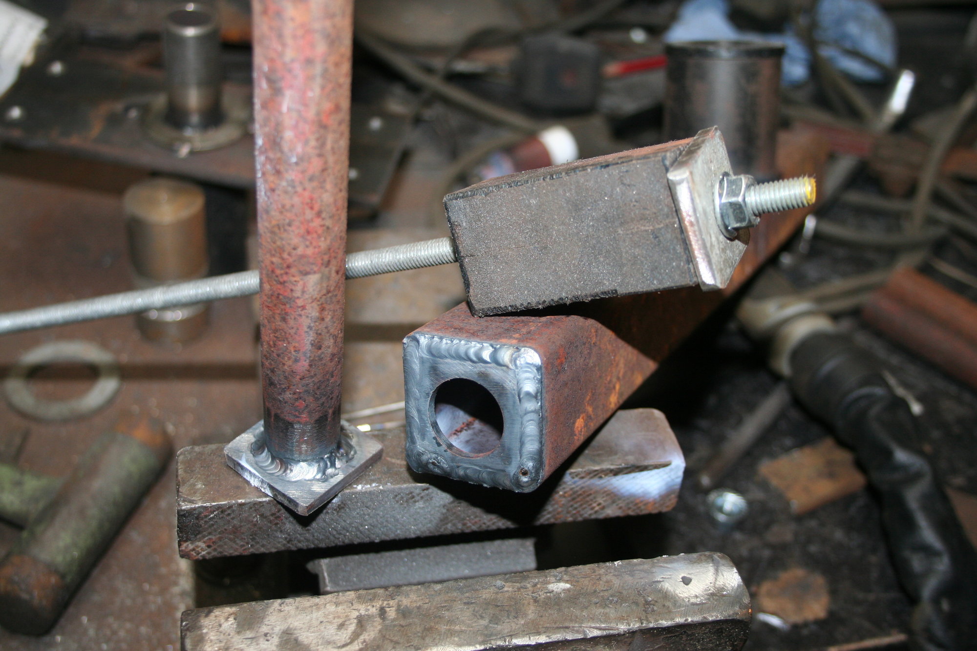

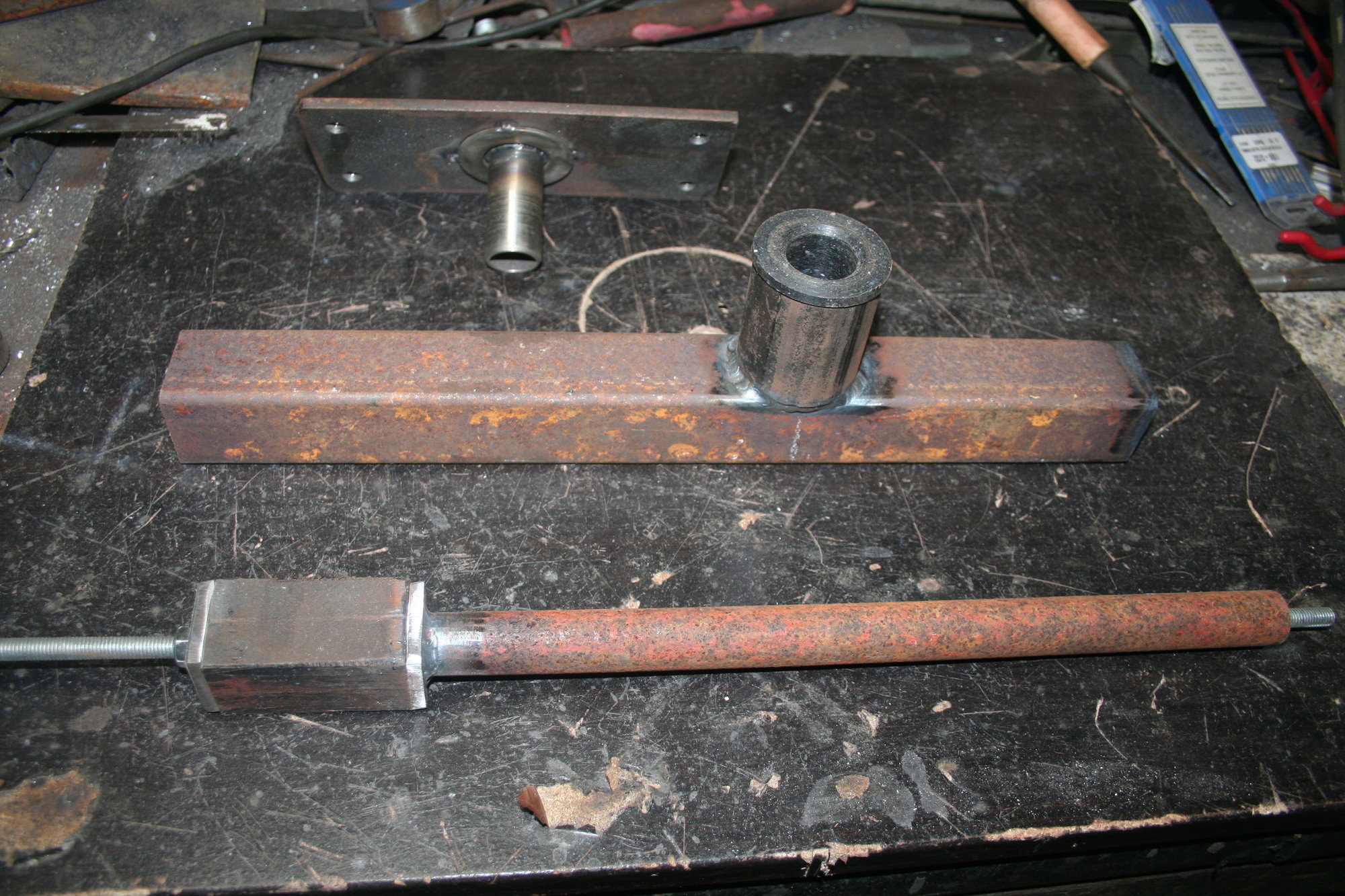

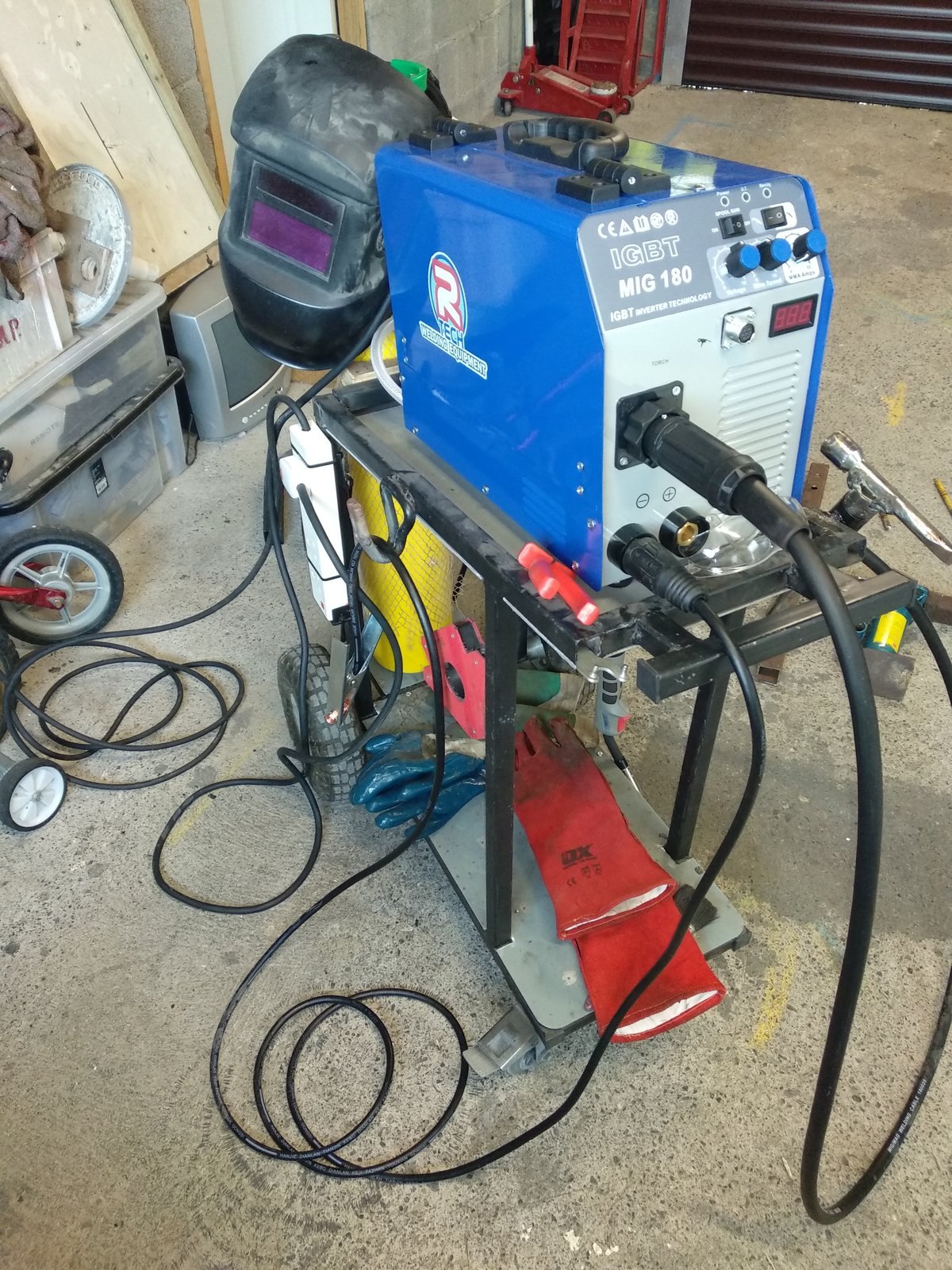

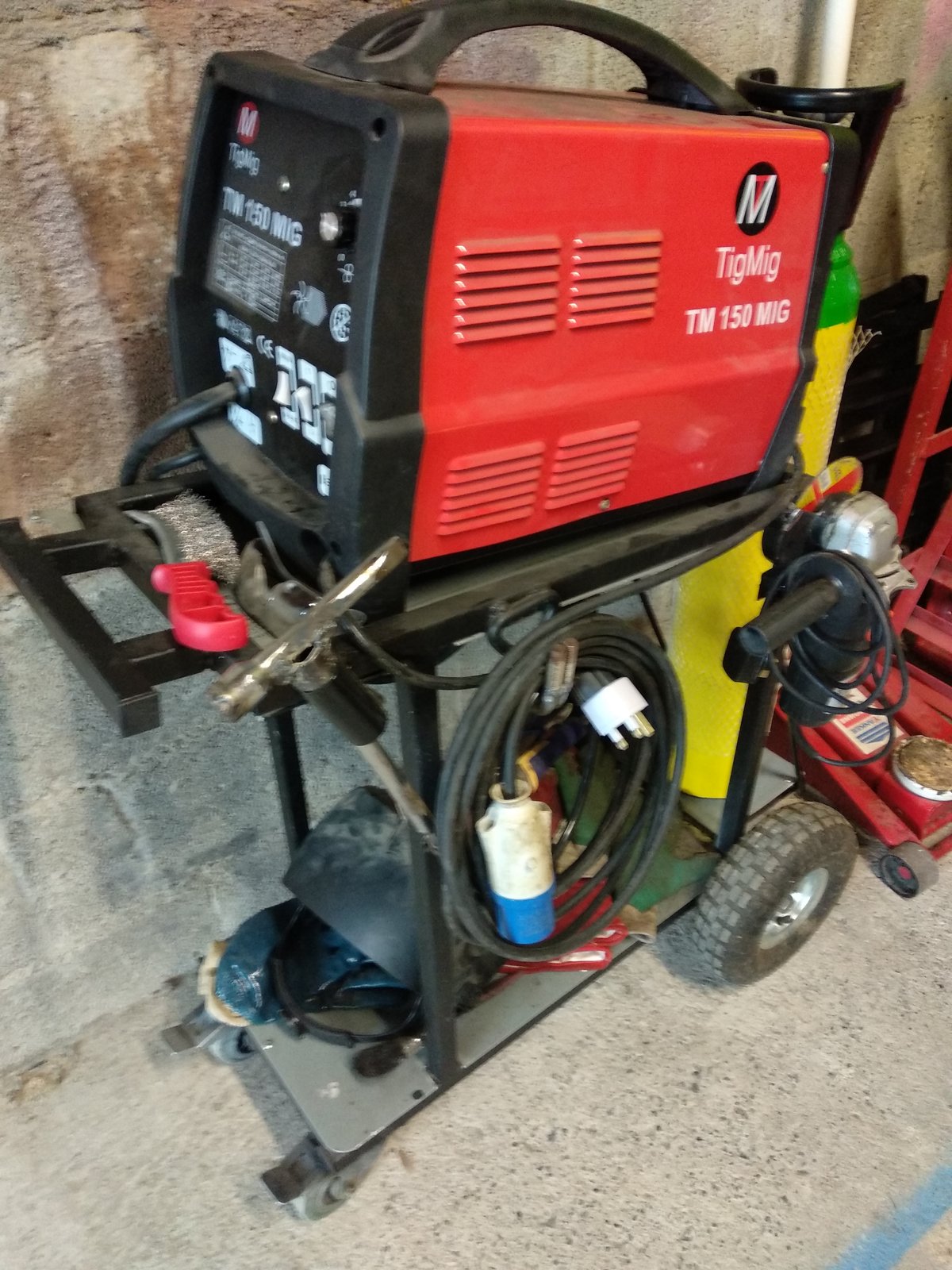

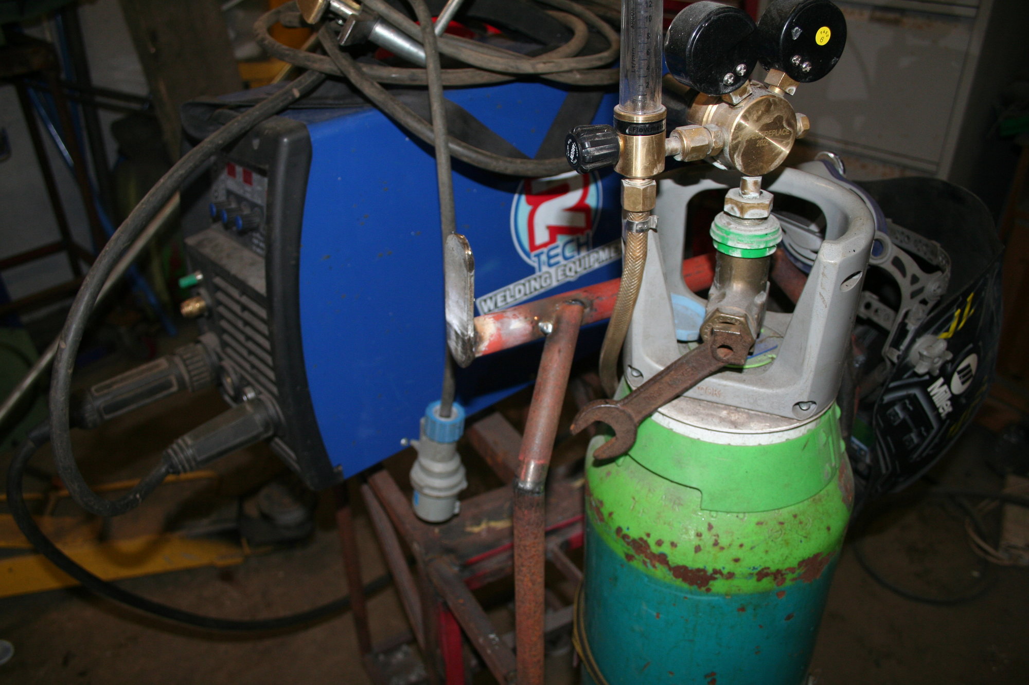

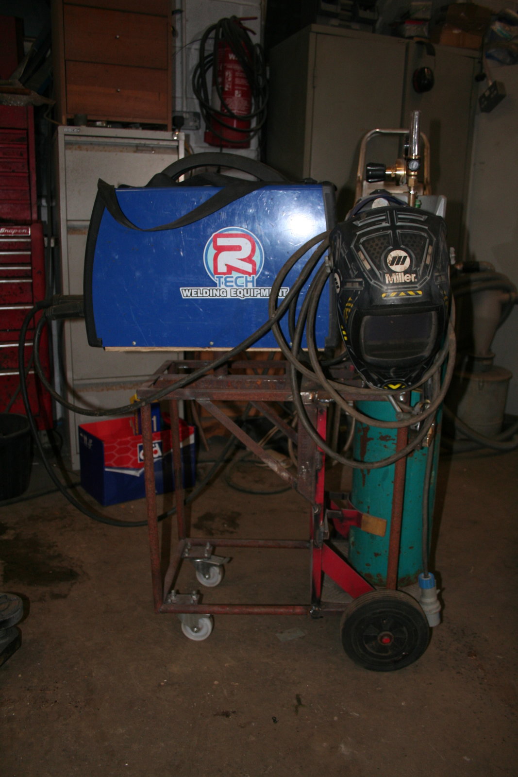

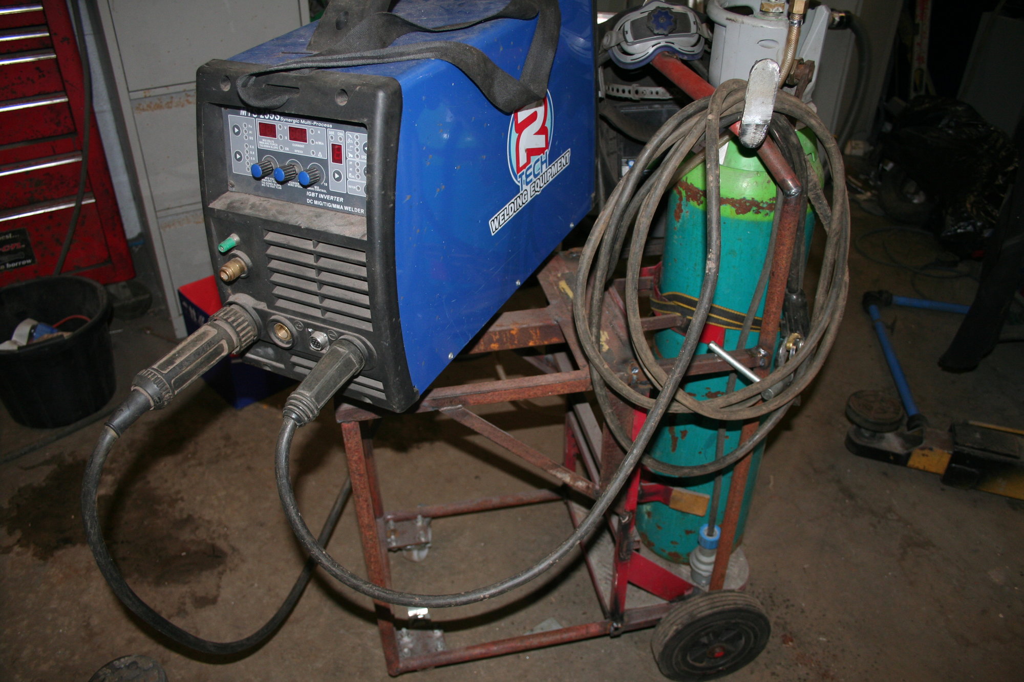

This is where I'm at with a trolley for my mig.
It started out as a fire extinguisher station that I pulled from a skip which turned out to be made of very light tube and box.
I should have put it back in the skip and started from scratch.
Maybe next time.
I wanted it to be as low and compact as possible and I also wanted the welder to swivel on the trolley so I can get at the front panel without moving the whole thing.
Added a couple of hooks to have somewhere to store the leads tonight.
At some point I'll call it finished and give it a coat of paint, but not just yet.

Top job ,especially the top plate, might be an idea to put some plate vertical at the bottle end to stop those gauges getting smashed
Do you think I might be spending too much time on this? I certainly do.
I really like the rotating top, mine will probably end up over engineered with taper roller bearings and a brake then hardly ever get used.
