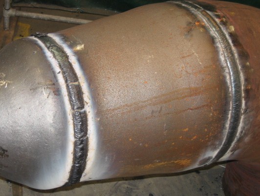

dont want 2 sound stupid but what is 5g and 6g??? that is serious welding there lads, give urself a pat on the back lol

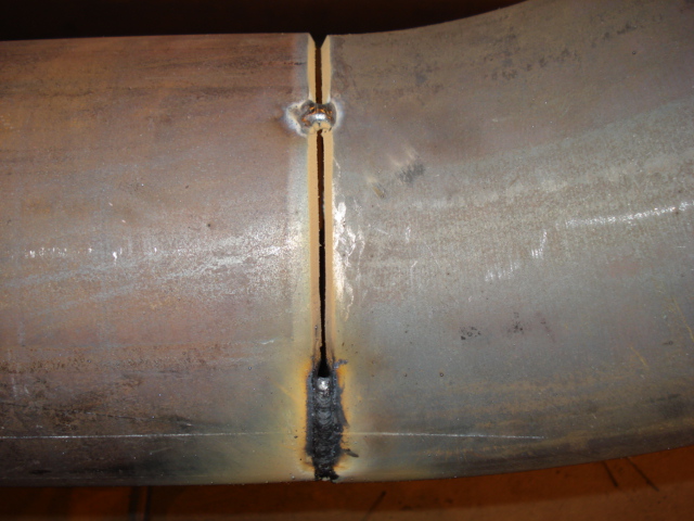

nice job runnach, i do this almost every day so these welds are prepped and ready its no effort, you on the other hand took the time its appreciated. the only thing i differ in is that i tend to stick with 2.5 on 4inch.

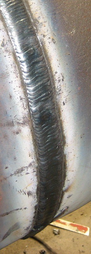

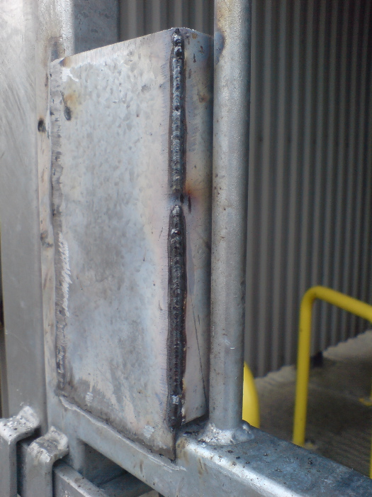

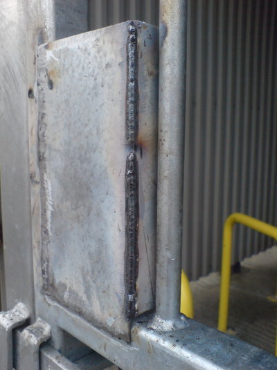

Here y'are Snowy. Spot of stoving I did today while making a lock box for a storage unit. Thin galv sheet (2mm?), so used a 6013, 1.6mm rod, possibly old BOC Saffire, don't know any more. Elec neg, about 30A. Keep ahead of the slag!!!
And please, don't mention the inclusion 4/5 of the way up, it wasn't a critical weld![]()
Ohhh spotted it, I do hope your going on UKW to tell em your the biggest balled stover to ever walk the earth now

Runnach, nothing so maritime. Loanhead. Inclusion due to operator second-rateness. No excuses i'm afraid.

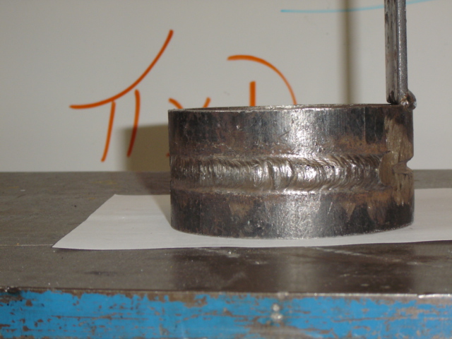

couldn,t even face a 5g so i did it in 4 quarters. f/j
