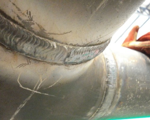

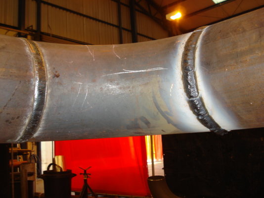

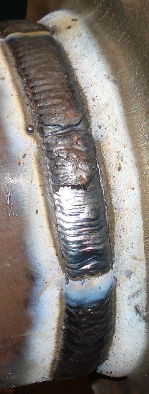

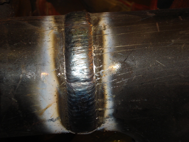

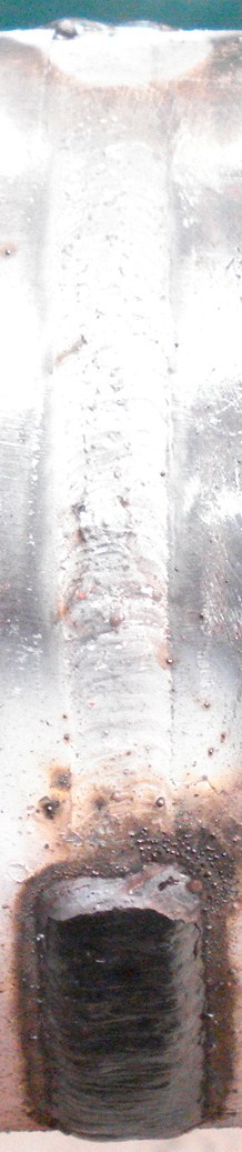

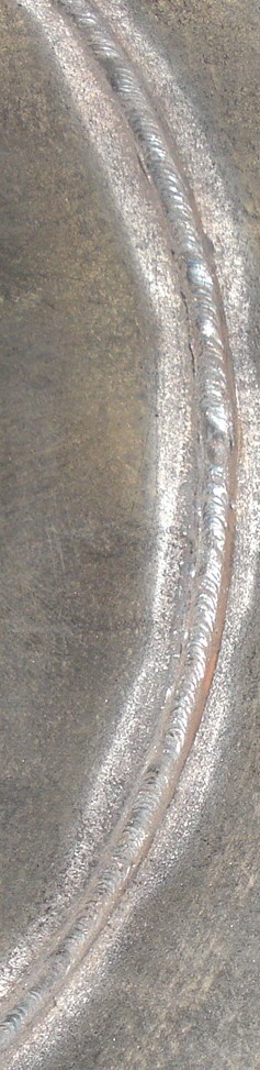

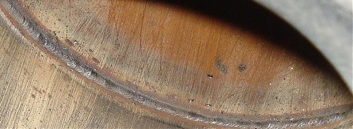

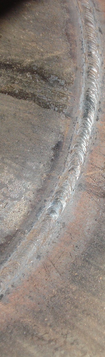

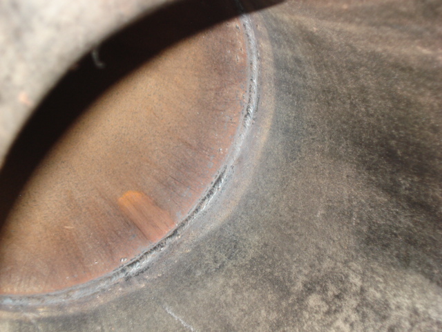

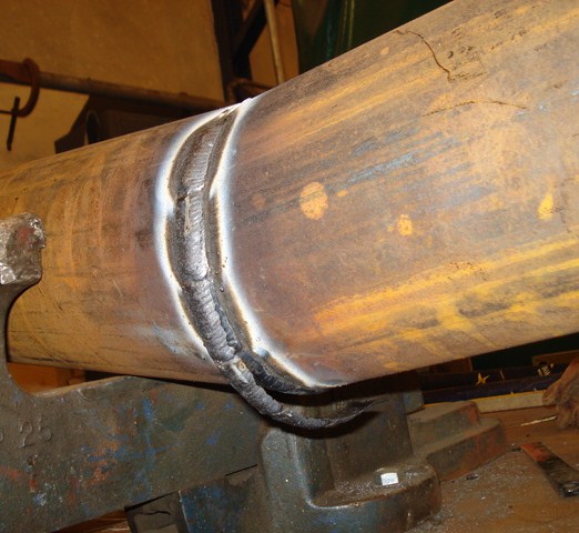

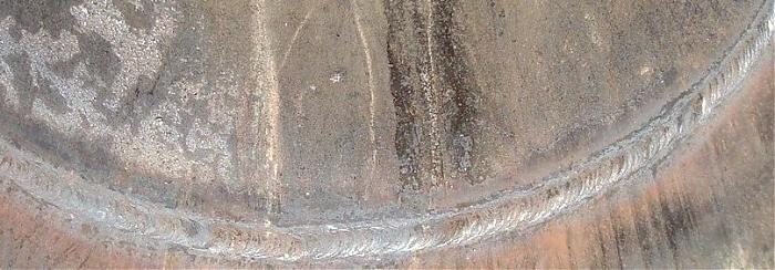

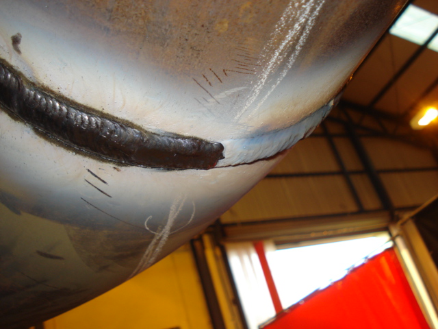

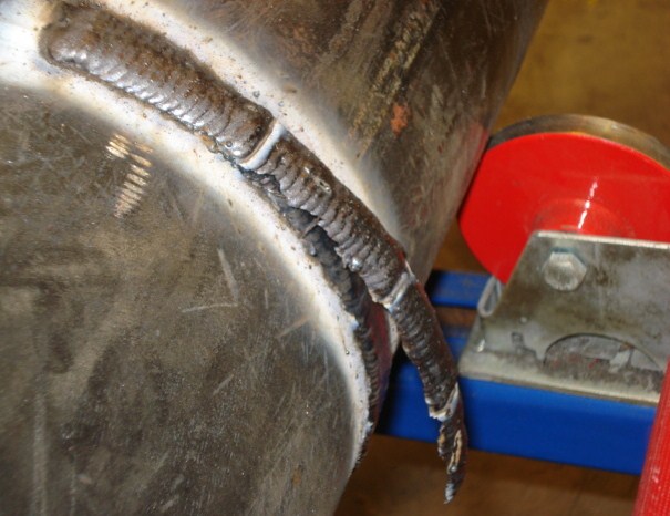

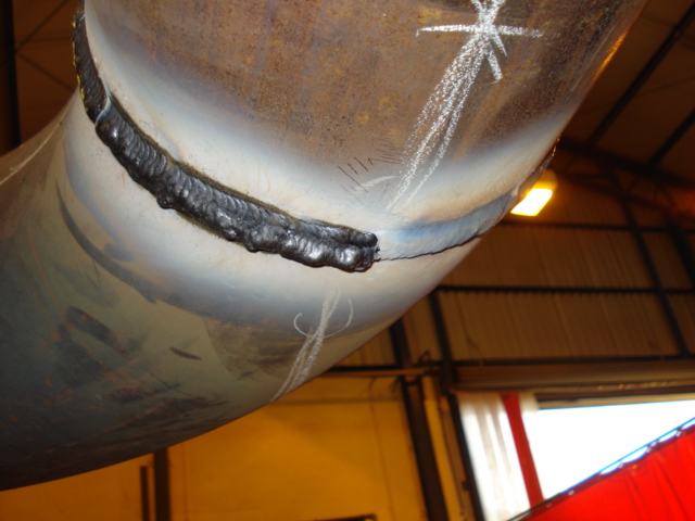

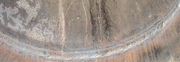

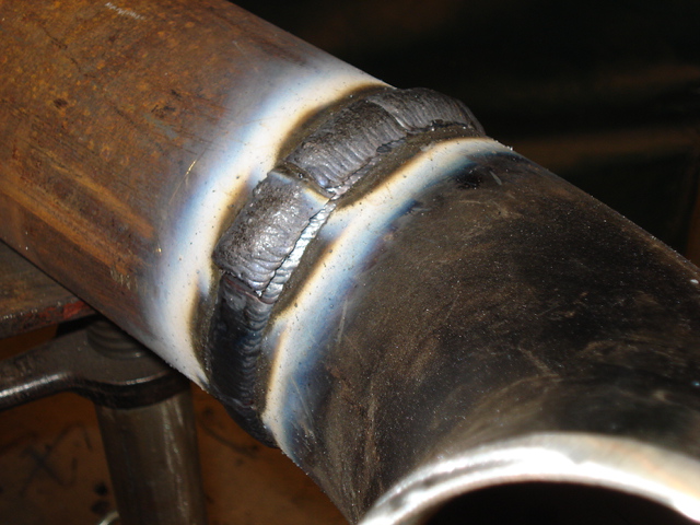

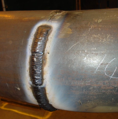

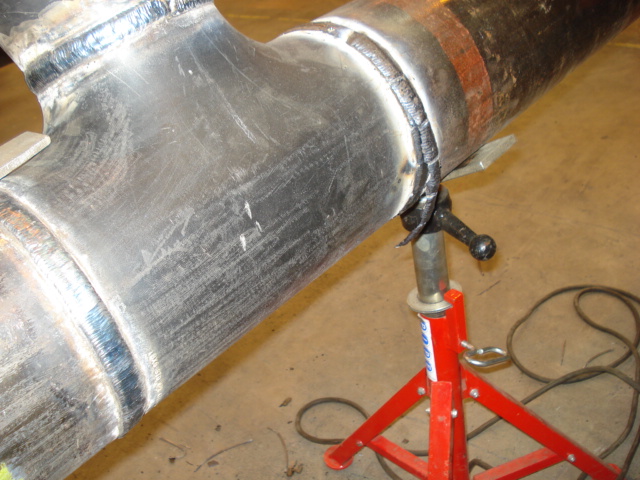

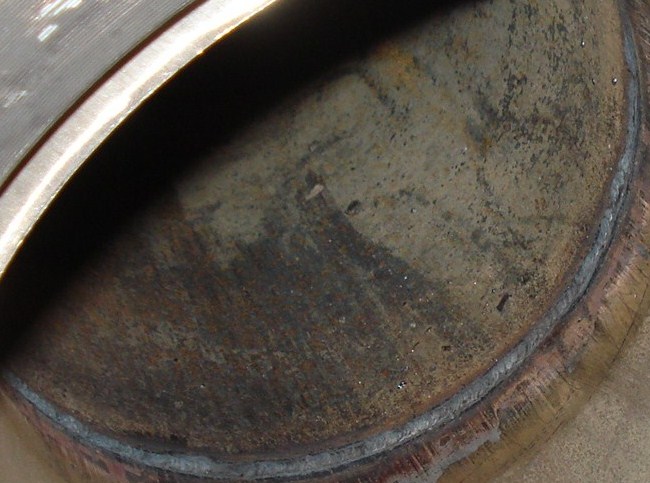

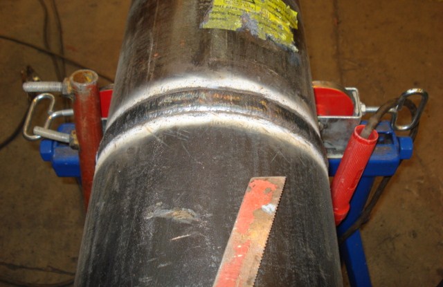

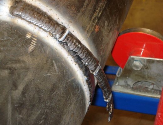

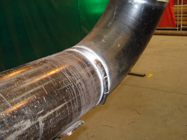

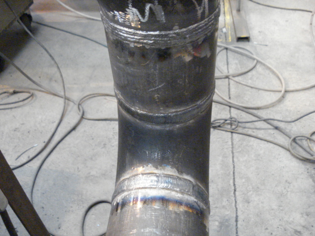

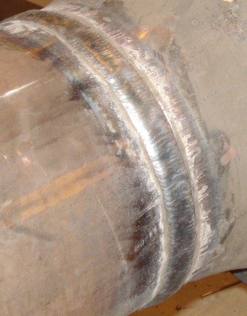

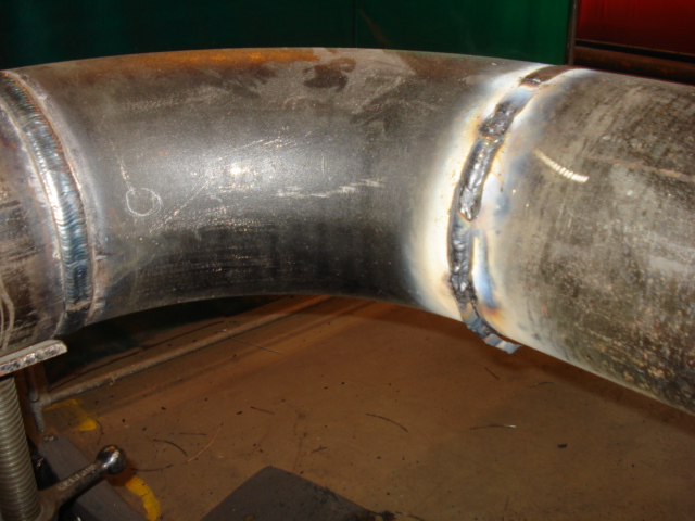

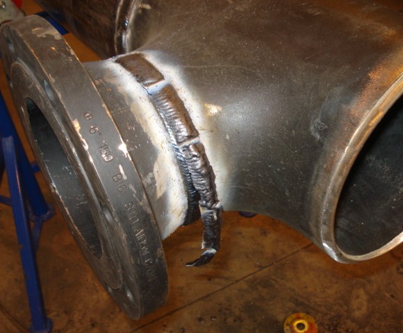

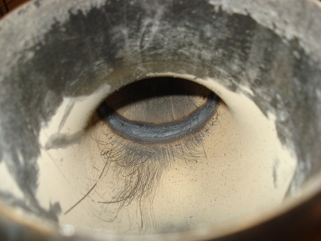

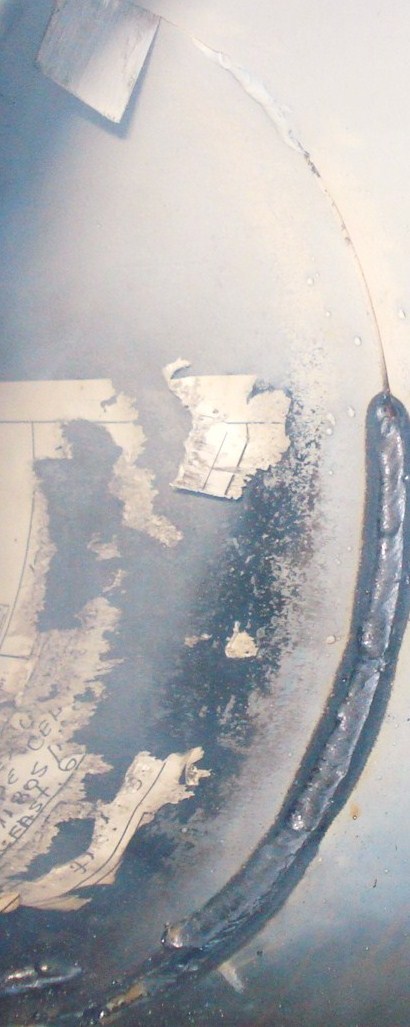

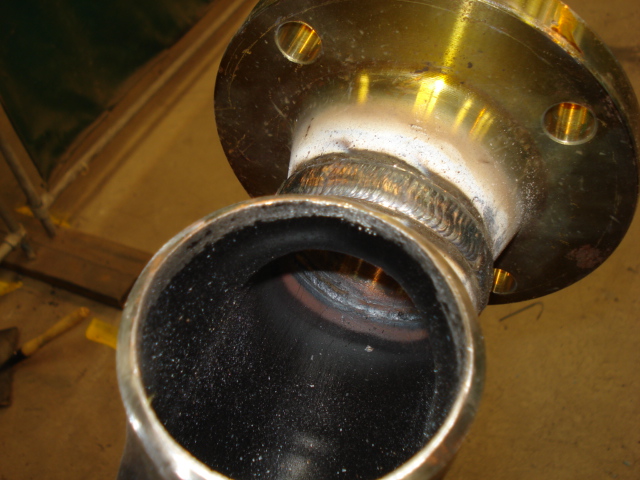

......then the space in-between the weaves (or ladder step) should be very small, infact half of the arc should be going back over the weave just made and the other half should be on the pipe..........understand?? :-)
I am not 100% sure of the number but officially you shouldn't weave wider than 3 times (I think) the size of the rod (8mm weave with a 2.5mm rod), although I know that its possible to do more in reality.

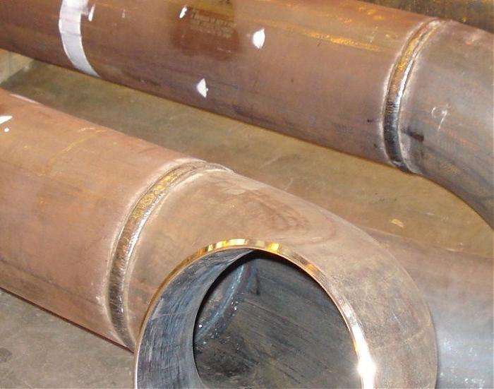

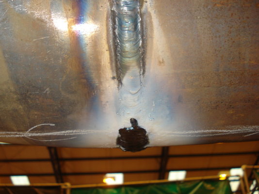

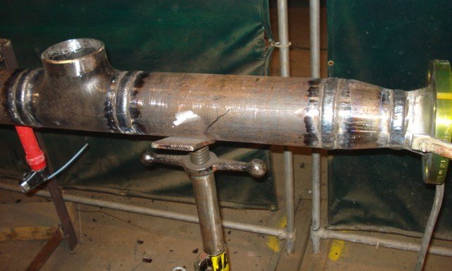

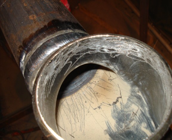

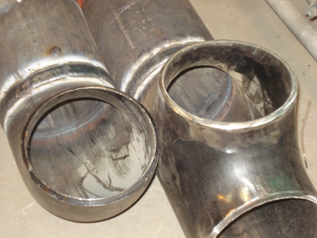

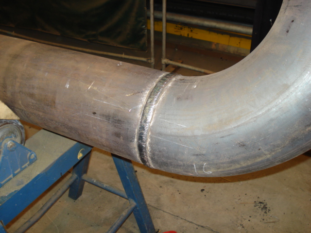

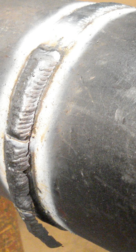

heres a few more pics f,j
as matt said it really is only an amp problem with you......
... just to clear something dutchman i actually use 3.25 and 4mm to cap 2.5 i have used but its a long way roundheres a few more pics f,j
