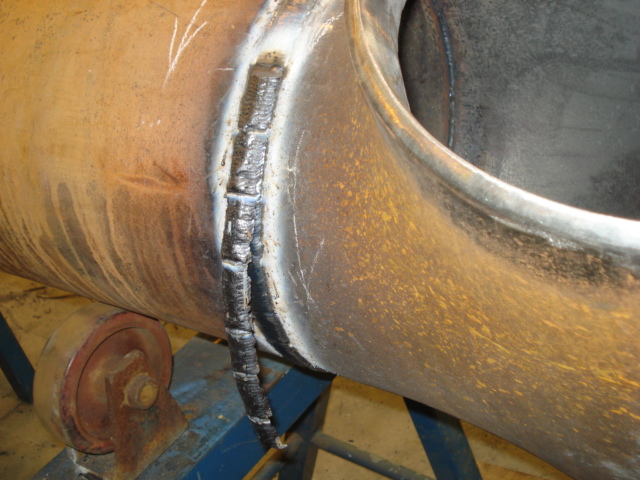

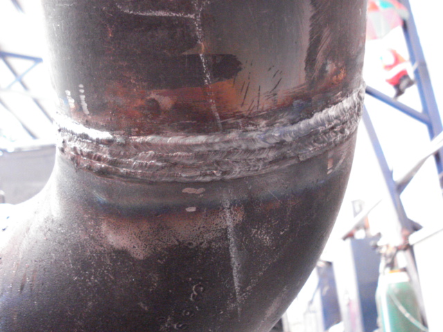

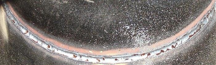

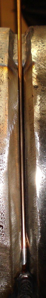

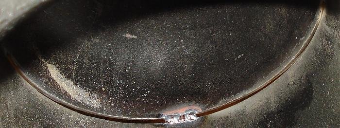

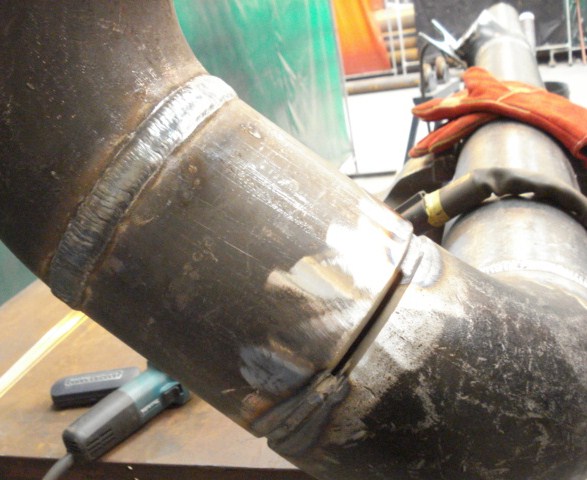

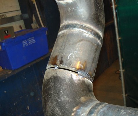

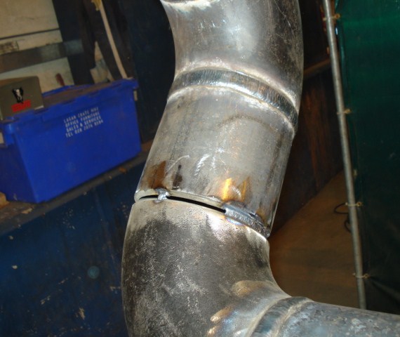

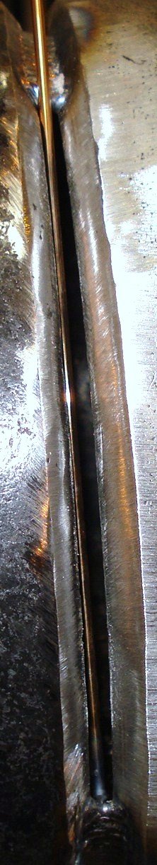

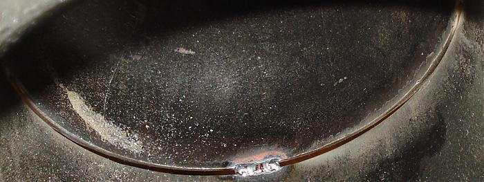

. i mentioned a while ago the use of large gaps on tig roots, these pics will show the closure from 4mm gap, pipe 8 inch, filler 2.5 amps 120, f/j

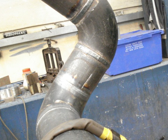

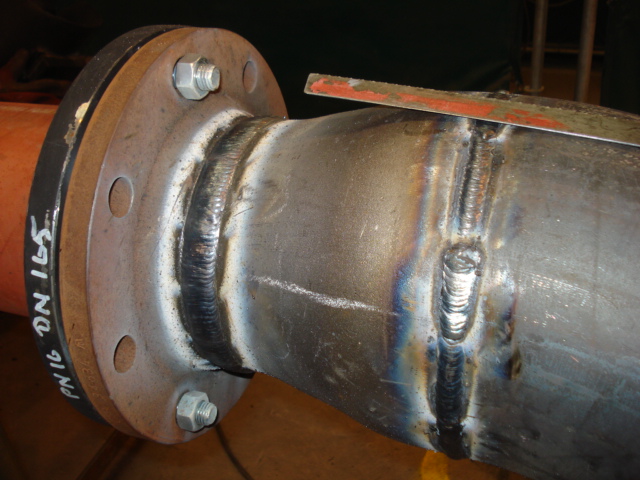

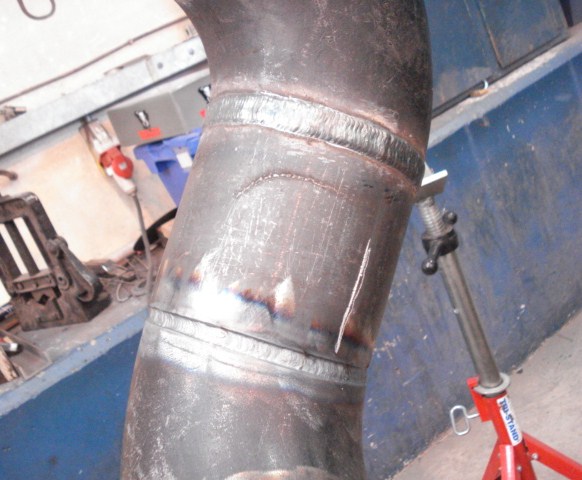

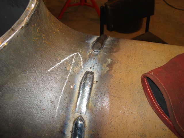

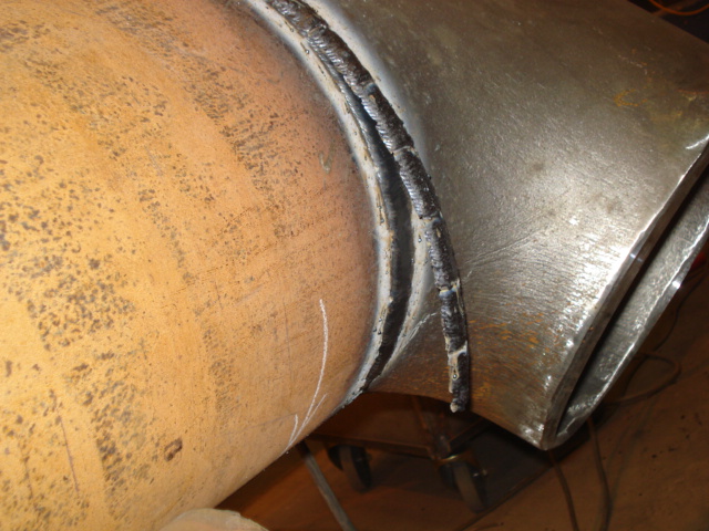

the reality is you need to learn to deal with anything that turns up, but i would recommend any young lad to weld 5 6 and 2g every chance he gets. this spool turned out a little awkward so i did one branch 6g tig root and filler, when i finished i just did the other 5g

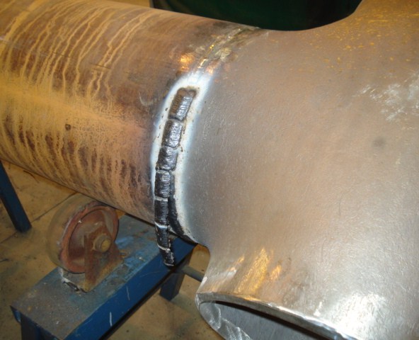

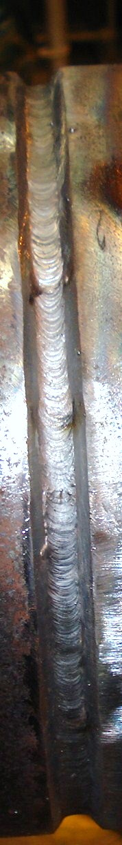

That bottom one looks like it took a few passes F/J?
Nice work again mate.

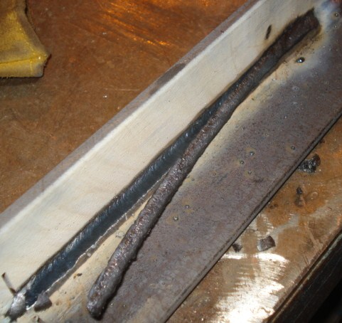

I know it's slightly cheeky to ask but any chance you could give us a few of your parameters with your pics? Rod type, brand, size, amps etc. I'm trying to use my MMA kit a bit more rather than just use the mig and it's nice to have something to work towards, like welds as nice as yours.

Nice one Runnach! It would be good to just set the machine up using similar parameters and see what the result is. I doubt I'd be the only one to try too jusdging by the amount of interest this thread has generated.
runnach the eye of a teacher
im sure you,ll forgive me that one considering it probably blinded me. wooz its 4 runs just to keep it uniform with the surrounding weaves. im sorry if i haven,t posted details i was worried about repeating myself, this lifting slag thing is only a novelty try this first,angle iron on the flat,1/8 rod 115 120 amps 3 runs the rod i used was fox sum but any 13 should work.Best to get "stuck" into a Subway sannie matt parked up in some forlorn layby. X babbies eh, you ever visit Cockenzie on a shut down? Now that is the pitts!!
