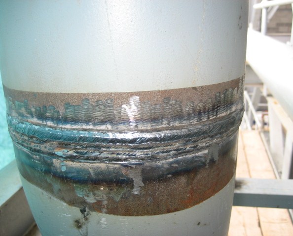

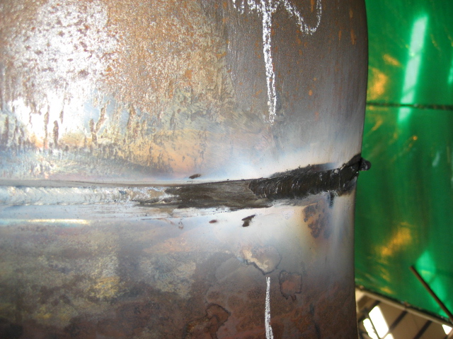

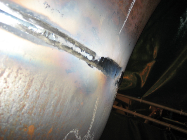

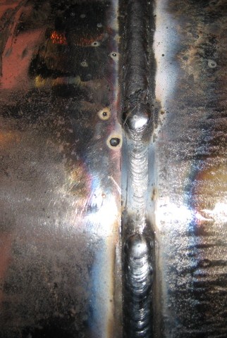

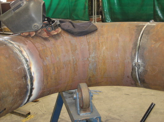

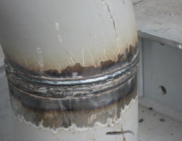

lads in the first picture the root is coming off the bottom tig,these to me are hardest. the challange is to keep everything going on high up on the root face,in my case this involves dipping wire in from the top centre, of the puddle, if the power and angle are right you can hang around a bit, its like dip dip forward trying to move the heat off the pool. always watch for the edges breaking, there wont always be a visible keyhole. f/j
