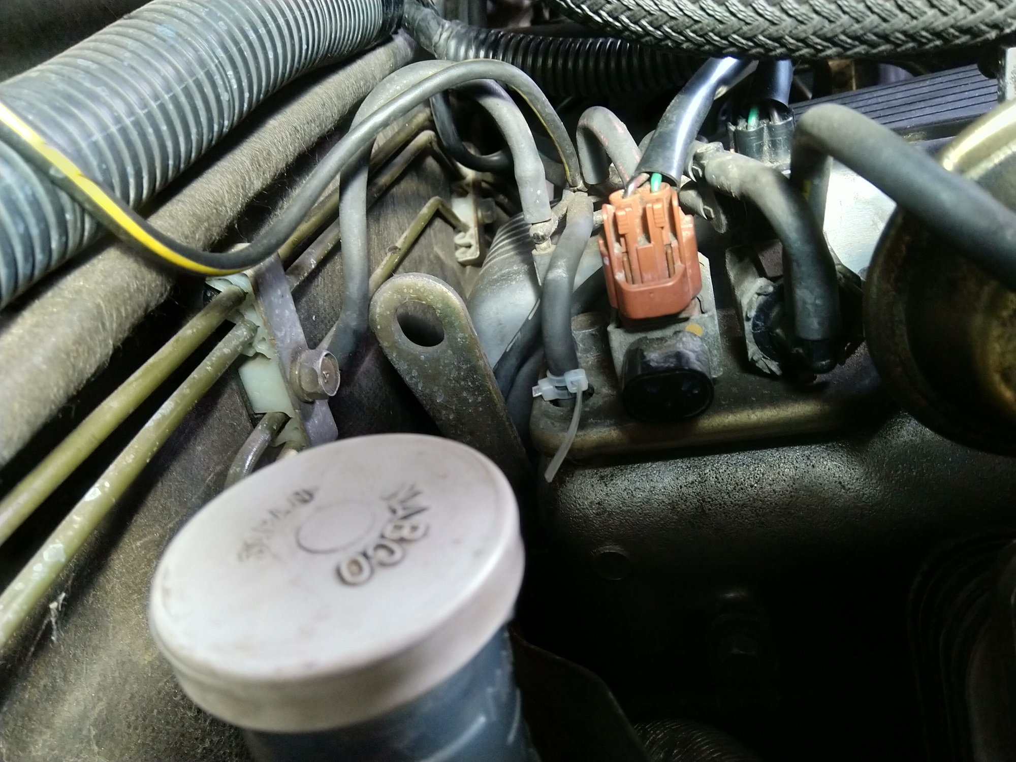

    Took it for a run and it runs great, no leaks or issues.... except when putting my foot down at about 2500rpm there is a boost of power immediately followed by the amber EML :doh: - Then I discover that the OBDII look-a-like port, isn't OBDII it's MUTII as mnrf pre 04 so I can't get any codes.
    Due to when it comes on I suspect the turbo actuator or it's controls - sure enough the little pressure line that goes to the (boost?) sensor has popped off, fix, test again, great to 3500.. then EML light. Re-check the pipe and it has popped off again. I have cleaned the pipe and put a couple of zip ties on it, anyone know what glue is used to keep the things on? Don't want to use superglue as it would never come off.

    Don’t think mine had glue, could be wrong though. Hotchef will know

    They are difficult to get off the first time, I left most of them attached but had to pull this one.
