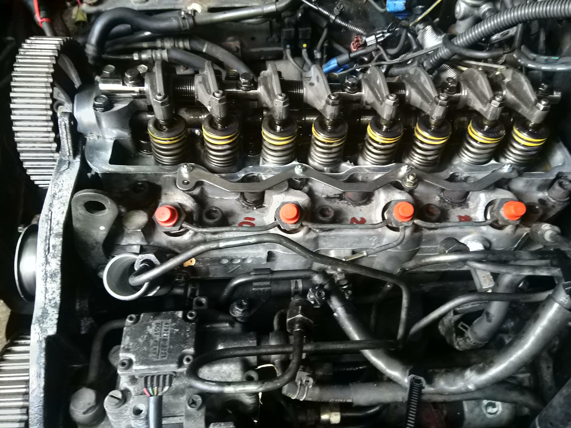

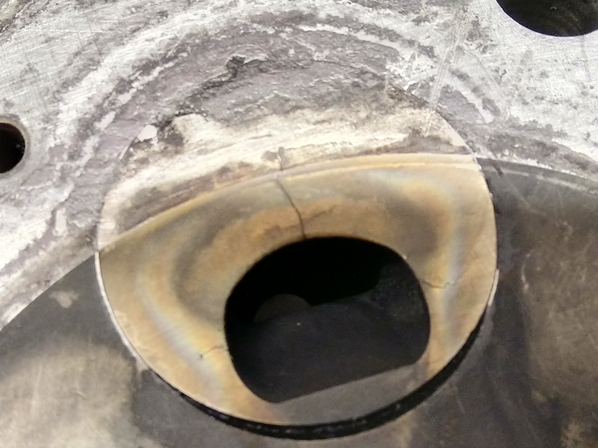

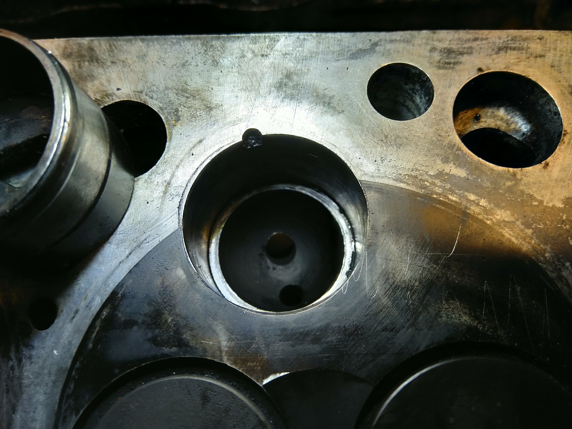

    I bought @123hotchef 's cylinder head but on arrival it has identical cracks in the inserts AKA Precups or pre-combustion chambers, to the head I have taken off.
    As per earlier post I thought these cracks were what was causing the exhaust gas to be blowing into the coolant, - hence getting a replacement head - however chef assures me that the cracks are common and are no where near the coolant. So I popped one out of the old head and he is indeed correct - as they are an insert into the casting ... which means that I probably didn't need to replace the head in the first place :doh:

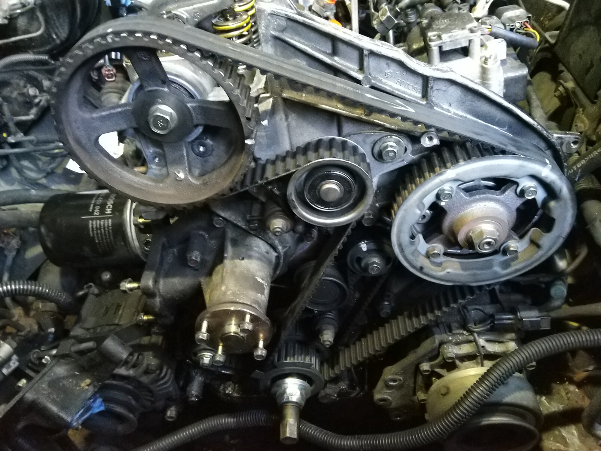

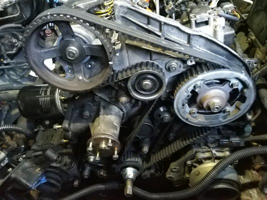

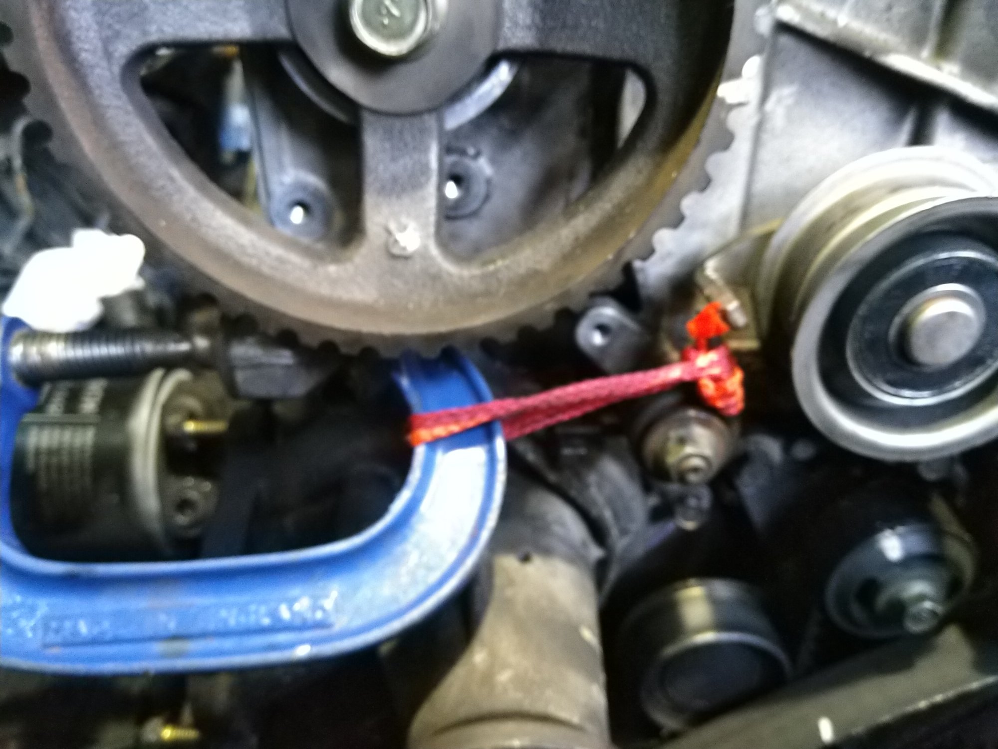

    Chef's head cleaned and bolted on (Frankenchef !)
    Figured out a way to pull that spring back to let the tensioner down using a bit of shoelace and a G-clamp - no drama's at all.:cool:
    Mounted the belt, just a few hundred bits to bolt on now. Would have got more done but got volunteered for wallpapering duties..
    (the marks are lined up it's just the camera angle)

  8. 123hotchef Member
    Messages:
    9,473
    Location:
    Kent
    Love it shoe lace and.g clamp don't forget to time it up properly

  9. Wightsparks
    Wightsparks Forum Supporter
    Messages:
    1,368
    Location:
    Wight
    I'm assuming it is timed as all the marks line up - unless I am missing something?

  10. 123hotchef Member
    Messages:
    9,473
    Location:
    Kent
    Yep but the normal de tension rotate a full rotation tension turn a few teeth back blah blah
  11. Wightsparks
    Messages:
    1,368
    Location:
    Wight
    Yep, followed the instructions. pretty easy compared with some I have seen!

    Not been able to get to it for a week but put the last bits together today and after a few splutters to blow the air out of the injectors it fired right up. :thumbup:
    No nasty noises, smells or leaks so far. Filled it with water from the top hose and the rad, getting hot air out of the heater. Ran up to temp and cooled off, sucking in some from the expansion tank. Apparently these can be difficult to bleed so left the rad cap off with the nose up and will fill tomorrow.
    Once I know it's all OK I'll put coolant in. Normal Glycol I assume but have not checked.
