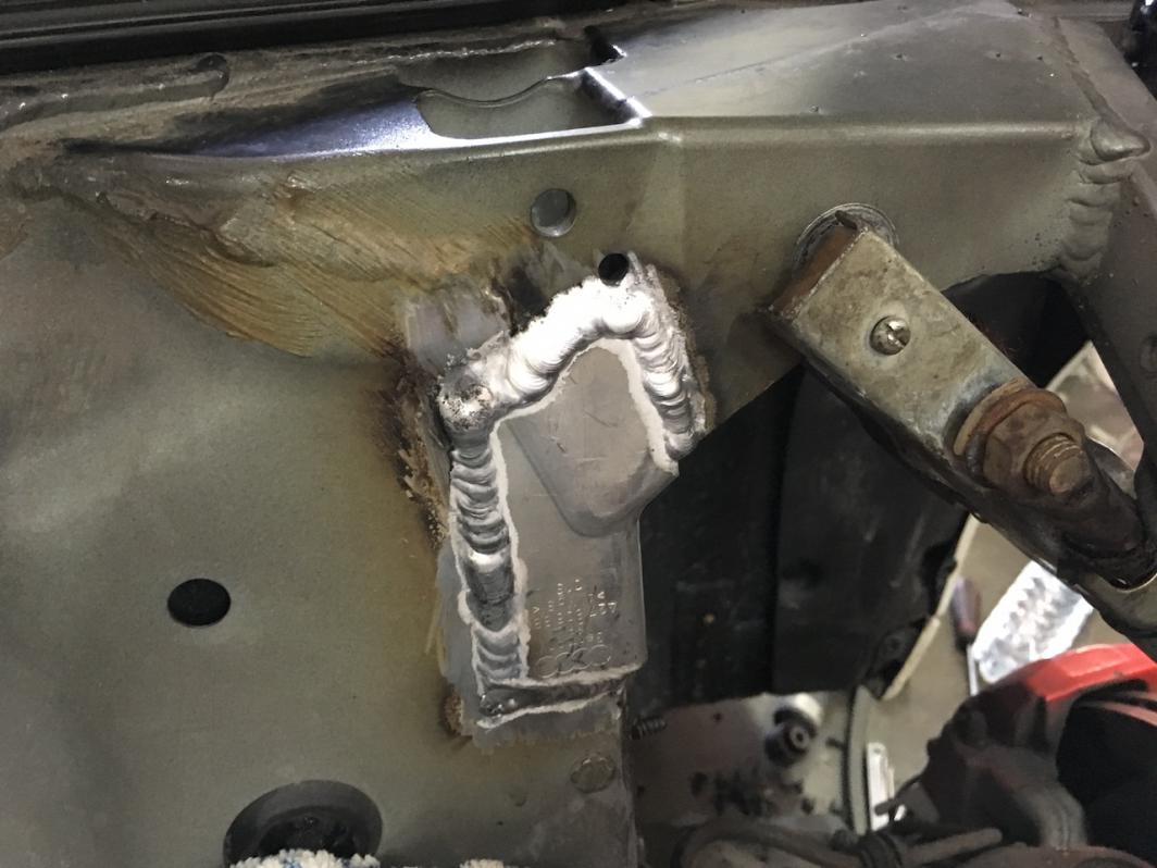

Hi brad its an Audi R8
Usually certain repairers use certain machines that they’ve bought into and that’s all that can be used on their car. CEA, GYS, Fronius all have contracts with certain manufacturers.The proper Audi repair guy gave me the details of the mig welder needed to do the repair, I am tempted to get one as I would like to try a twin pulse mig but it was £5k or something. ..

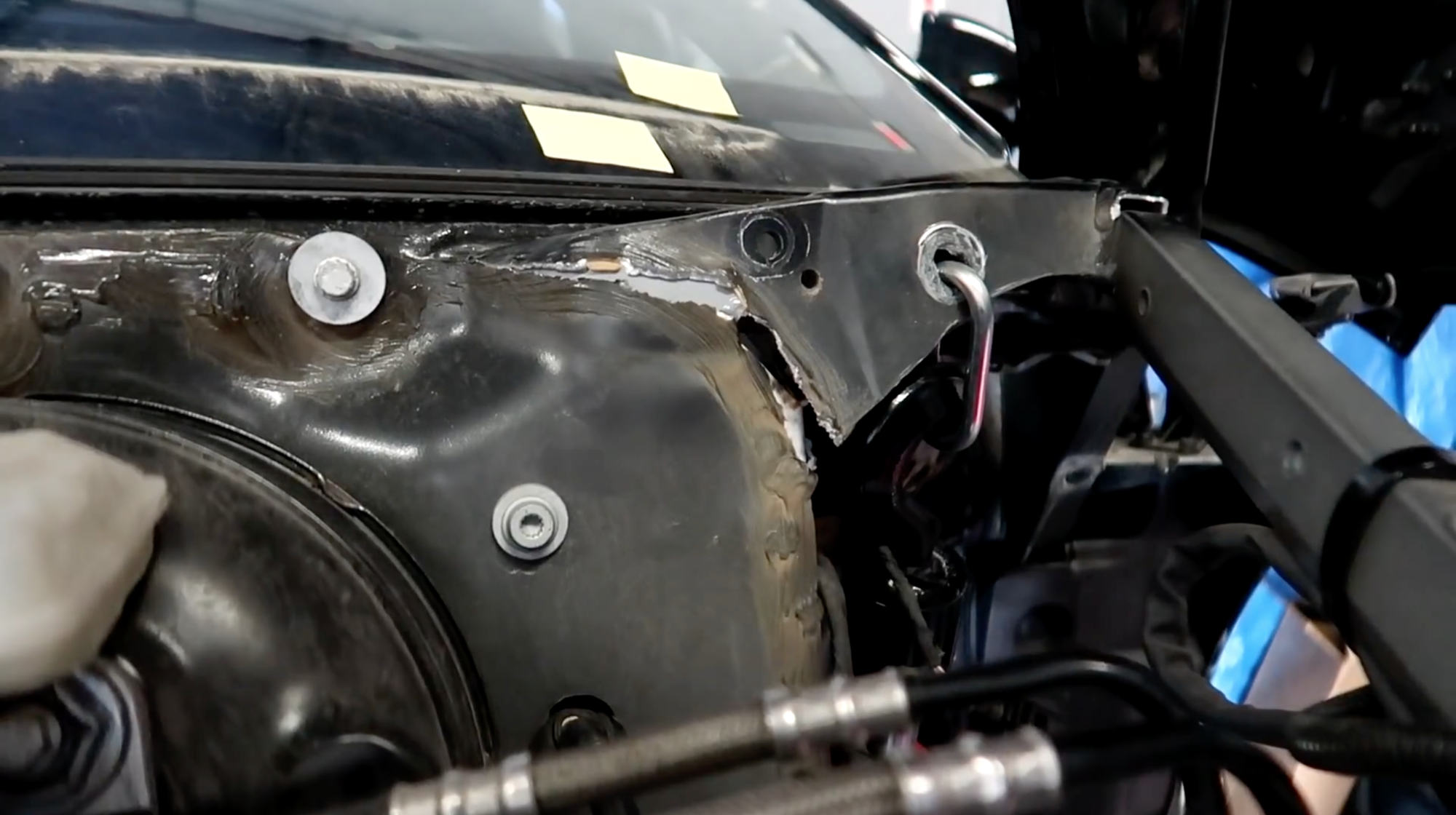

https://www.google.co.uk/amp/s/www.motor1.com/news/275490/audi-r8-frame-fix/amp/
“Professional Welder” my ass. What a crap repair.
Anyhow this guy smashed the windscreen pulling the chassis back
Thanks Brad i have miller dynasty 200 dx tig plate is only 3 mm thick, esab have replied saying use 4043
They are rubbishnice welder!
