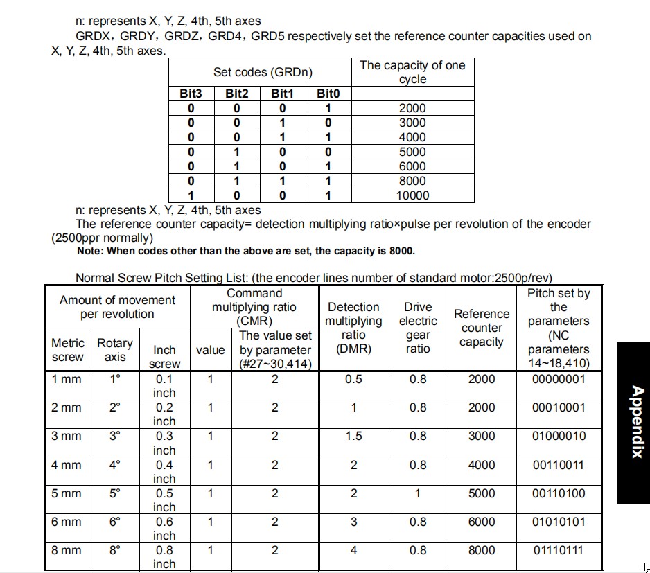

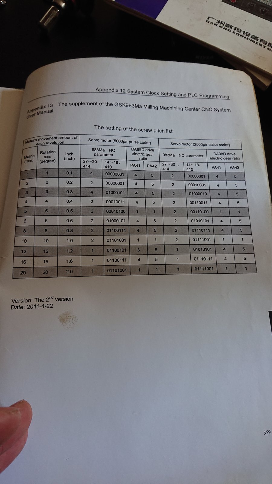

You will have 5v, 0v, A+, A-, B+, B-, Z+ AND Z-.
I can't find the settings anywhere. Maybe I need to log in as administrator?Have a look at the X Y and Z parameters and see what they are and compare to the manual.
