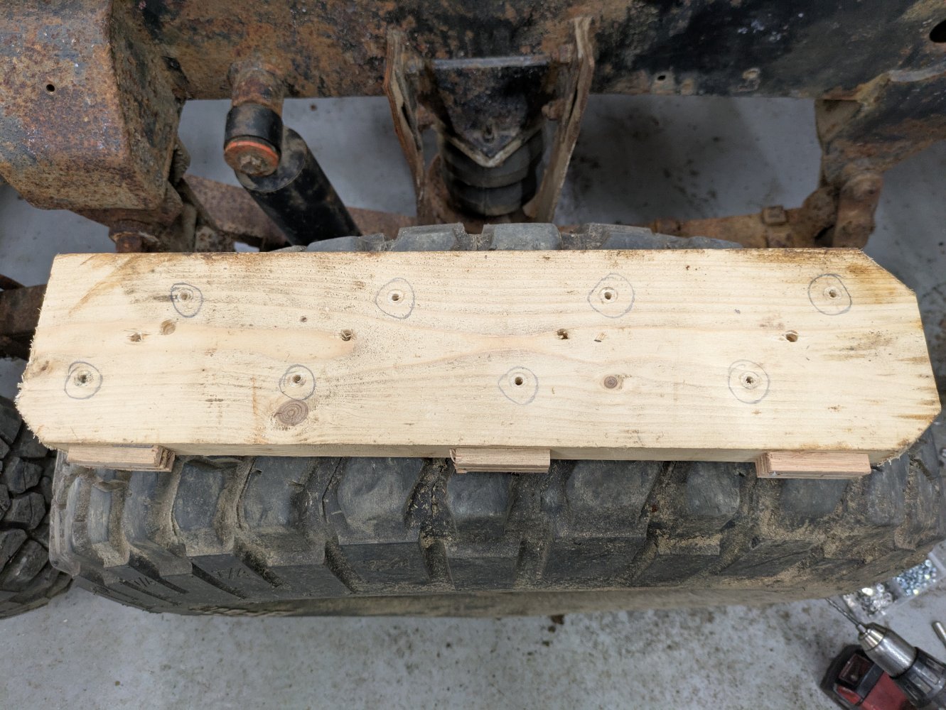

Absolutely anything is more appealing than going down to the stables to deal with the wife and horses.A painful amount later and I have some replacement lights.

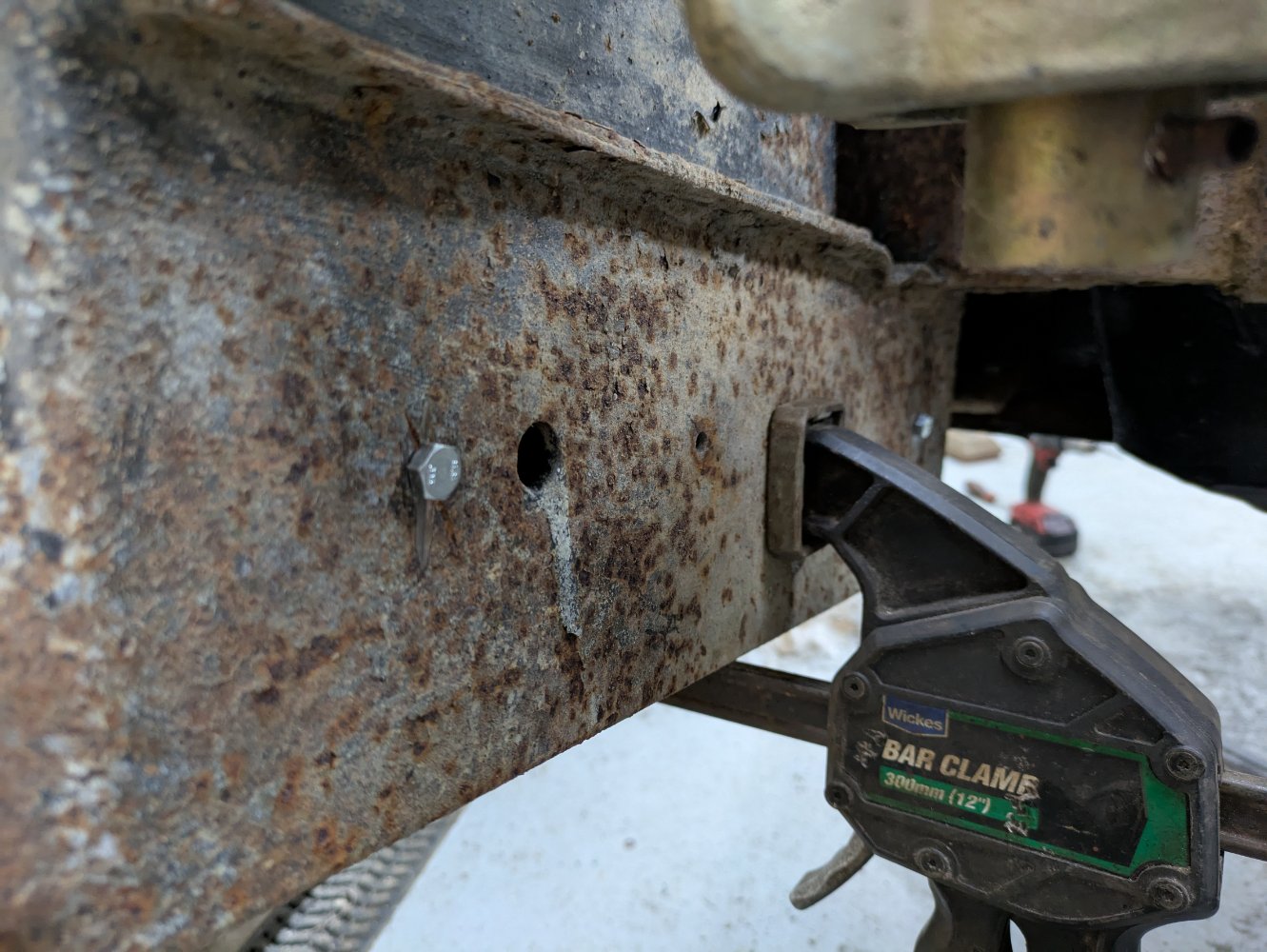

To aid in drilling the holes a bit of actual CAD (computer aided design) was employed to produce a piece of PAD (paper aided design) to make some WAD (wood aided design).

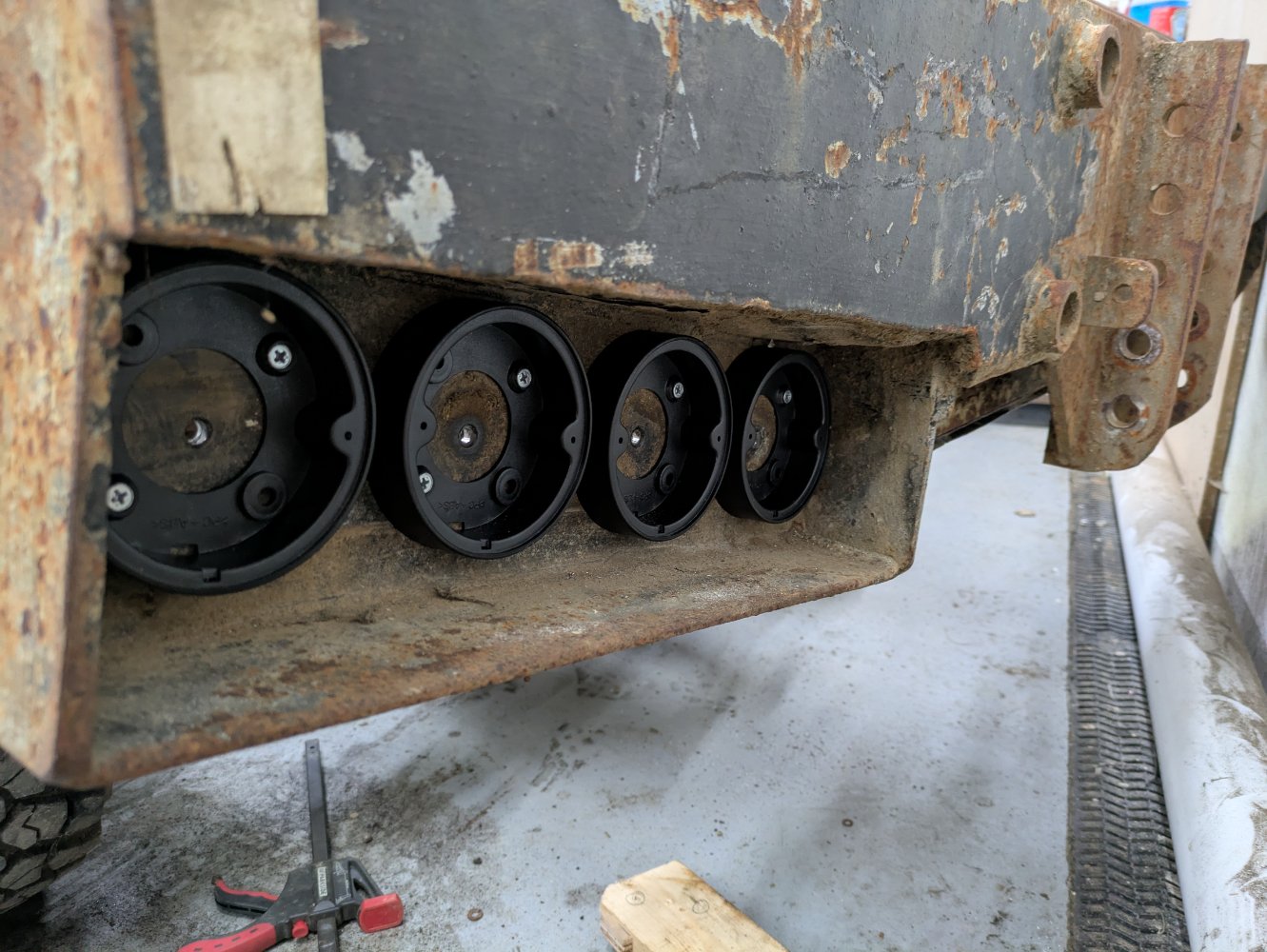

Using some of the old bolt holes to aid alignment

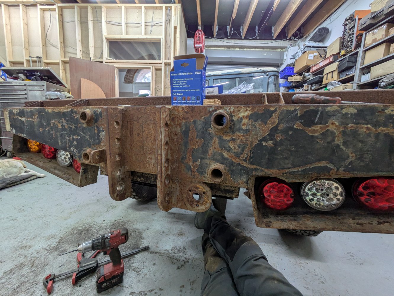

The old bolt holes spaced at 110mm were just right for feeding the wires through and aligning the plinths.
And voila we have a set of lights
