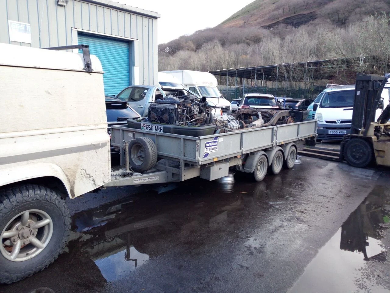

I was genuinely surprised but I took a load of scrap and before leaving we weighed just the Sandringham.Another downside to a 6x6 conversion is the loss of towing concessions on a car license, they only legally apply to 4x4 vehicles weighing under 2040kg empty. They are no longer 4x4 and most will tip the scales at over 2040kg.
Bob
Thats good going Ed,yours is a sort of series hybrid, that said its no longer a 4x4 The real basic 110's are just a tad under two tons, no chance of one of those being converted and still under the concessionary weight.I was genuinely surprised but I took a load of scrap and before leaving we weighed just the Sandringham.
20ft Ifor still hitched up but reversed off the weighbridge. Me at 100kg, two labs at 30kg each and a load of stuff in the cab weighed in at exactly 2200kg. So even without the extra stuff it would 2040kg with the heavy Nissan diesel lump in there.

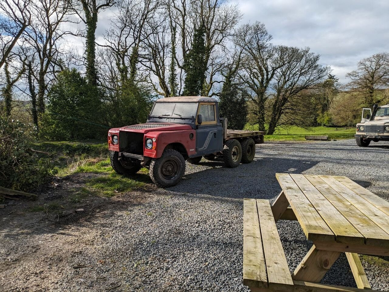

That always seems to be the case when I see these kinds of conversions and about6 wheel Land Rover in the car park. I only saw it from a distance, but it looked immaculate, like just rebuilt.
What? You mean it being in the workshop for 2 years whilst I'm procrastinating about actually getting it running.That always seems to be the case when I see these kinds of conversions and about
@sako243 seems to be a bit of a outlier in actually using his 6x6 Landrover to do "Landrover Stuff".
Exactly, Landrover Stuff.What? You mean it being in the workshop for 2 years whilst I'm procrastinating about actually getting it running.
