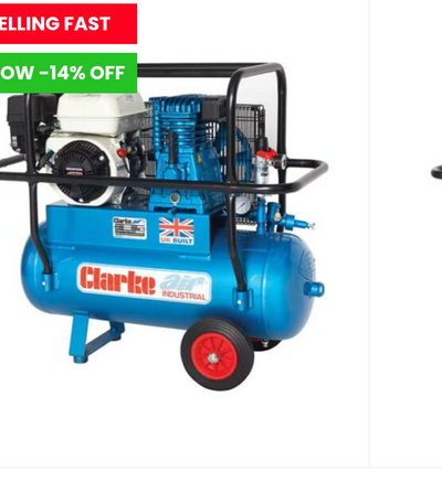

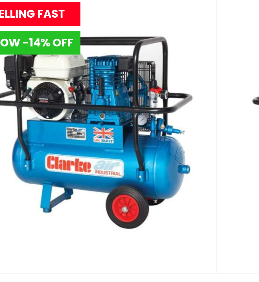

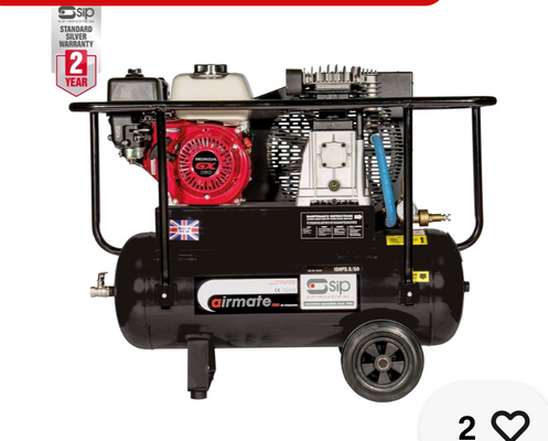

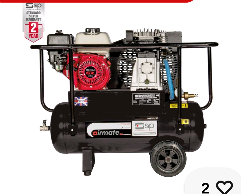

I've been able to buy these two compressors if I link these up would I stand a chance of sandblasting?
if there both 14cfm they will run a 3.0mm blast jet nicely an airfed mask will pull a fair bit of air and reduce it you could use a decent face mask with cheapo face shield to get you away without getting pepperedI've been able to buy these two compressors if I link these up would I stand a chance of sandblasting?
