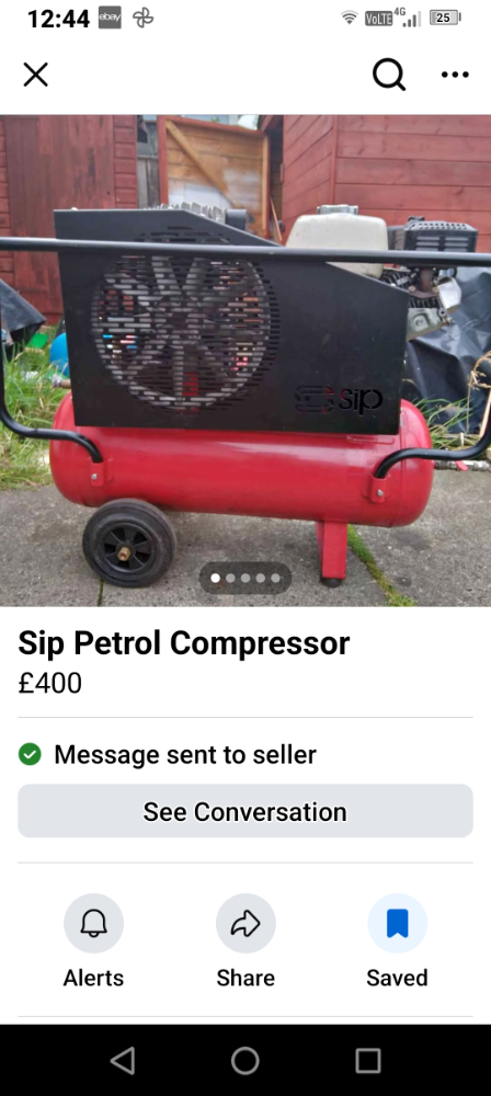

They are both 14cfmI cant be bothered to look up the stats on them, but its looking much more hopeful!
To be fair I got them both for 500 I had to buy them for that price one is a sip honda gx 160If you have been able to buy both within your budget, no way are they legit. The Clarke one on it's own is over a grand new, and they don't loose their value that much
Please yes that would be very much appreciatedif there both 14cfm they will run a 3.0mm blast jet nicely an airfed mask will pull a fair bit of air and reduce it you could use a decent face mask with cheapo face shield to get you away without getting pepperedi got a fair few given if you want some
working on a job on monday i have so many at home but can probably get some more from therePlease yes that would be very much appreciated
Spec
50 Litre
FREE AIR DELIVERY CFM11CFM (312 litres/min)
FREE SPEED RPM1200rpm DOMESTIC2 Years & 10 Year Air Receiver CorrosionMADE INBuilt & Tested By SIP In UKPISTON DISPLACEMENT 16CFM (453 litres/min
NOSIP04444PSI PRESSURE150psi
(10 Bar)

and the other is clarke pph15c50

Is 3mm the max? On the pot it states 125psi is the max and if it's over to use a regulator what type do I need as I have no clueif there both 14cfm they will run a 3.0mm blast jet nicely an airfed mask will pull a fair bit of air and reduce it you could use a decent face mask with cheapo face shield to get you away without getting pepperedi got a fair few given if you want some
They both run sweetYou've surely been done... Those two compressors are supposed to be nearly £2.4k. You did not get them in working condition for £500.
25cfm will keep up with a 3.0mm jet at 90 psi, i dont bother using a regulator i just run mine at full tank pressureIs 3mm the max? On the pot it states 125psi is the max and if it's over to use a regulator what type do I need as I have no clue
