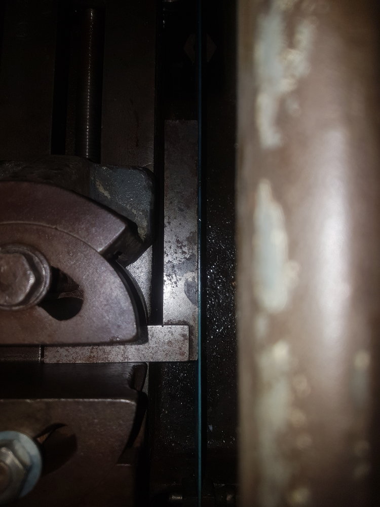

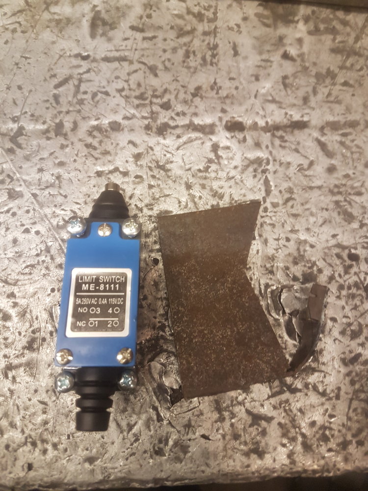

With the micro switch I want it live on the NC if I have it correct in my head.

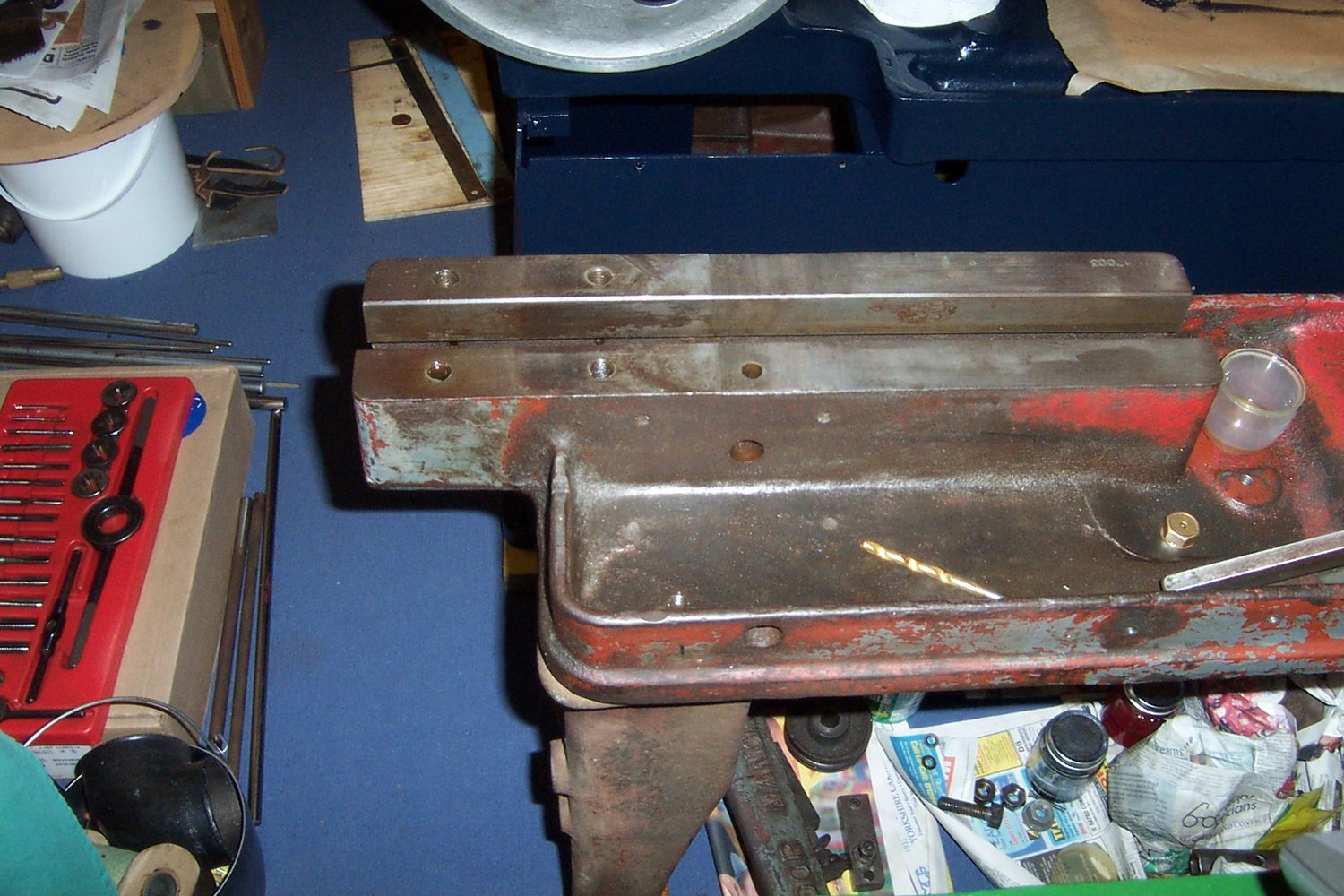

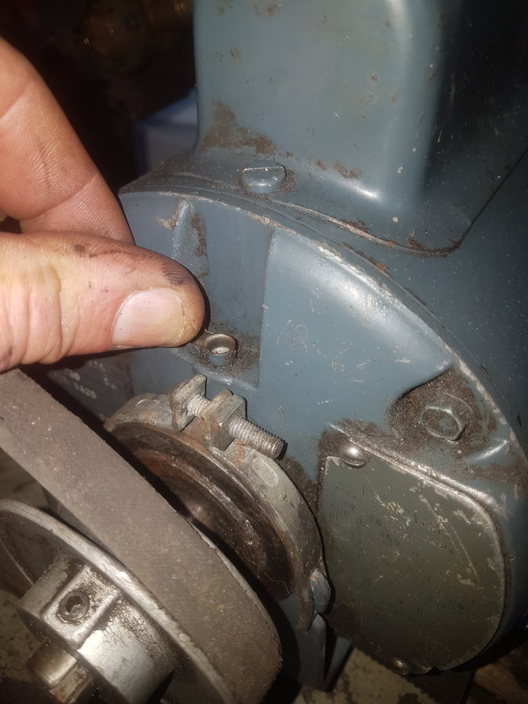

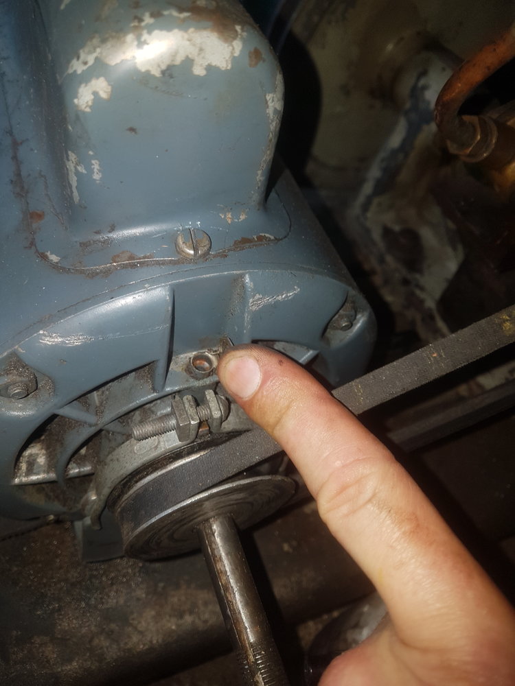

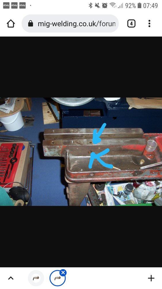

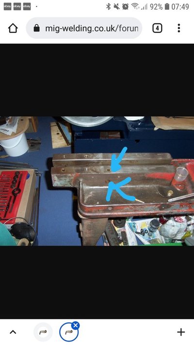

Great that helps I'll take a closer look for those holes. These ones marked in blue I presumeView attachment 330349
A rod goes through those holes, with a grub screw or bolt locking it in position from above. Then just a block/arm to slide along the rod.

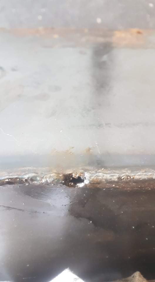

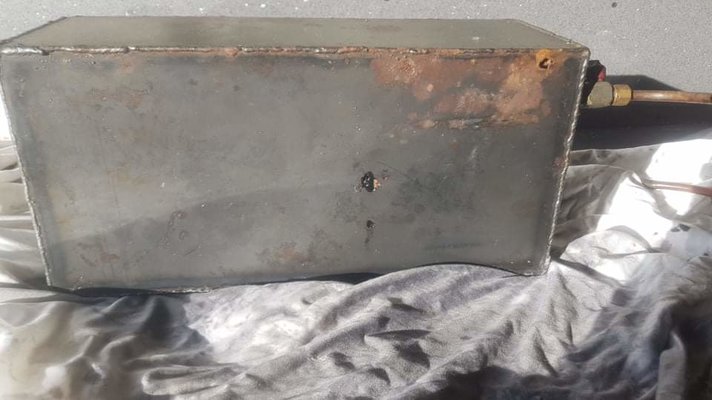

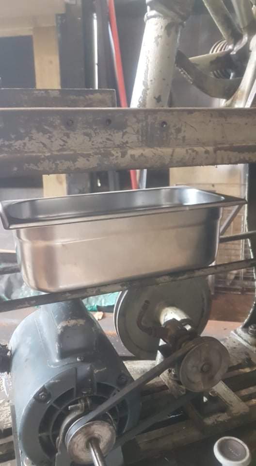

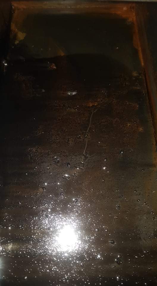

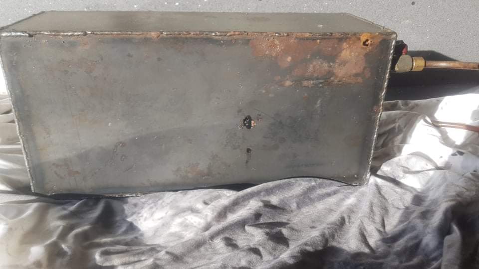

Did it come with a suds system? I wish I had it set up. Would have saved a lot of blades.Ah dam the sump for the suds has rust holes and it leaks looking inside it is well pitted and not worth patching. So I will either make a new one or steal something half suitable out of the kitchen cupboard and make it work, SHSSHHHHH dont tell the wife ;-)
It did indeed. Simple little pump driven off of the motor via a small belt. I will make a new tank and hopefully it will be all good again. I'll grab a pic later of the pumpDid it come with a suds system? I wish I had it set up. Would have saved a lot of blades.
I've bought a 99p small bike pump from Home Bargains (no expense spared) to see if I can get the lobe driven pump to work, before commiting to making something proper.It did indeed. Simple little pump driven off of the motor via a small belt. I will make a new tank and hopefully it will be all good again. I'll grab a pic later of the pump
Oh I will not be painting mine either now then thanks for the heads up. Oh so you have a pump on your saw also. I may make a wooden shelf to sit on the bars between the legs like they had originally. Give me something to sit the tank on too.I've bought a 99p small bike pump from Home Bargains (no expense spared) to see if I can get the lobe driven pump to work, before commiting to making something proper.

Oh I know the hole you mean. I over filled the damperand it dribble through that hole.No pump..... it's just a theory I have, an unsubstanciated one. Perhaps someone knows for sure?
The threaded hole is below the lobe. It isn't a drain hole. Although it might be easier to fit a pump off the drive belt. But would need to modify the guard.
