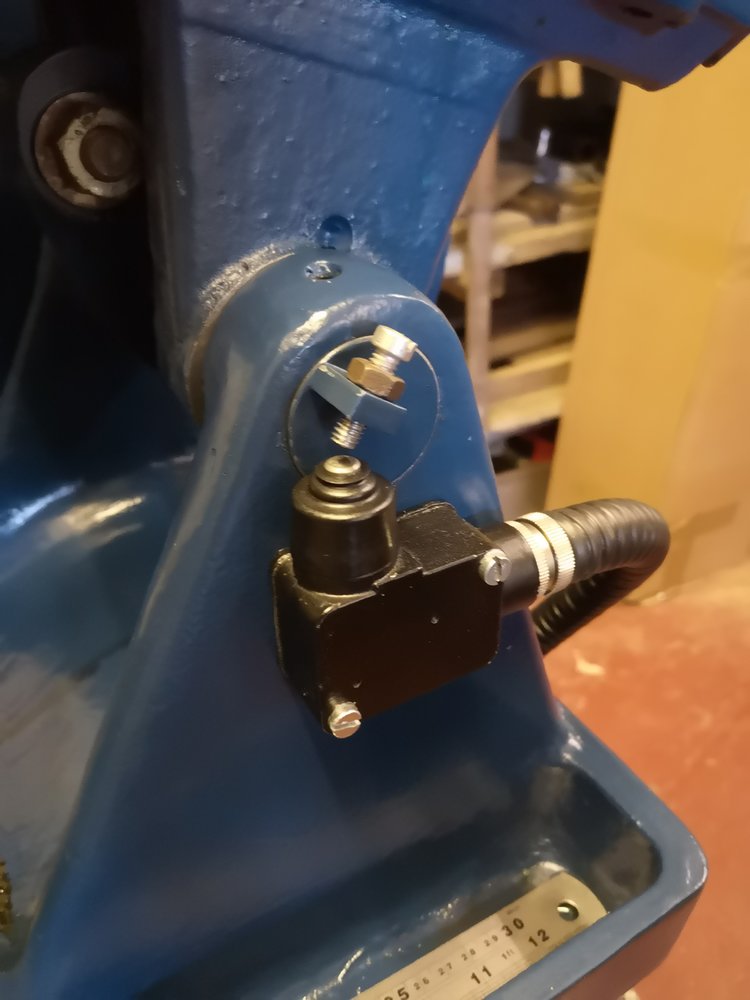

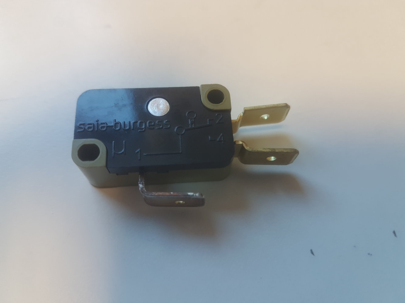

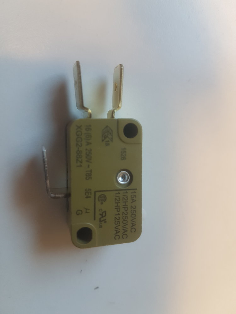

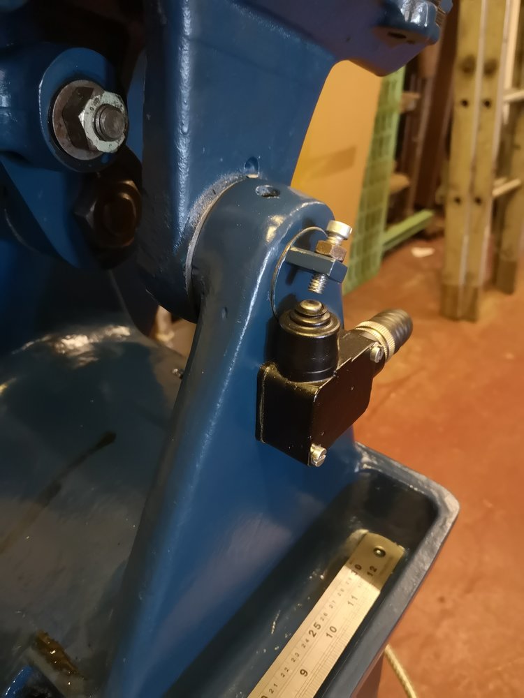

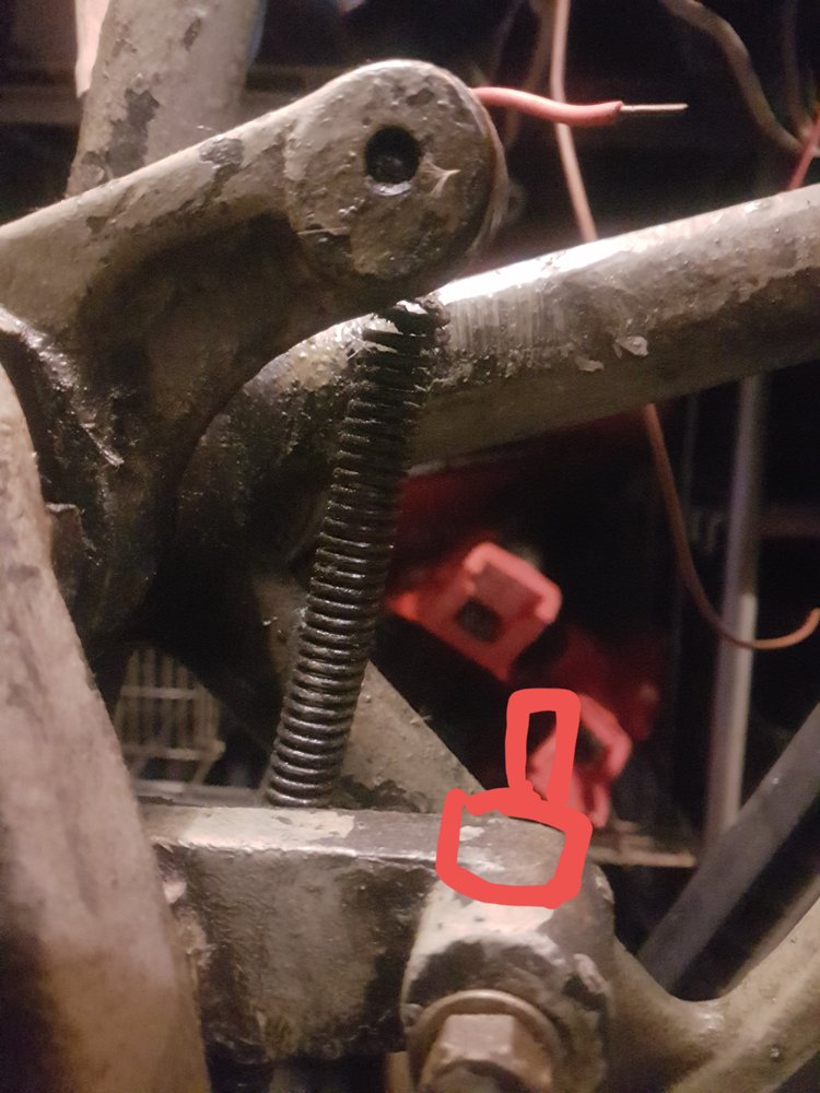

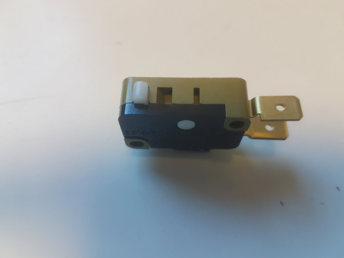

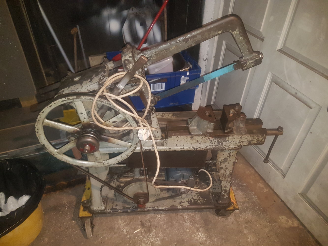

heres my switch i put in and the arm that holds the bow up. i welded a bit of bar on and a nut and bolt to adjust the stop on to the microswitch thats sat in a 3x3 tin box
With having the switch in that position the motor will not automaticly turn off as the cut is finished though will it. As the bow does not lift by itself after a cut.
