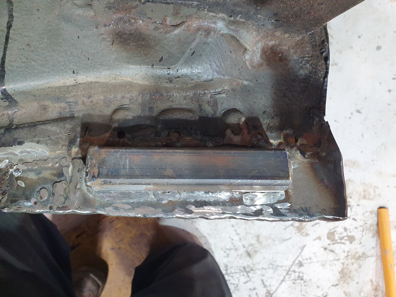

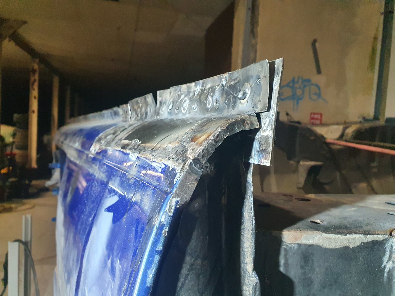

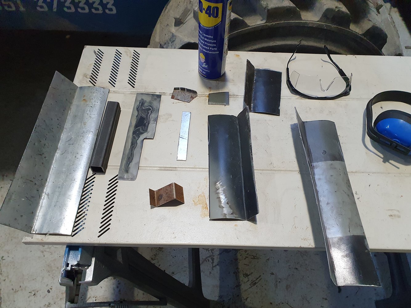

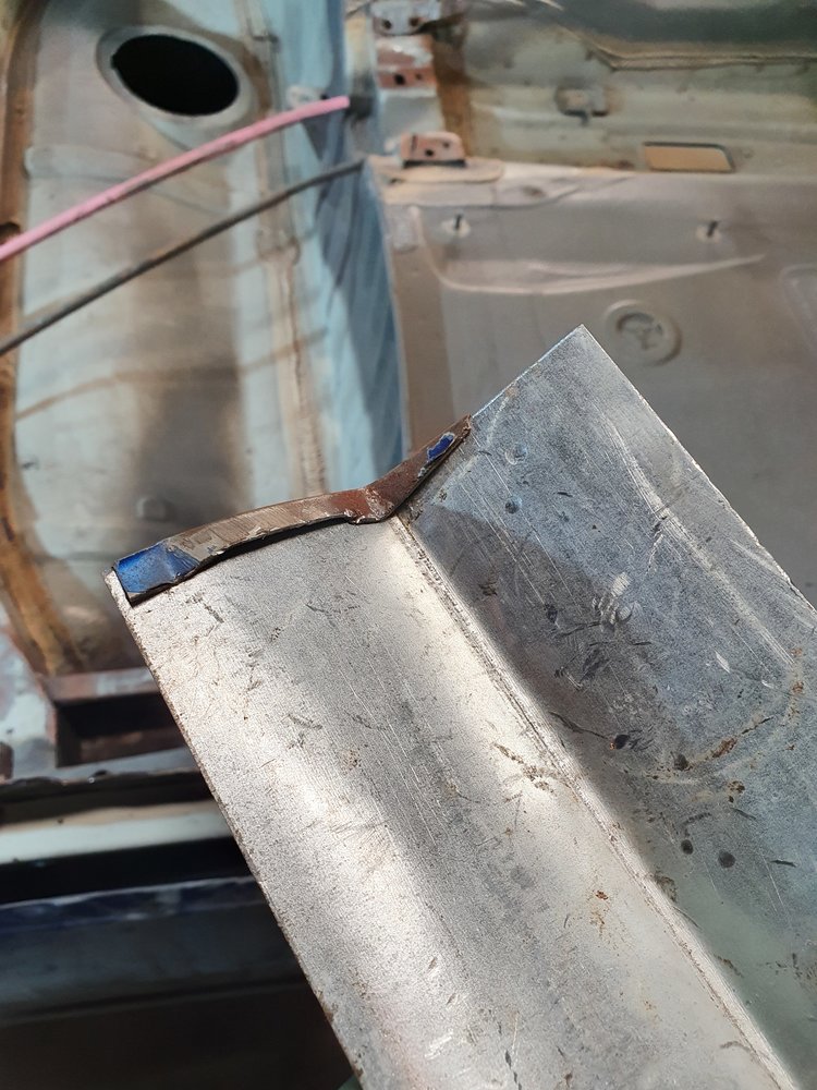

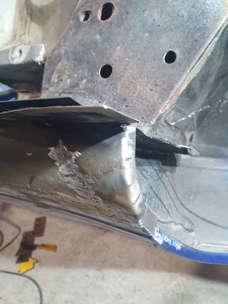

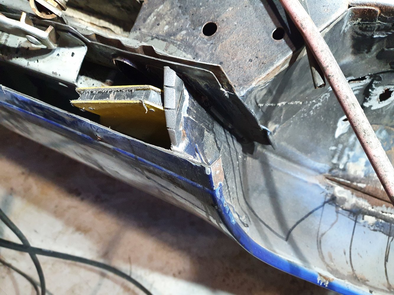

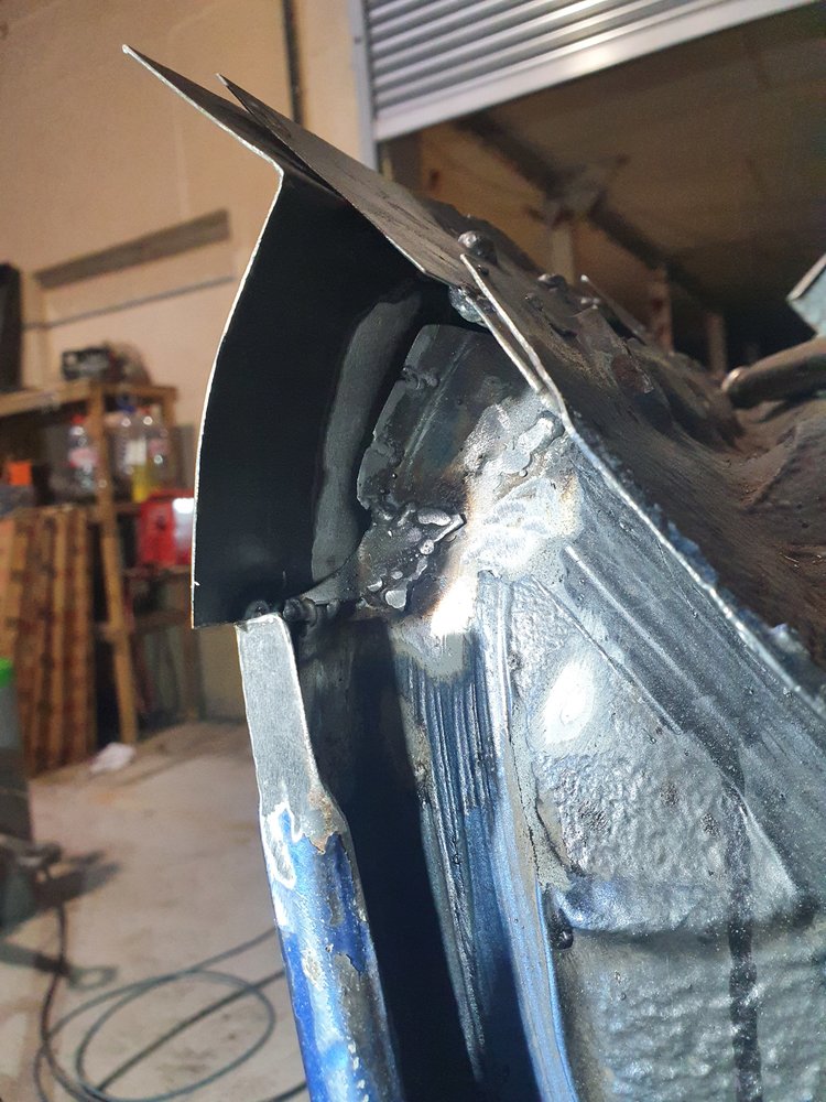

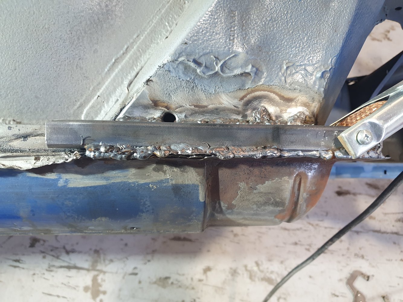

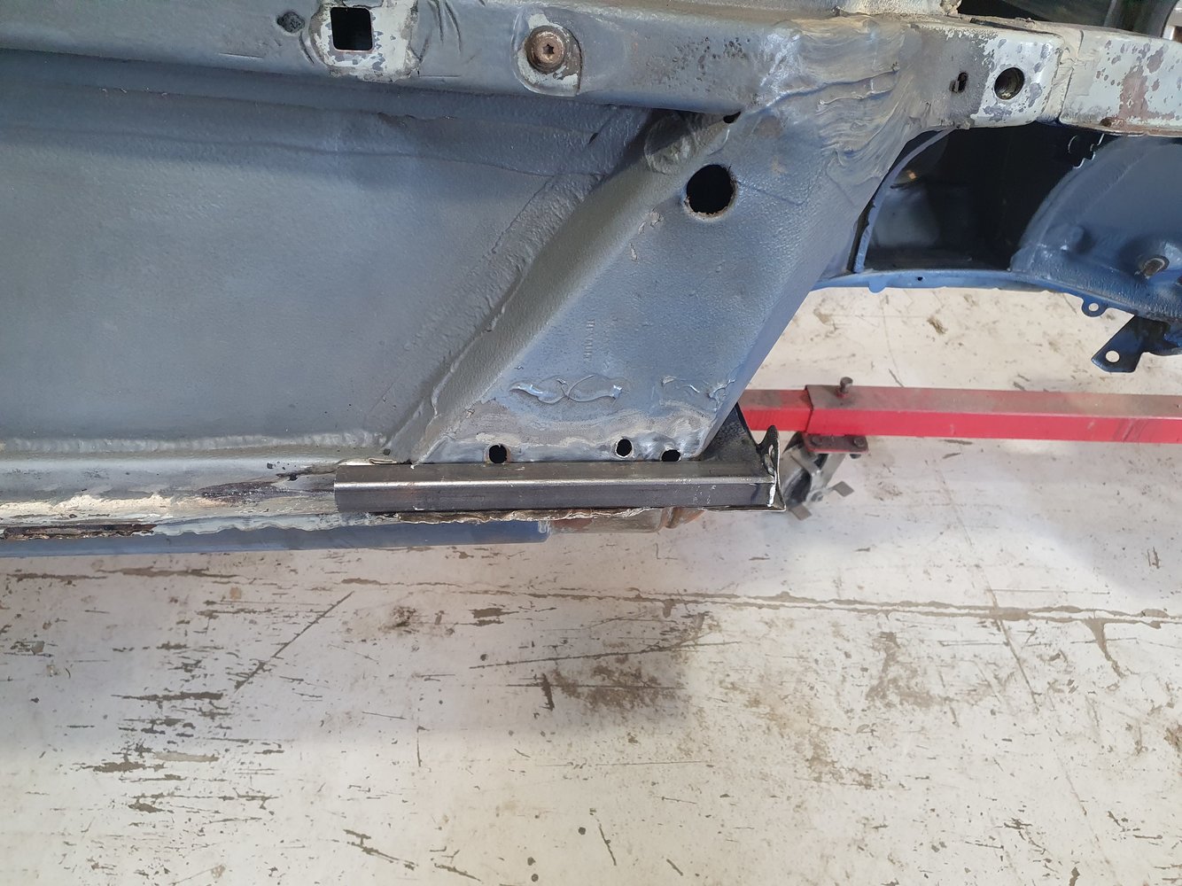

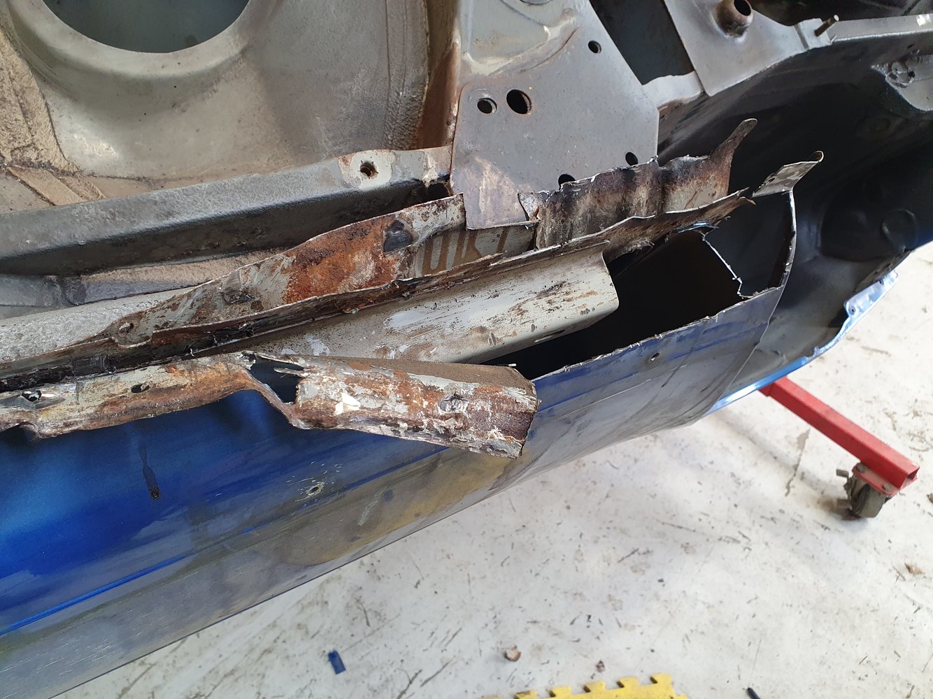

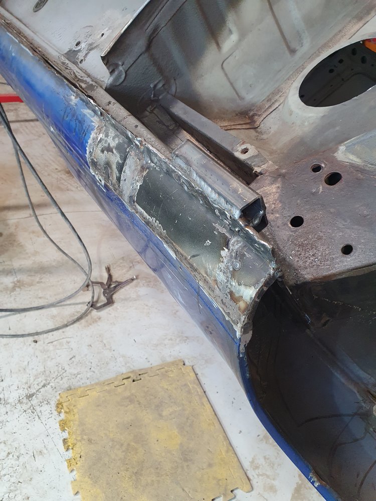

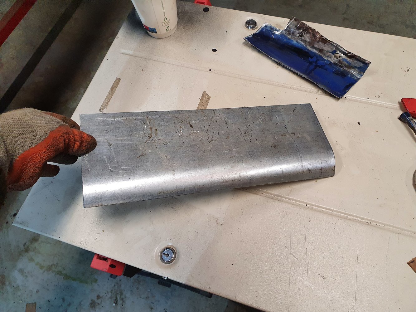

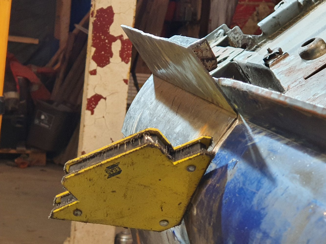

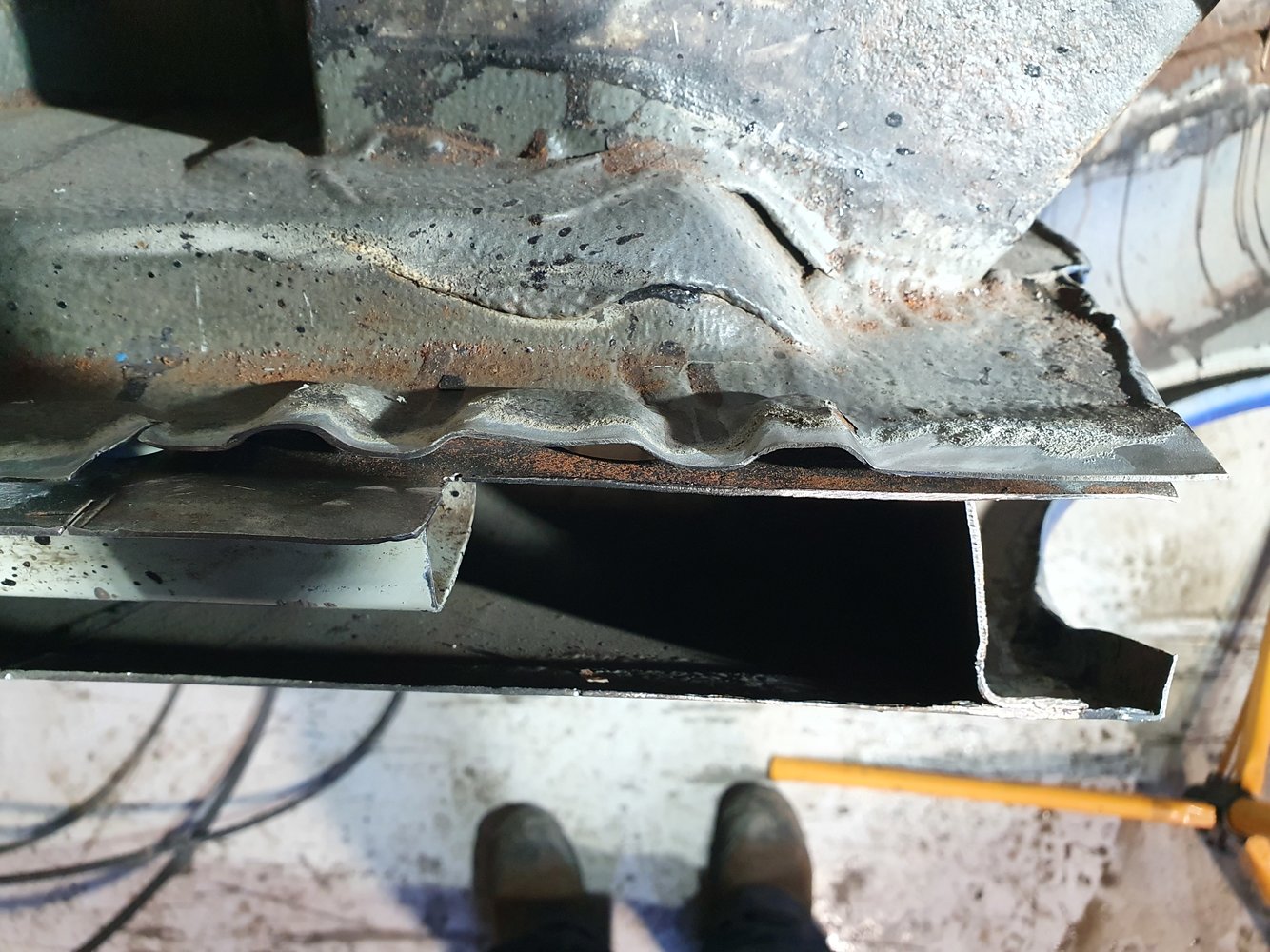

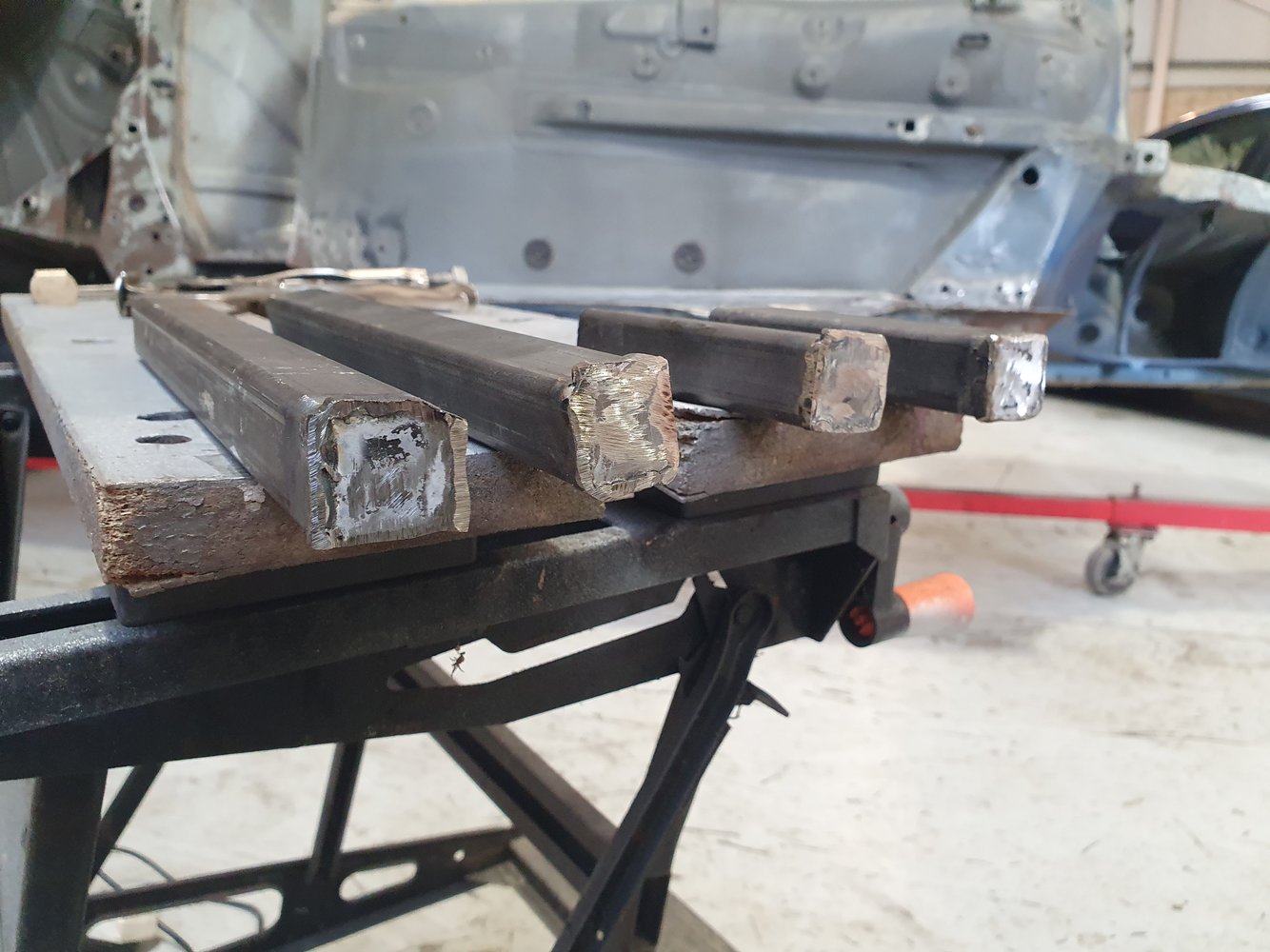

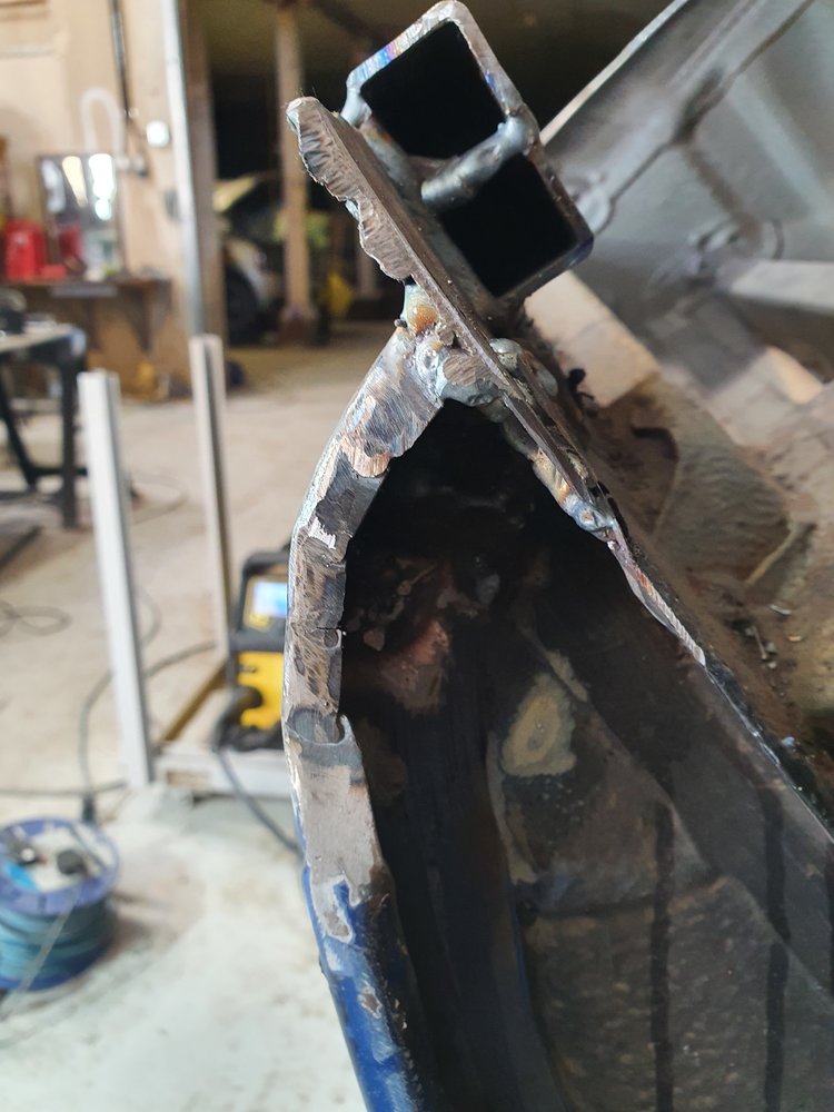

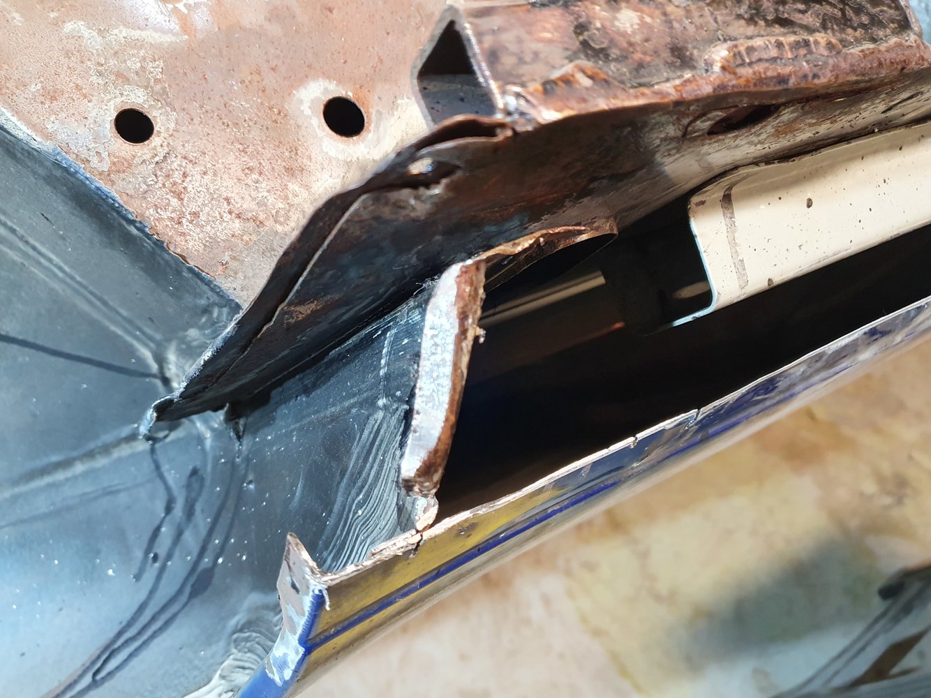

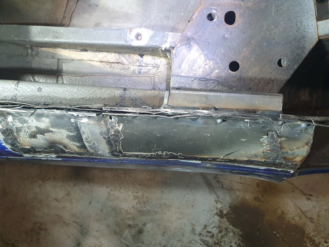

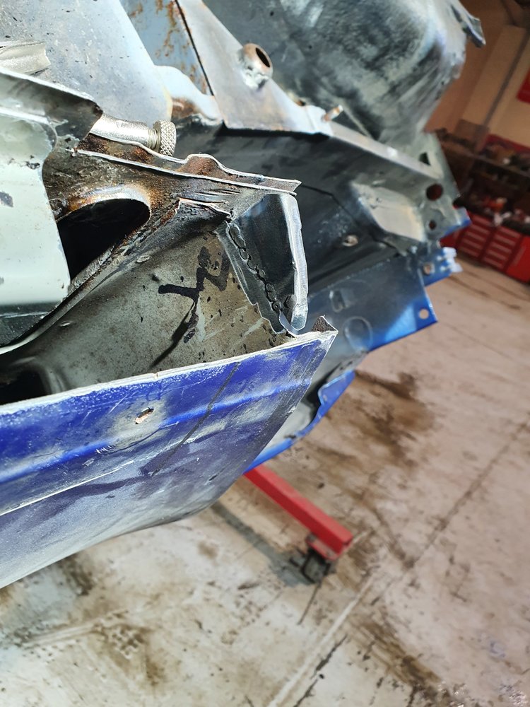

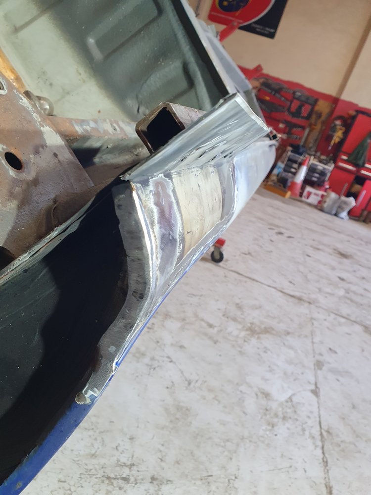

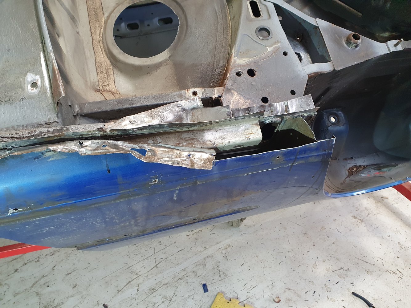

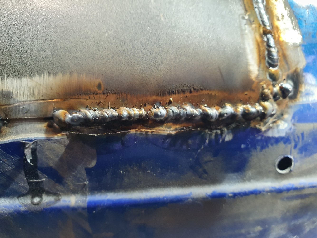

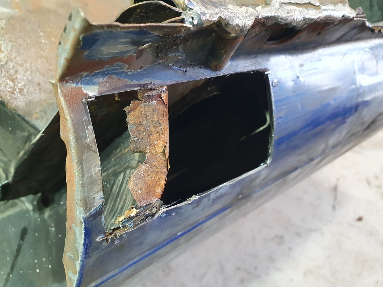

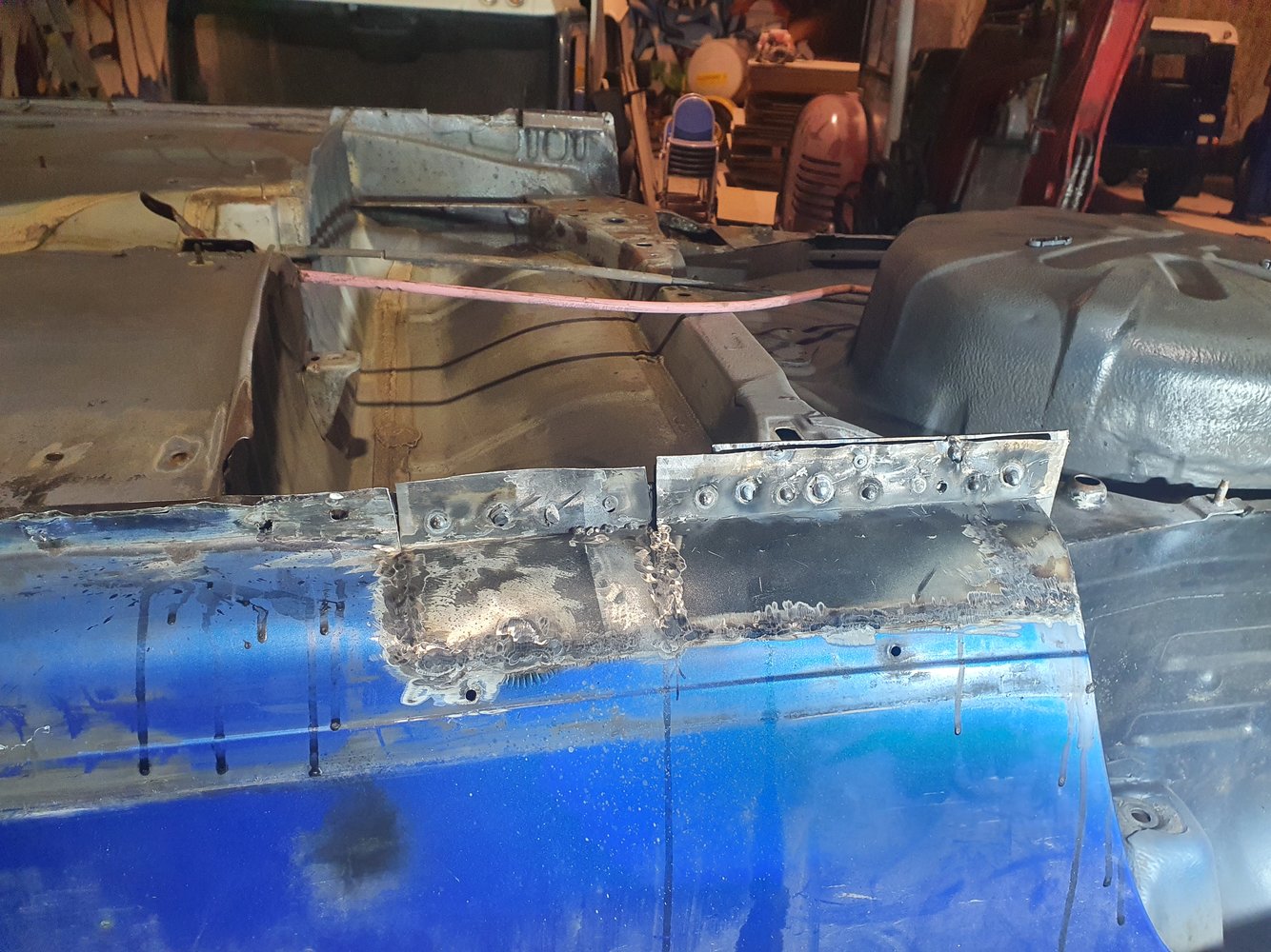

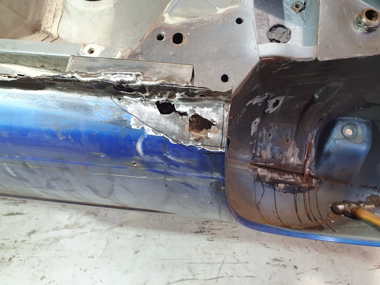

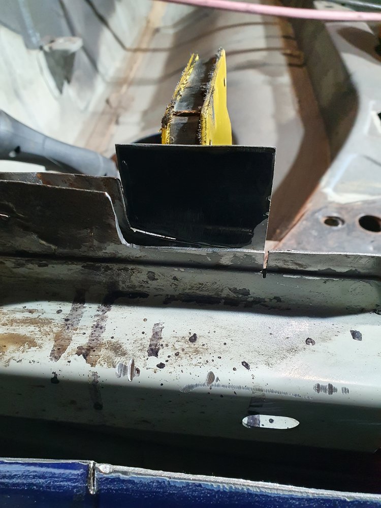

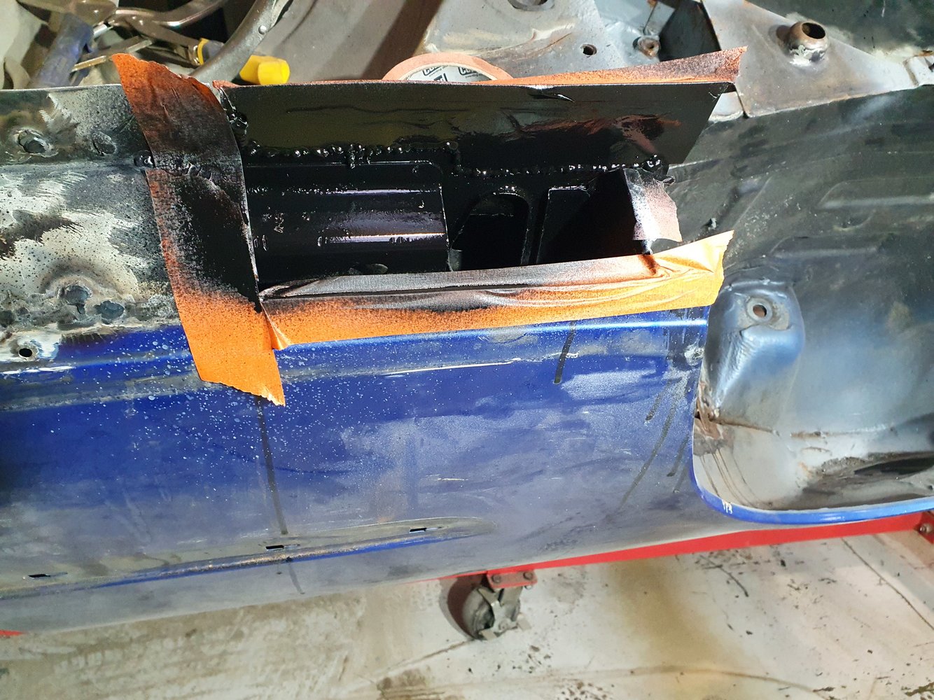

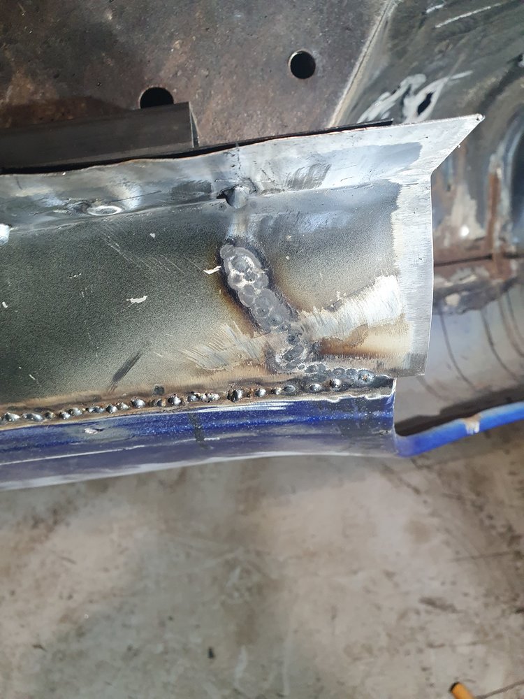

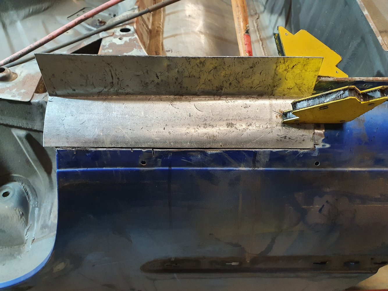

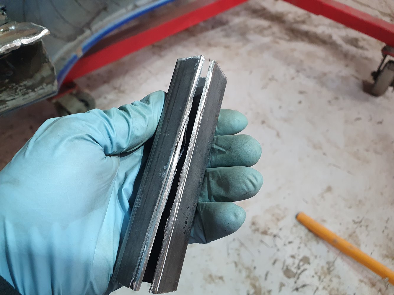

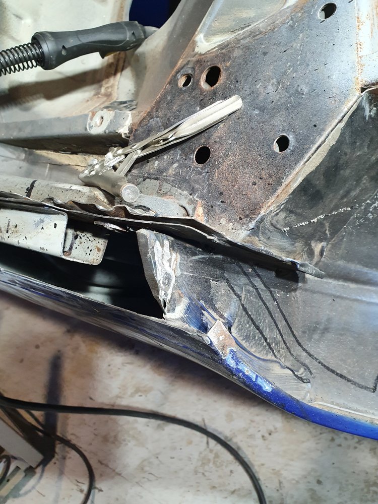

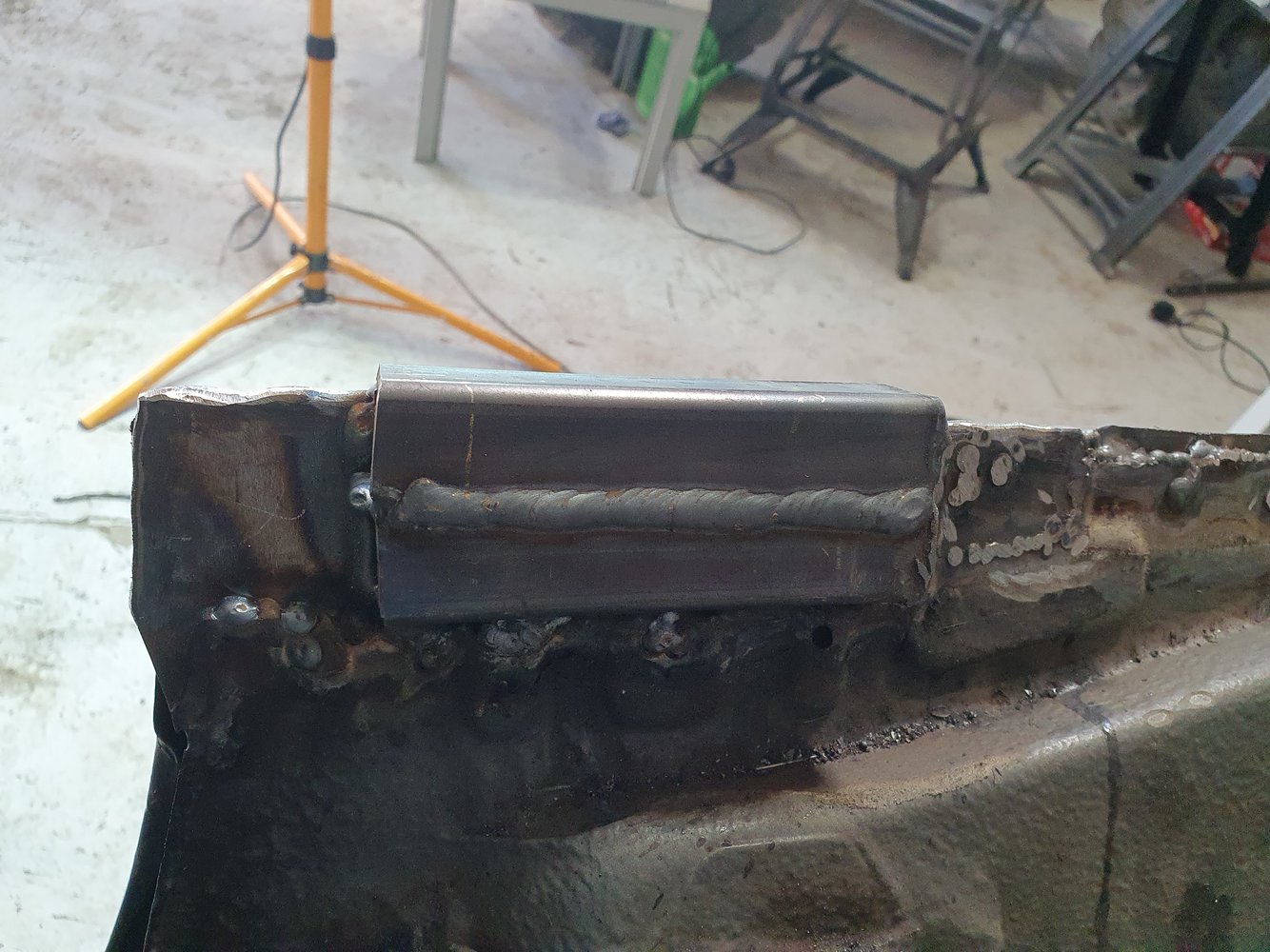

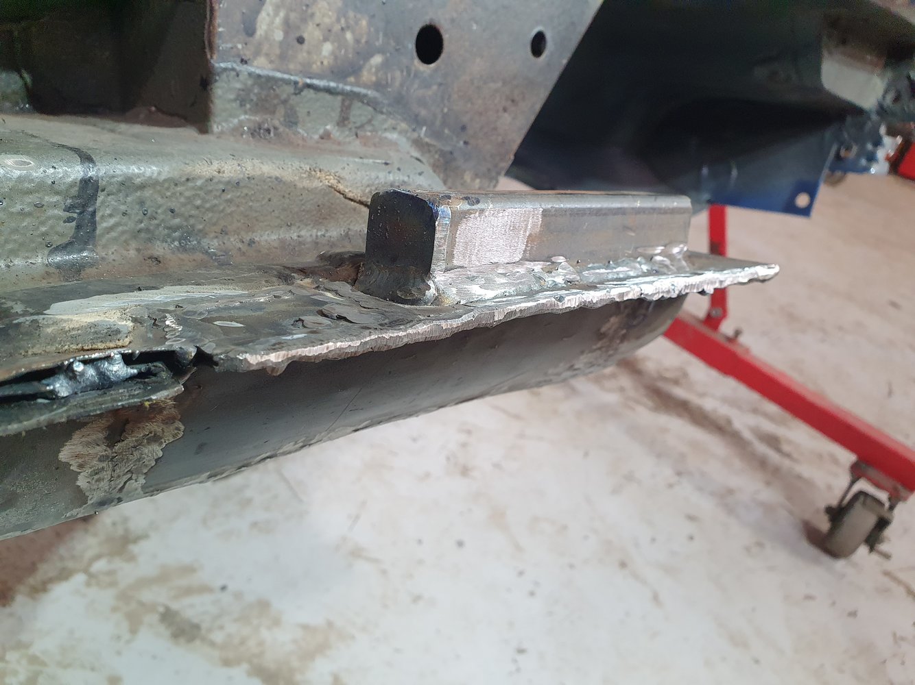

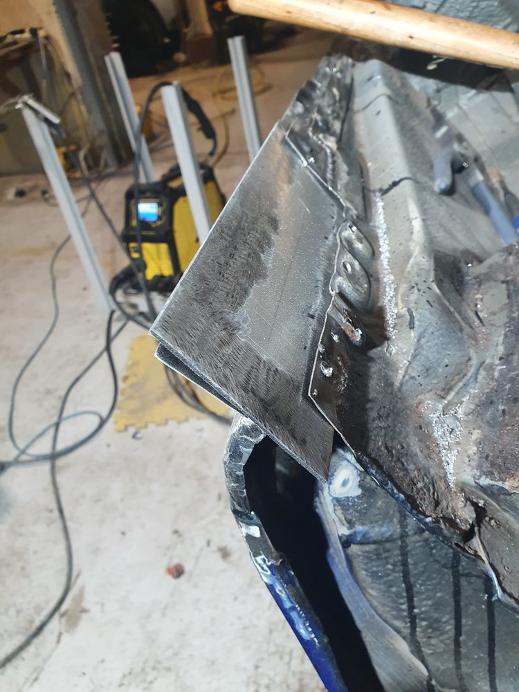

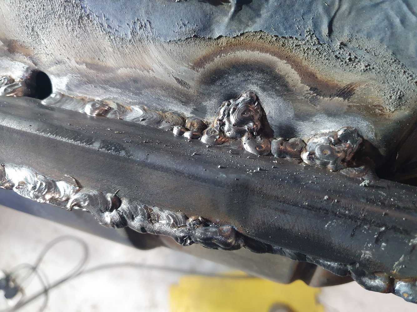

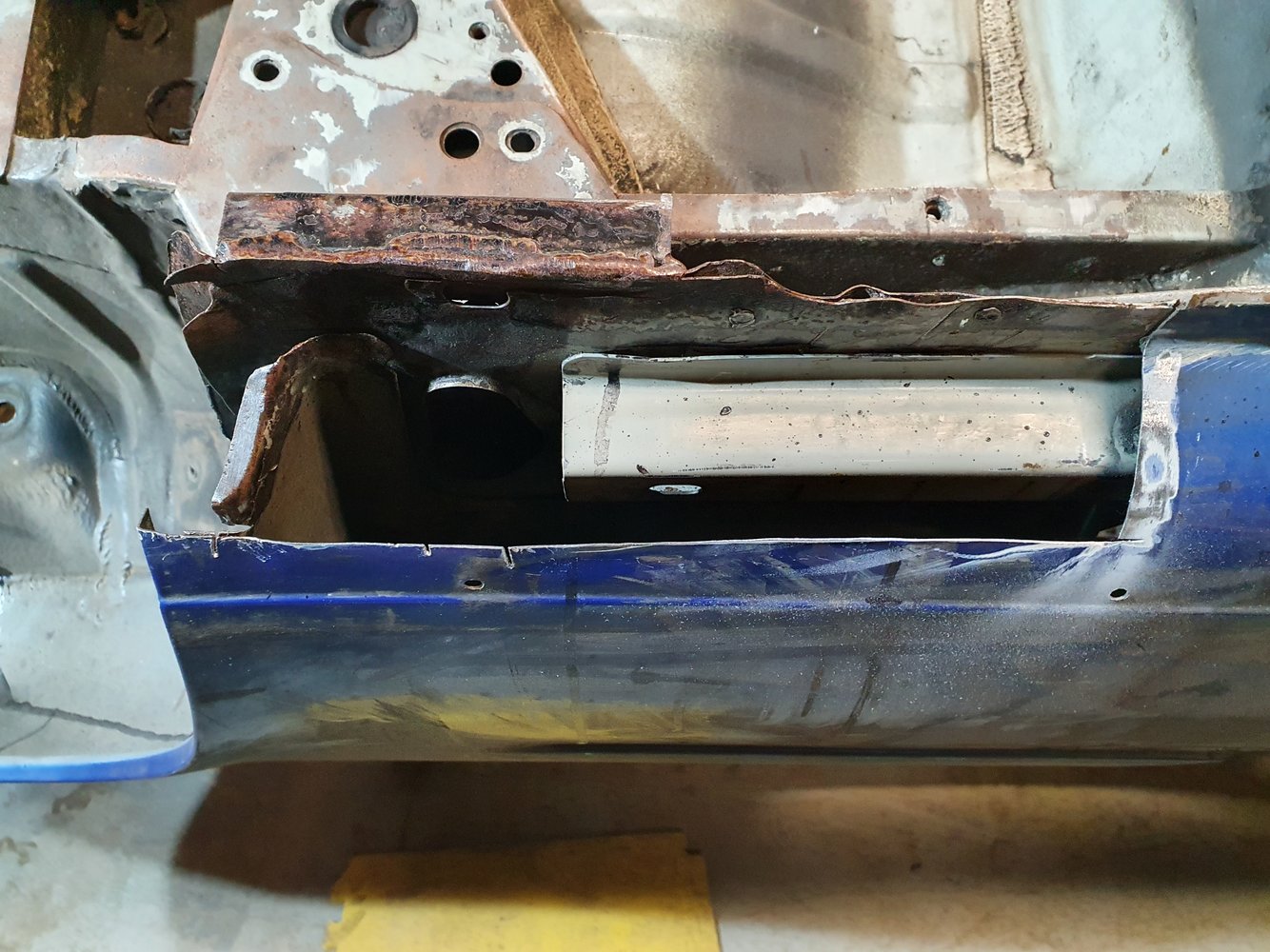

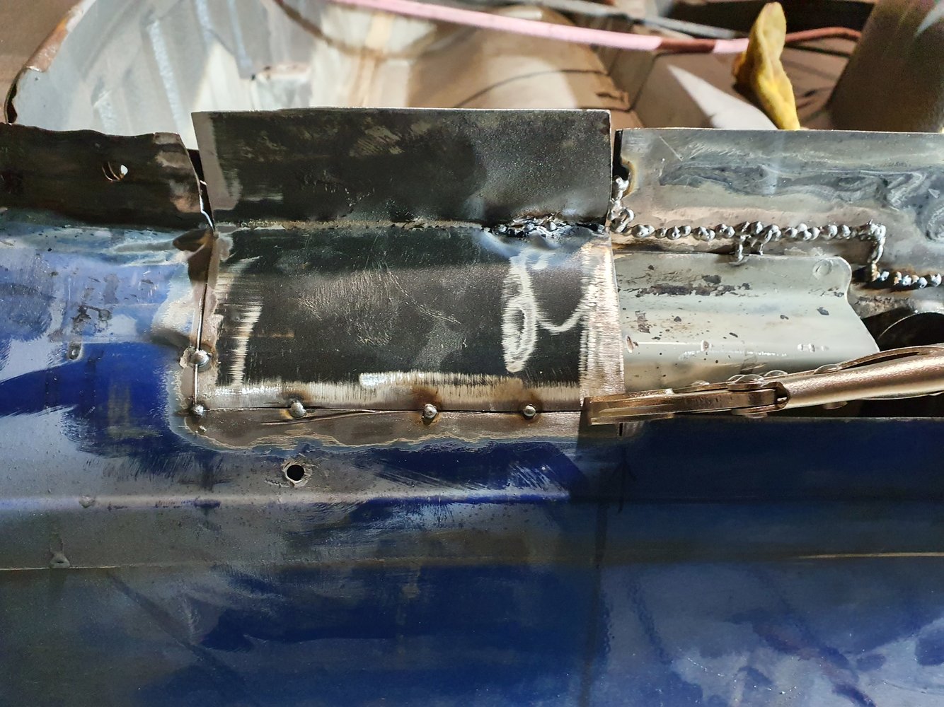

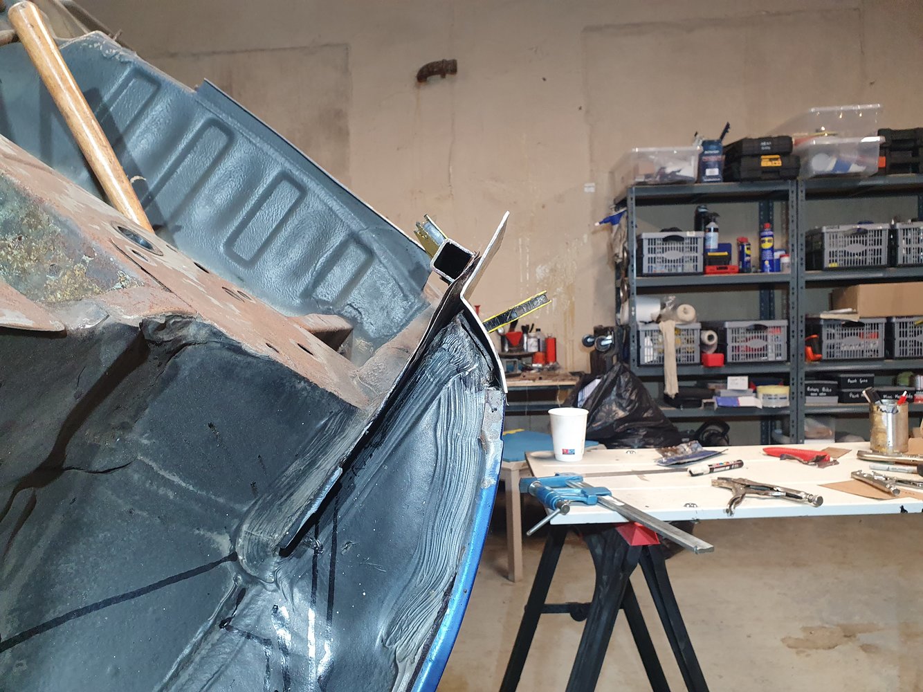

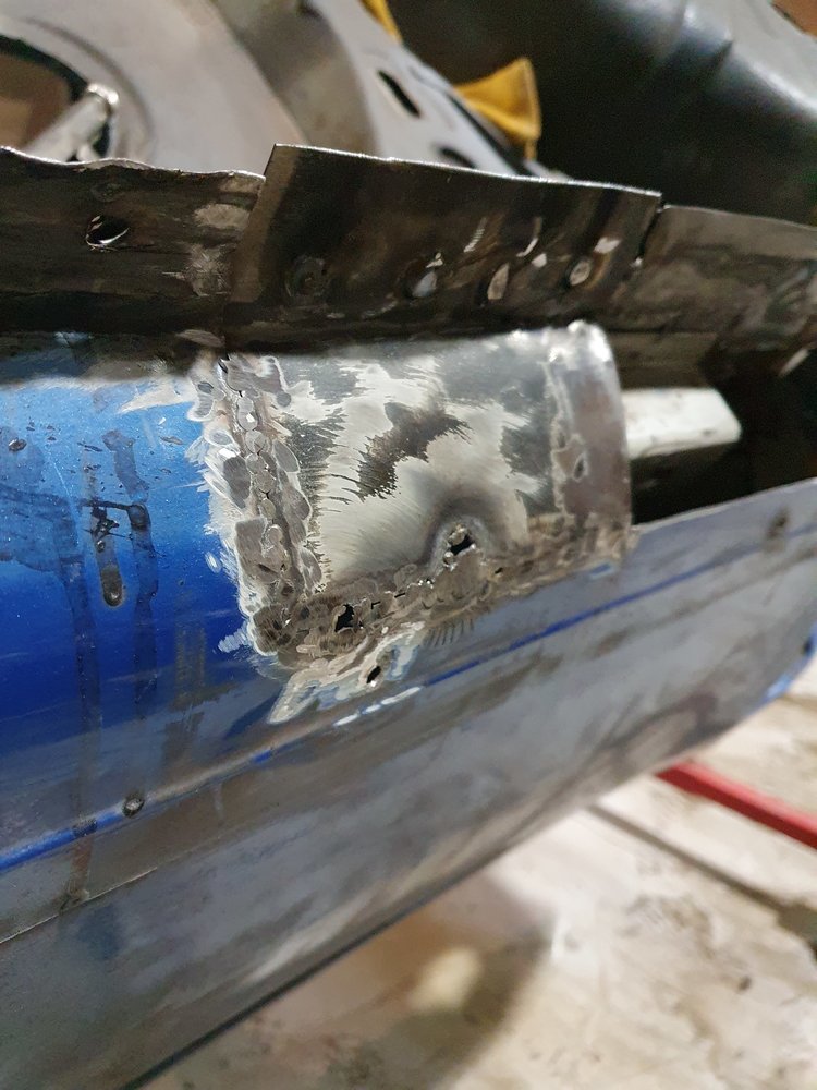

The following montage should explain where I ended up.. and you might then understand why it was a bit of a mental set back. Just as I thought I had finished the welding and ready to move to paint.
