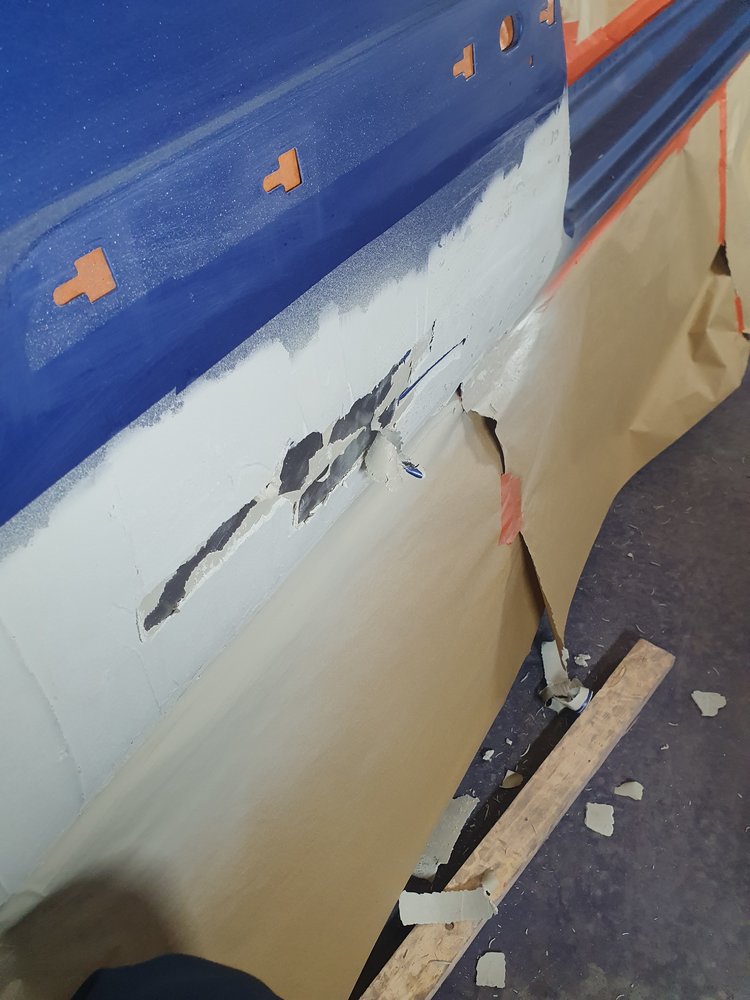

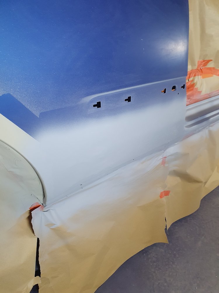

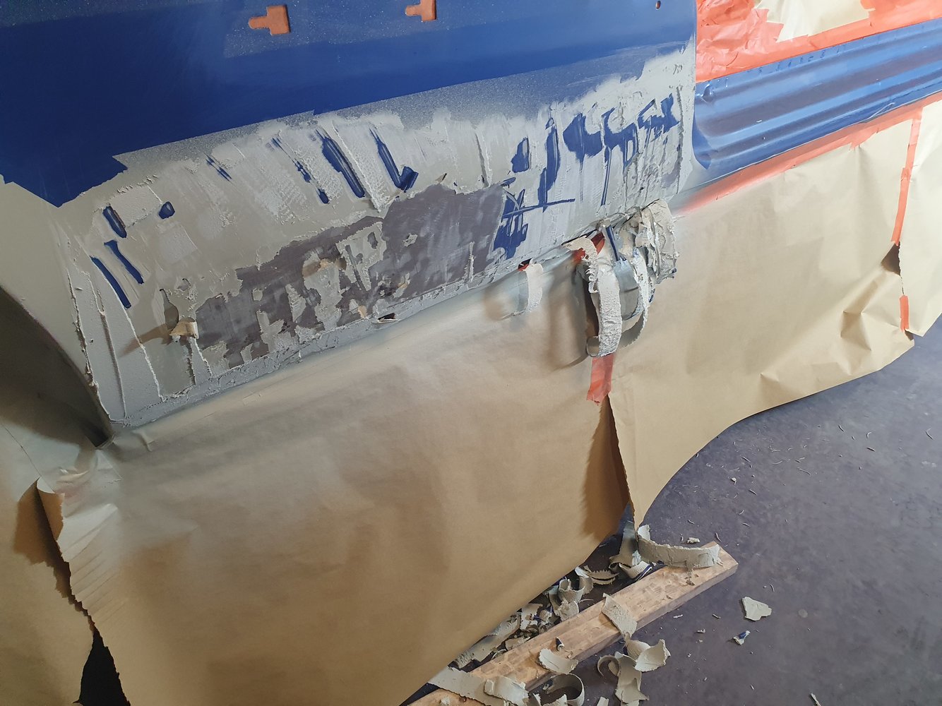

Soo... see the epoxy primer I lashed on in the last update.....!? Two things.
* I added some filler over it - I made too much filler in one go and likely didn't add enough hardener, so it never fully set.
* I'm not sure why but when I went about getting the filler off.. the epoxy primer primer peeled off too.. i'm not sure if that is correct or not.
Anyway.. here are some pics to make anybody cringe.

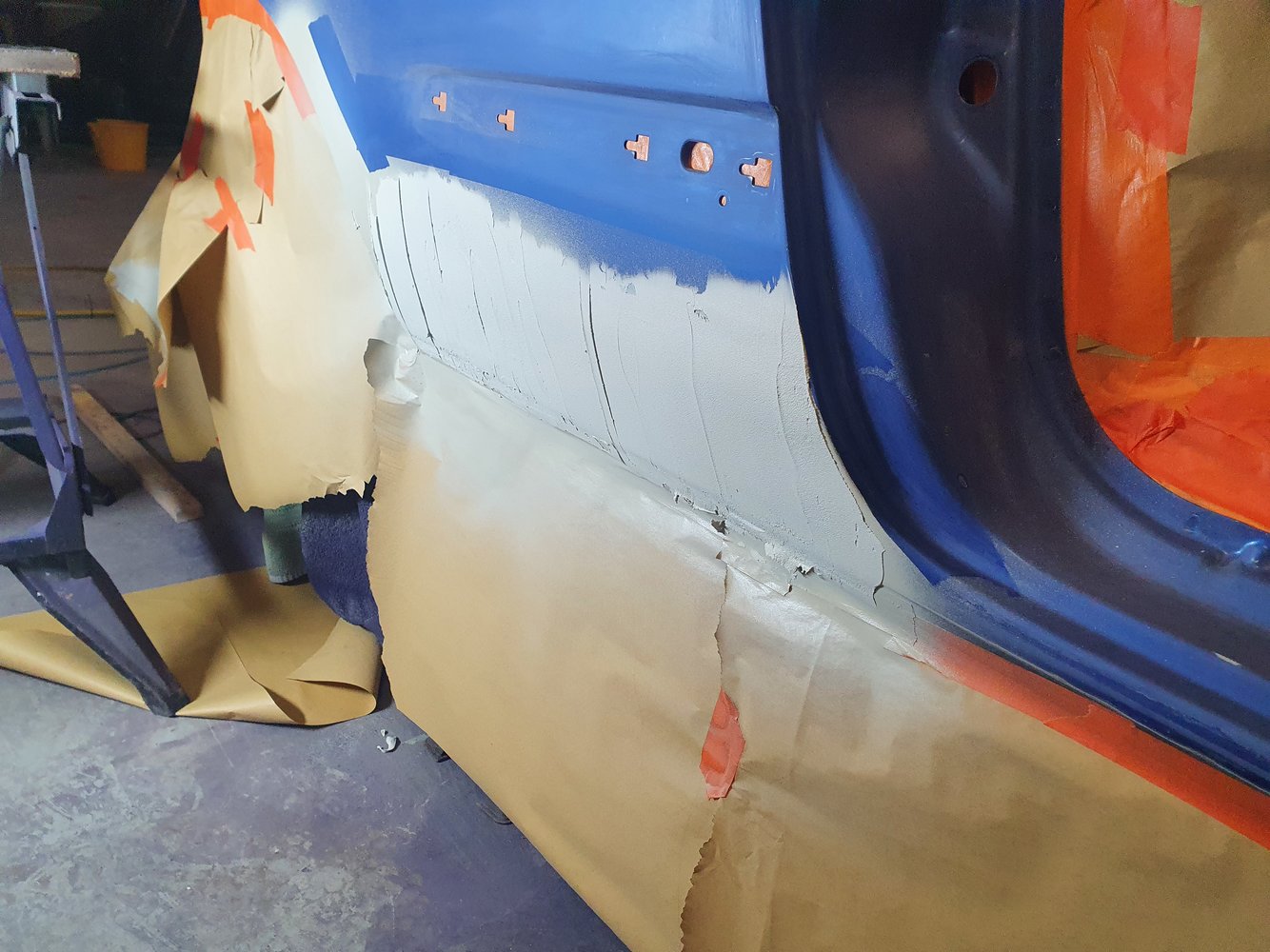

Beautiful filler job.. intended to be the first pass, which I would then shape and add another skim or two, before finally finishing and adding some glaze and further finish.
Best made plans and all of that.. It simply didn't cure, so it needed to come off... Absolutely brutal moment and one of the biggest mistakes I made on this build. I mixed too much filler really..

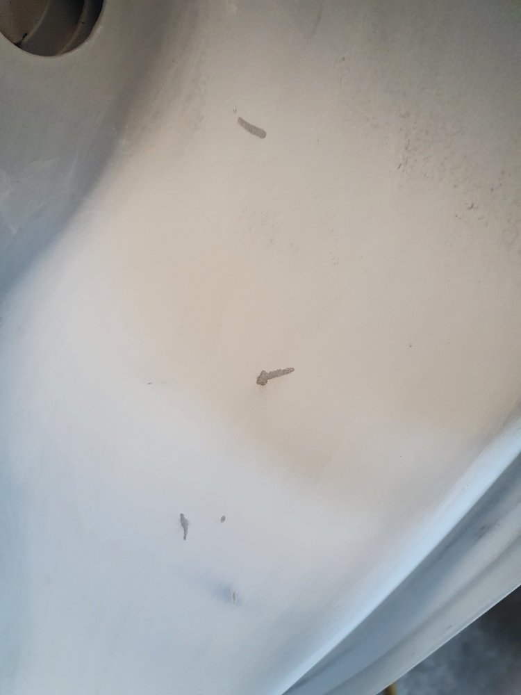

Oh.. in this pic you can also see how the epoxy primer just peeled off.. not something that fills me with comfort given there is still some of the same batch around the fuel filler area. Perhaps I didn't wait the induction time before spraying. I imagine that will keep me up at night.. but I guess if it does peel in future i'll fix it.

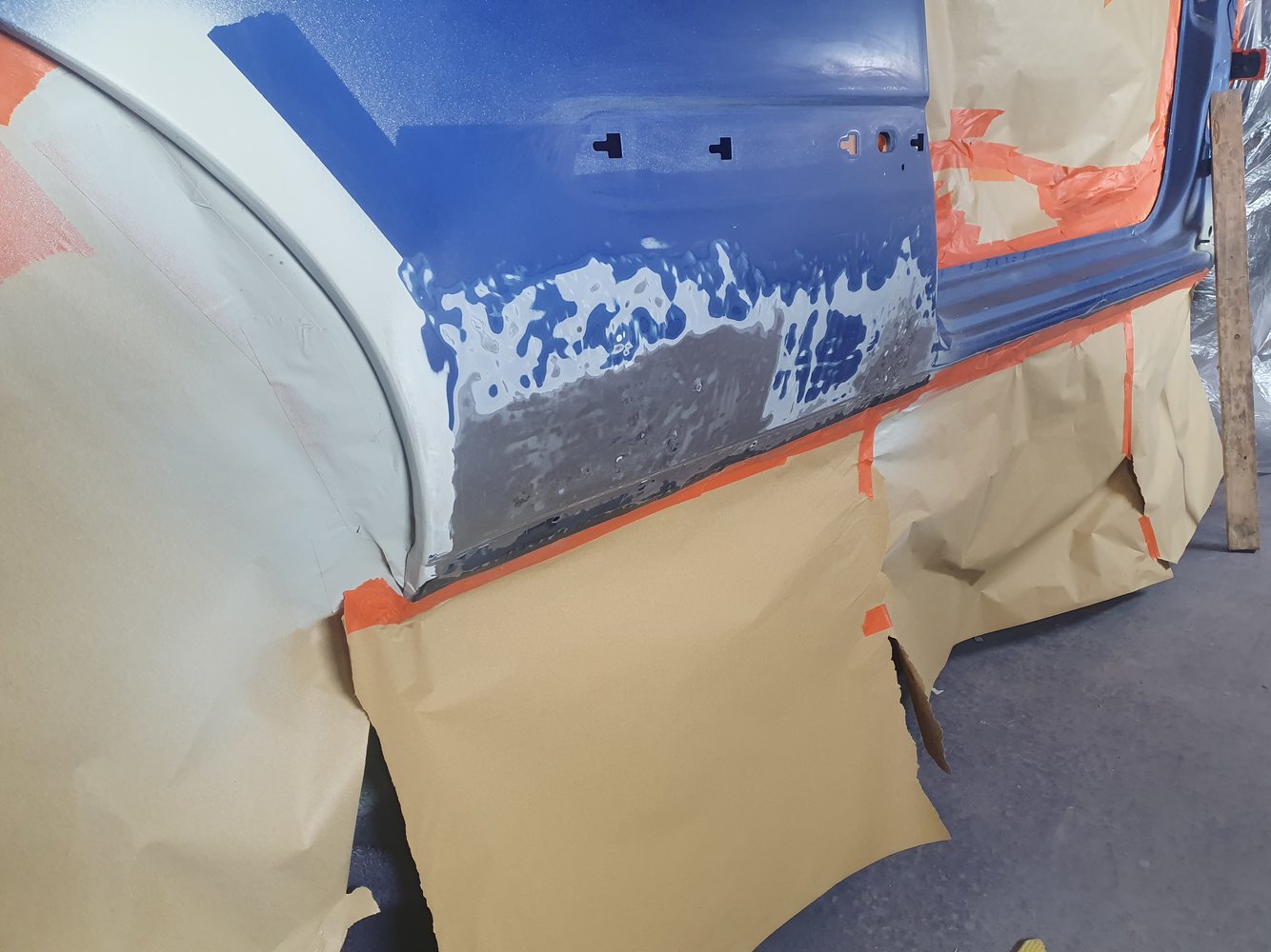

And this is how the cleanup operation finished. Once the filler and epoxy primer was cleaned off.. I did 80 -> 180 -> 240 grit... then etch primed.
It's not in the pictures but I did have an electric fan heater on that panel plenty of times throughout the process so I am not worried about putting the etch on a cold or damp panel. I am confident that the etch will offer up some good adhesion. The 2k high build primer went on shortly after the etch.

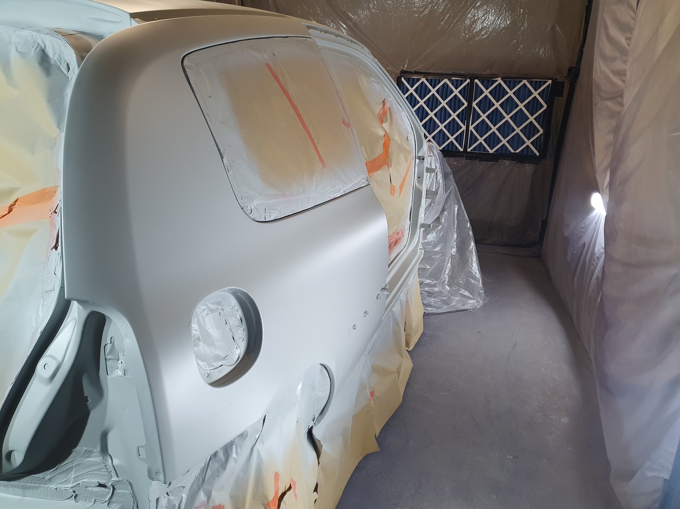

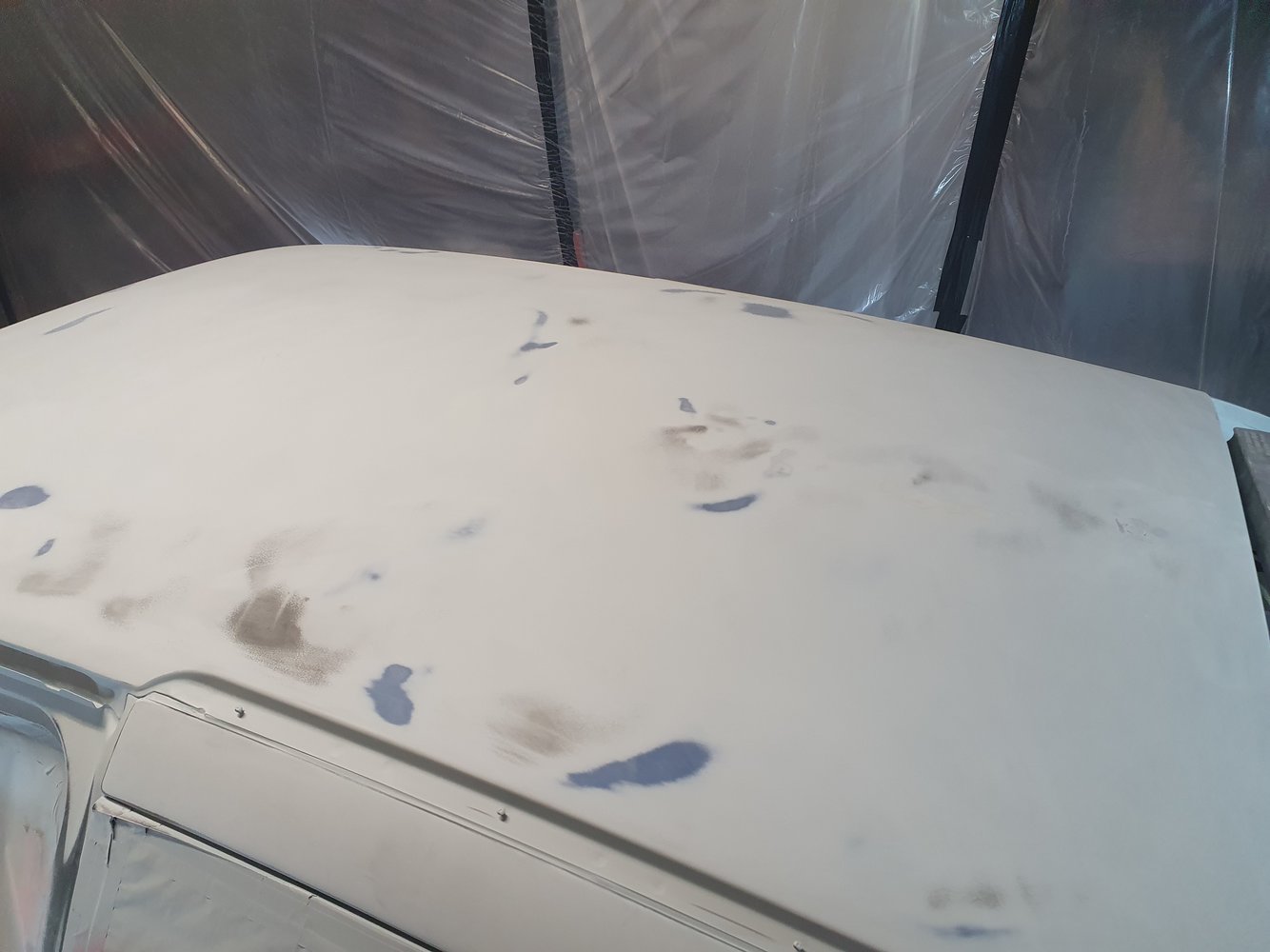

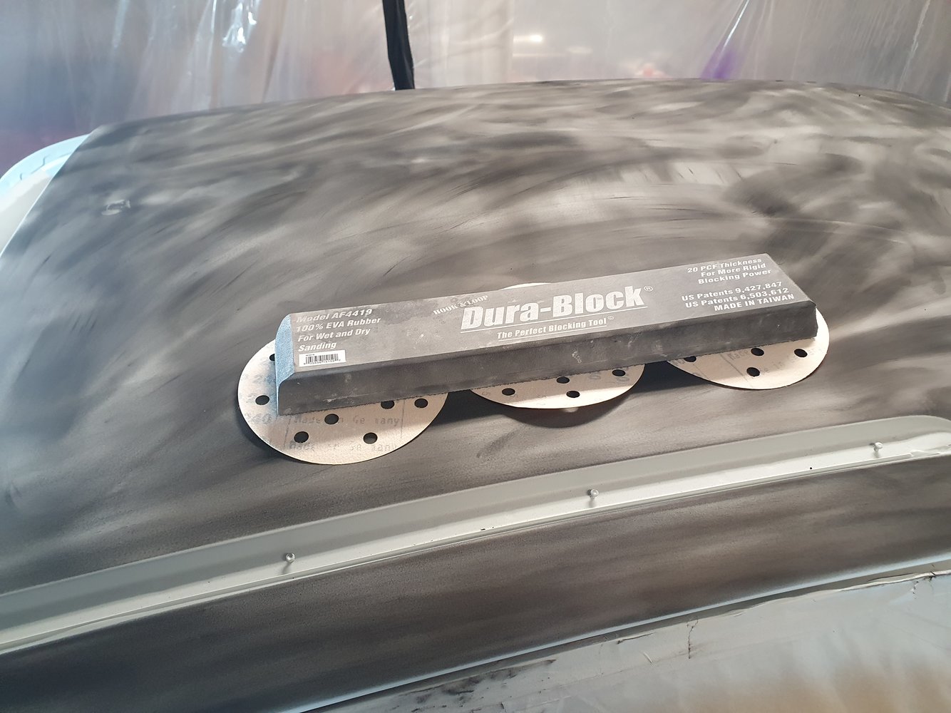

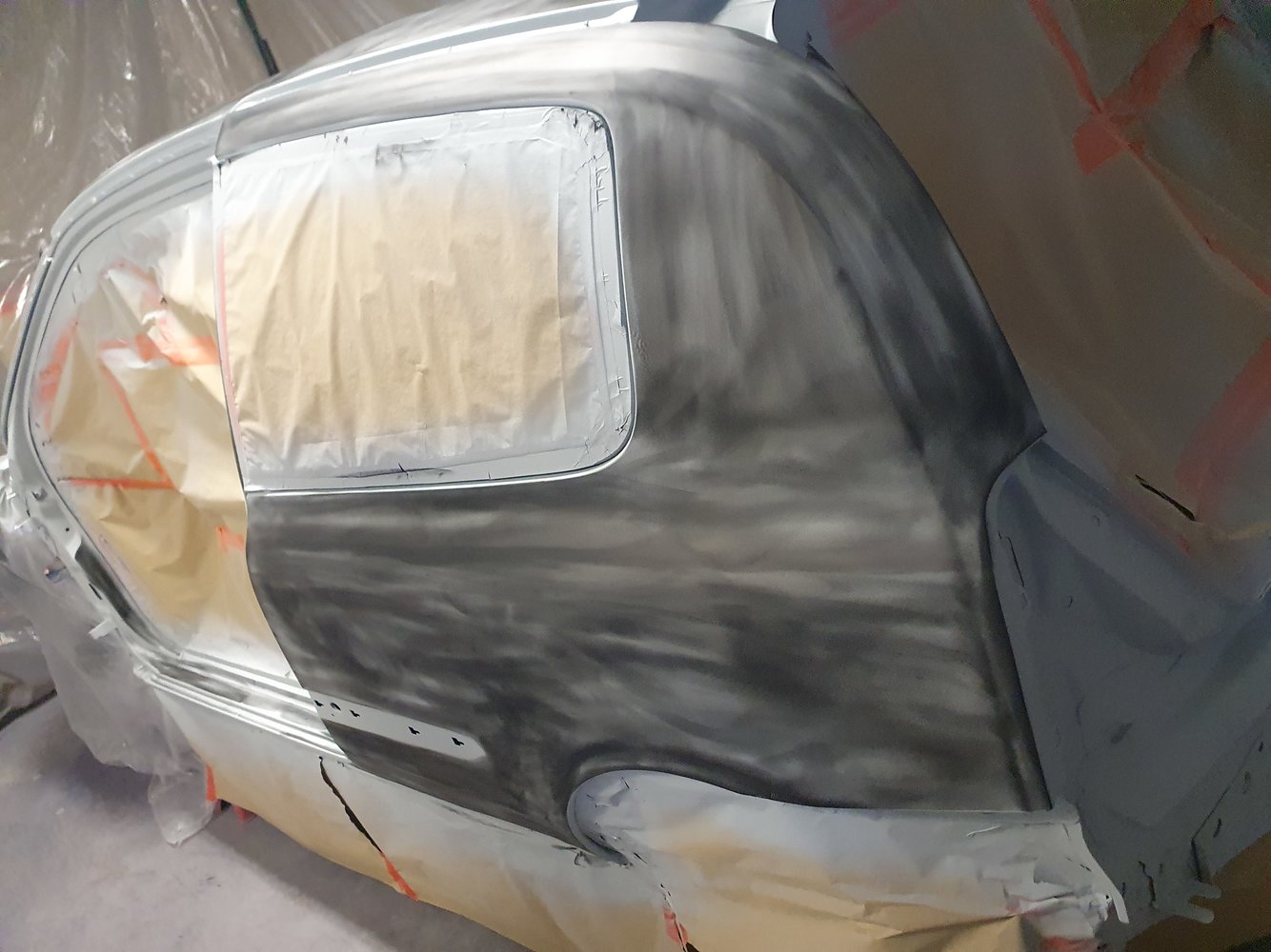

And now for the 2k high build primer... which I bloody well ran out of after 2 coats. 2 coats is fine as it allows me to block etc while I wait for more to arrive in the post.
If you look closely in the following picture you will see my schoolboy error of not feathering the hard edge of epoxy primer around the fuel filler area.. It's not a big deal really as the shell will be getting another coat or two of high build before the base coat (colour) is applied so it will be eliminated.
For those curious about the masking around the window areas. I used 3M trim masking tape. Honestly it is pretty expensive but works fairly well. I am sure I could have worked without but it seems to do a good job at keeping the trim away from the body and I will be very surprised if I don't end up with a really neat finish later on.

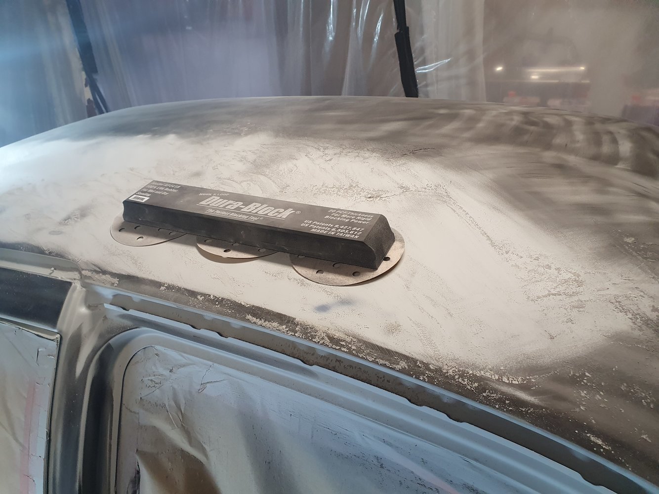

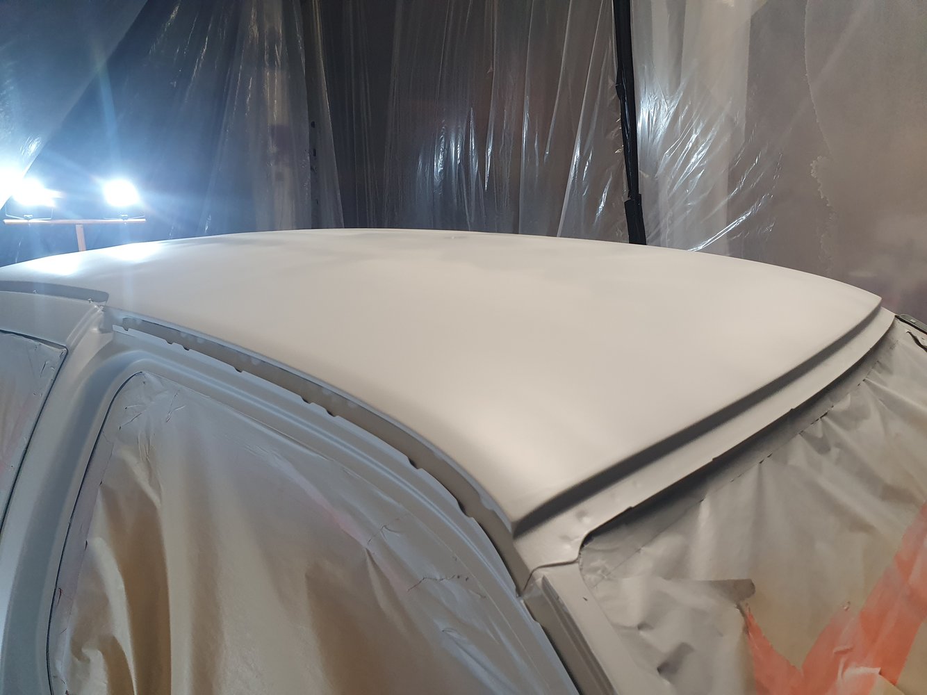

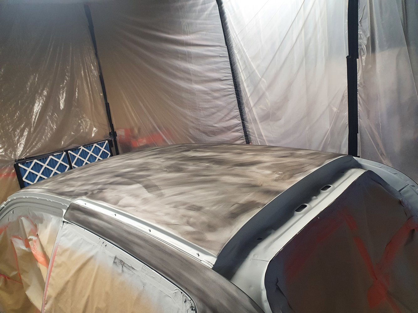

Roof looks a bit funny as there are still a few damp primer spots .. it is also the most ropey panel on the entire car, as there are a number of high/low spots. Blocking that will be fun (not!) and I am sure there will be a bit of glaze here and there.

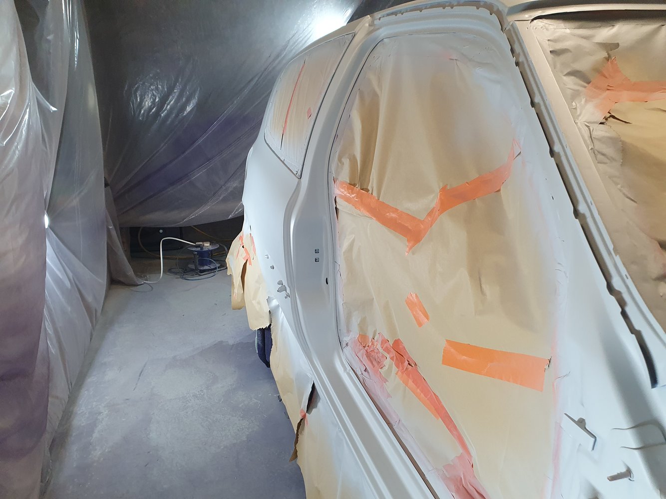

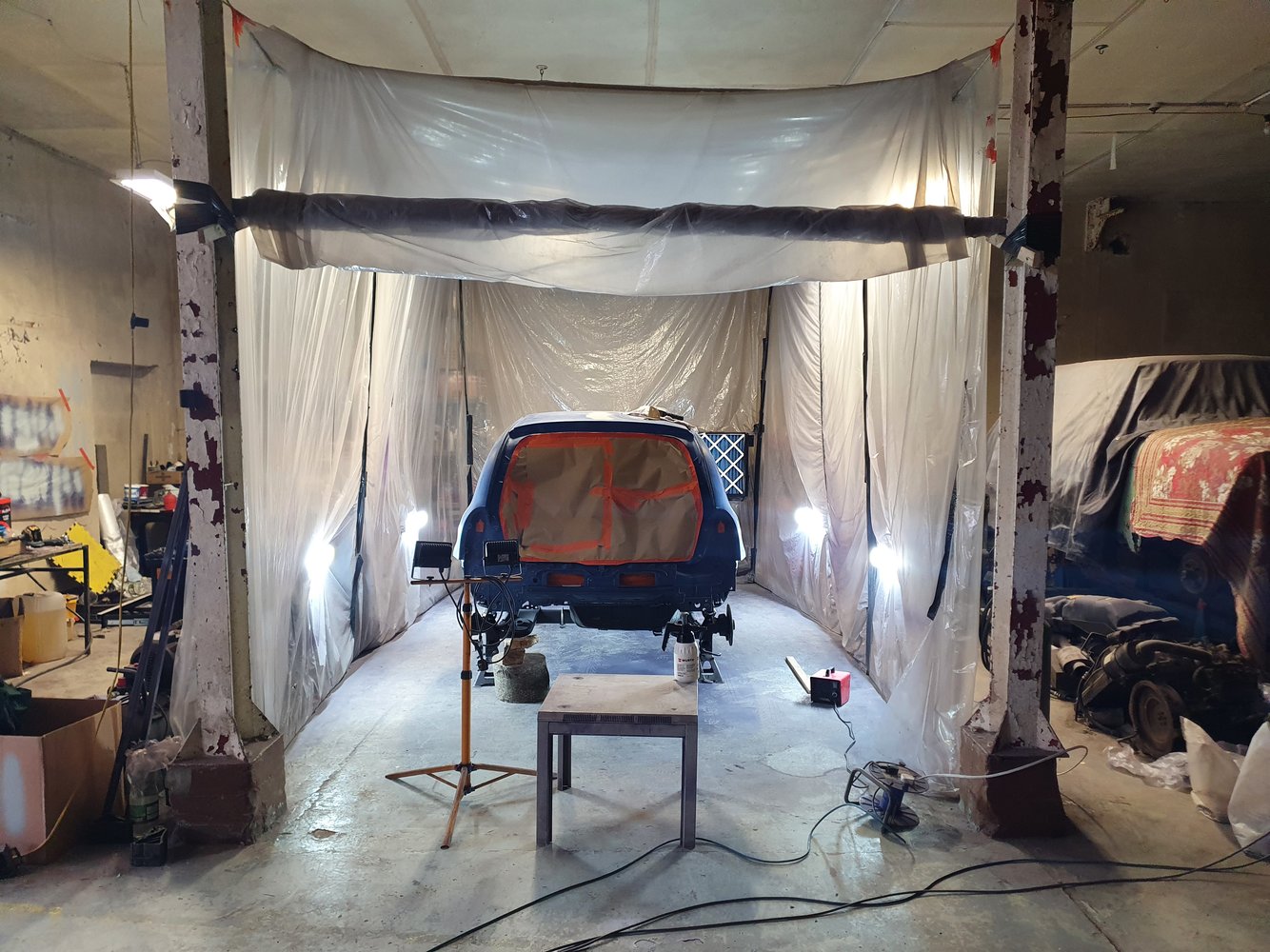

Oh and for s**** and giggles.. I have two photos left in the kitty for this post so here is a snap of the car in the booth before final masking.. I must say I really like my DIY spray booth. I get zero dust in there. I think I said it before.. but I remember painting something in it on a Thursday and the following monday I ran my finger along a panel and there seemed to be zero dust on it.
See where the little stool/table is at the entrance to booth.. I place a big powerful fan (out of frame) just in front of it and it does a really good job of getting the overspray out in a timely manner.
There is the heather I previously mentioned.. I leave it on around the booth for an hour or so before painting and it does a great job at bringing up the temperature. Panels are 15/16 degrees Celsius when I start to paint, which is supposed to be ok.
For the primer stage it's not important. But when I am laying base/clear I pour water (with a bit of soap to break the surface tension) on the floor and sweep it around and out of the booth to collect/supress the dust.
