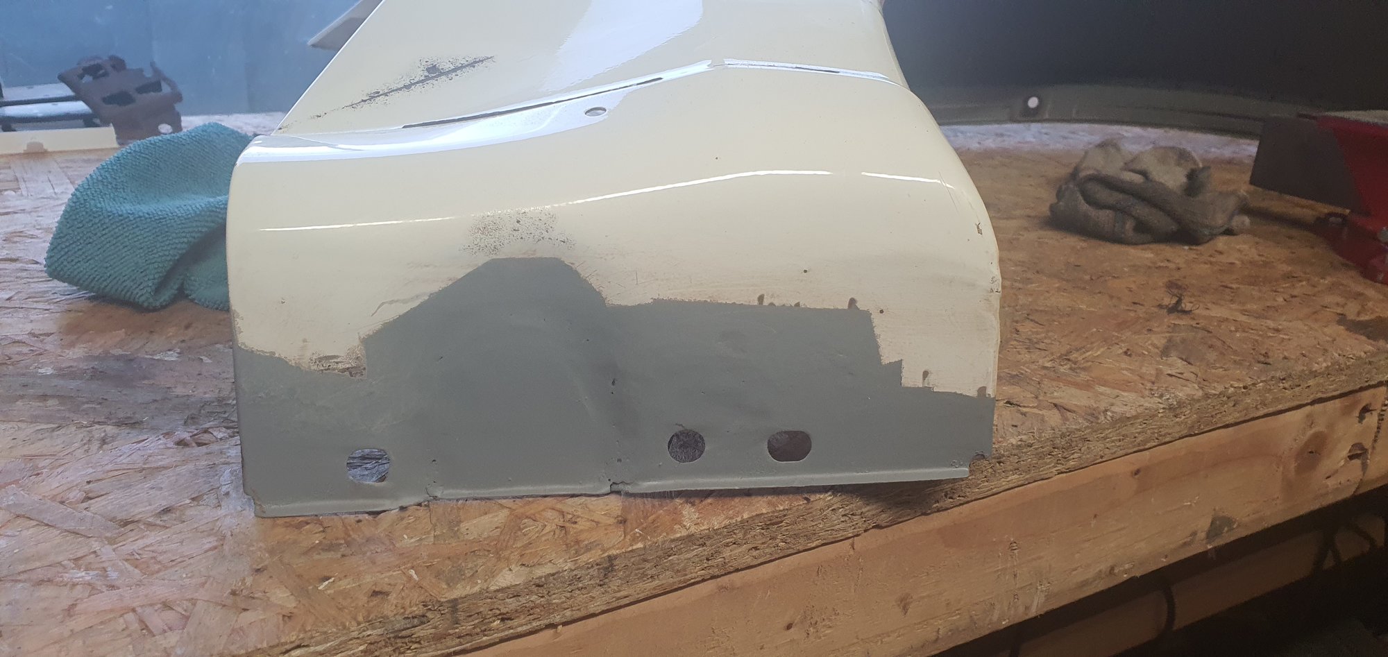

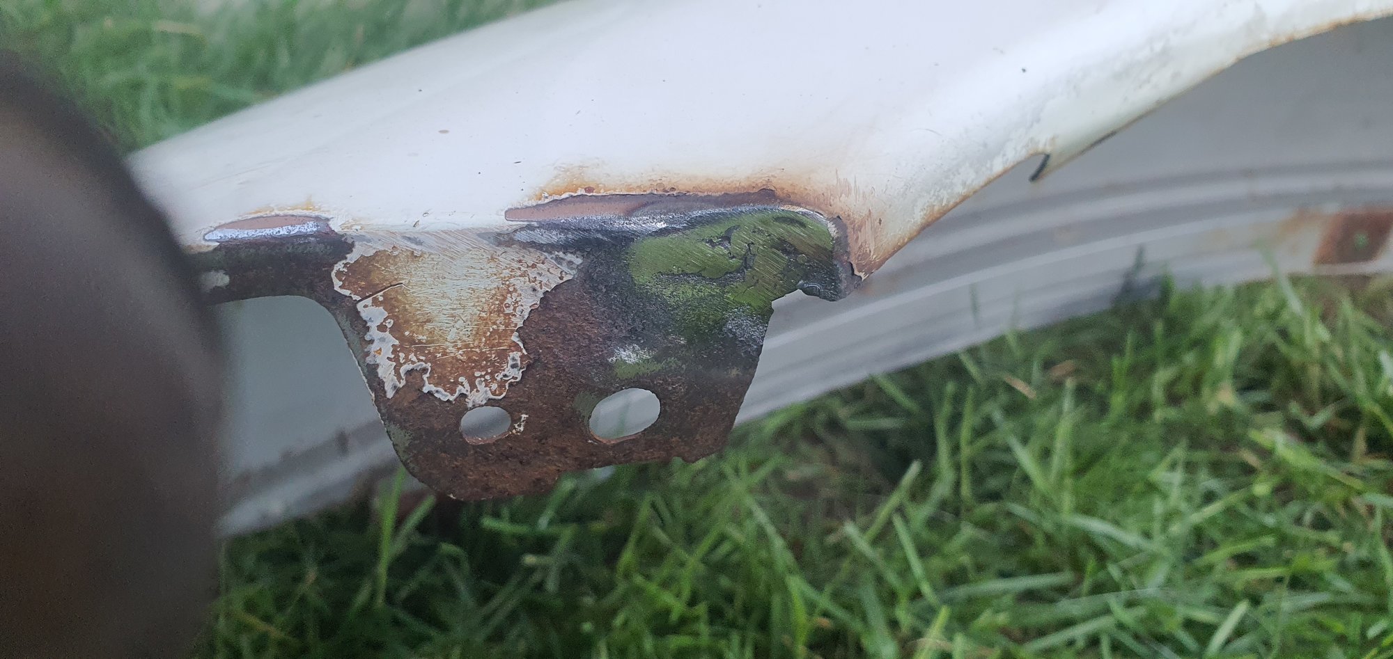

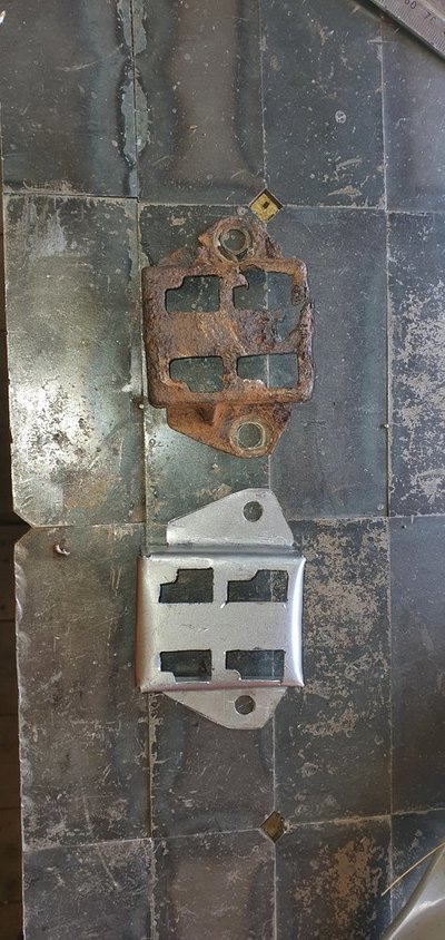

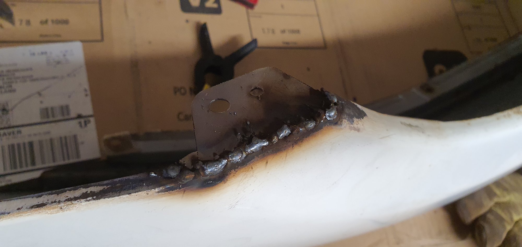

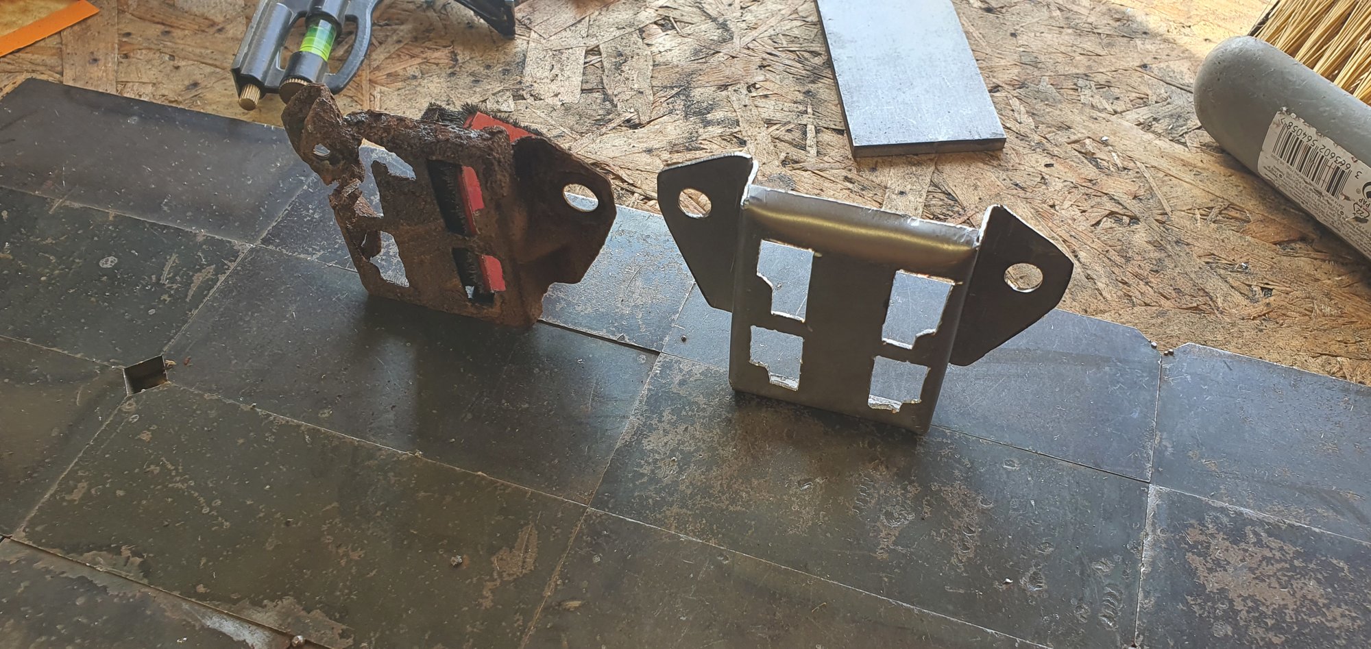

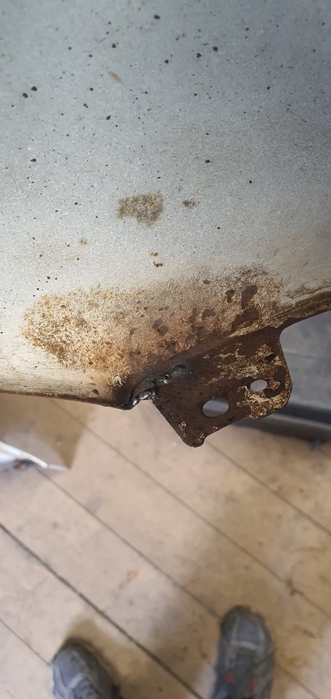

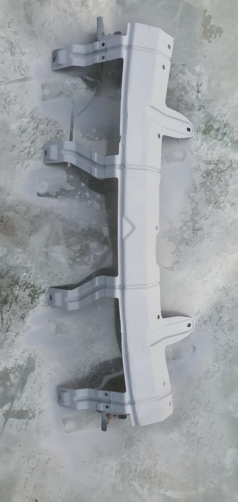

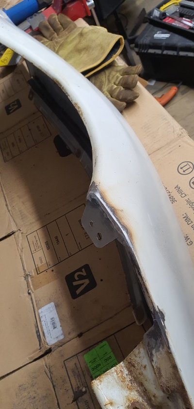

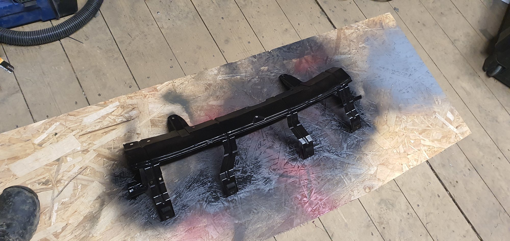

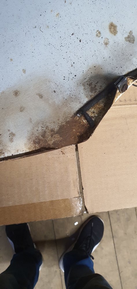

So bumper bracket is done and this is the first piece I've repaired and am happy with how it turned out. I just need to spray it black and it's ready to go on the car.

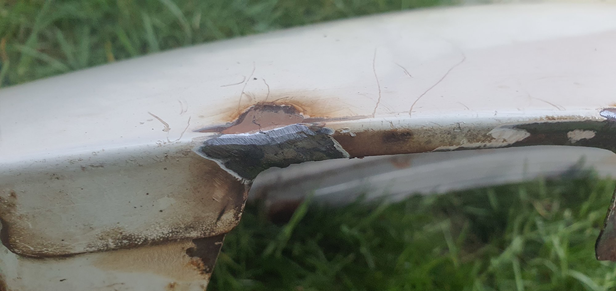

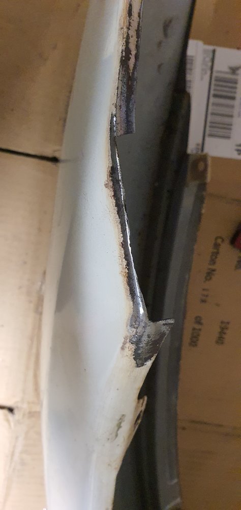

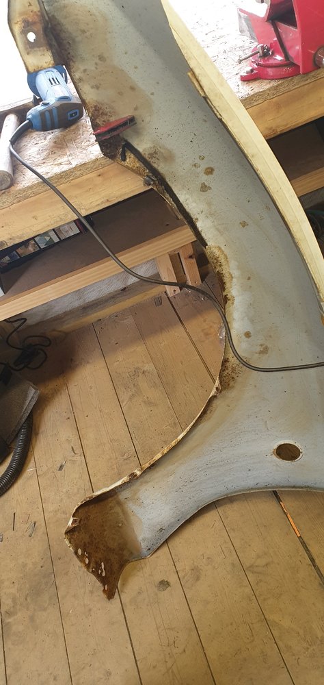

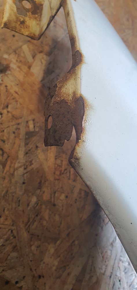

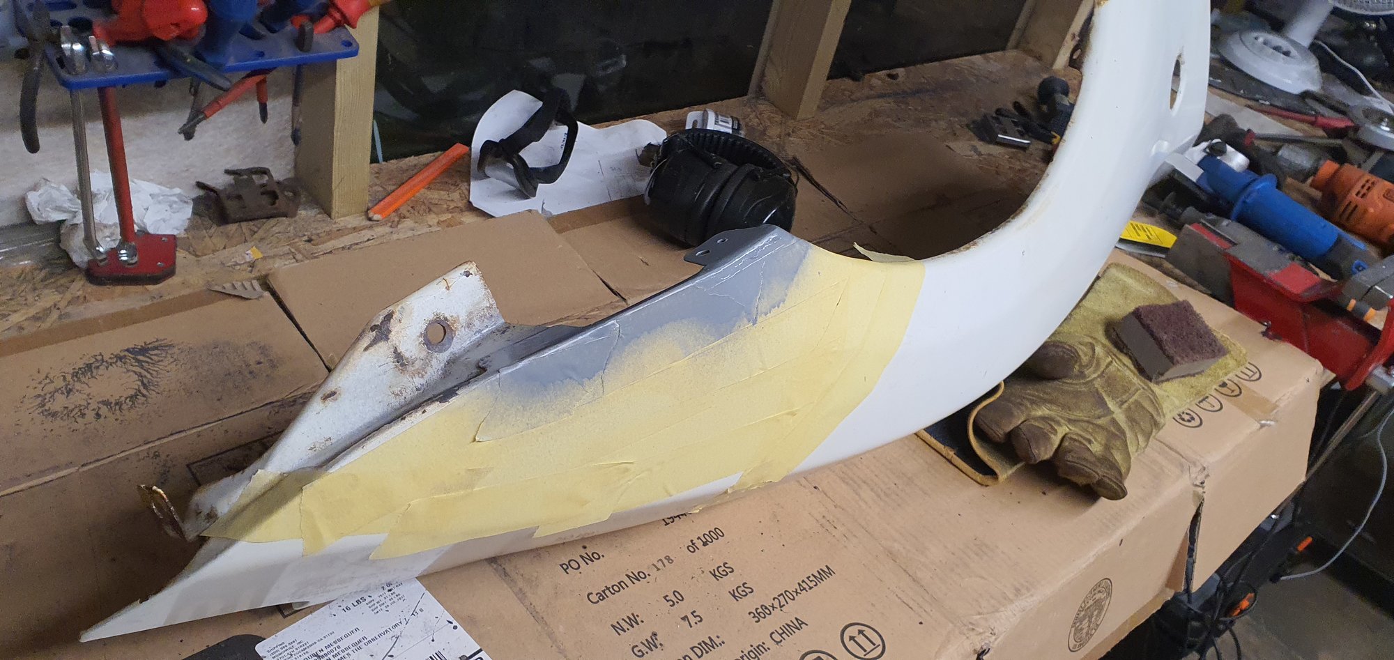

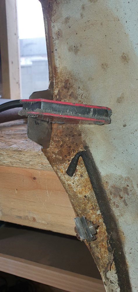

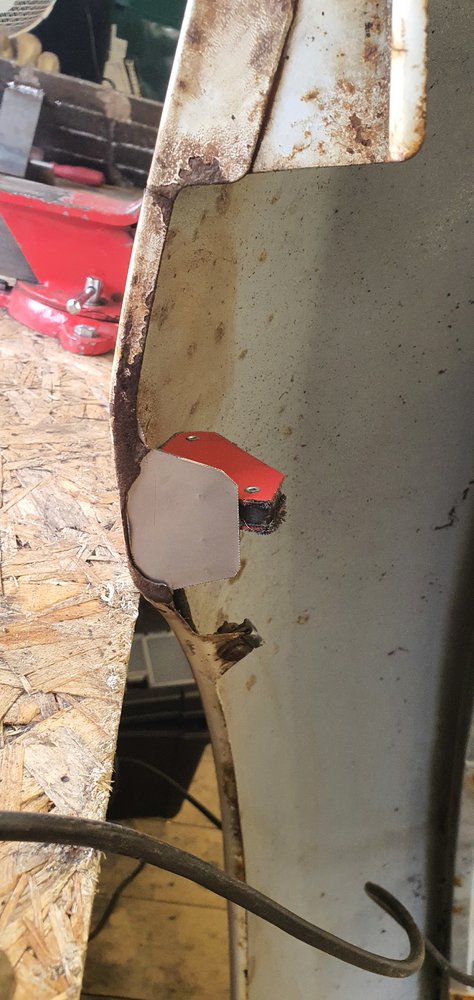

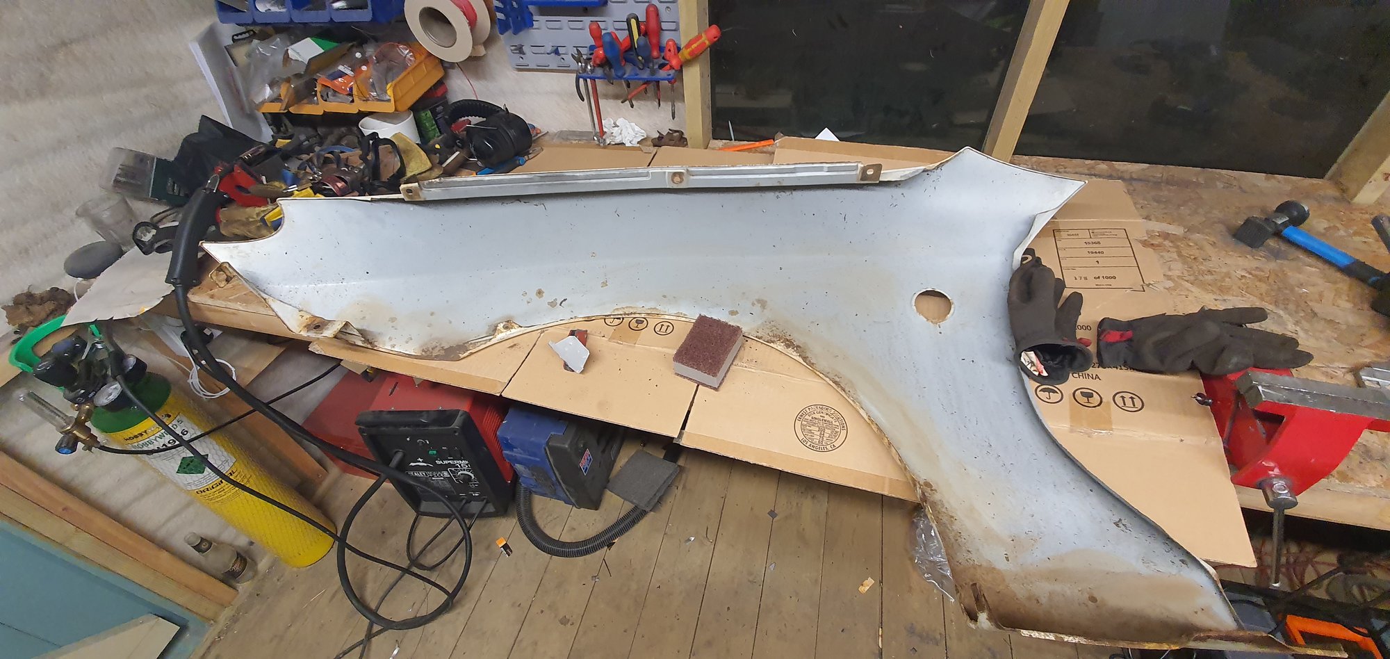

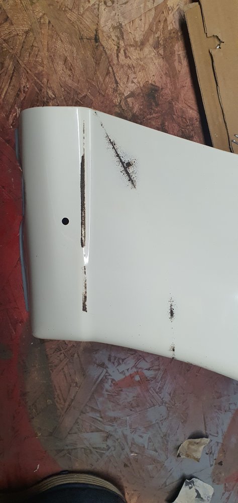

Next on the list decided to tackle a small bit of work needed for the passenger side wing as I'm back home and not with the car.

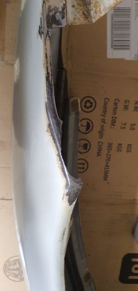

There's a little tear in the wing and also the bumper bracket has started breaking away.

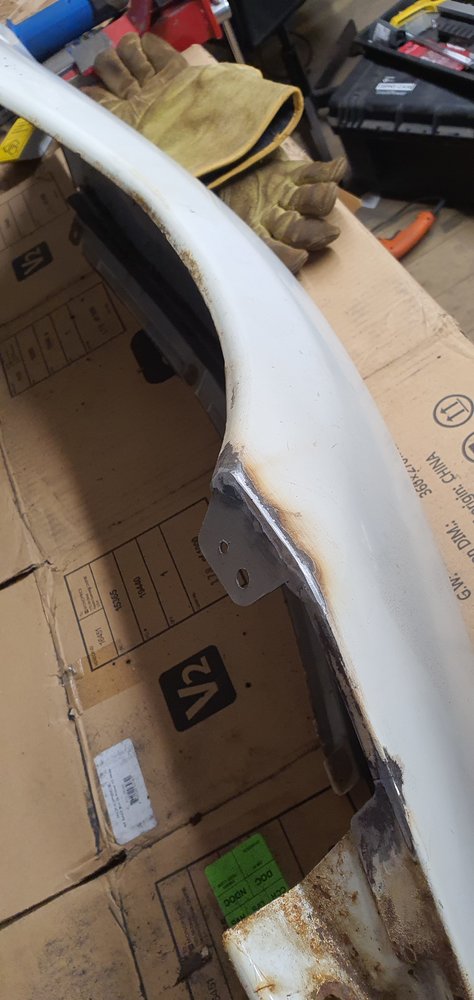

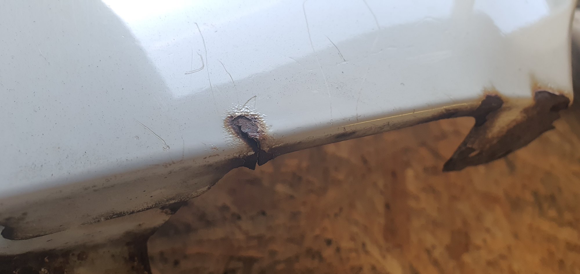

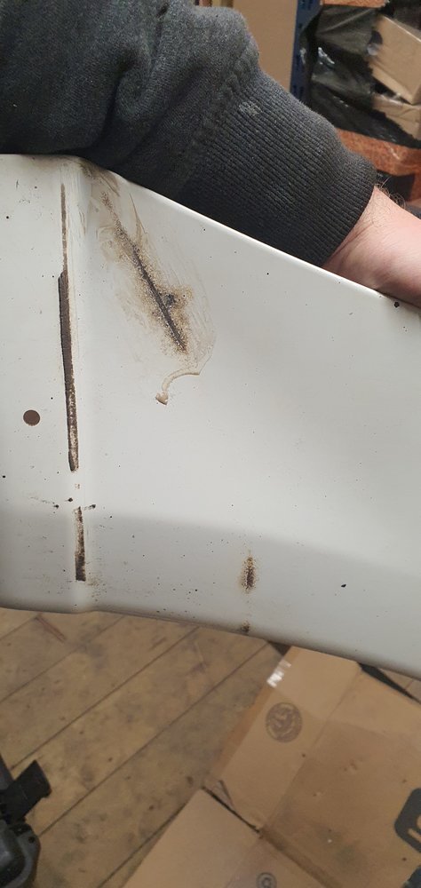

A few minutes later job done. For the little spot weld I was thinking of smoothening this out with filler or should I try get a better weld there as I feel like I can still see the seam.
In really nervous welding this thin rusty material that is also an exterior pannel so not sure how close I should get it to perfect and rely on filler, should I aim not to use filler and do I need to make sure there's no pin holes etc on the welds

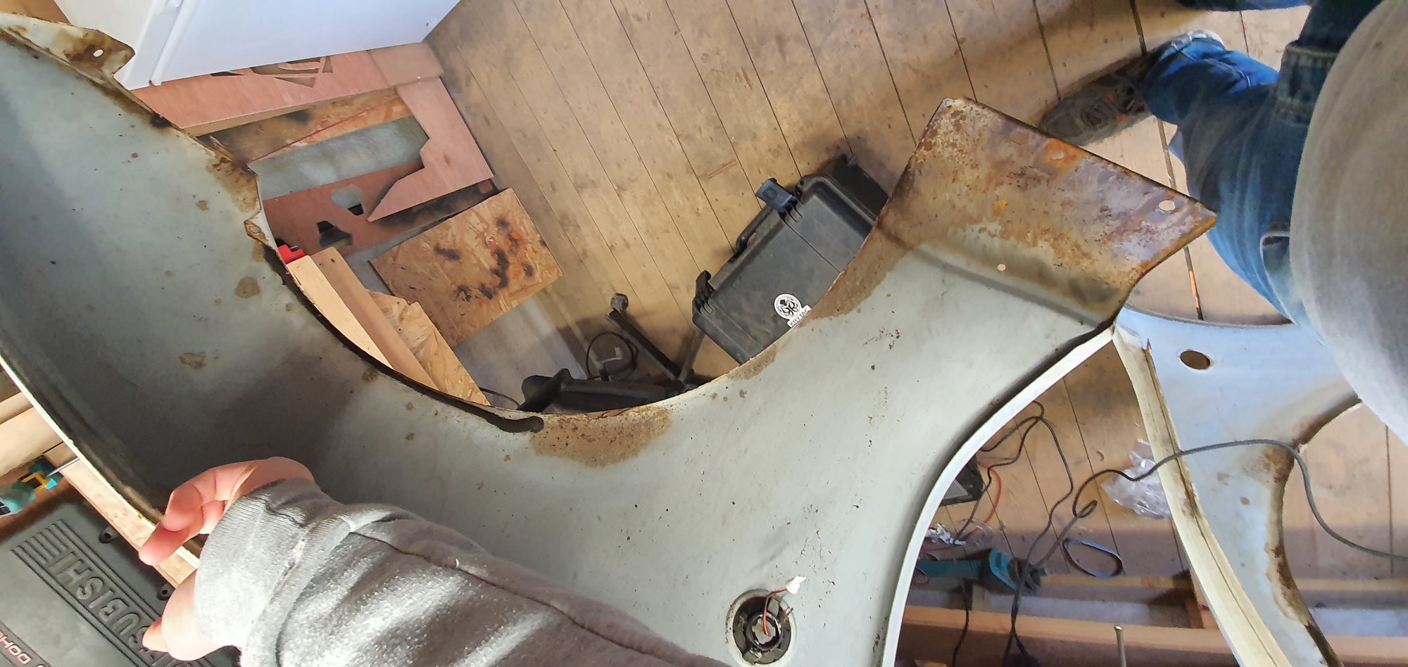

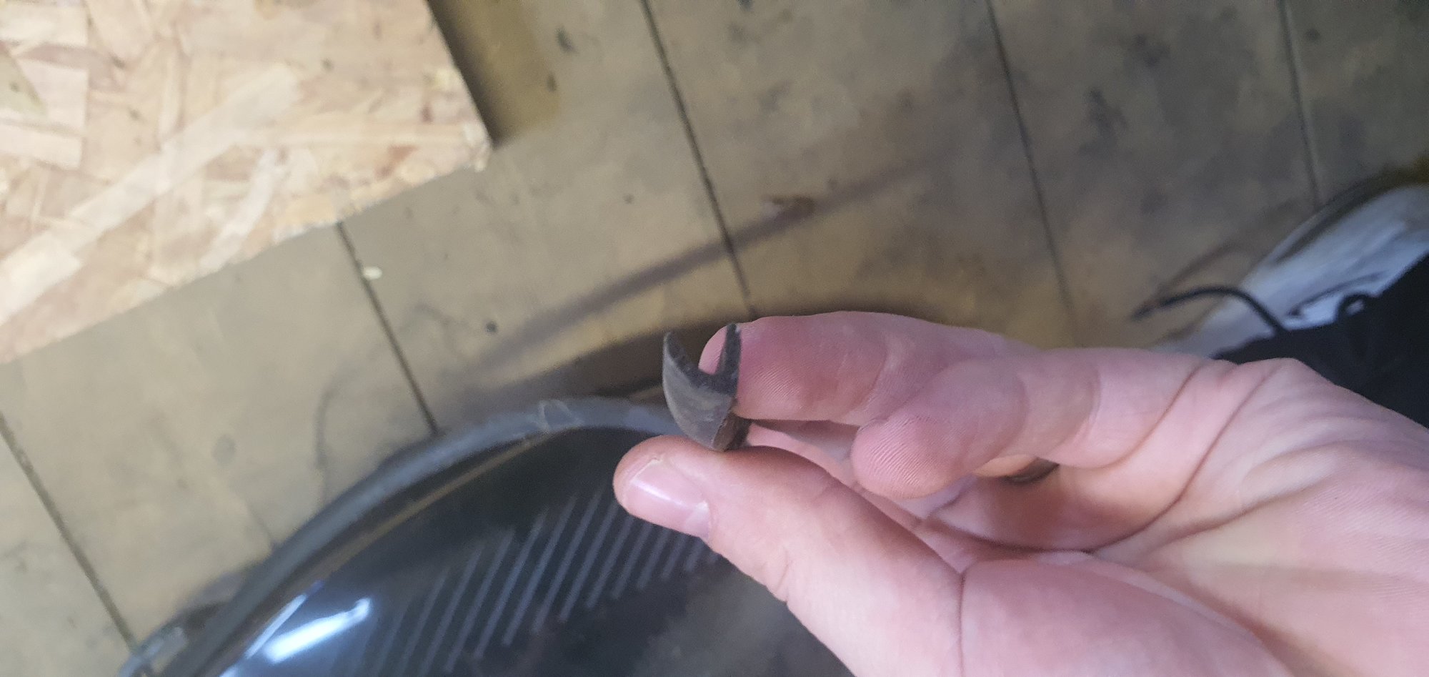

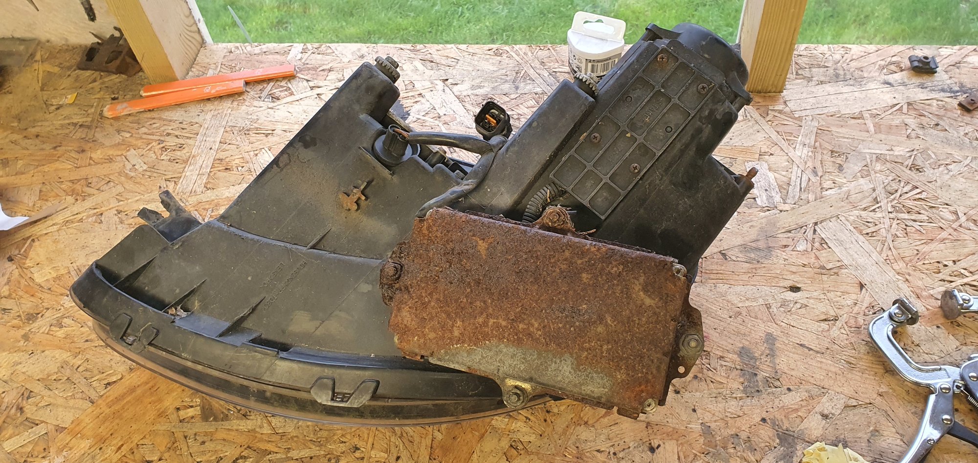

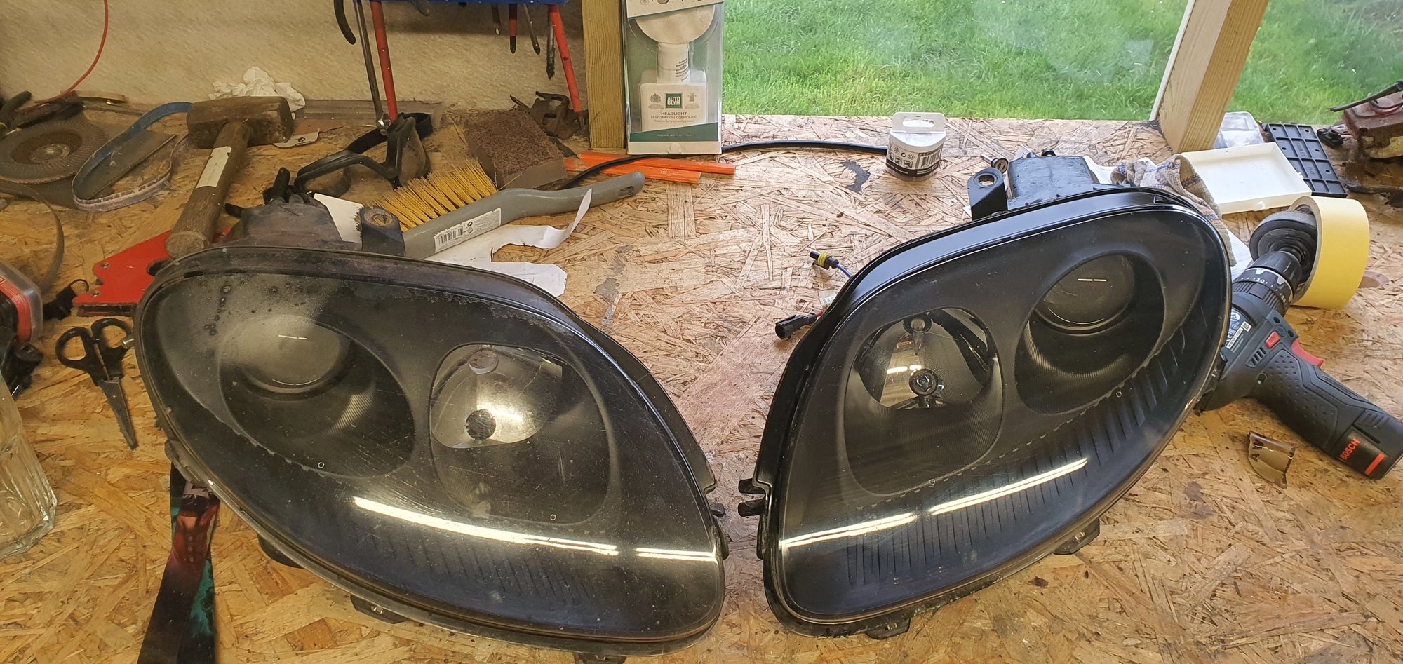

, front lamp gasket maybe?
