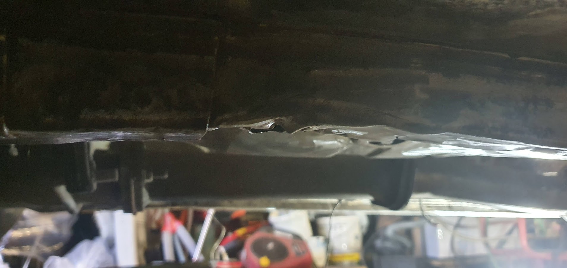

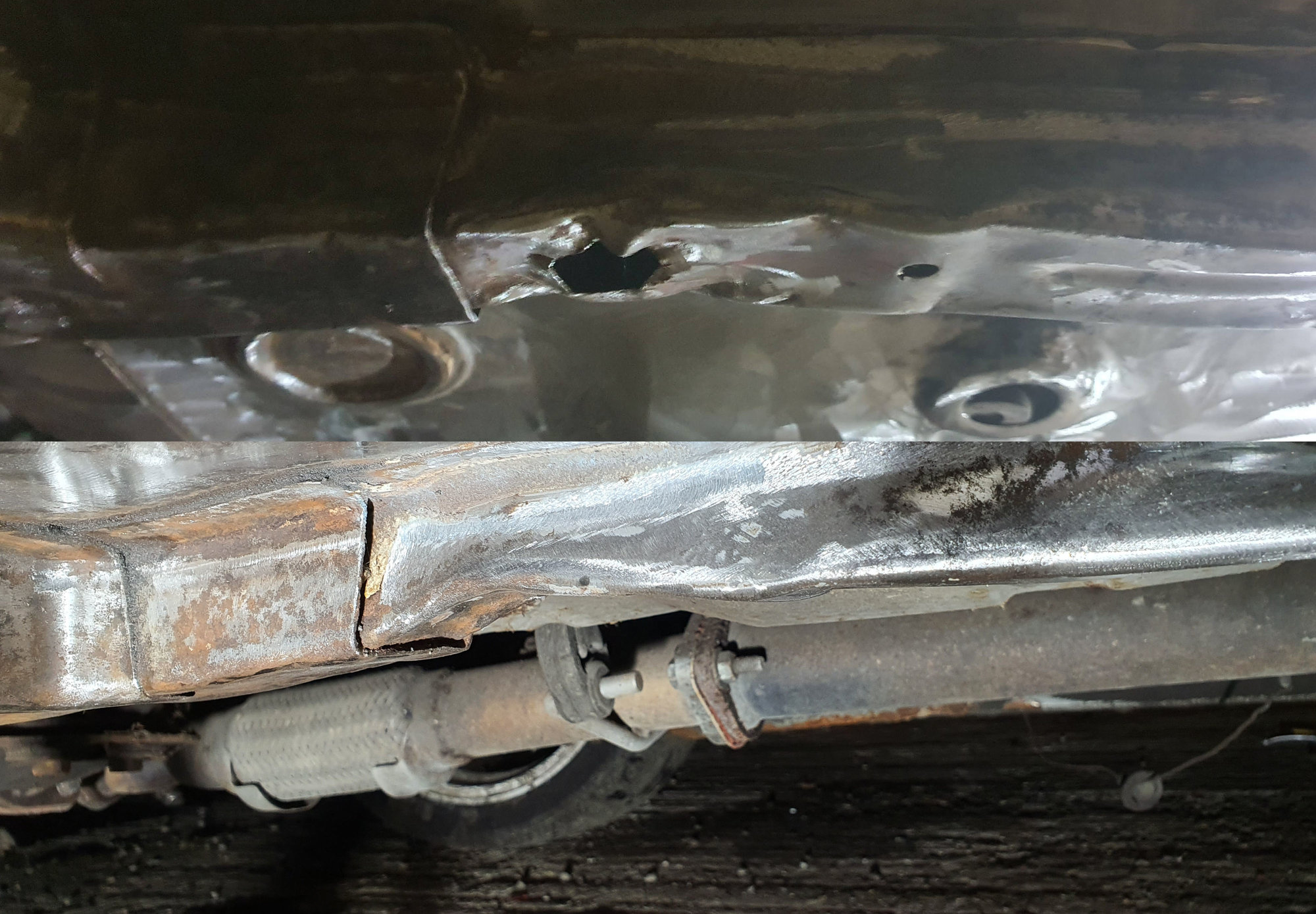

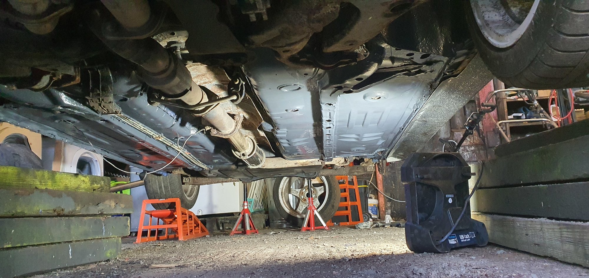

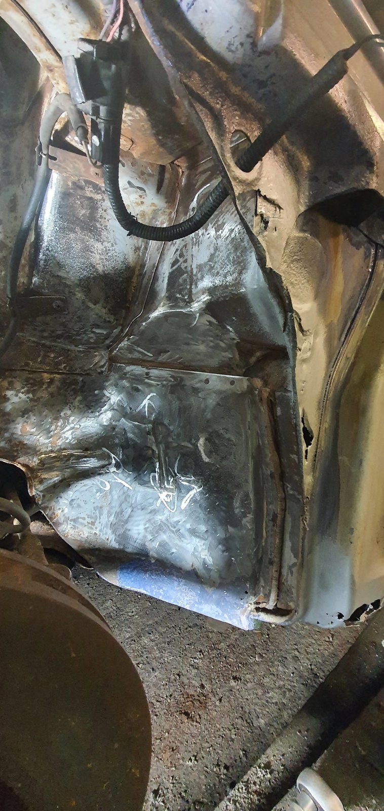

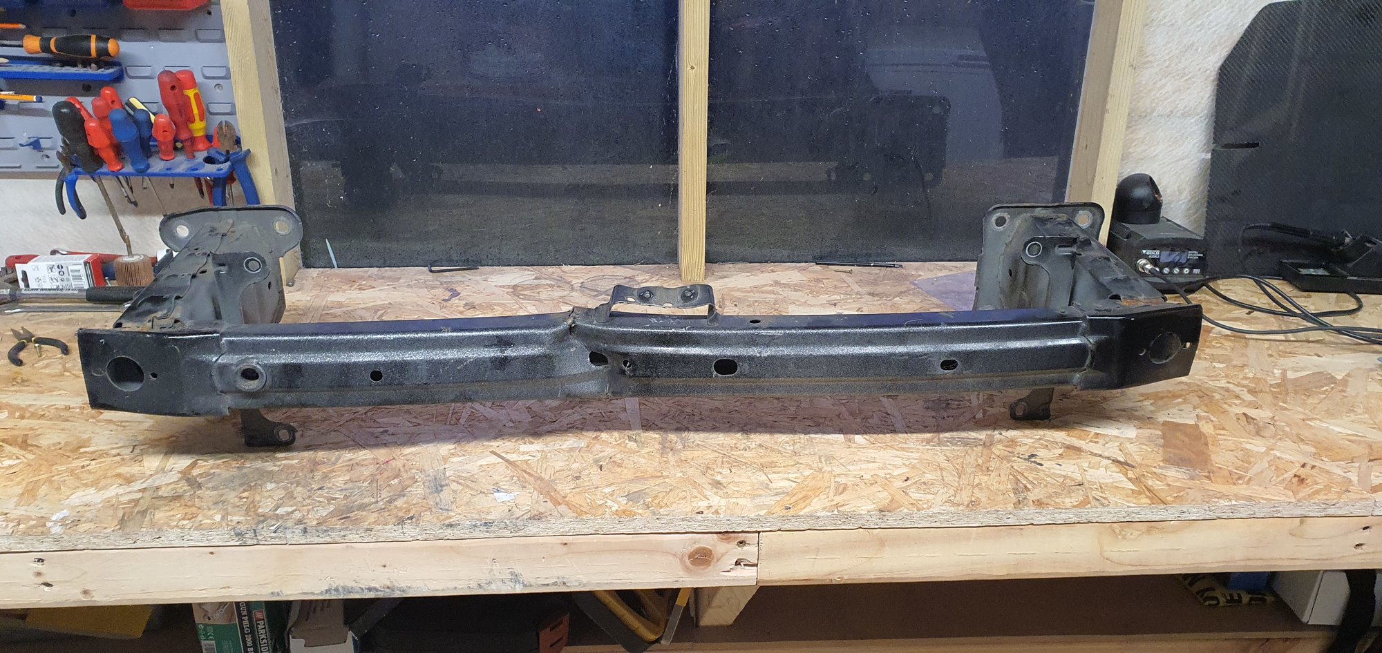

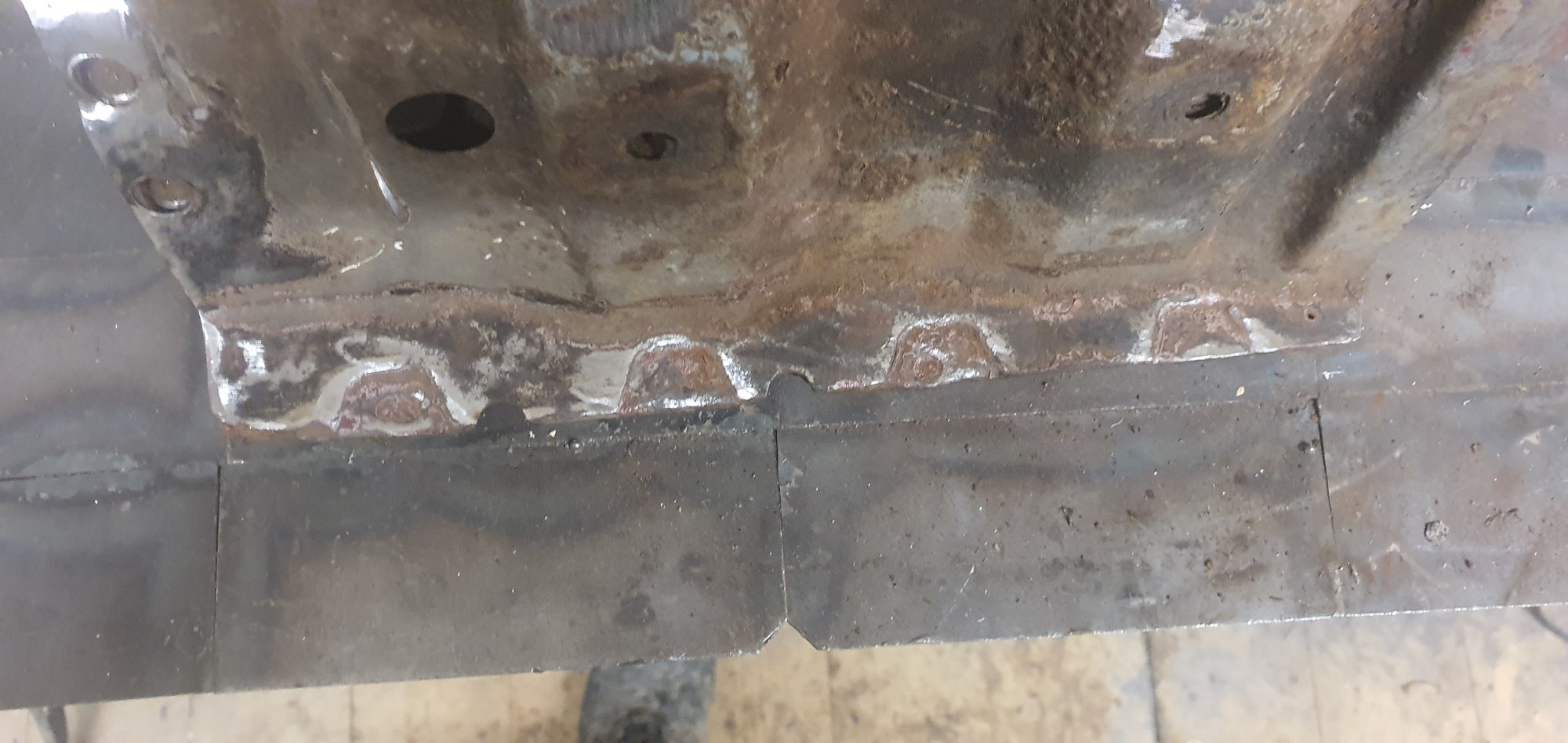

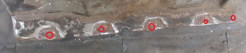

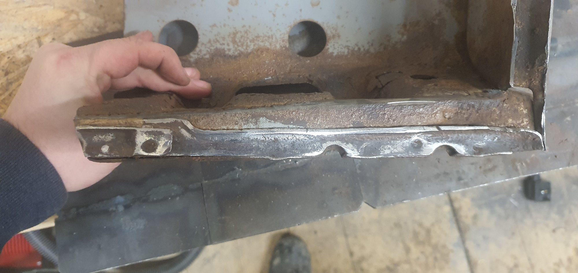

The work from above would be to hammer down where the red bowed lines are in my pic. Remember you need to "move" that metal as well as the bottom (underside). If necessary you could also use a hole saw to open up from above an access to allow hammering down through the box section where the slide hammer is not able to move the metal. If you went for say a 1" hole saw then you could just plug it after with a grommet. Just take it easy tapping (must stop saying hammer ) it back to shape. Try and use a bar say 1/2 diameter with the end rounded (like a ball pien hammer) that should help to avoid it splitting the box.
