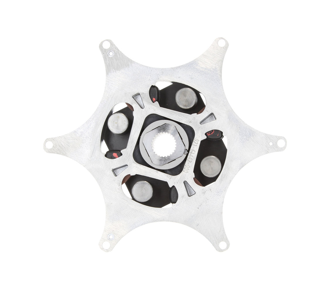

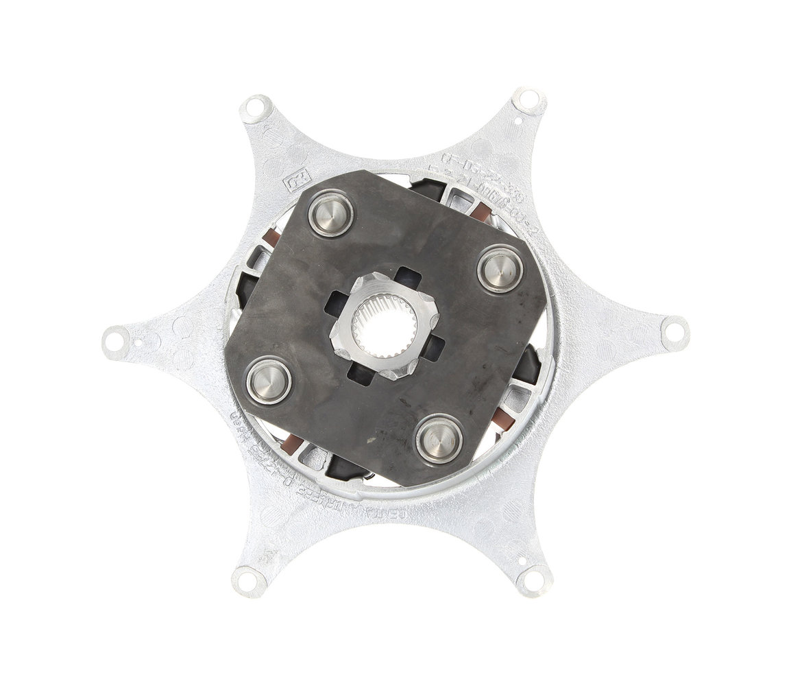

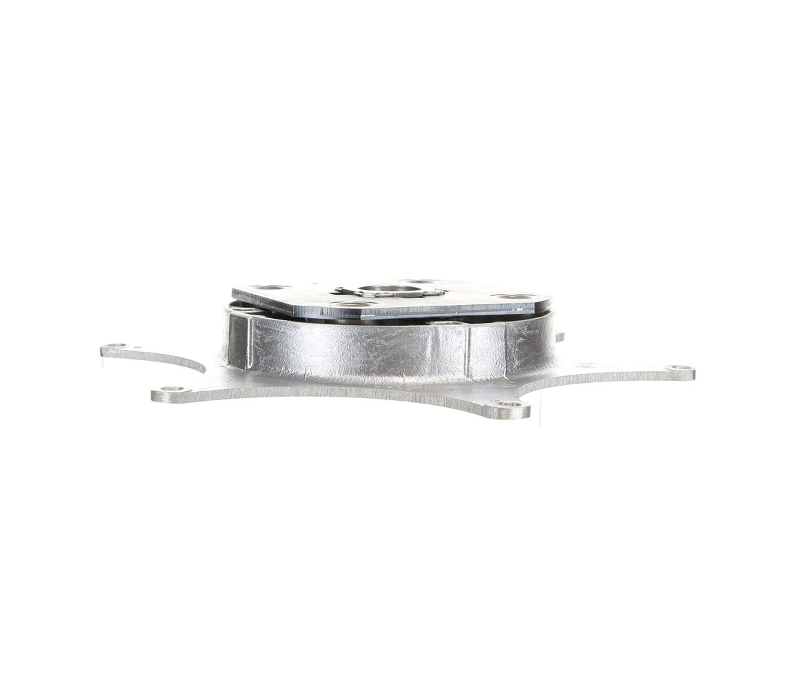

if only it had a flywheel ! And the space.
Essentially the electric car version of a DMF!View attachment 435064View attachment 435065View attachment 435066It needs adapting with a damper plate to are out some of the shock load.
Or simply set the drive rate into eco mode ??????Sounds like there is potential for aftermarket intervention there . . .
Stick a damper on the accelerator pedal - make it slower to depress (not return tho!) so future applications of instant full torque can't be so easily applied.

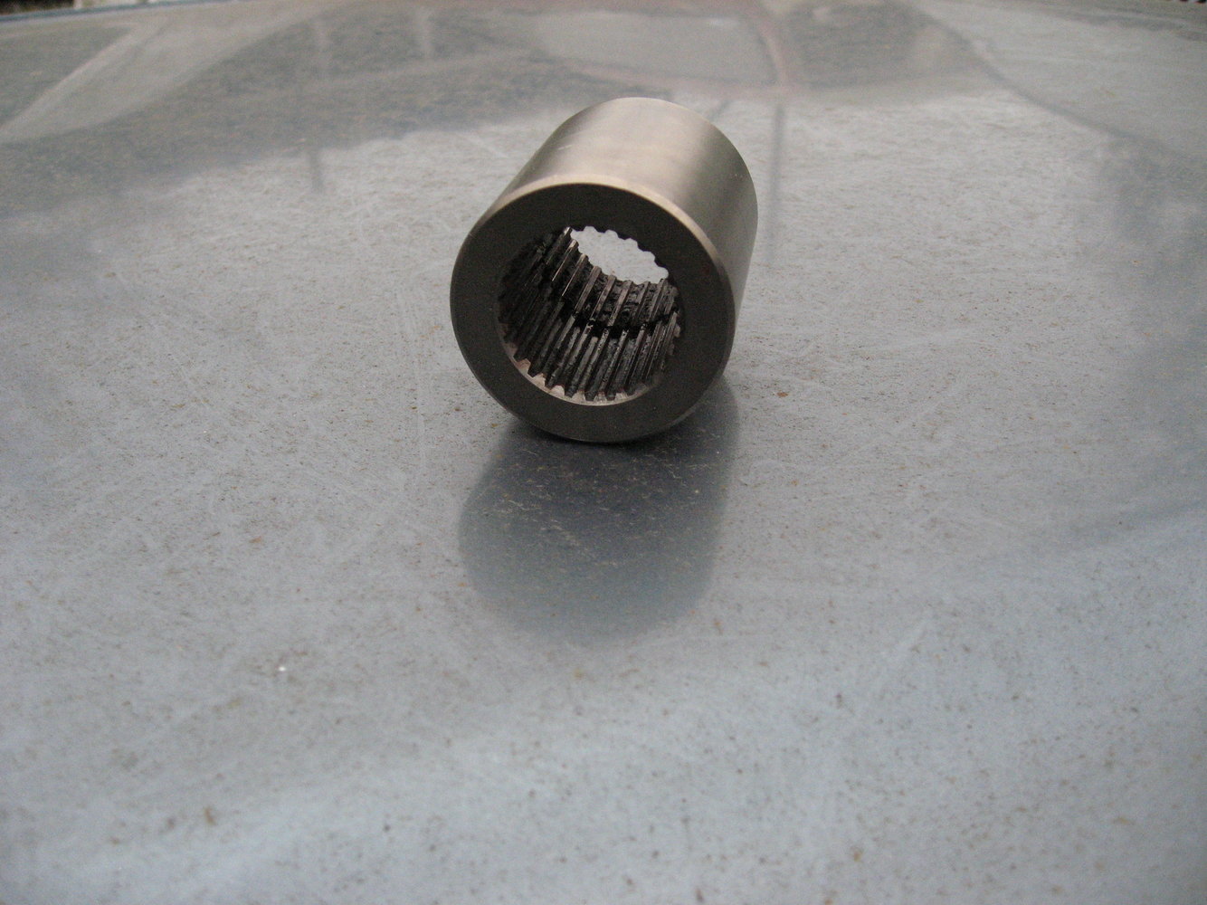

That is a thought... I could do that at the transmission-end of the new sleeve, and then use that shaft as a broach to size the hole.What would be the chances you could shrink the splines a small amount by putting a good hot run of weld around the outside near each end?
I did it with the slightly oversize ends of a solid car axle, where the king pins fit. It worked, shrunk them enough that I could run a reamer through to clean the hole to the exact size required.
But how many clutches have you changed that have ripped the splines out of the center? I have changed hundreds if not thousands and have never come across it yet I have changed several spline couplings on Citroen/Peugeot Talbot cars , considering the relatively few of them I have worked on versus the failure rate there was definitely a problem !!Neither has every other manufacturer using one on a clutch plate then![]()
