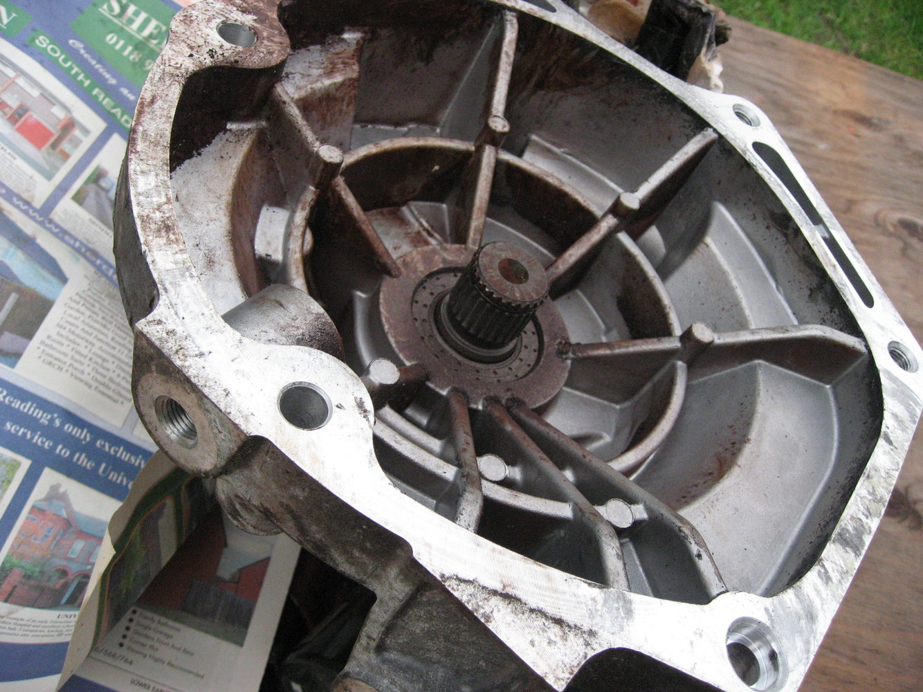

It is suffering from a known issue - the splined sleeve that joins the 50kW ( 66 BHP ) 200Nm 9,000rpm electric motor to the single-speed transmission has lost it's teeth at the g'box end, and taken the splines on the transmission input shaft with it.

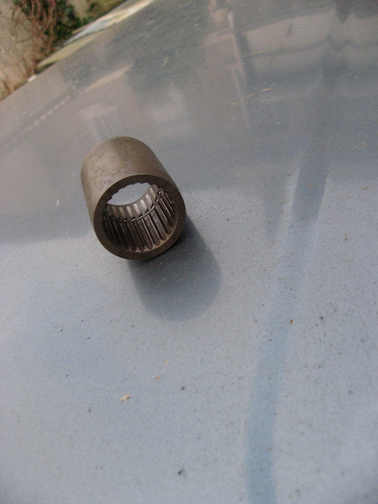

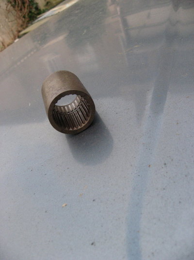

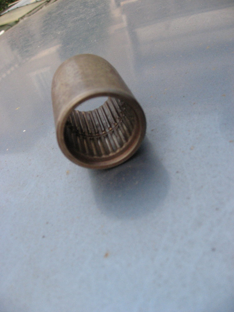

The end of the sleeve that joins to the motor shaft is still OK:
The motor end of the sleeve is about 25mm deep, the end that mates with the transmission is only 20mm deep.The overall diameter of both shafts is ( or should be ) 28mm, but the transmisson shaft has been abraded down to 25mm. There are 26 splines. The full length of the splined sleeve is 50mm. The outer end of the transmission shaft has ( had ) a circlip to locate the coupling sleeve, and there is ( was ) a rubber O-ring between the sleeve and the outer bearing in the transmisson case. Without the O-ring, the worn sleeve can be seated flush with the bearing face, and pick up enough unworn spline to locate concentrically.
