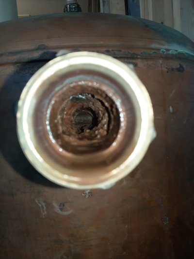

Not iron - brass. I made that mistake once, when I ran out of the right size brass fittings on an install. Ten years later, the householder called me to say his flow had dropped a lot. A fair bit of head-scratching ensued, and I eventually traced it to the farking iron bush that had corroded internally and blocked up.
Because it was my cock-up, I didn't charge him anything for the time.
